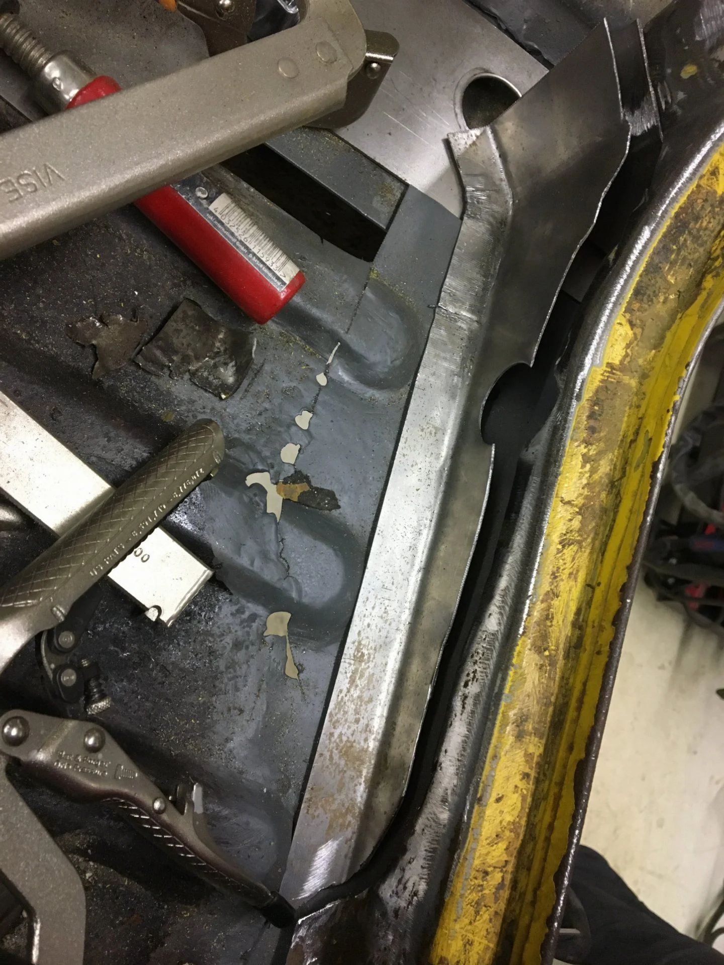

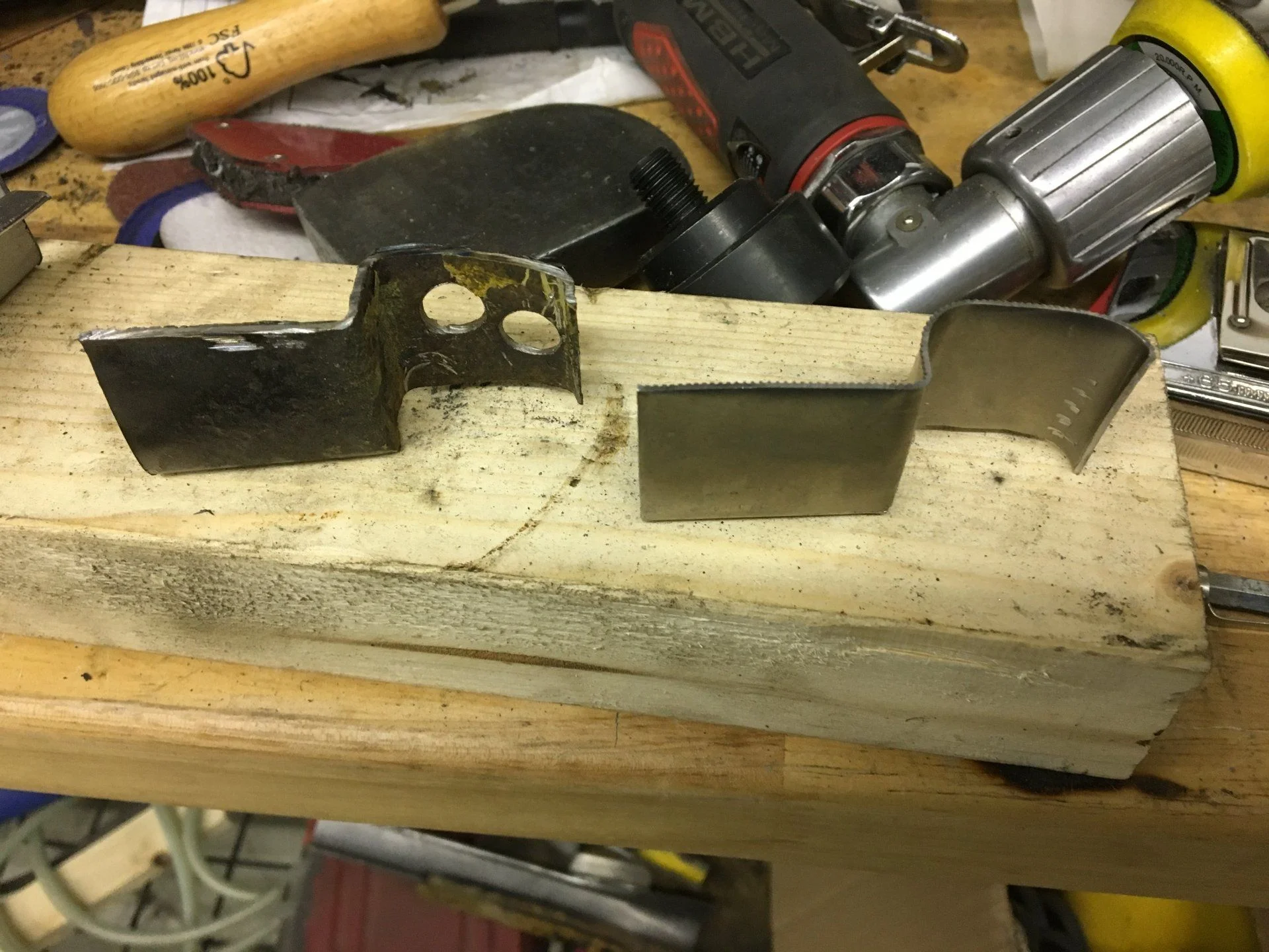

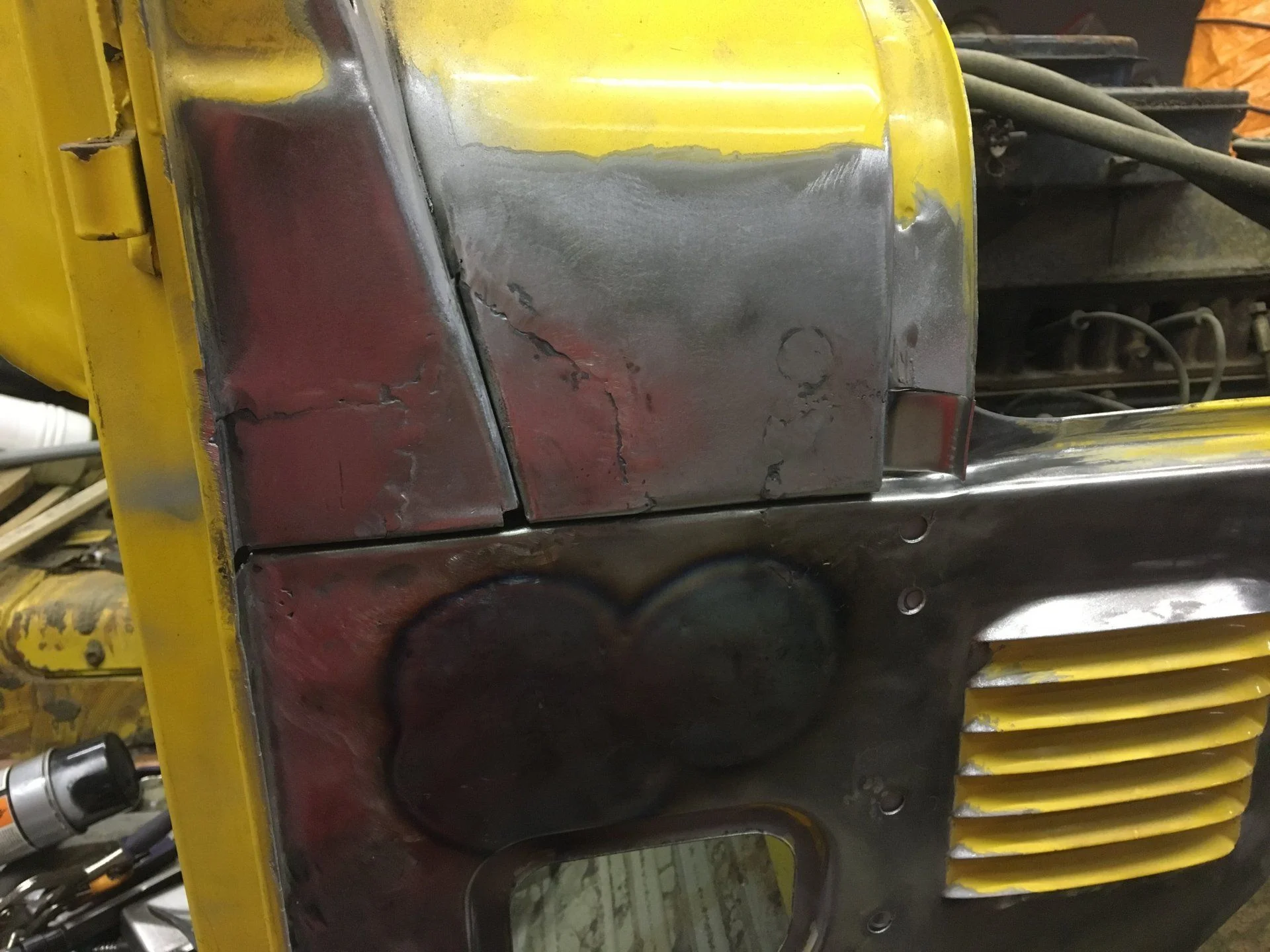

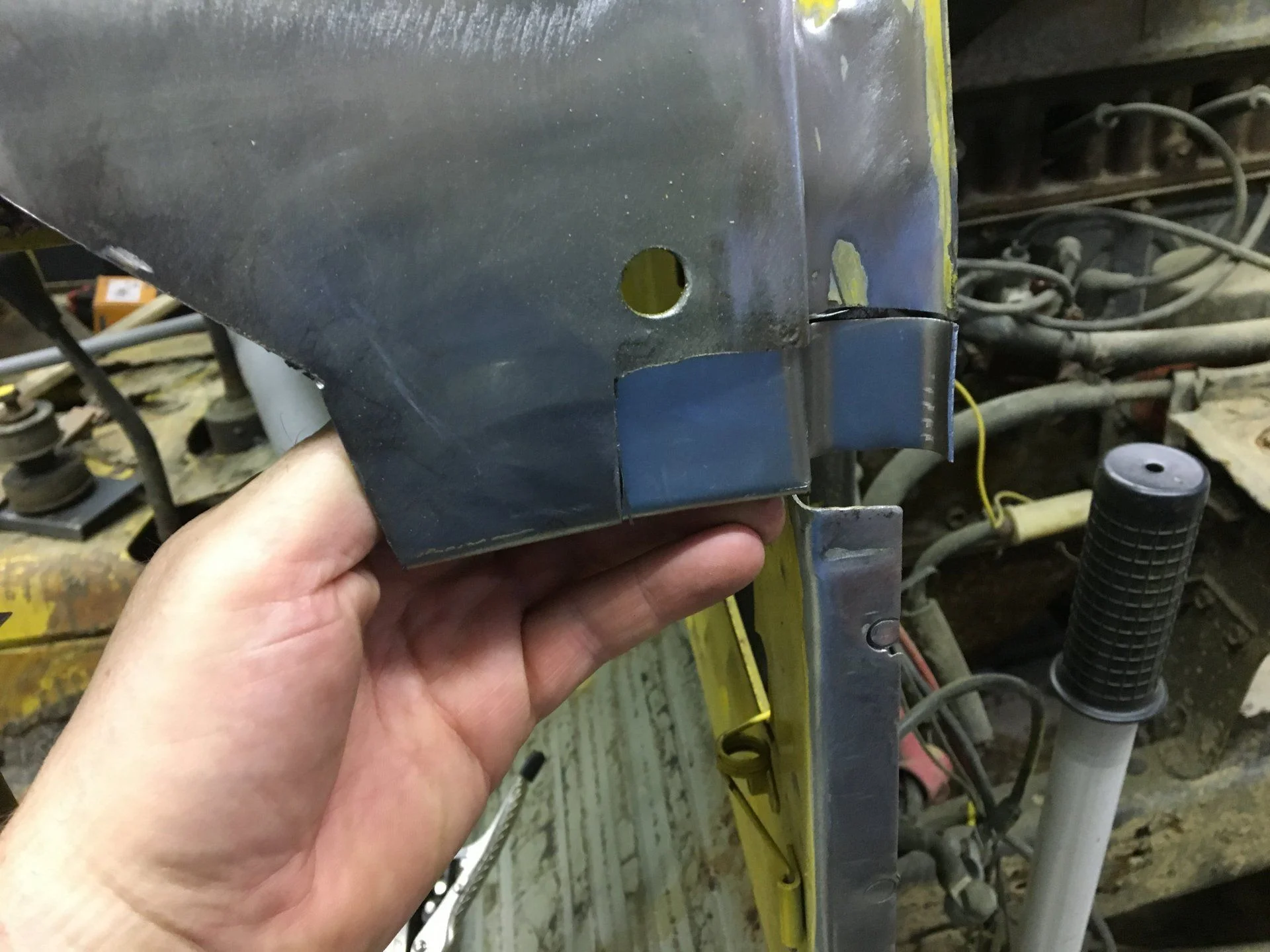

Patch panel number three made for the cowl.
Beautiful work!!

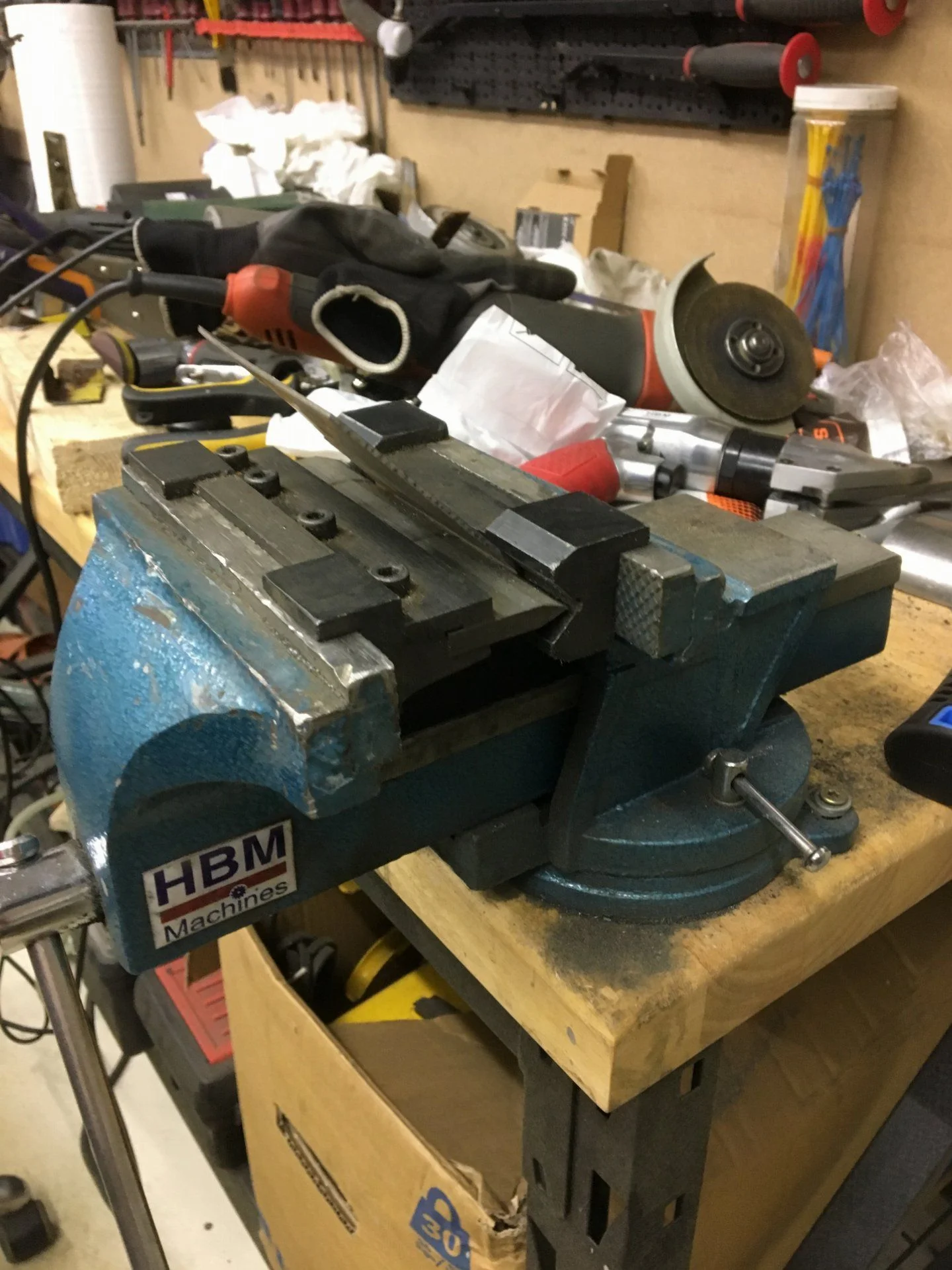

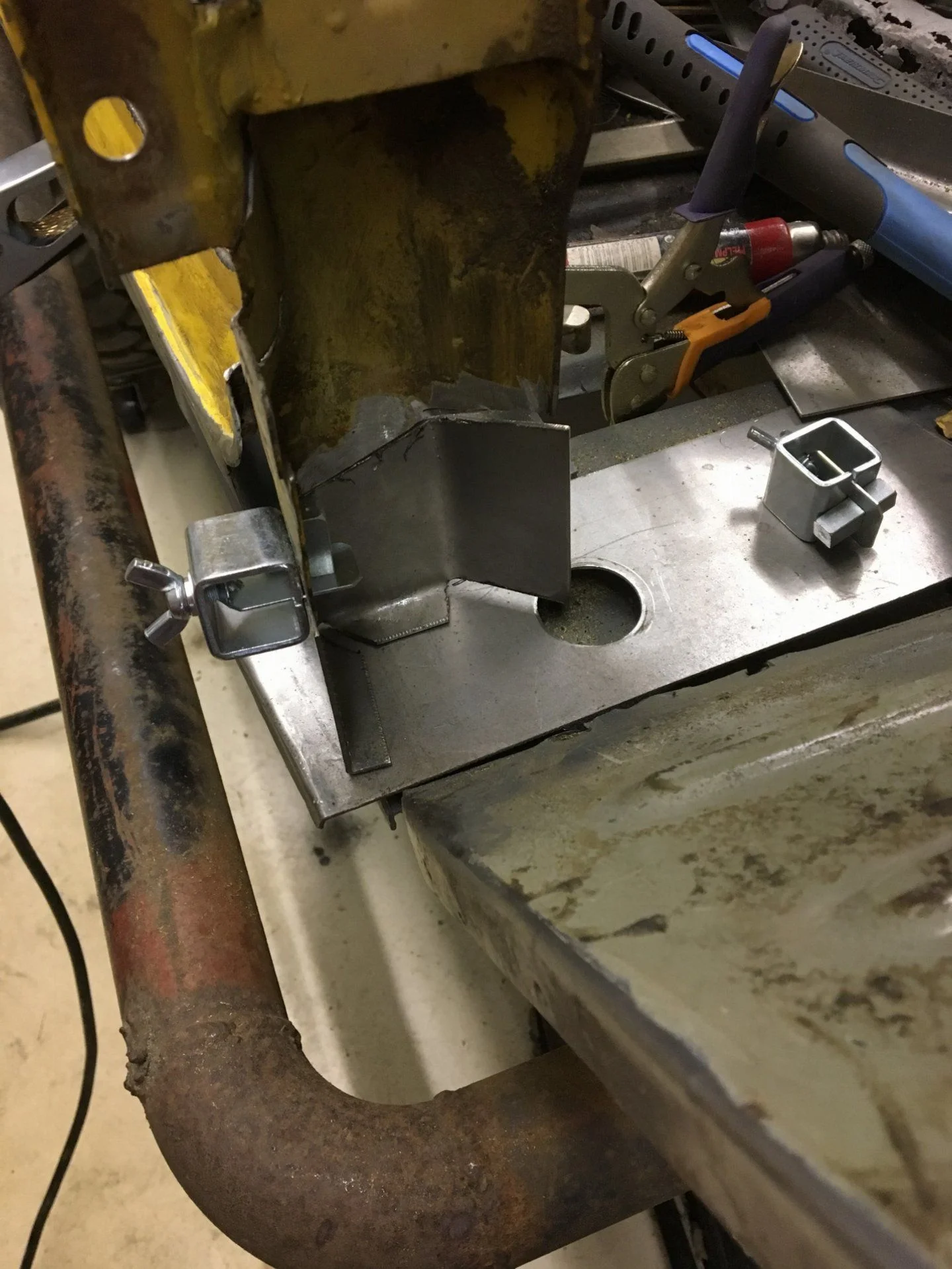

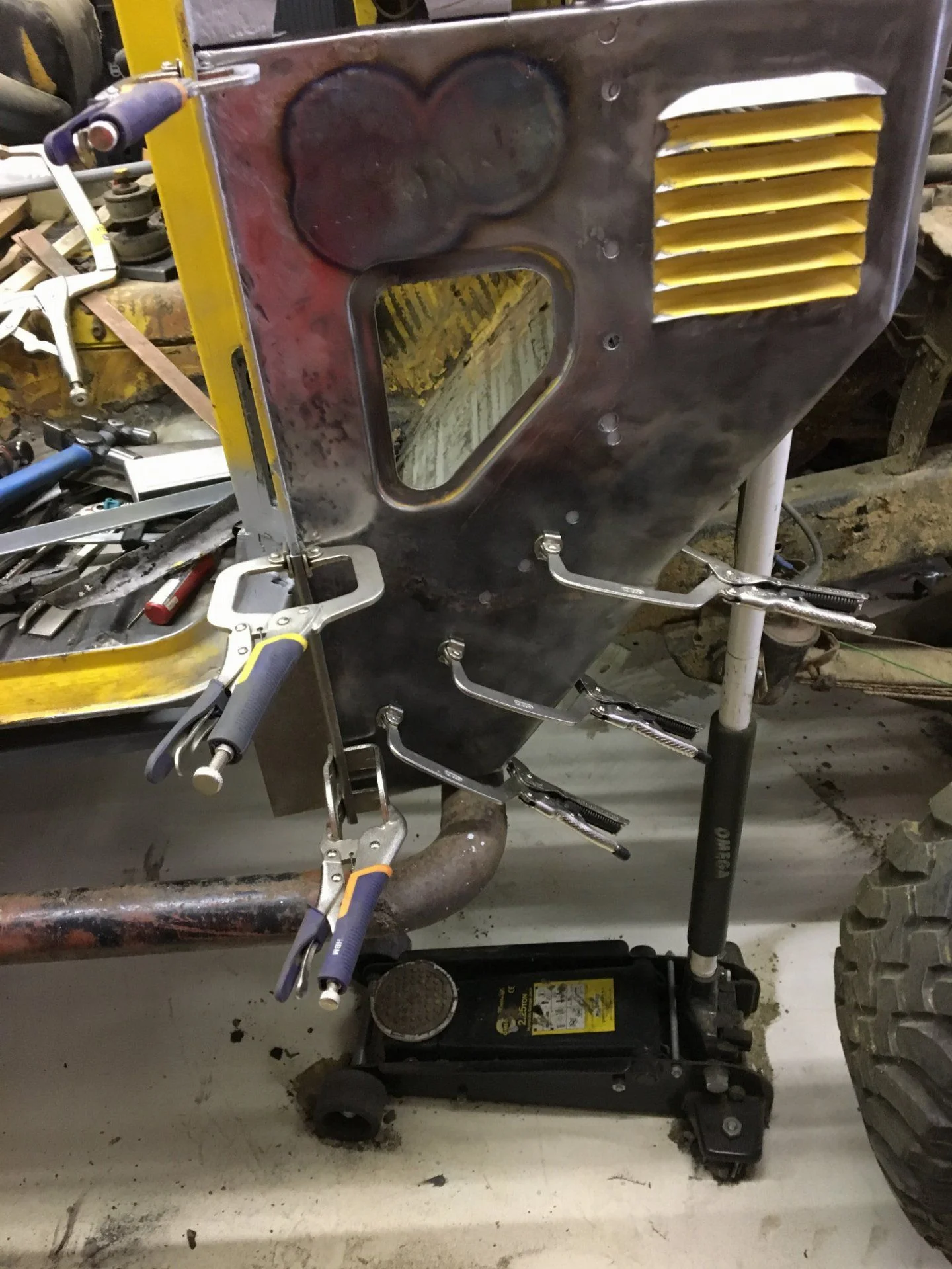

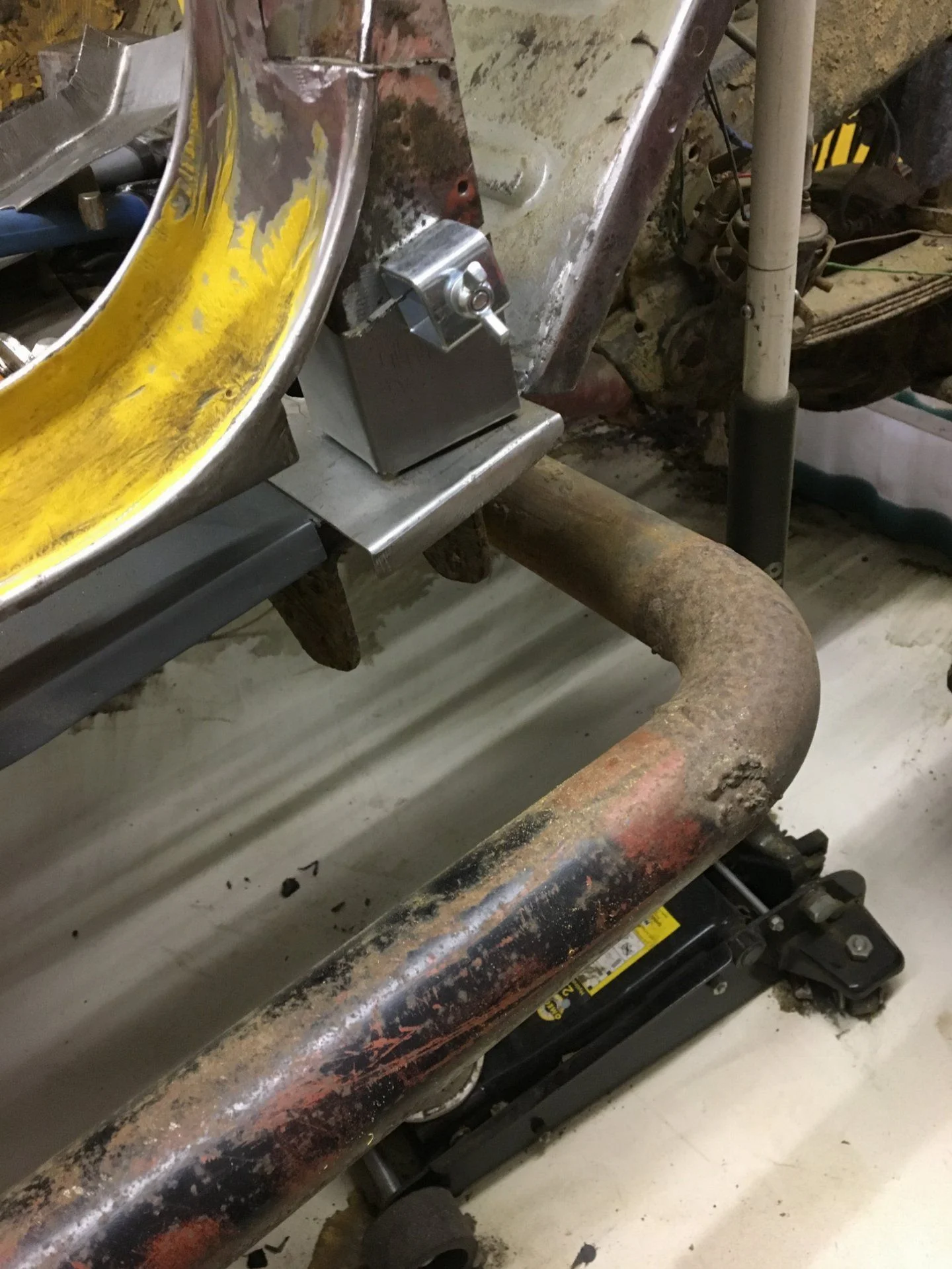

Don't be afraid of the steel work. Just cut the pieces out an use them as a template.
Buy the tools as you need them.
Most of my patches are made with vise inserts for bending, a roling sheer and a grinder.

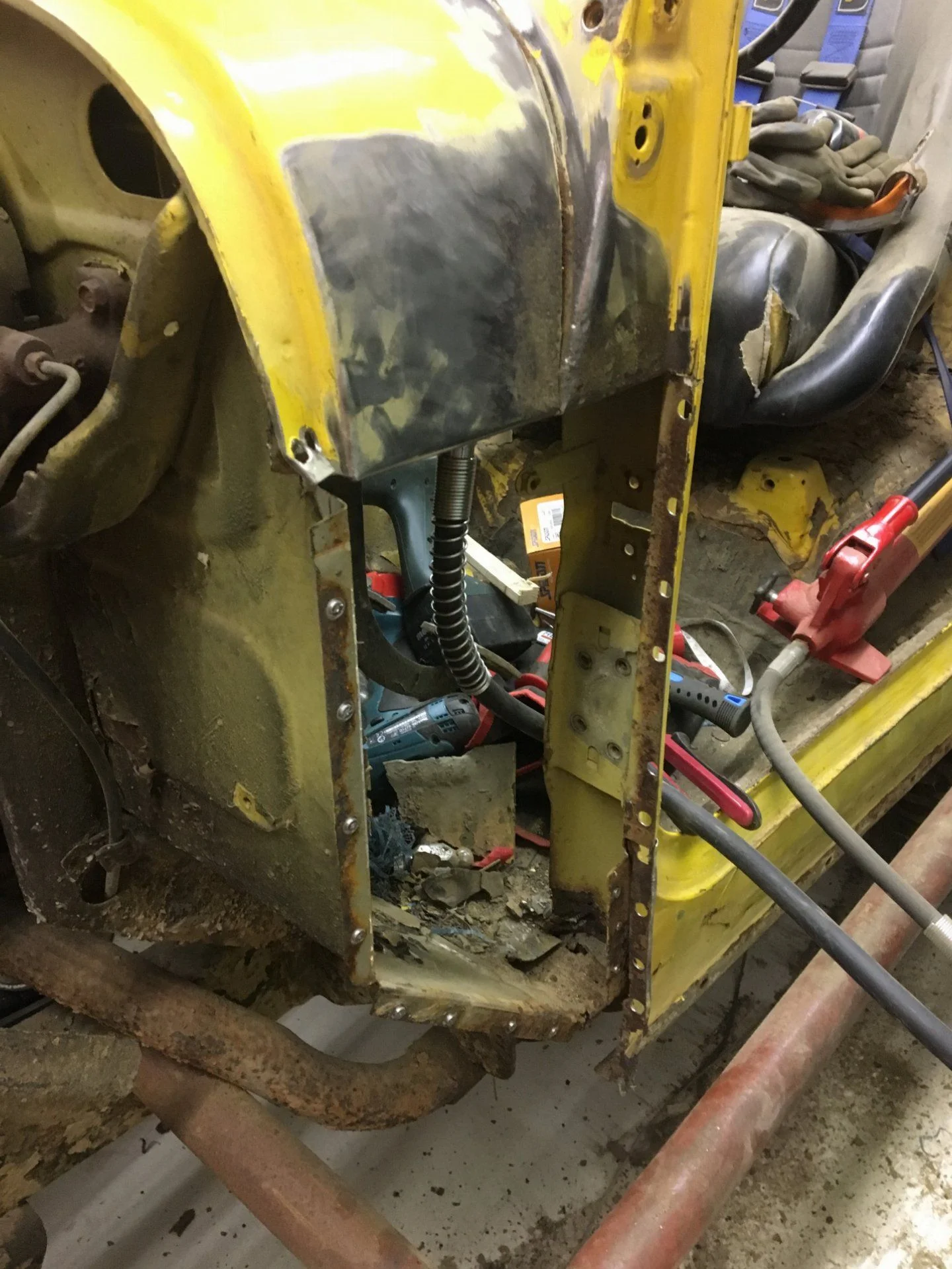

Being a Vermont truck the bottom of my A pillars are non-existant, so any pics of what it should look like are hugely appreciated!
What year is yours?
What year is yours?
It's an '82. I bought it in 1993 from the my next door neighbor, the original owner, who was 75. She used it for hunting and plowing snow, so it's seen a lot of winter salt.
I actually have to carefully separate the cowl from the tub, because I have 3/4 tub that I bought 10 years ago. It'll make it easier to work on but harder to get the final fitment right. It's complicated also by the fact that it's being disassembled in VT, and reassembled in Boston (in a 1-car garage).

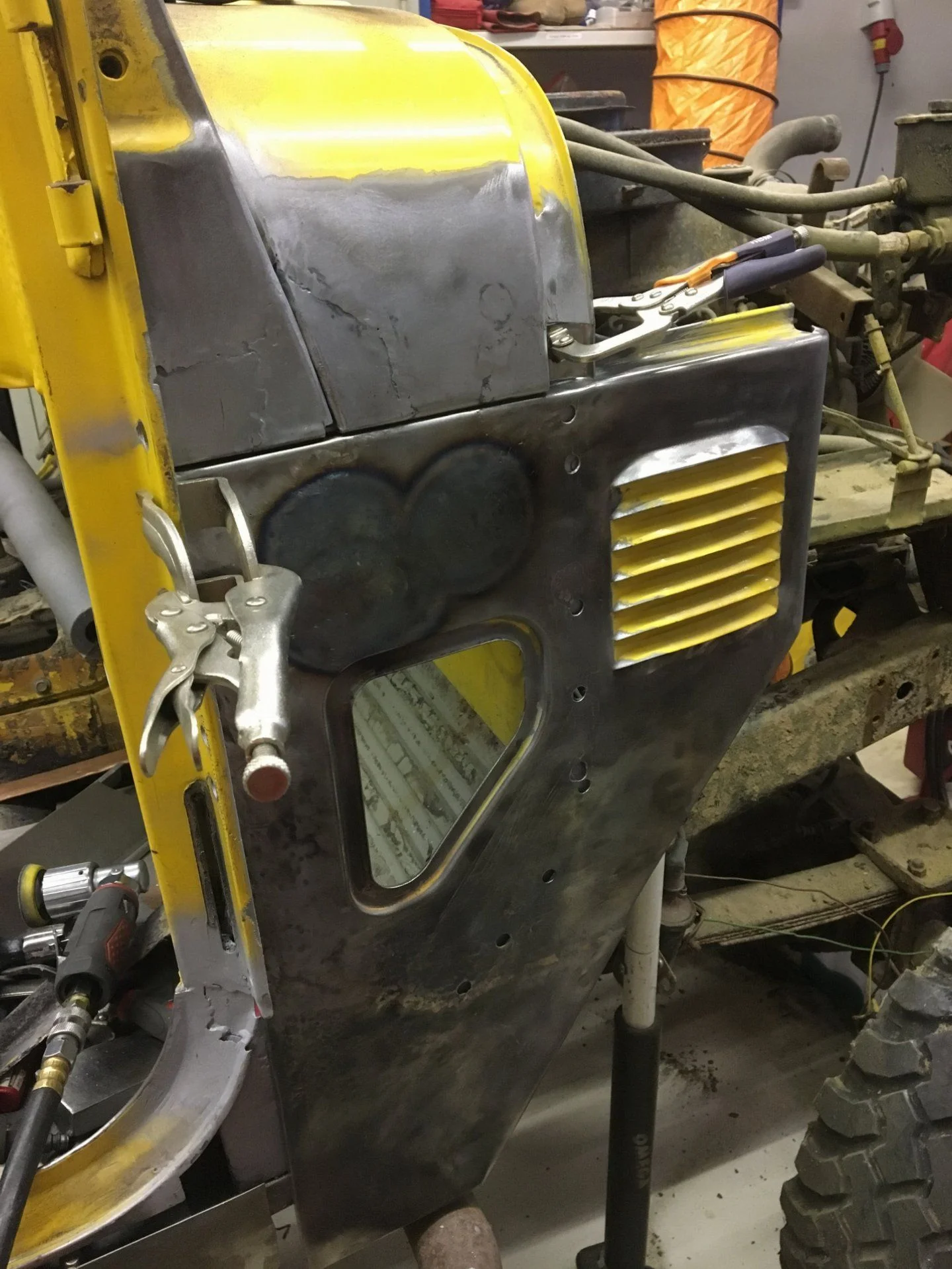

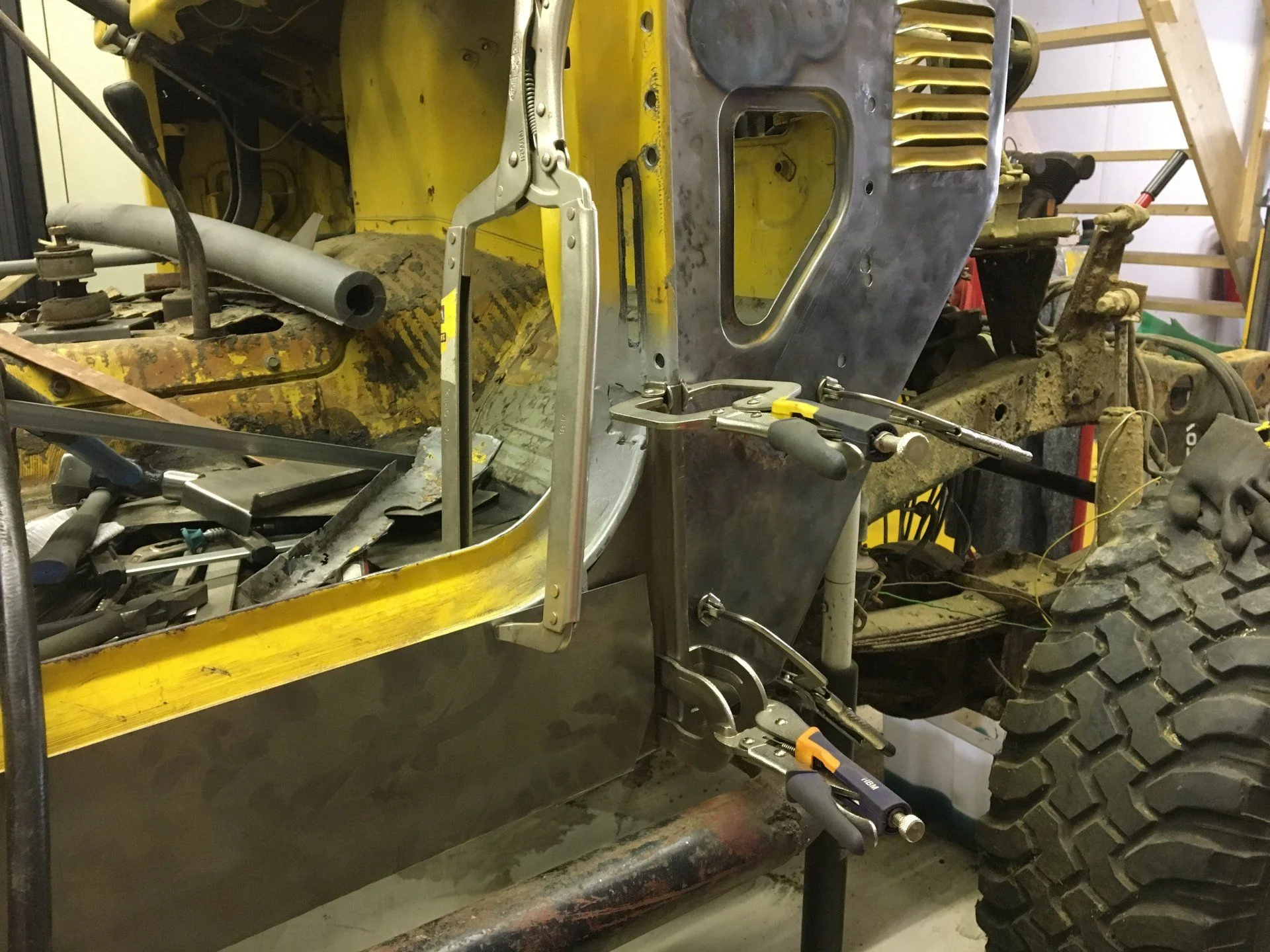

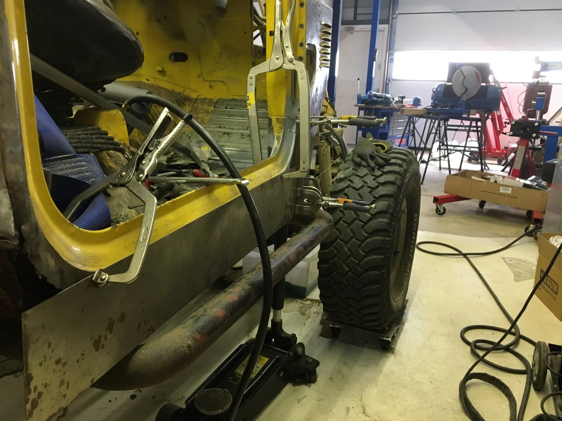

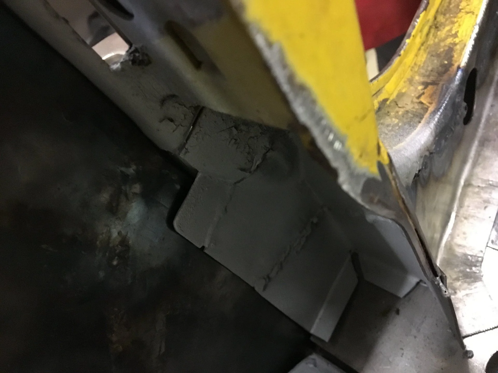

Decided to cut the remaining affected part of rhe cowl and replace it

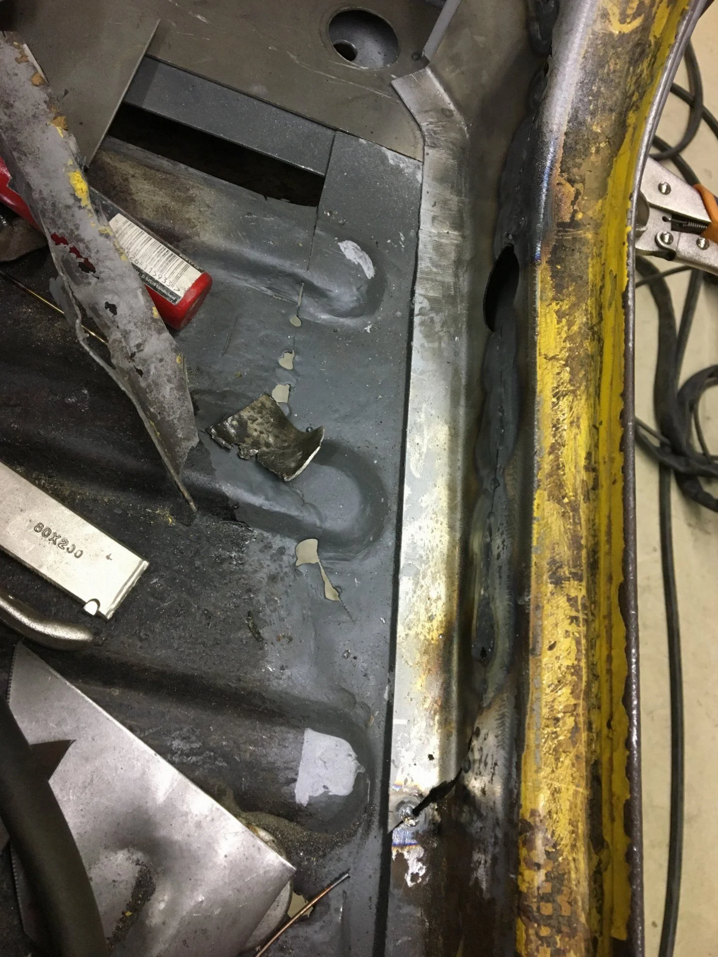

Patches welded in, they still need some work but it is a start.
