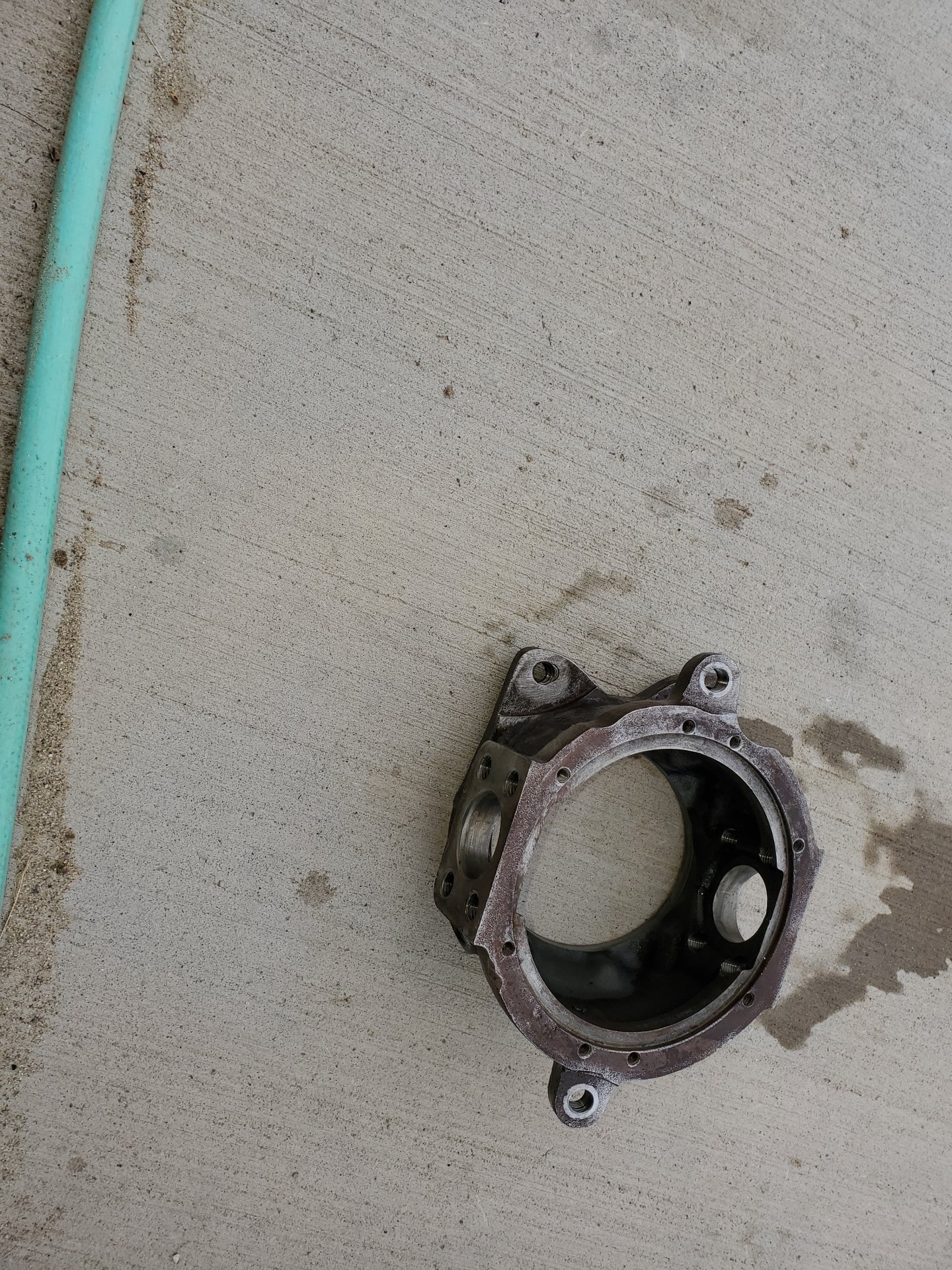

A 3F bell housing was delivered yesterday, so I borrowed a needle gun to get some of the rust flakes off and went over it with a wire wheel then too it to the power coat shop and dropped it off.
Came back and fired up the vac and used a putty knife to get the loose rust, dirt and grease and everything the mice brought in and left and pulled out the headliner since it was falling off. Some surface rust but is all sound, not bad for a build date of 02/78.

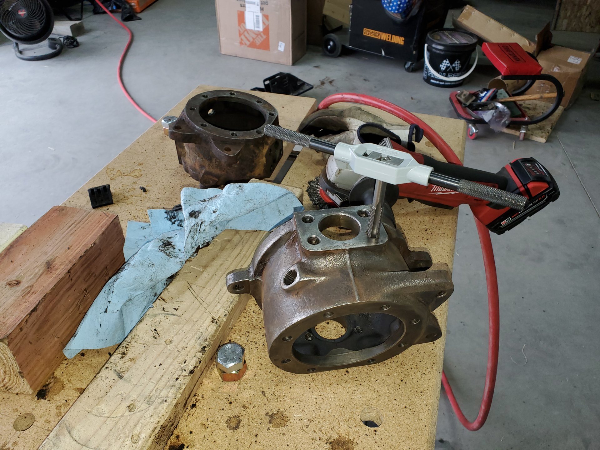

Then it was my turn to do the dishes and pulled out the FJ60 knuckles and started washing out the grease the stripped them down and washed some more. Let them dry and are ready to be wire wheeled.
Wire wheel cleaned the FJ60 knuckles and more time in the parts washer.
Chased all the threads that I have a tap for in my set. Did not have a tap for the seal side

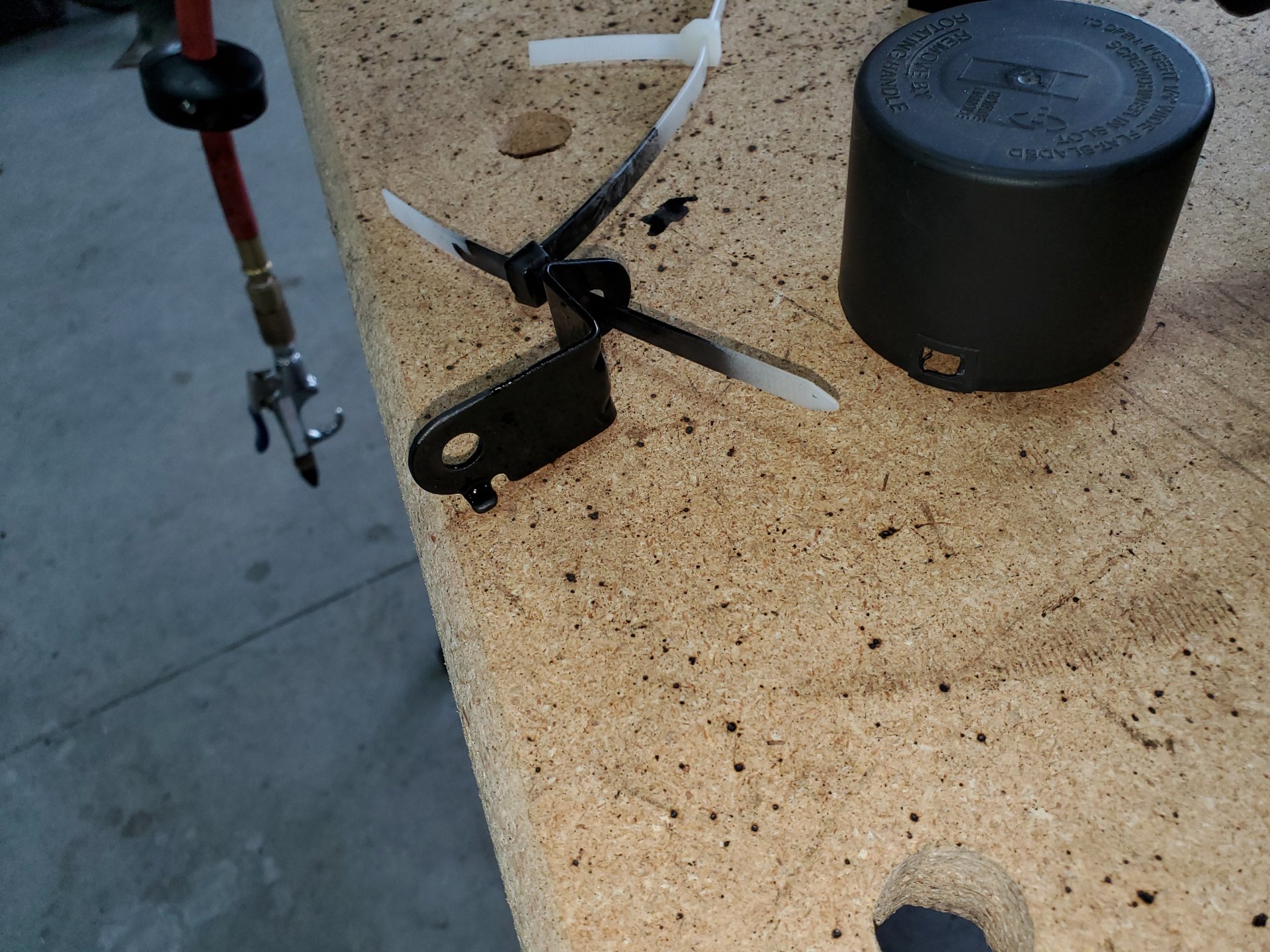

The bracket for the parking brake switch had surface rust so I used the wire wheel to clean it up
After cleaning
After it was clean shot it with rattle can paint
