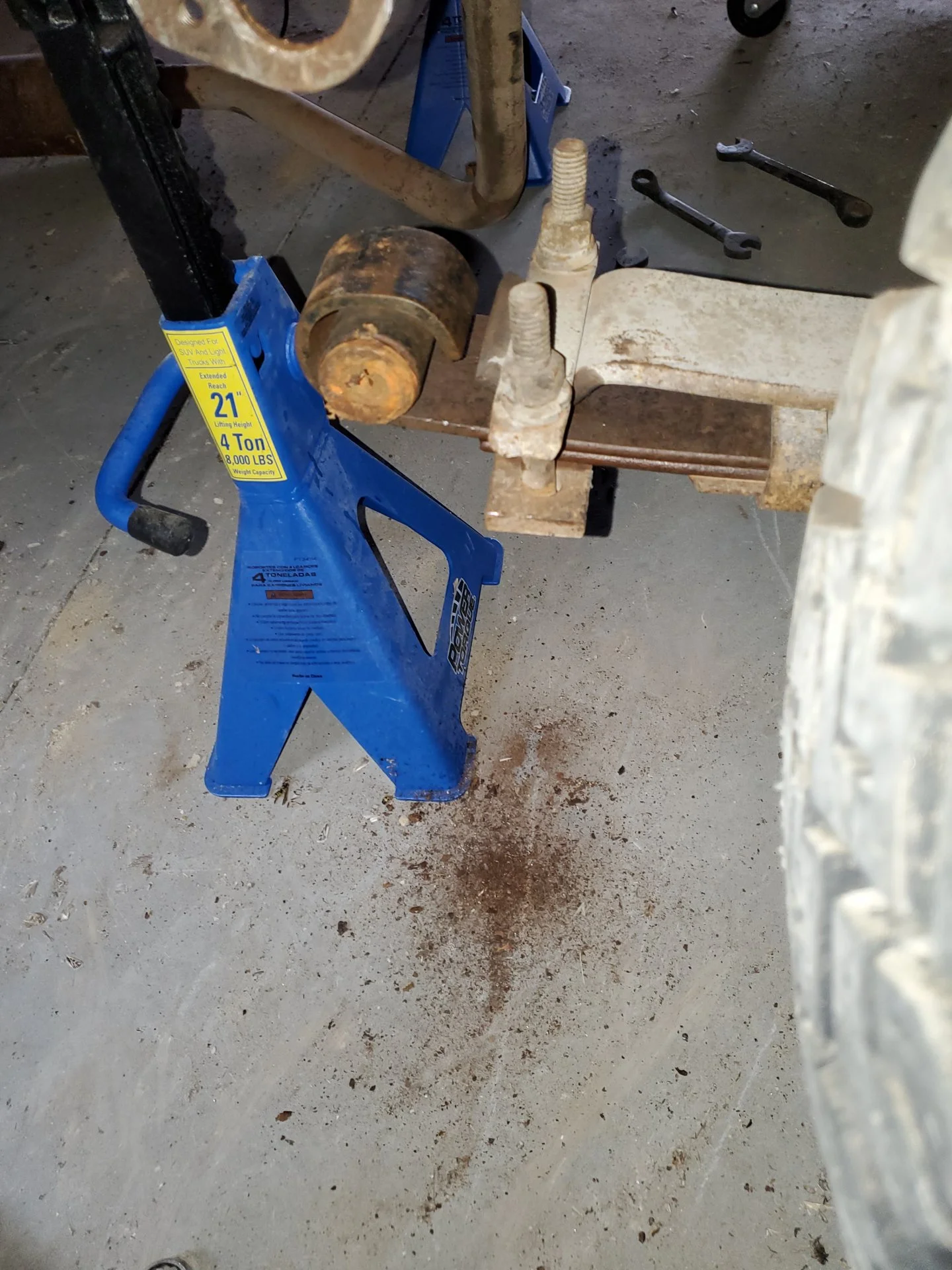

I used a bearing puller to get the stuck pin out of the eye of the spring until I was able to pull it out by hand. I had to get creative to get it out using a chisel or wrenches to jack against with the bolts. Worked a lot better than beating it out with a hammer and chisel.

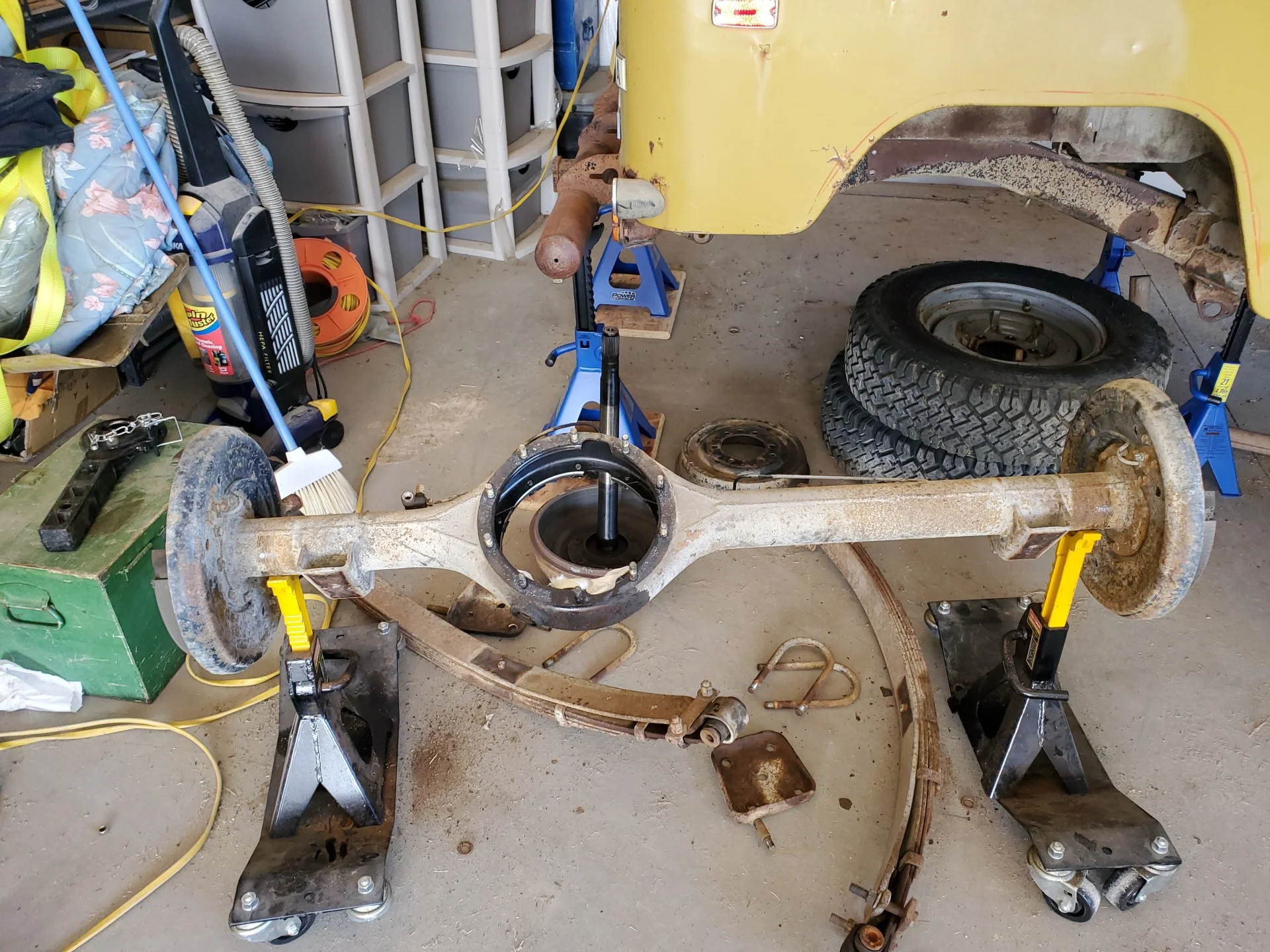

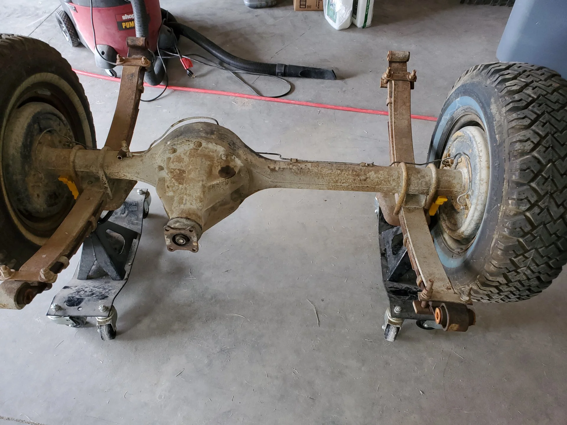

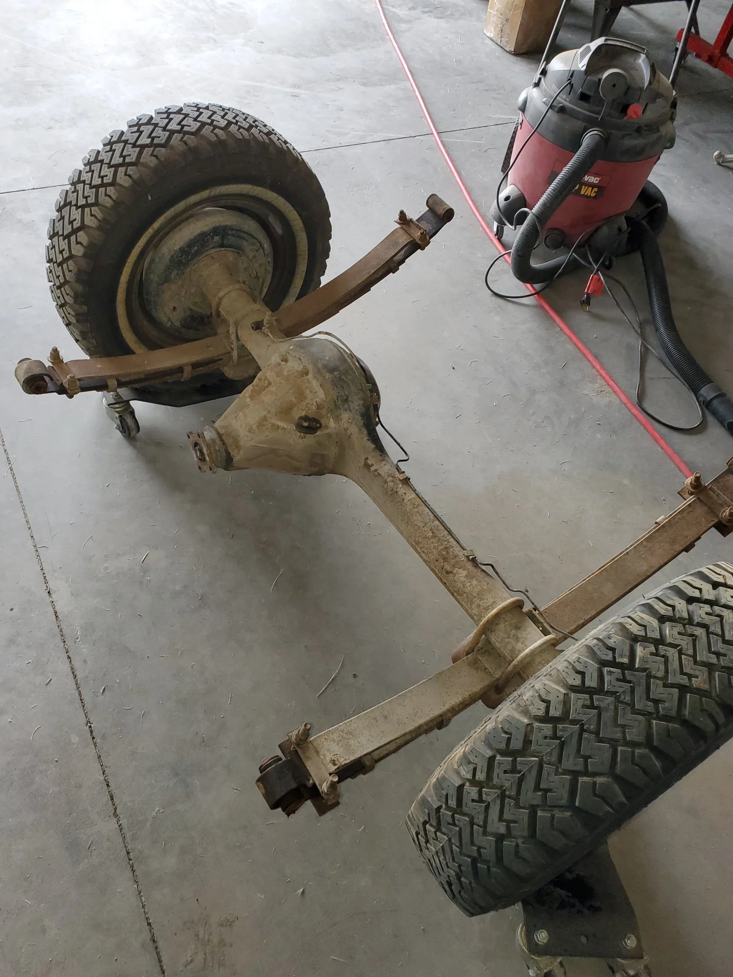

Raised the LC up enough to get the tires to clear the frame and rolled out from under to work on.
Set up on the skates and jack stands for mobility

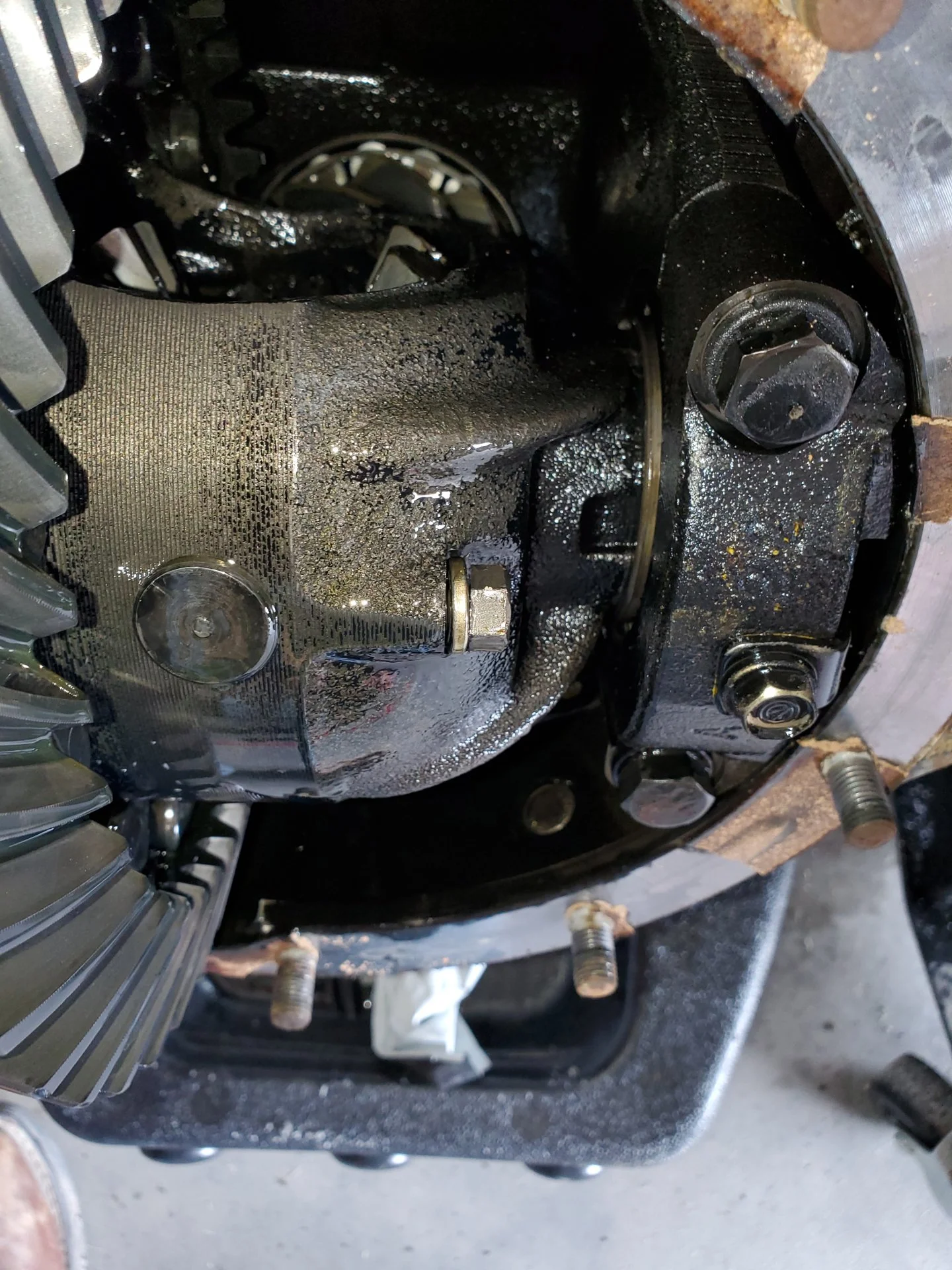

Removed the retaining bolt to get the pin out

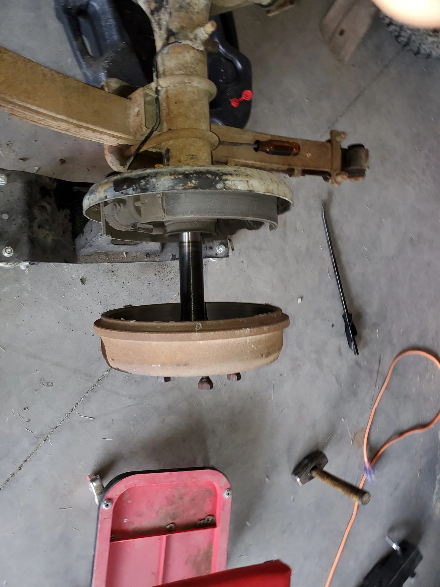

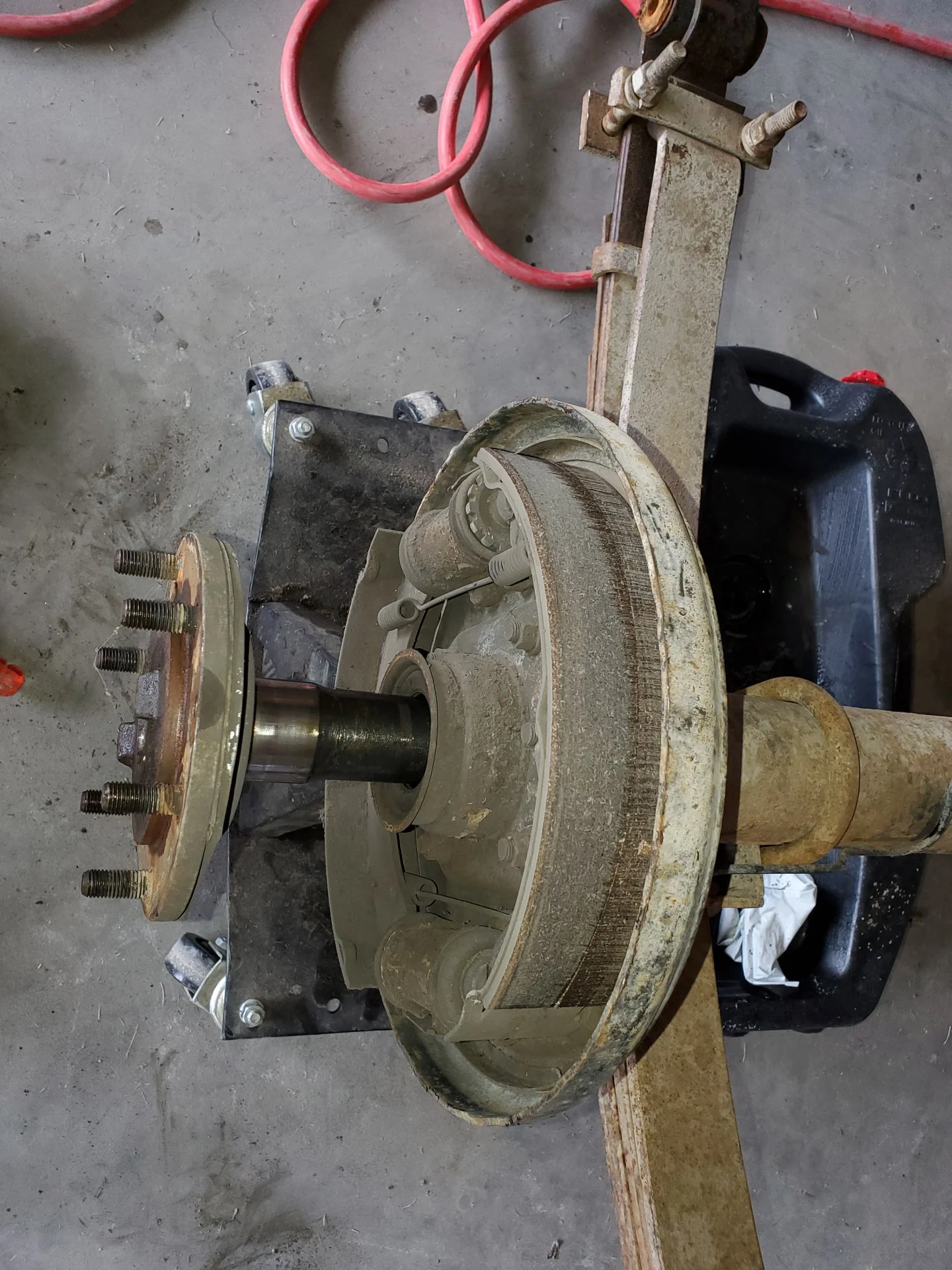

Once the C-clips were removed I had to fight the brake shoes against the drums to remove the shafts. The short side was not quite as tight and was able to beat the drum with a 4lb hammer and rotate and got past the shoes. On the long side, it was tighter and I had to keep pushing the axle and pry the drum out until I could pry on the flange hole. I did try to back off the wheel cylinders, but with much luck. The shoes, cylinders and drums were all original and had not been activated since 1991. I won.
Pulling the short side
Short axle out

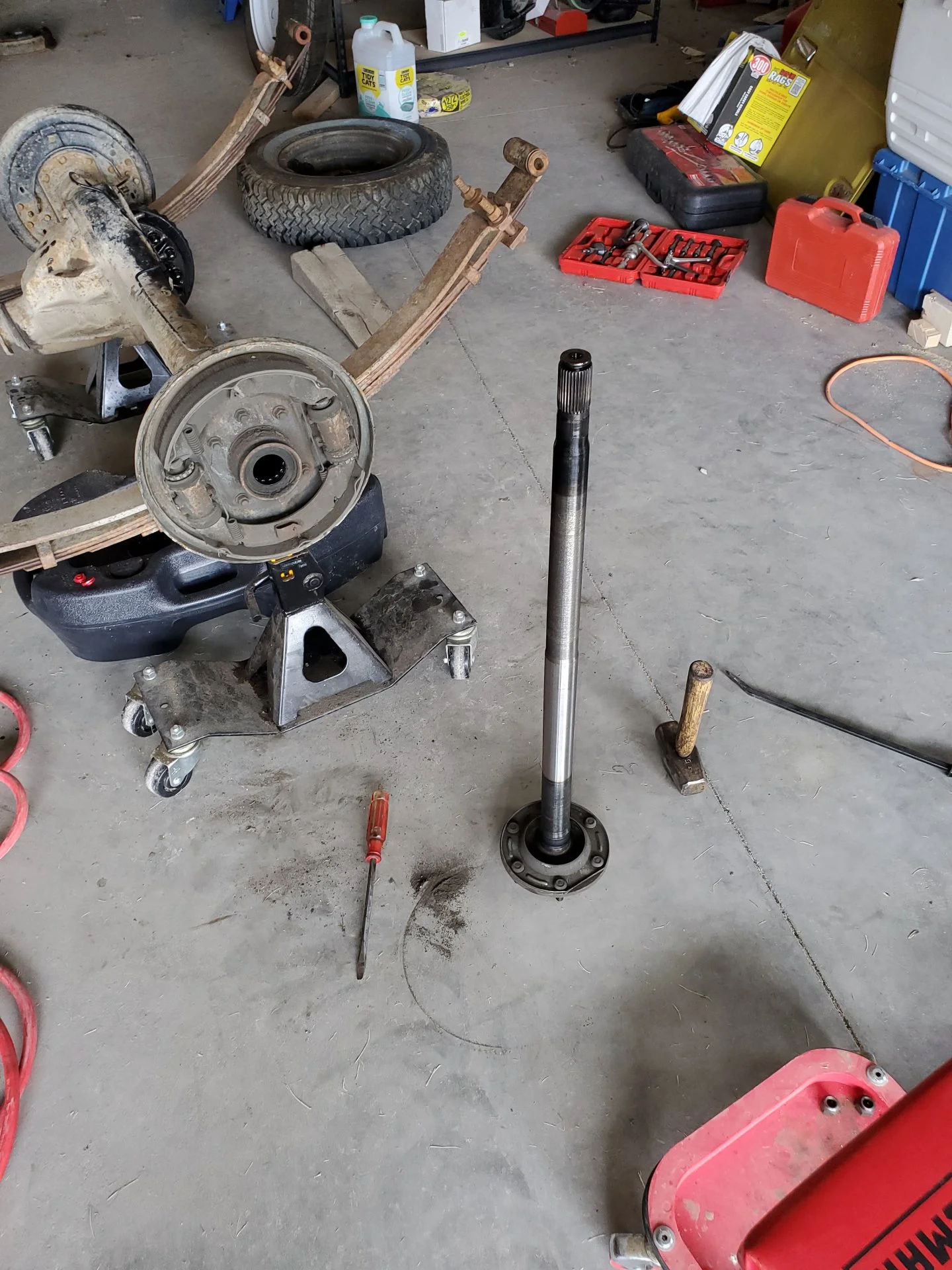

Pulling out the long side
Long axle out

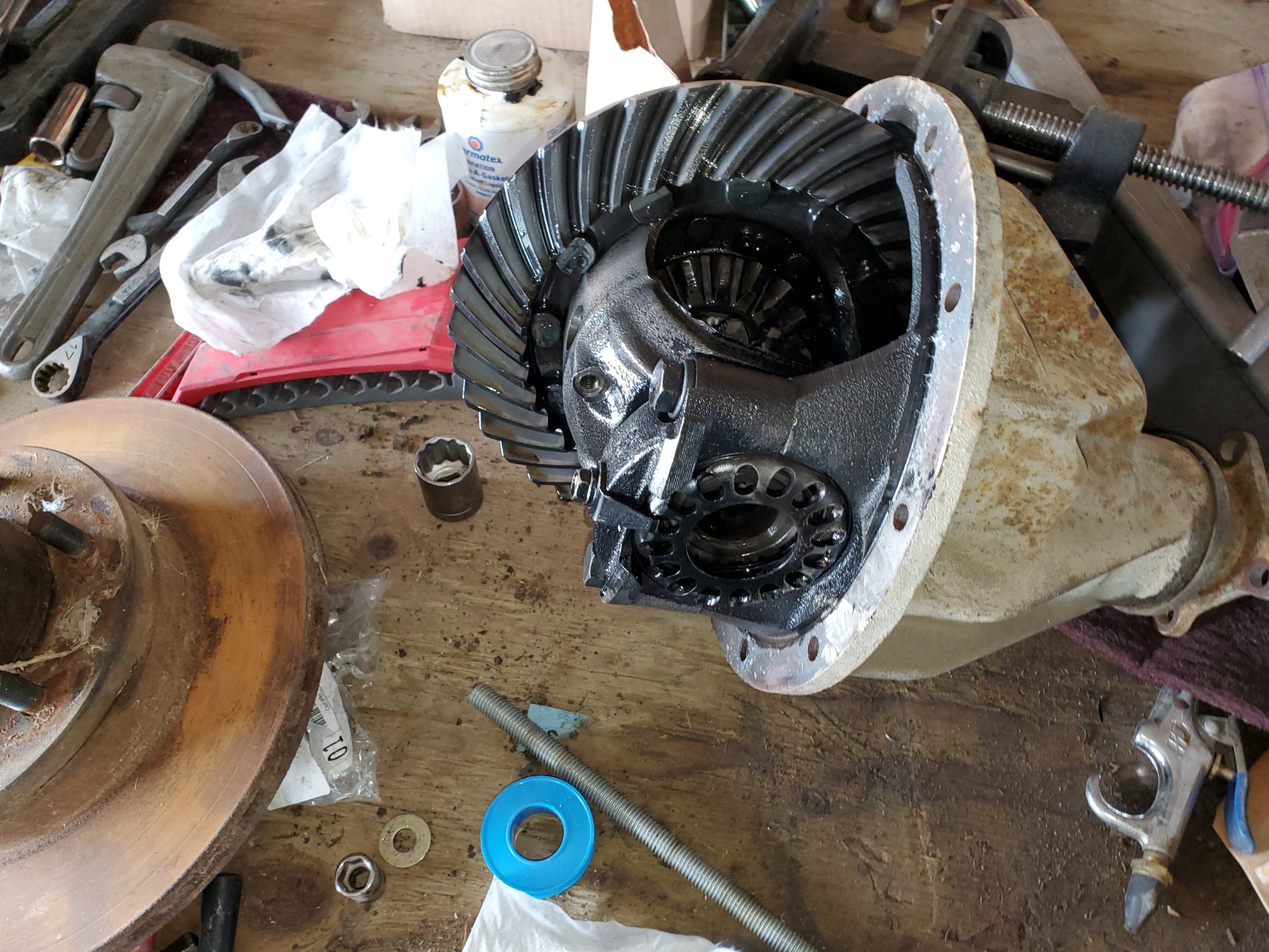

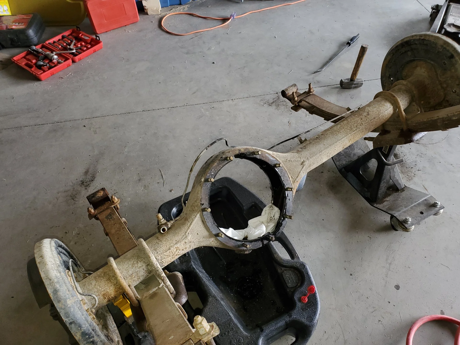

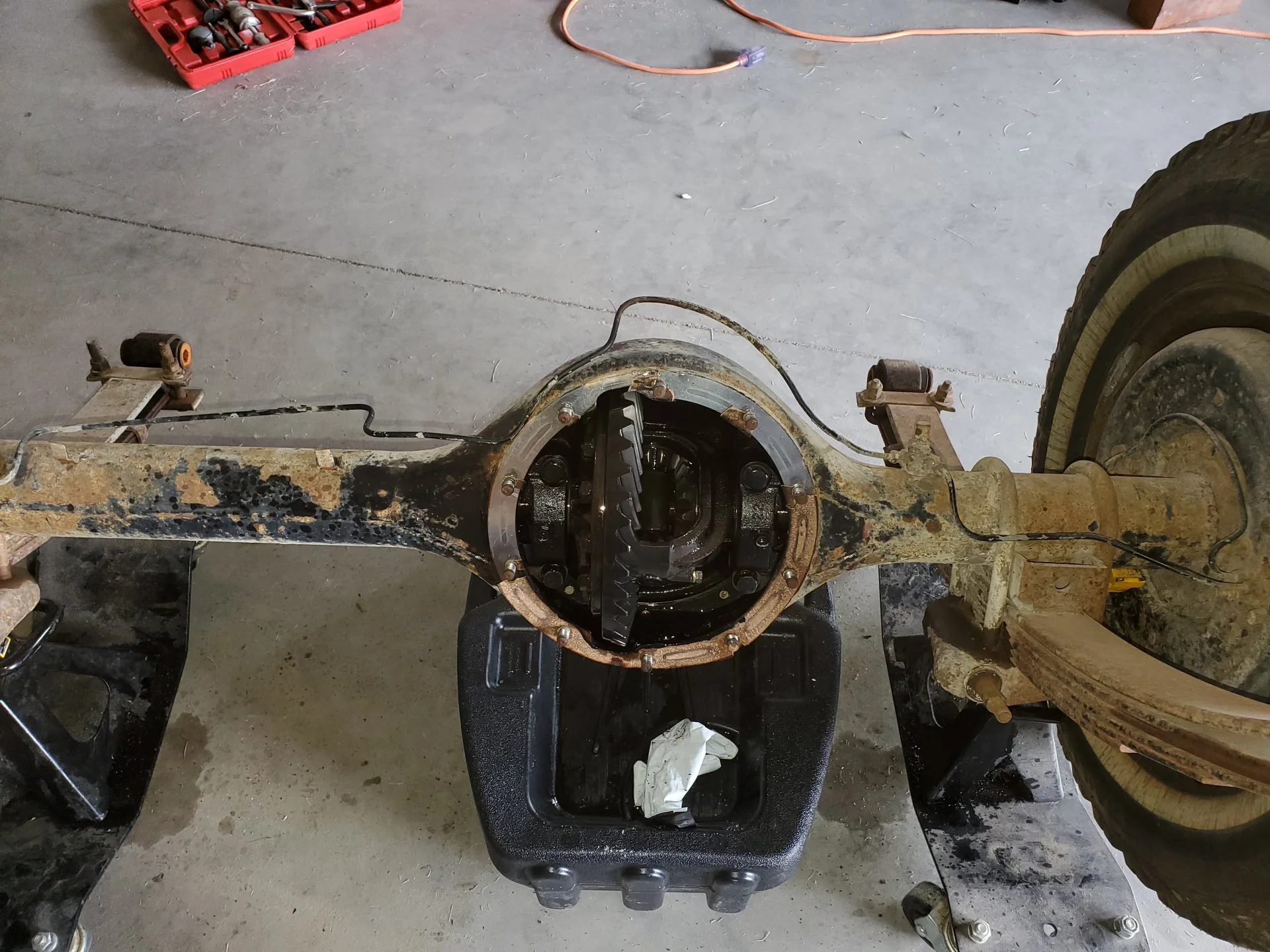

Unbolted the differential and broke the seal and had my Wife come out and use two screwdrivers to help separate from the housing and keep things square so I could lift it off the studs. Very glad I did not try that under the LC.
Housing gutted
Differential on the table

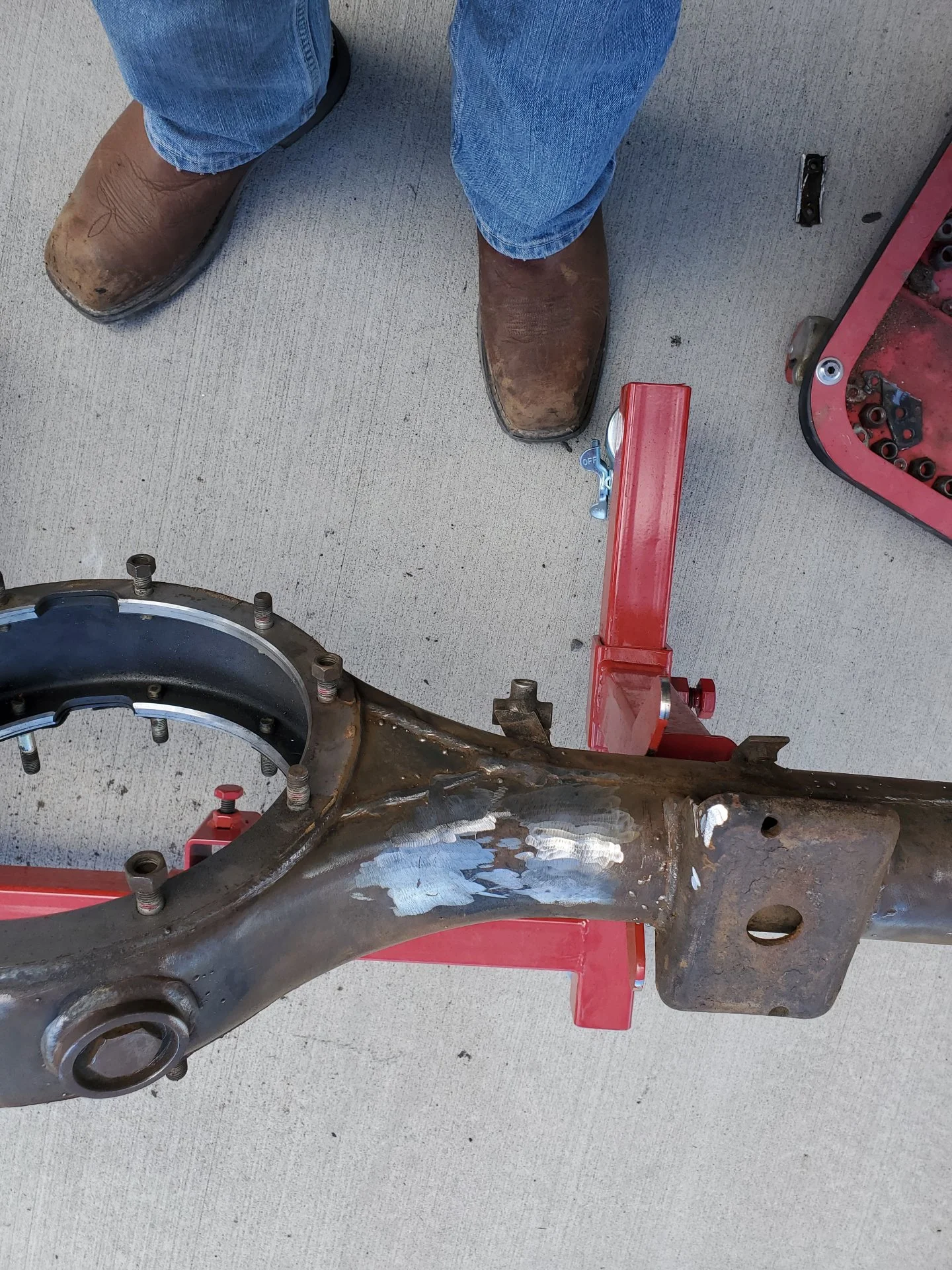

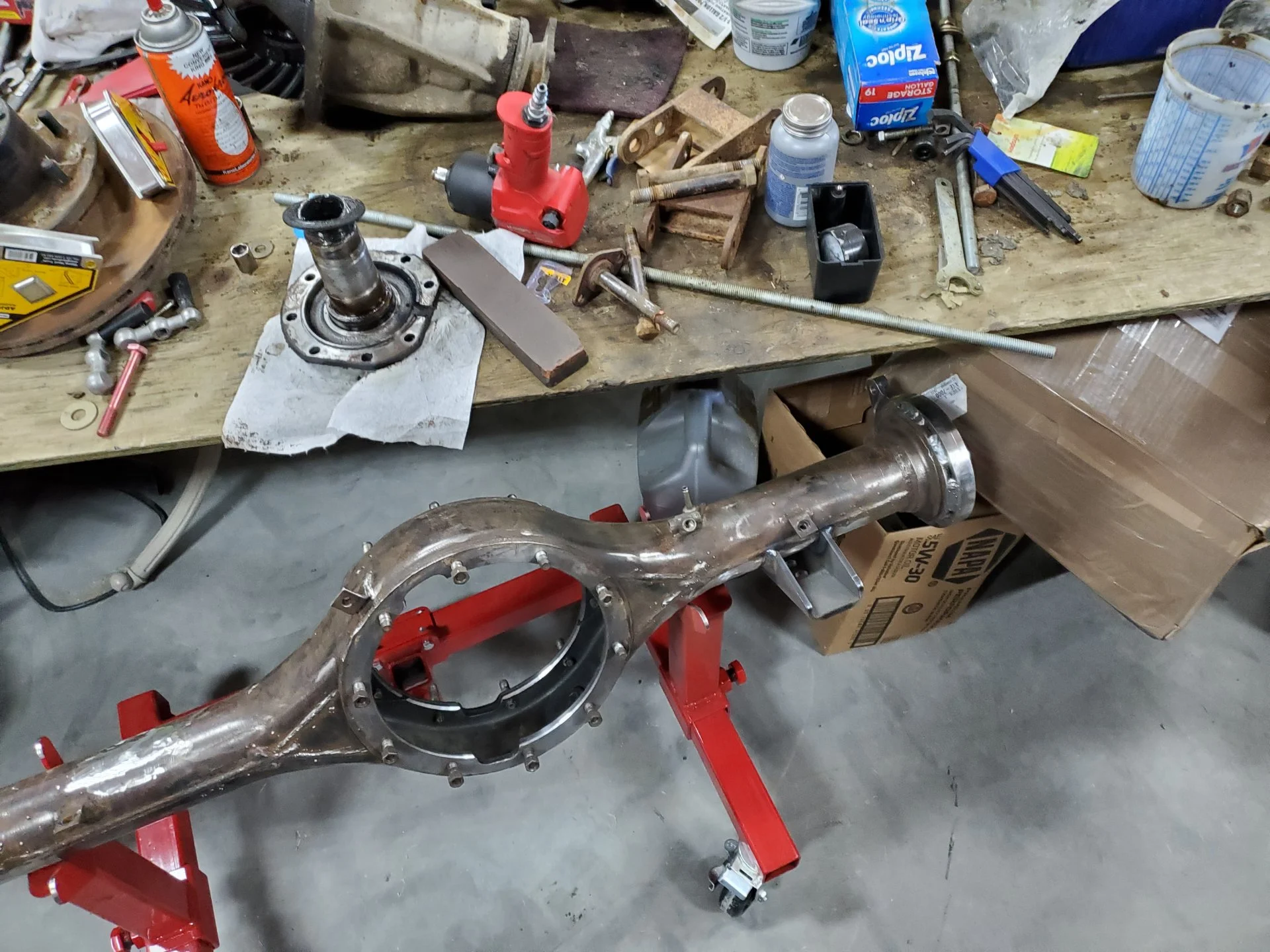

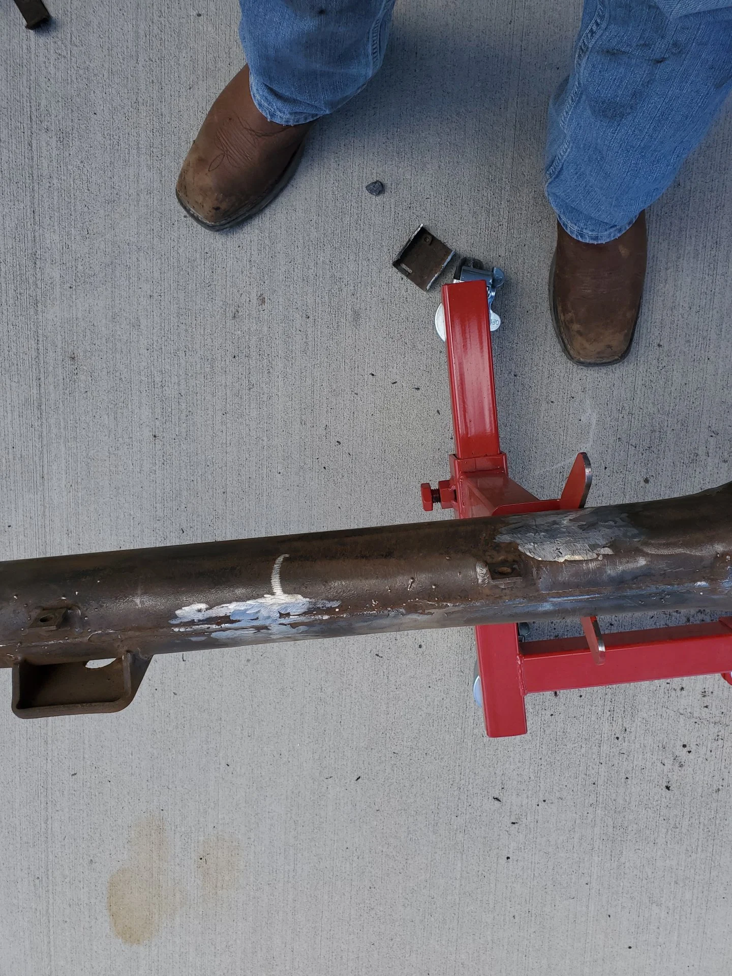

Removal of welded tabs and mounts from the FJ60 axle and ground the welds smooth
My size 12s are in most of the photos

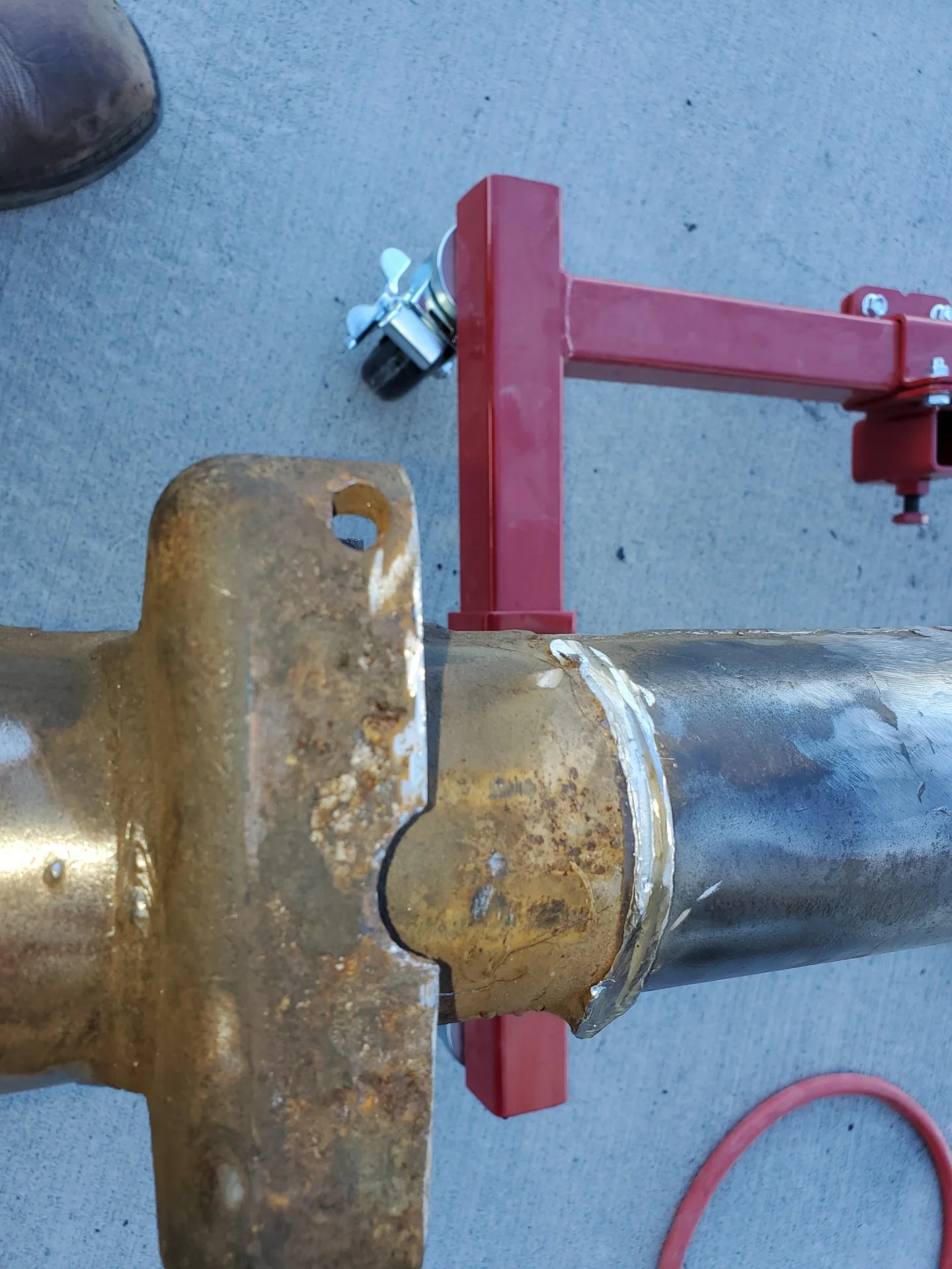

Removing only one perch so that I can use a level on the other perch with a level to get one new perch tacked and level to the old one
Half of perch cut off
The other half of perch removed
Welds ground smooth for the Long side perch

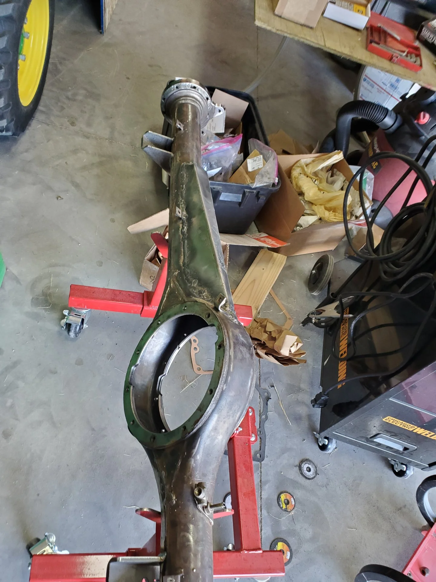

The welding at the shop was completed on the FJ60 axle so it has new perches set at the same distance from the center line of the differential opening and angle as the perches were on the FJ40 axle.
On the way home, I bought a new wire feed welder at Sutherlands with a spool of wire and had to go back for tips because I bought 0.035" wire and it was set up for 0.030".
It was 3 times as expensive as the wire feed I bought from Harbor Freight and hope it last longer and parts are available. I haven't set up a wired since the 90's when I welded on rail cars in Rock Springs, WY but I got the feed pull turned 180 so that the wire was in the 0.035" groove and plugged it in and feed the wire to the gun and installed the right size tip.
New wire feed welder
Perch welded to the short side
New perch welded to the long side

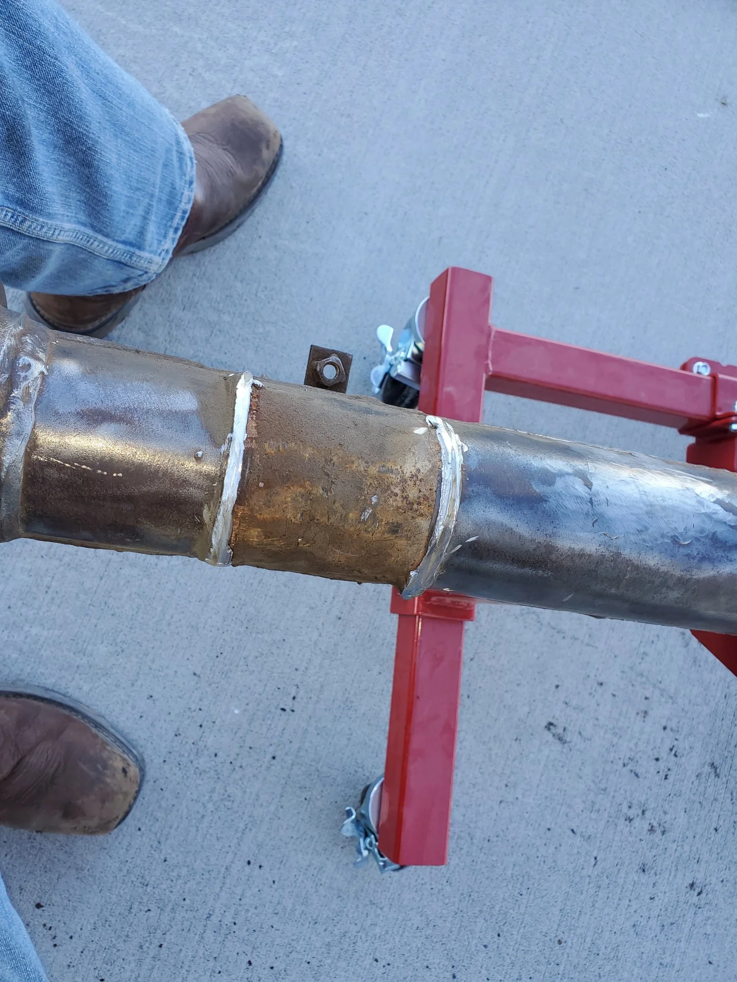

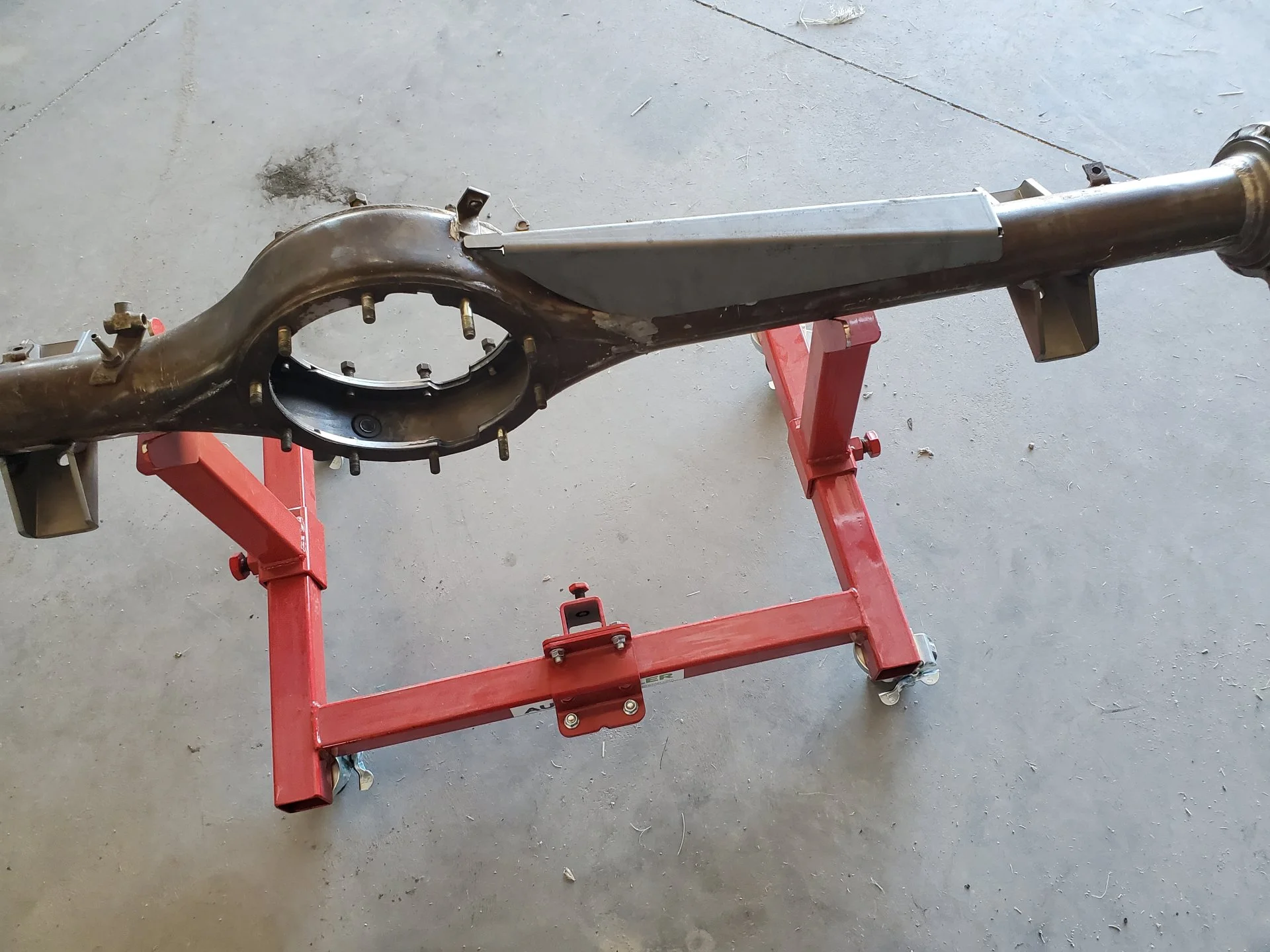

Worked on welding the truss, found out if I try to stitch more than about an inch the truss will blow out so I will have to just make more stitches and did not finish today.

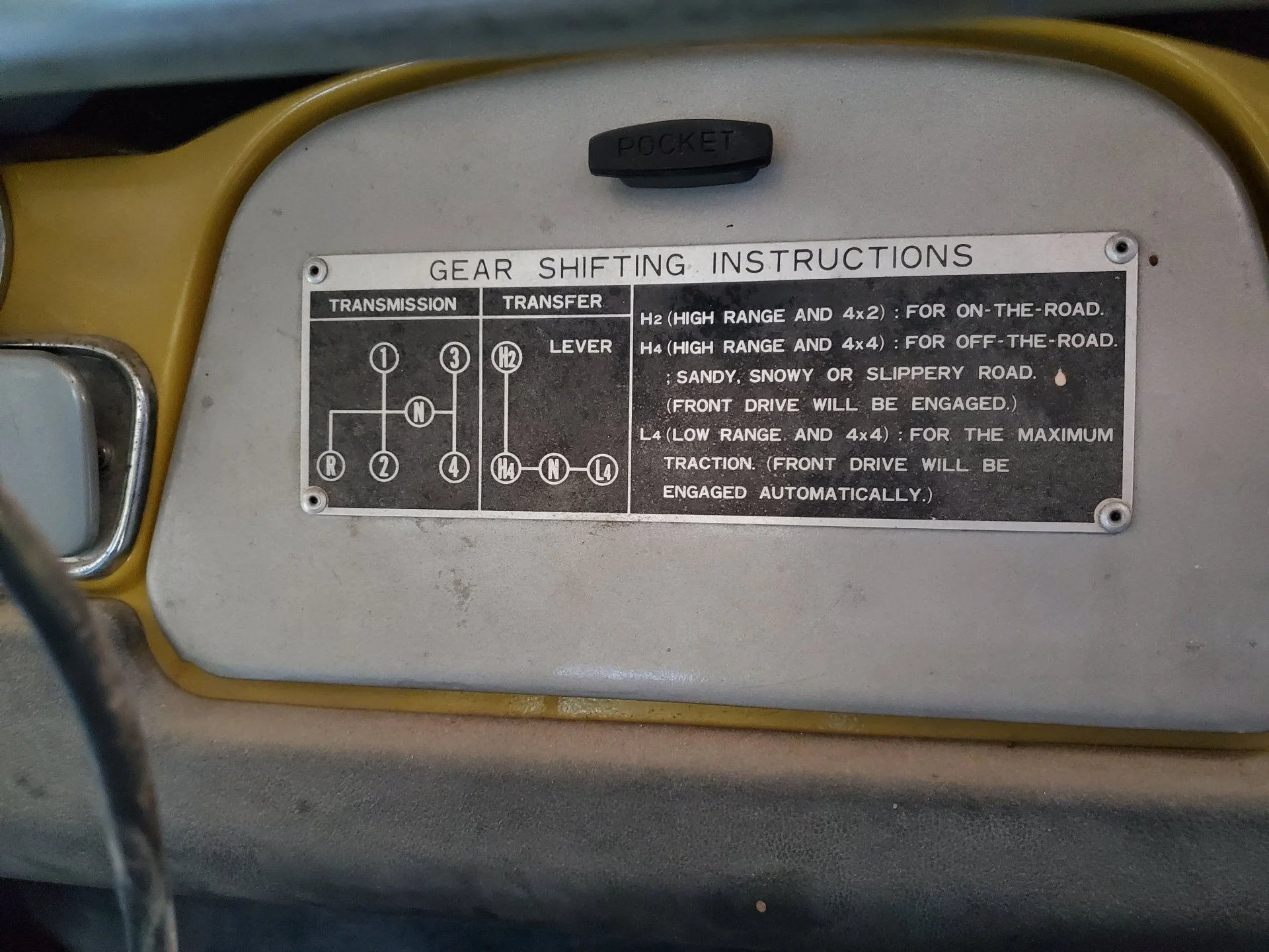

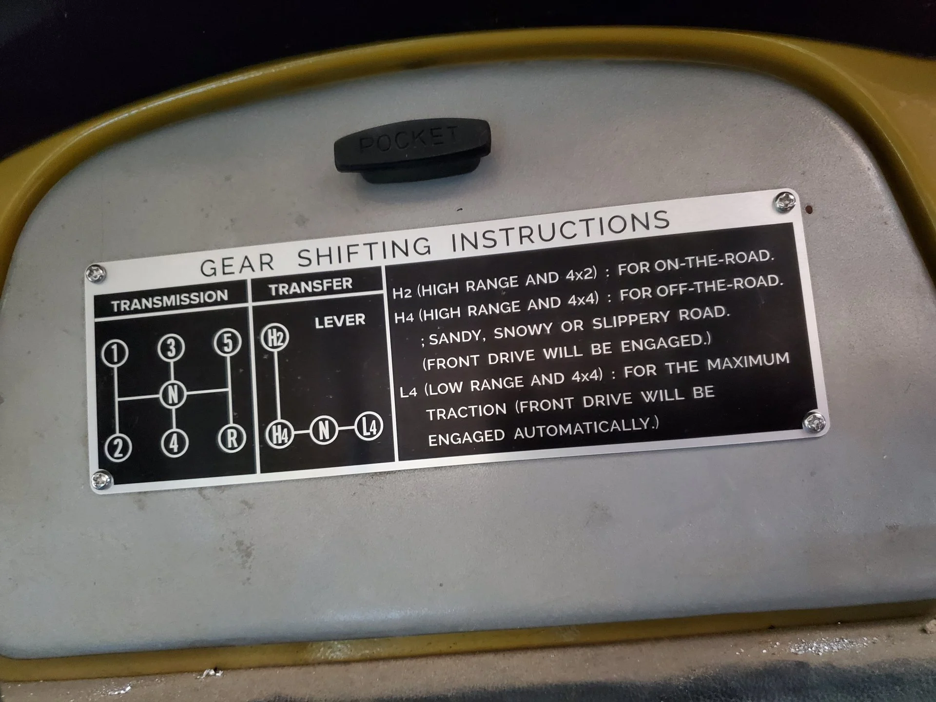

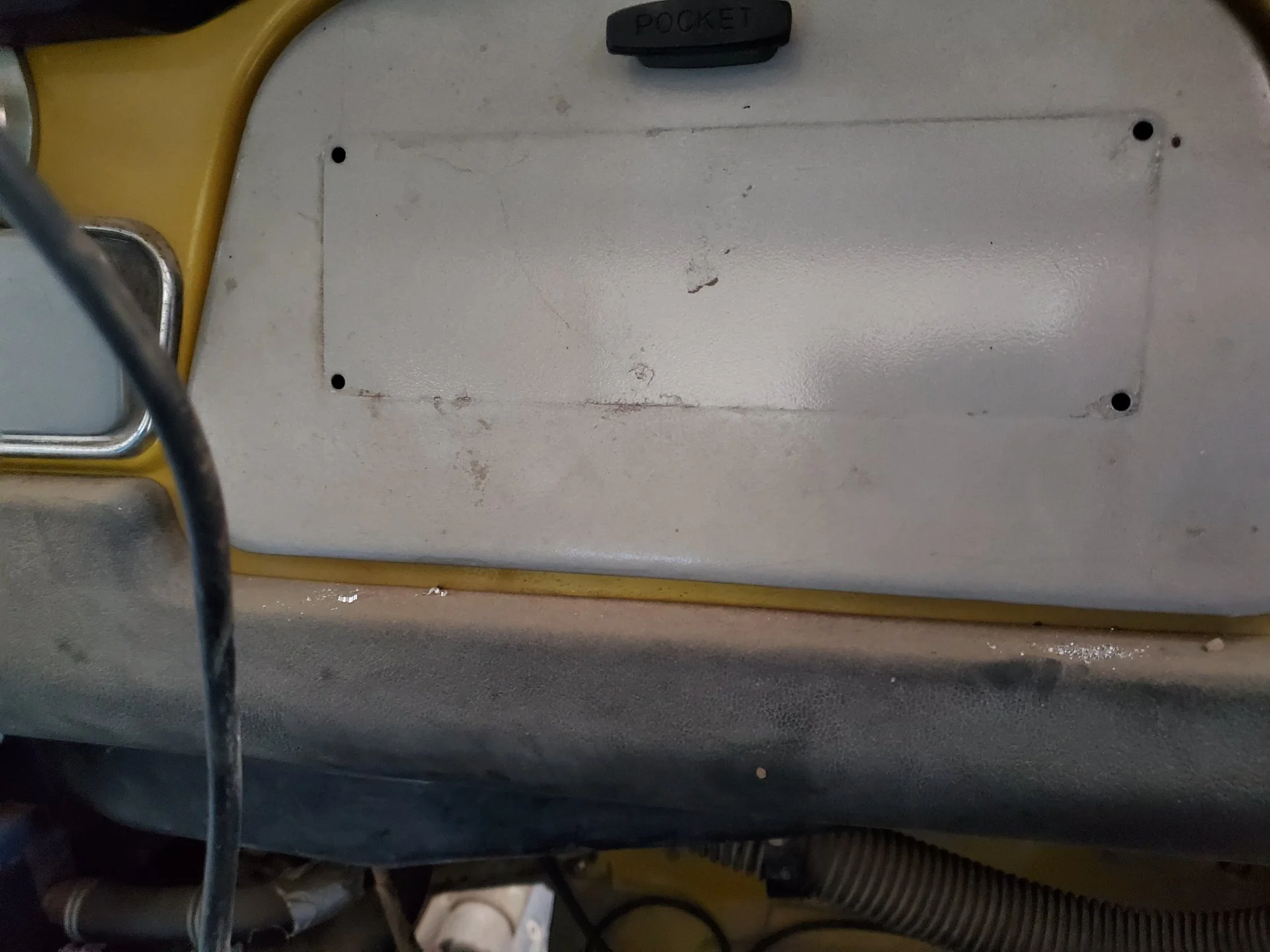

Started the day replacing the gear shifting instruction plate
The rivets were not real tight and when I tried to drill them out they would spin and bent the first bit on the bottom two holes. Used a die grinder to get the top two removed and scuffed the plate a little.
Truss ready to weld
Some welds and found that this length was about all the gauge of the truss could handle before blowing out

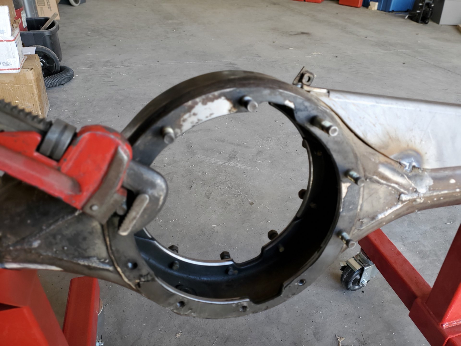

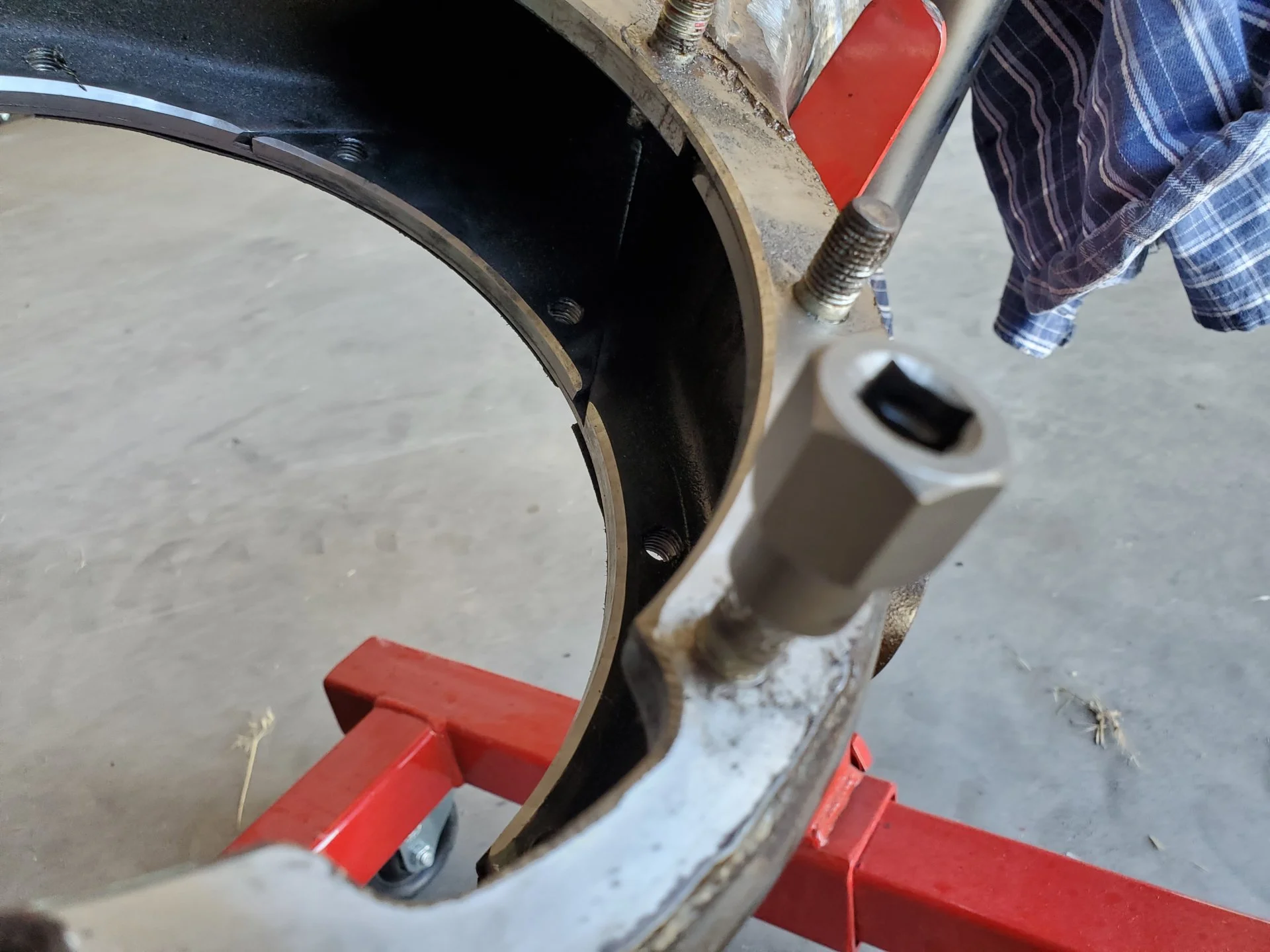

While cooling removed studs for the Differential and the cover, the pipe wrench worked pretty well on the long studs
Got a stud extractor set for the cover studs and it had a size for the hub studs in the set
ON THE COVER SIDE THE PIPE WRENCH WAS NOT WORKING WELL SO BOUGHT A STUD EXTRACTOR.webp

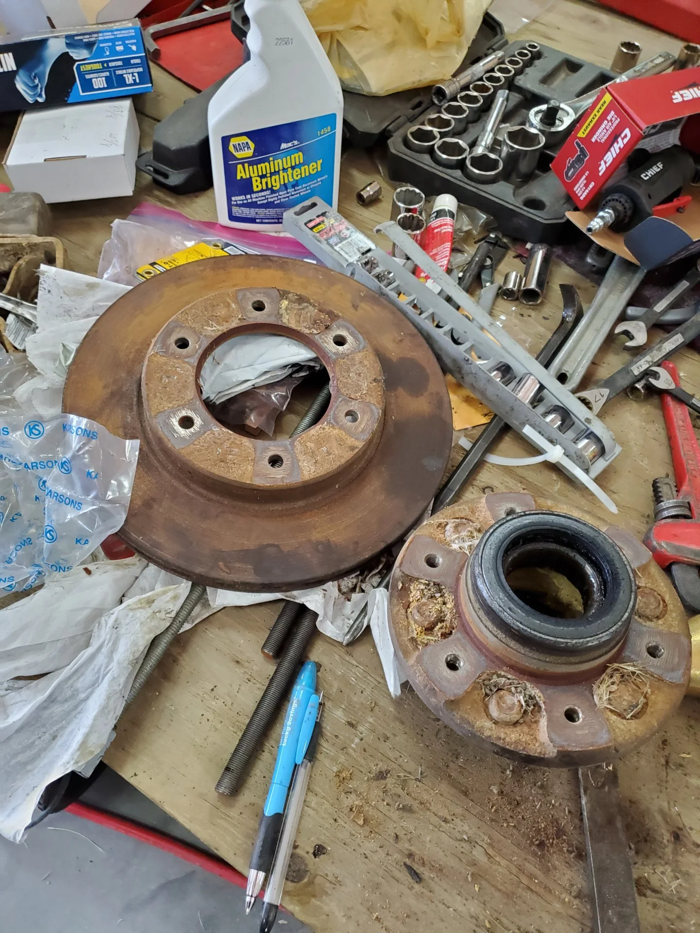

While waiting for the wedding to cool, I was working on the wheel hubs and spindles. I cleaned the old spindles that will go back on the front axle and put away for later.
Removed the bolts from the first rotor

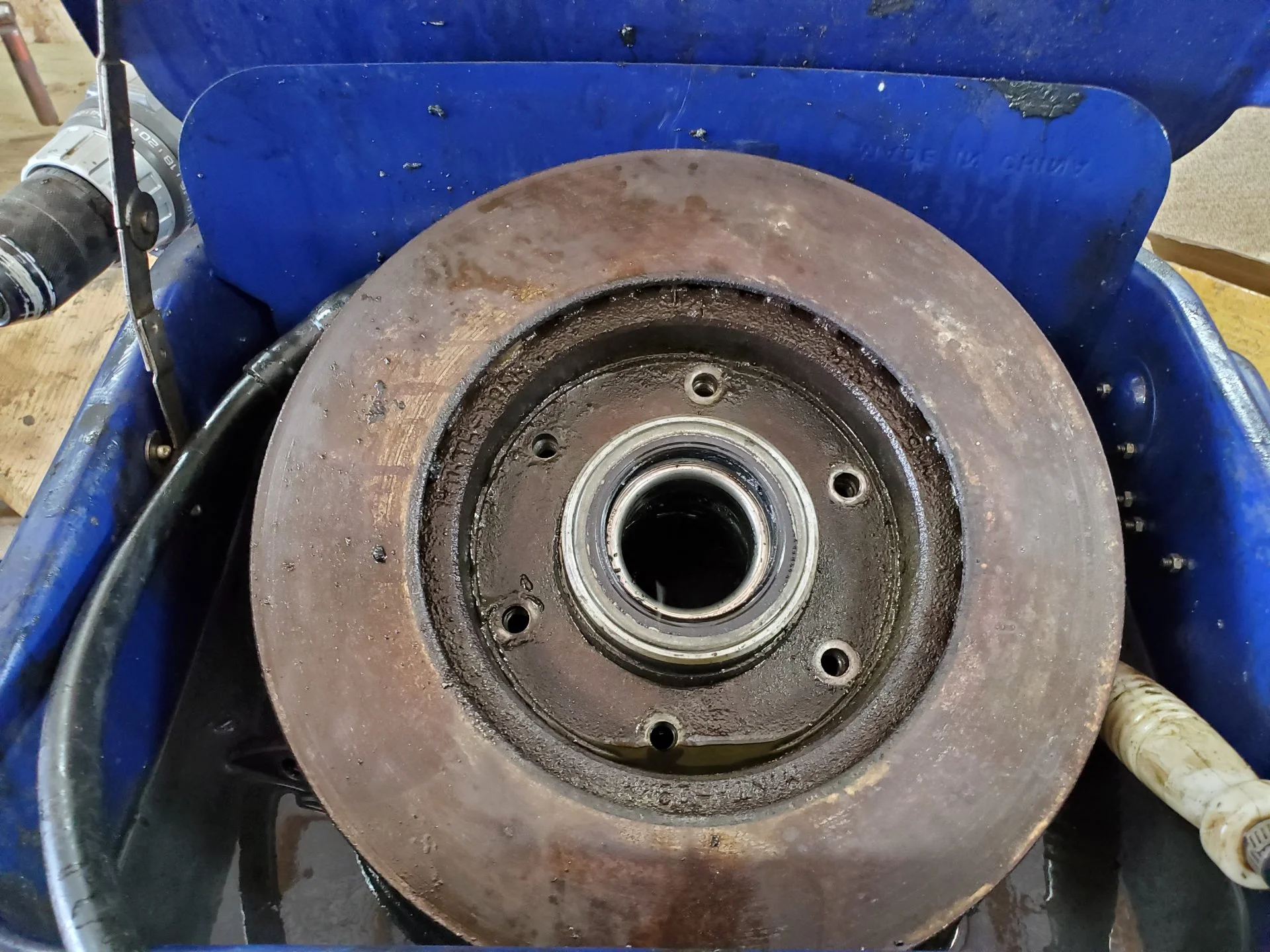

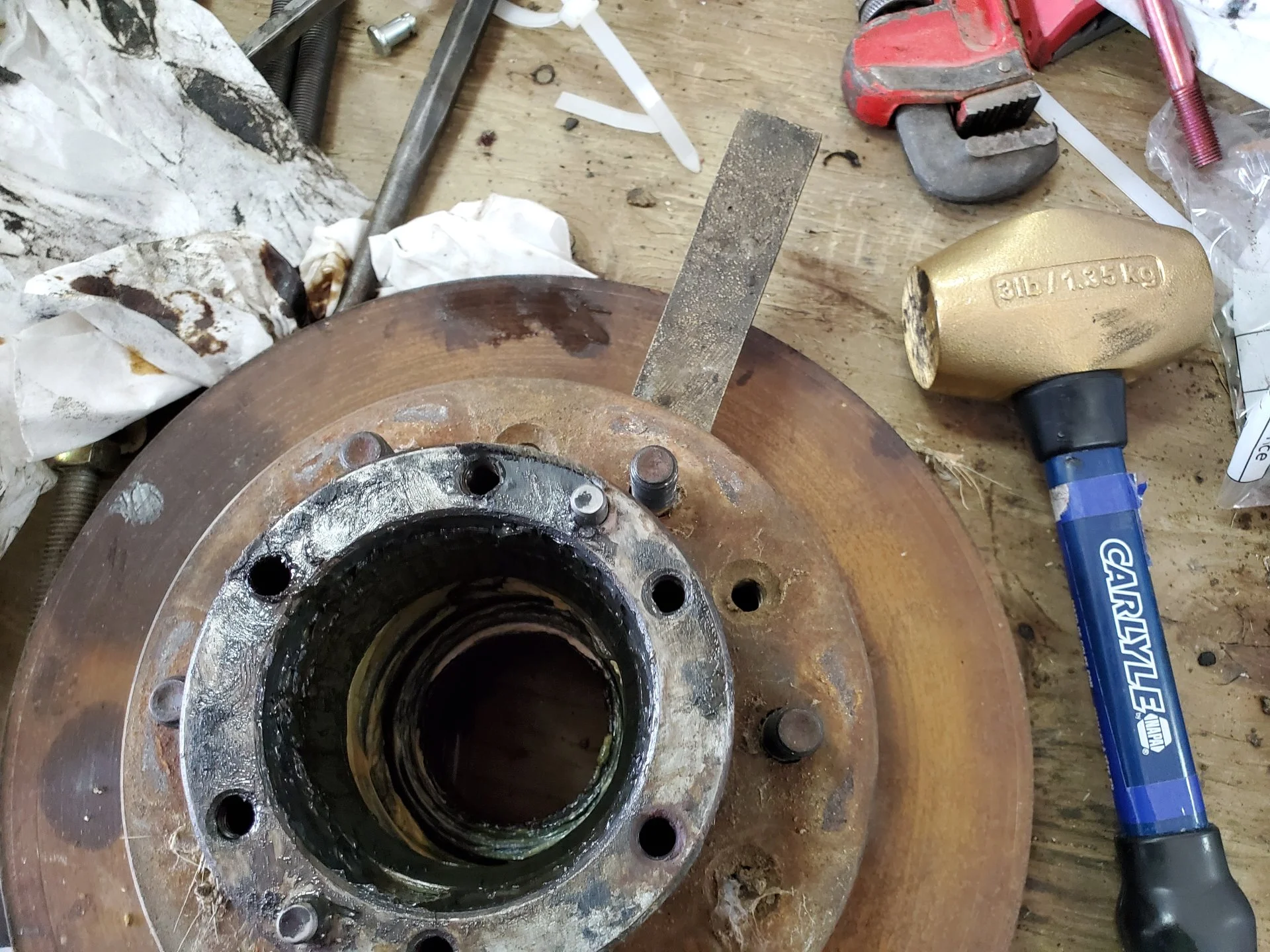

Used a brass hammer and wedge to separate the rotors from the wheel hubs and worked very well for being attached for 47 years
First one separated

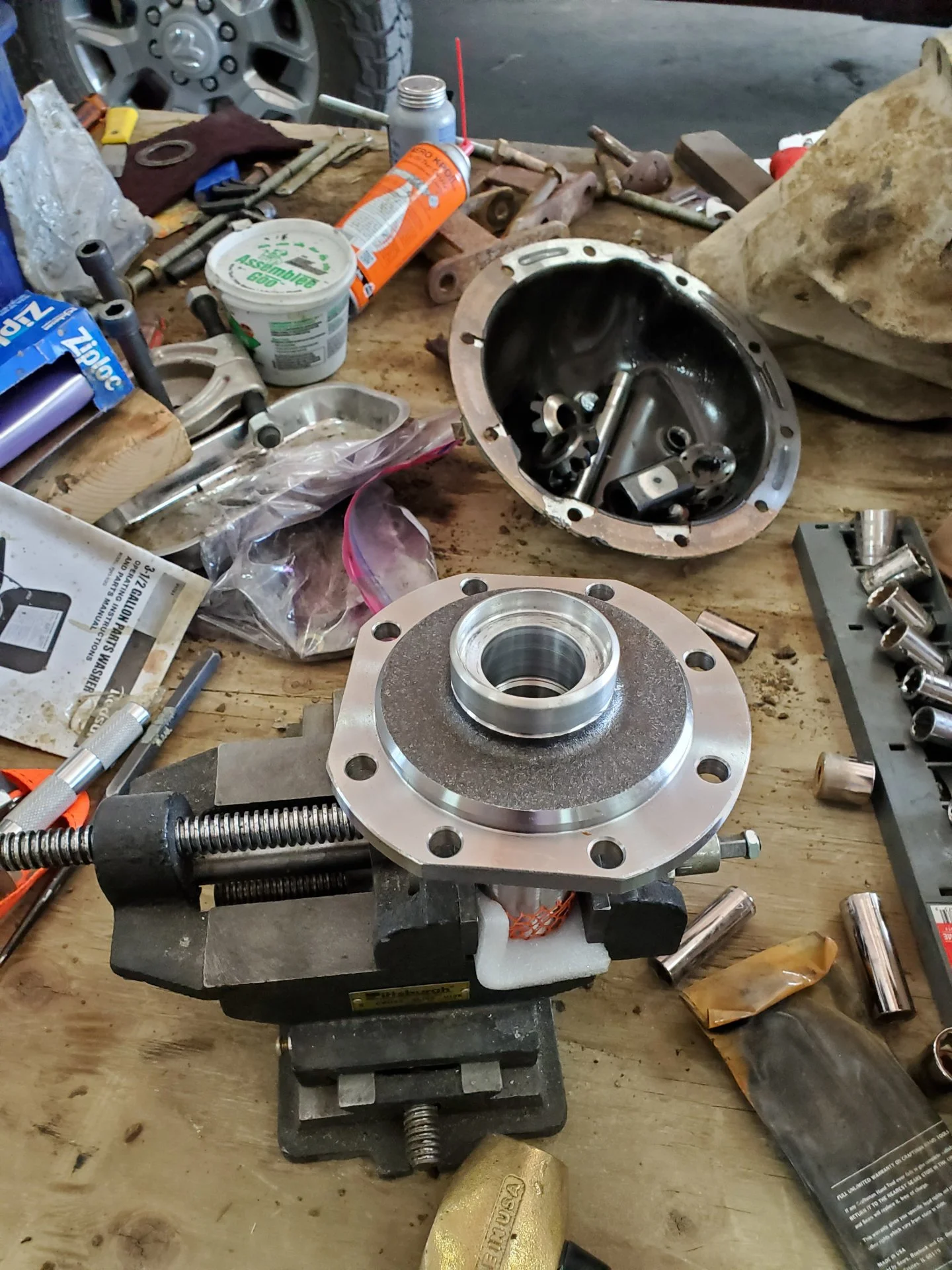

Installed the seal holders in the new spindles
First seal holder
Second seal holder

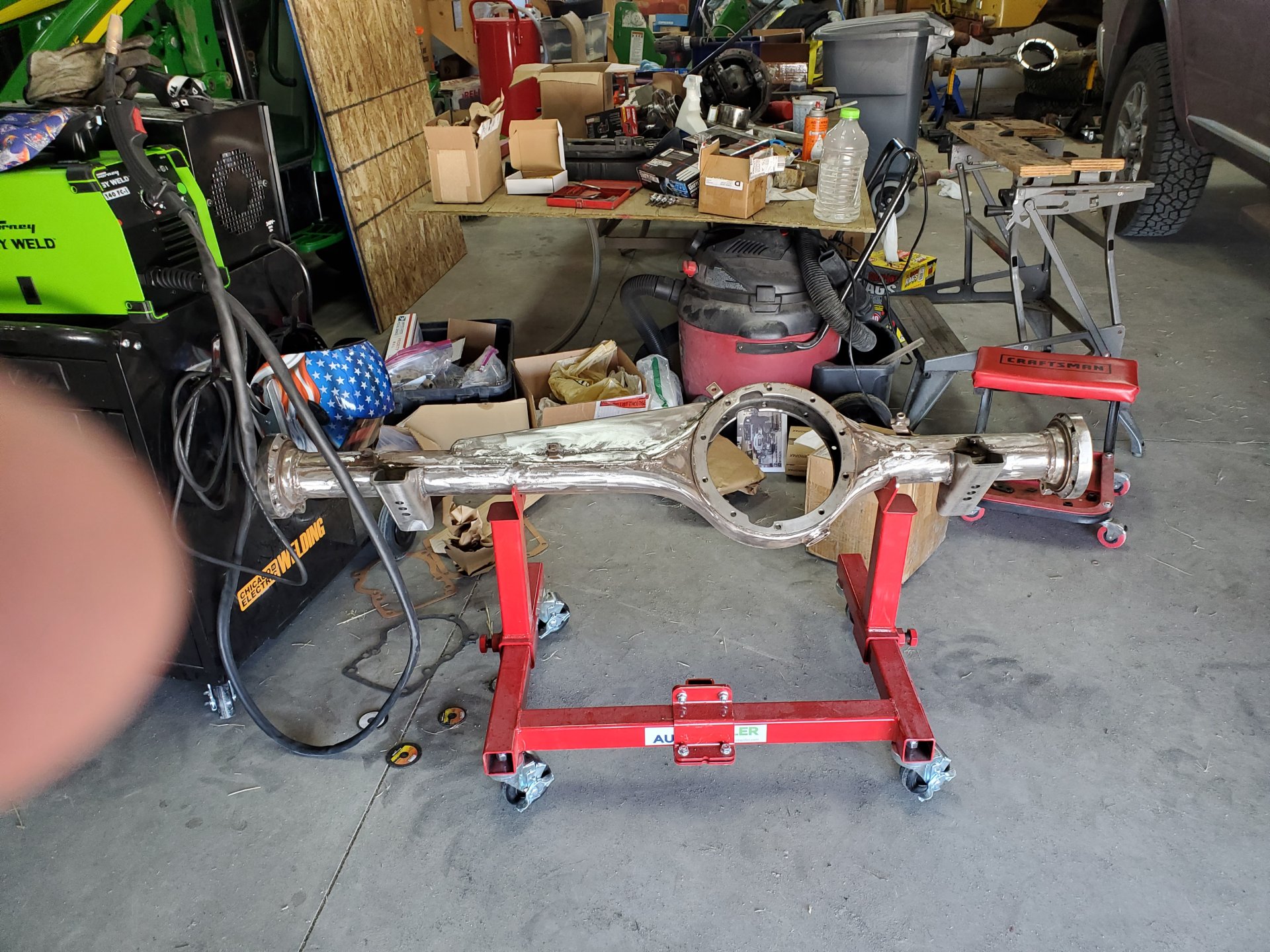

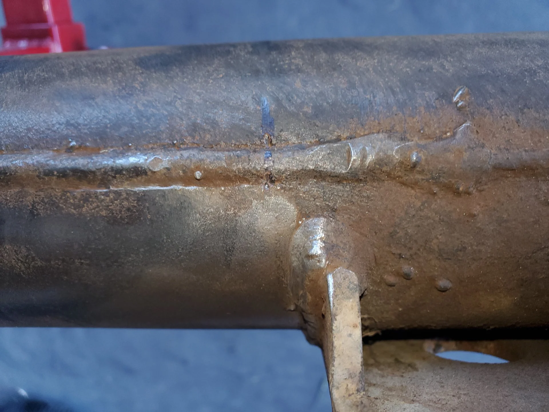

Completed welding the truss to the axle then will clean up with the grinder for paint. I was never good at stopping a weld or tying in ether, but was able to backfill any holes in the truss I blew out. Today there were a lot less.

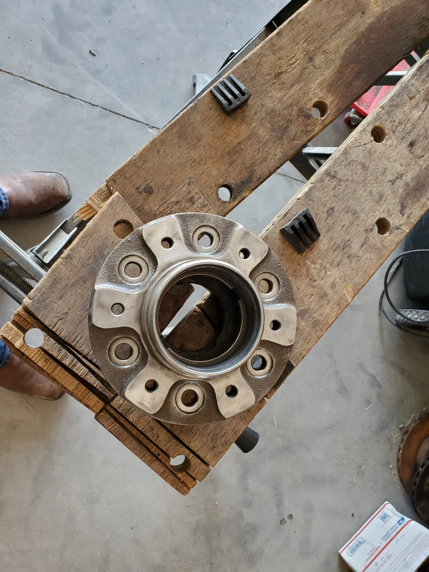

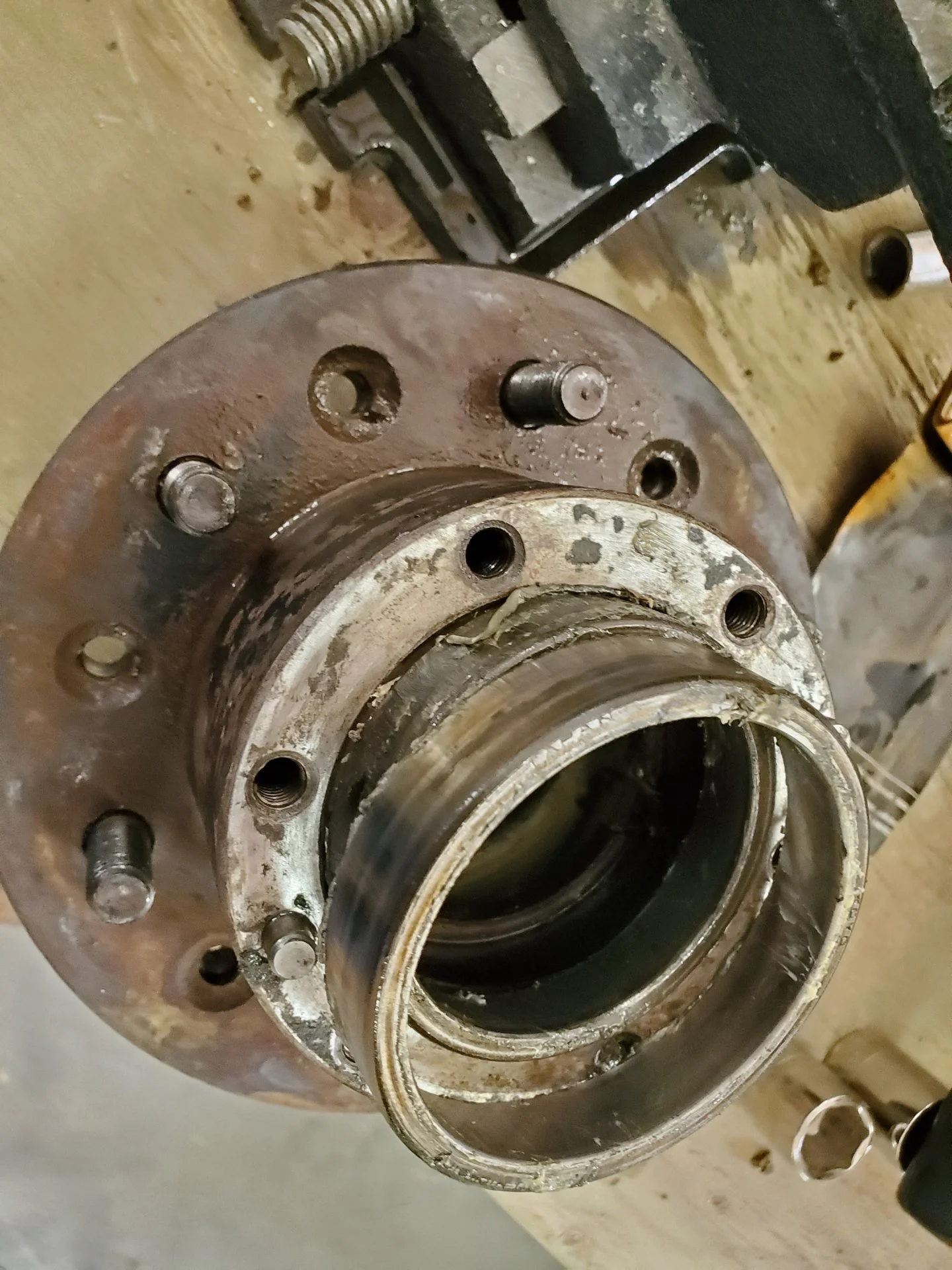

Cleaned up the wheel hubs with a wire wheel and a die grinder and flapper wheel. I also had to use a burr bit to clean up the race bores from knocking them out with a steel punch and I also got the bore knocking out a inner seal.

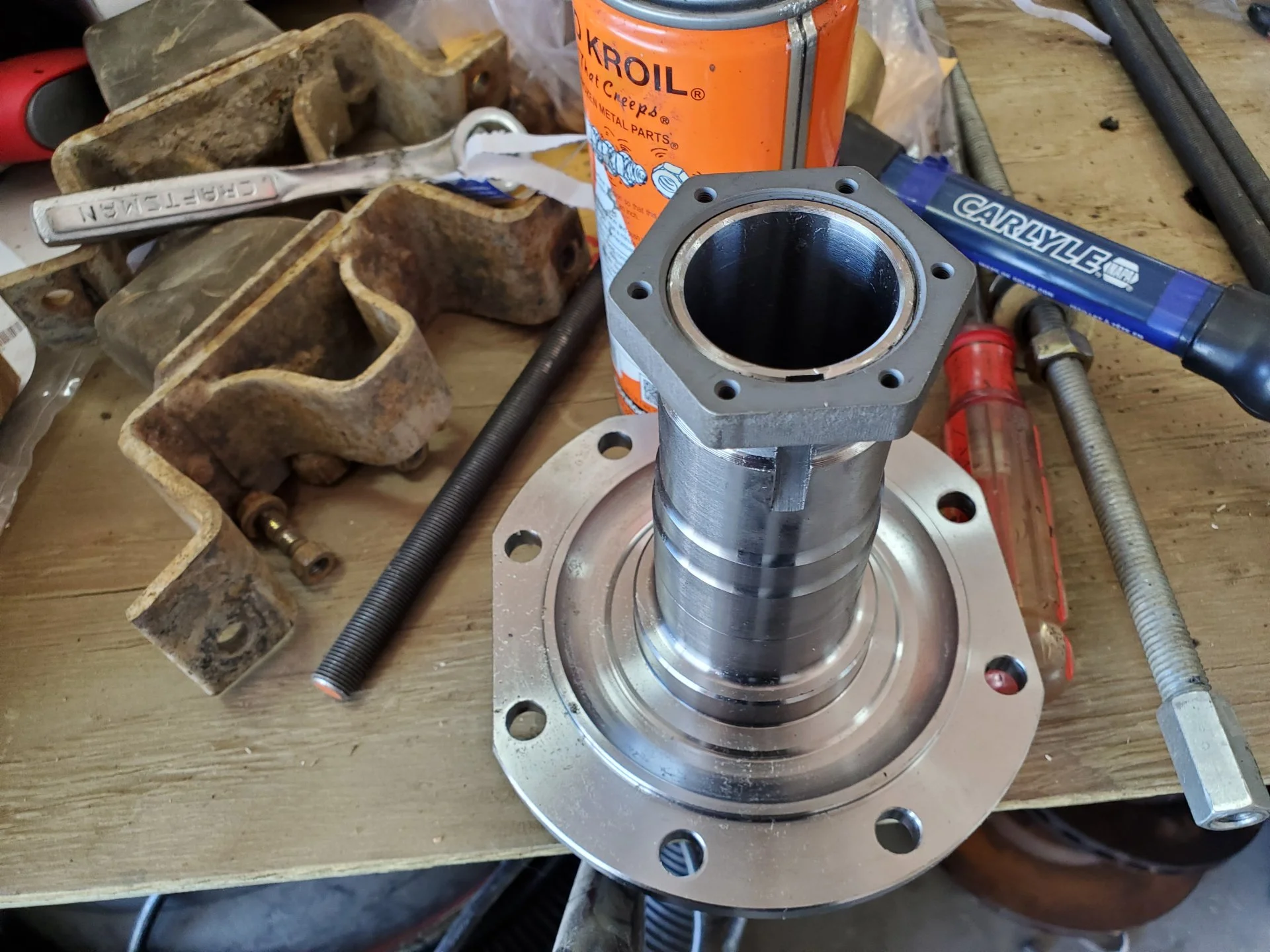

After installing the seal holders in the new spindles the threads needed attention with a 1.5mm thread file so that the new nuts would thread on. I left the nuts on to protect the start of the threads until I can install.
CHASED THE TREADS ON BOTH NEW SPINDLES UNTILL THE NEW NUTS THREAD ON BY HAND.webp

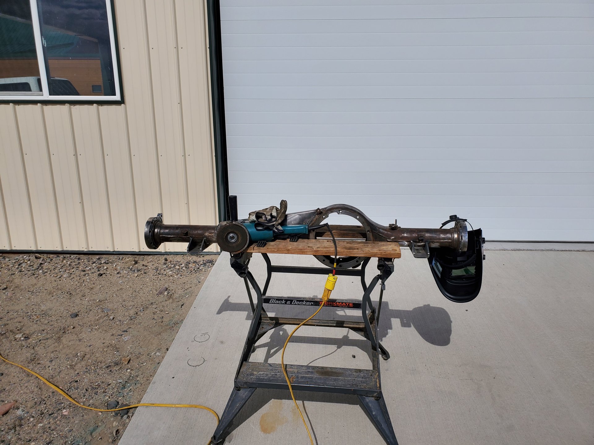

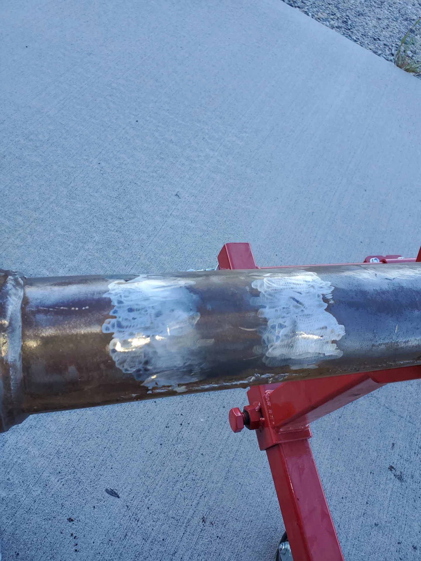

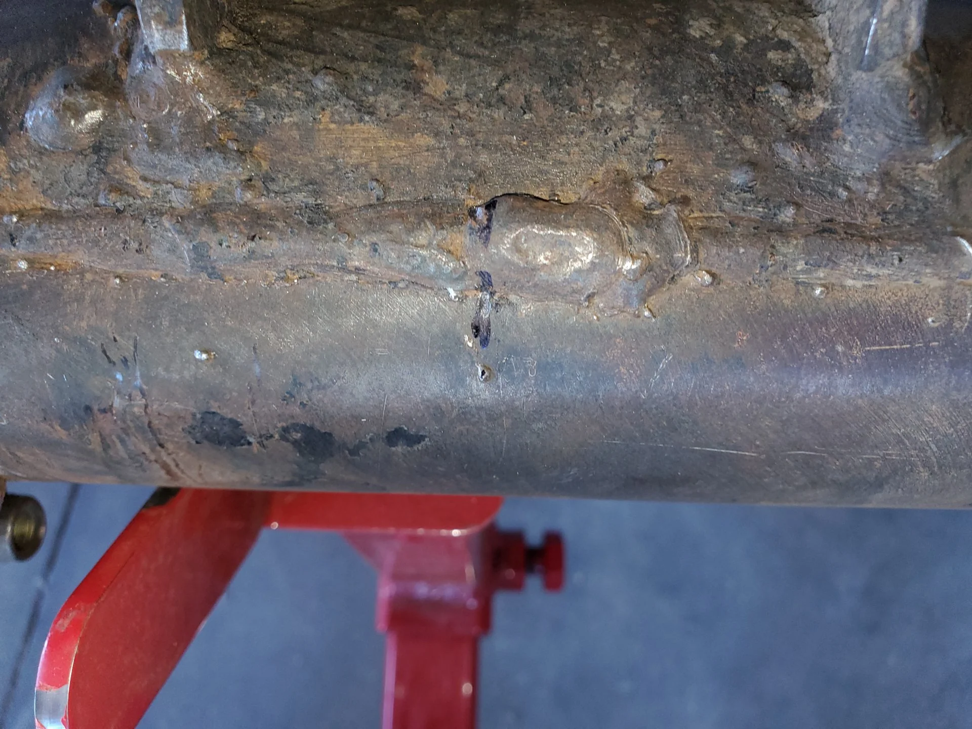

Did some grinding of the welds and did some touch welding fill in some holes. I also found the lens controls and reduced the shade level so I could see where the puddle was going I was only seeing it on the truss and listening for the sound change as I crossed the gap to the axle tube
Grinding
Results after cleaning with a 4-1/2 inch cat's paw
AXLE HOUSING AFTER CLEANING WITH A CATS PAW AND SOME GRINDING OF THE WELDS.webp

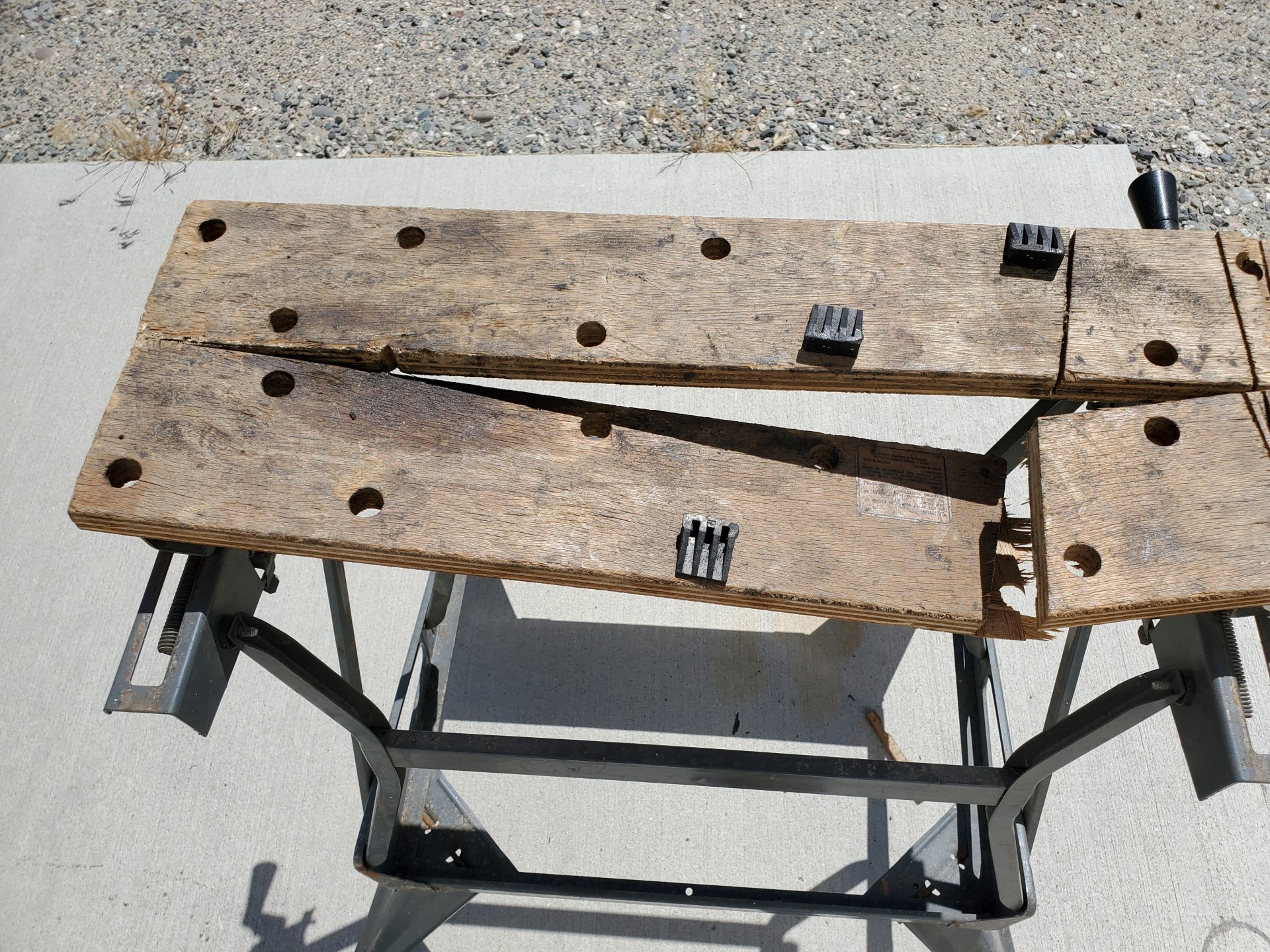

My Workmate finally broke from the cut lines from when Dad was helping me roof my house in the 90s, will have to cut some more wood for the tabletop.
WORK MATE FINALY BROKE AFTER DAD KEPT CUTTING SLATS FOR MY ROOF YEARS AGO.webp
So besides rebuilding the 40 you're going to be rebuilding the Workmate. :)
Yep, seems pretty handy for working with sub assemblies.

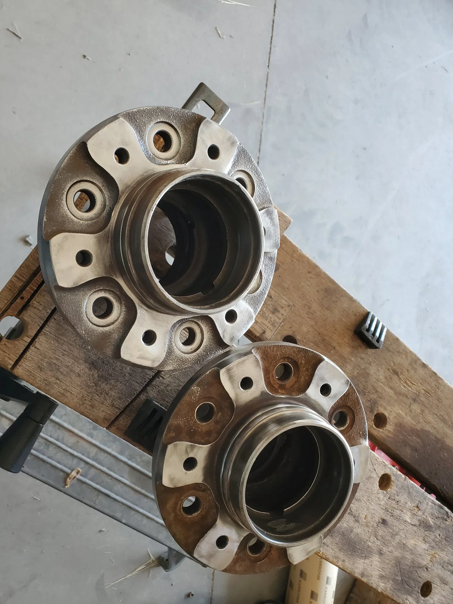

Dropped off the rear differential for cleaning before paining and installing the LockRight, then picked two small wire brushes for cleaning the wheel hubs.
Cleaned and dressed the wheel hubs, there were some raised metal on the mating face with the rotors.

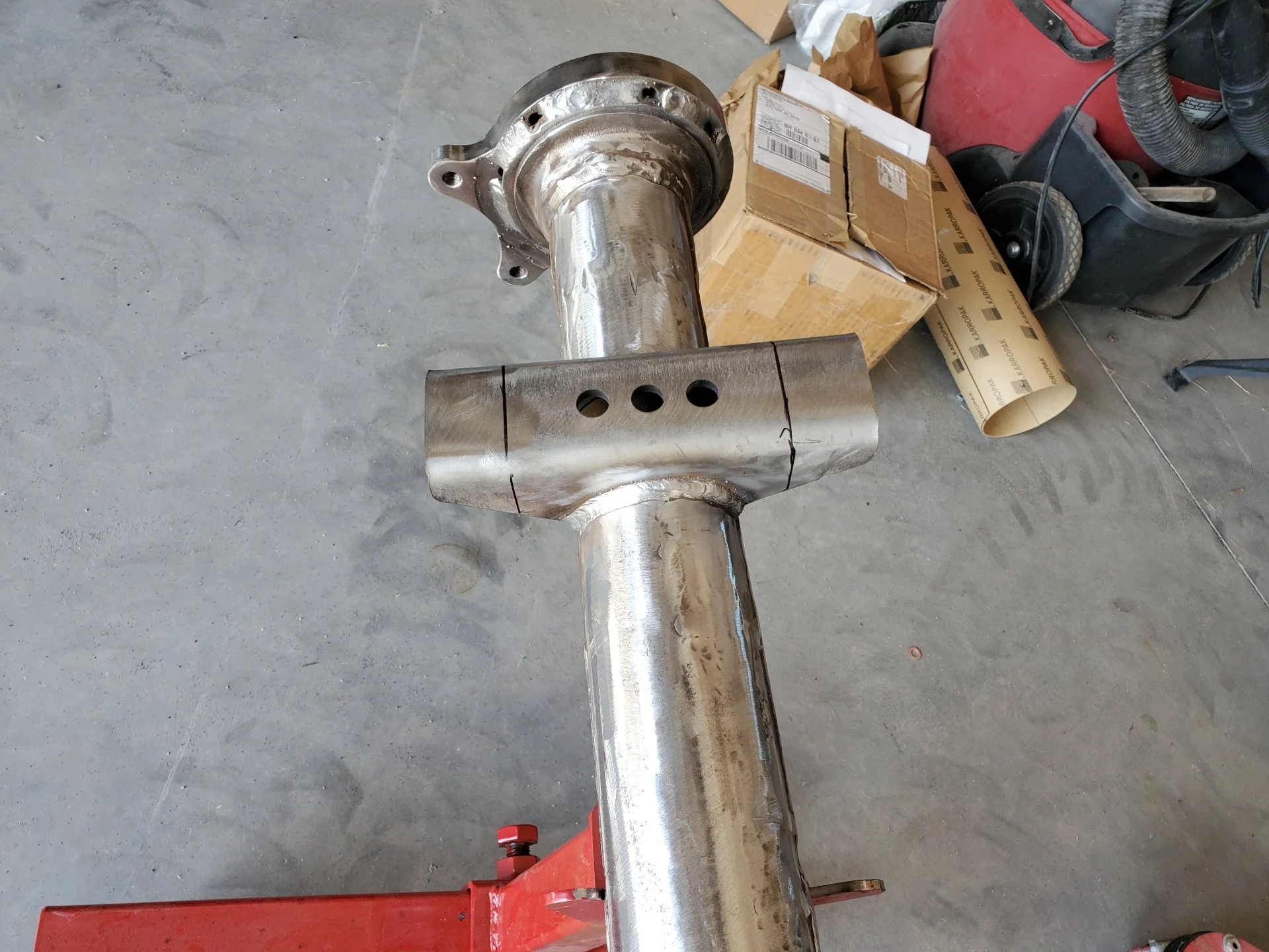

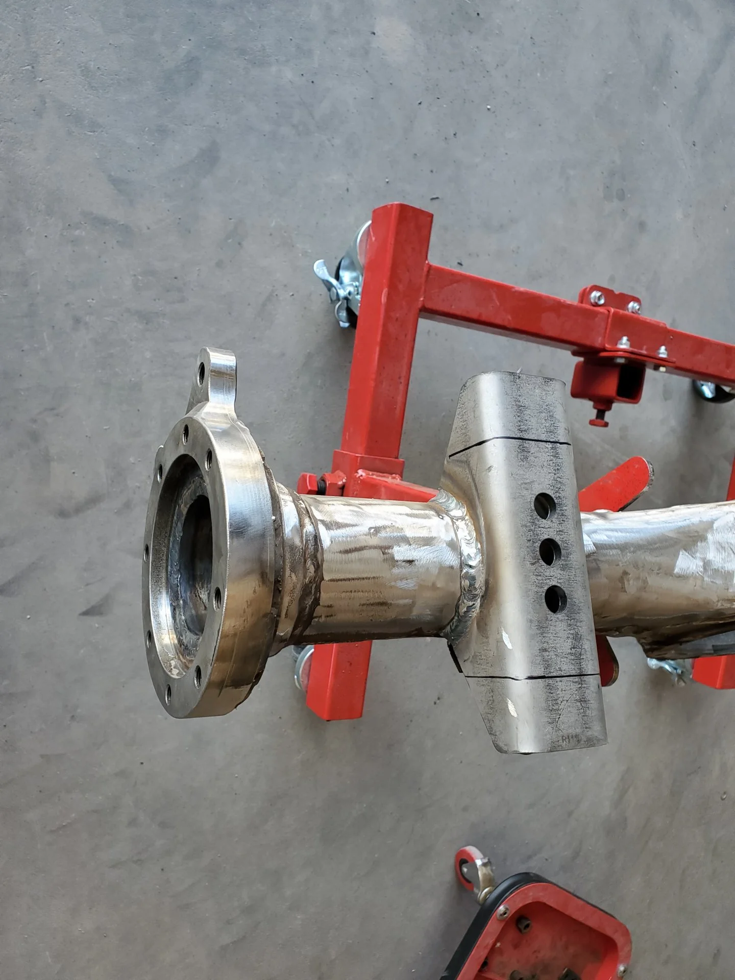

Laid out the perches to cut them to the same as the FJ40 axle and got to use my Sterrett combo square that I don't use much since I have been an Engineer

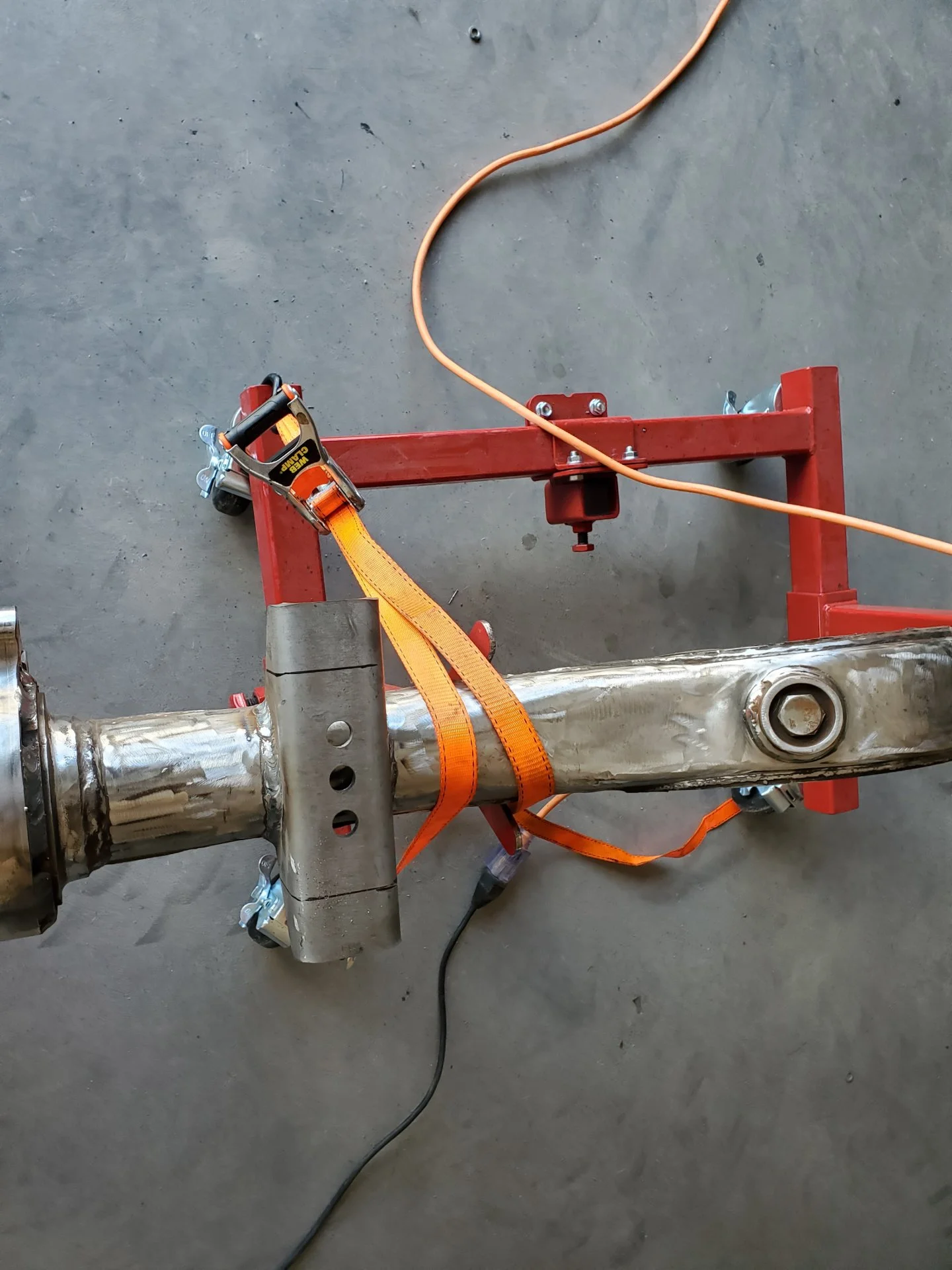

Cut the perches with a saws all at first, but got to be very noisy and rough then switched to the cutoff wheel and a die grinder and that would slow down because the compressor could not keep up so I had to wait for the compressor to build back up.
Had to make a break first so the axle did not roll while cutting
Then cleaned up the cuts with a grinder
