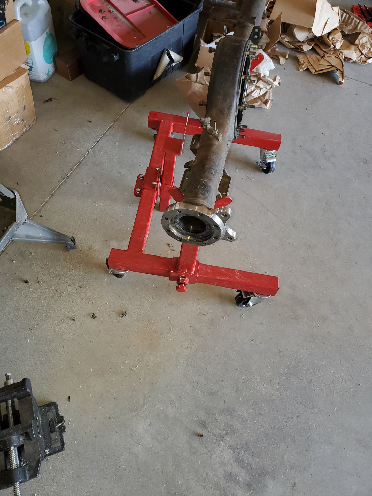

I started working on the rear axle modification to full float today.
First, I assembled the axle dolly

I tried to bolt on the full floating flange adapters from FROR and found that the bolt pattern for the spindle is not the same as t bolt pattern on the flanges on the axle tube. I will have to weld the adapter flanges to the existing flanges on the tube and keep building. While it is the shop I will get the ends of the tube trimmed and the bearing race remove.

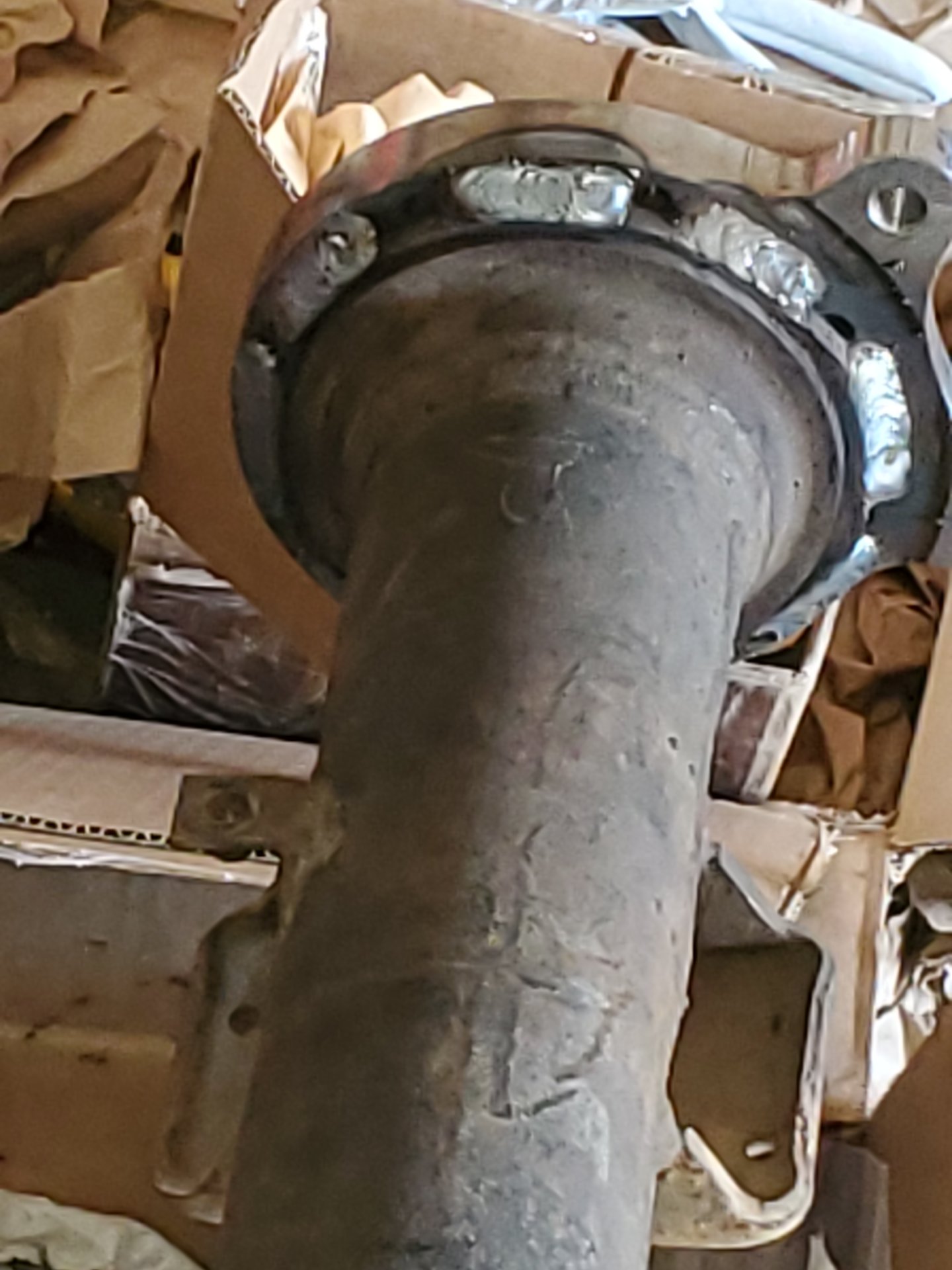

The bearing races were removed by the shop that installed the flange adapters for the full float conversion.
I just picked up the housed with the flanges welded both inside and outside of the original flange after machining the adapter flanges ID so that they would fit flush the original flanges on the axle tubes.
The inside was stitched welded because of the spindle bolt holes and the ID was seal welded with 2 passes.

Those flanges look super beefy
