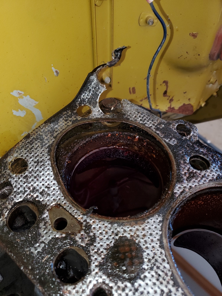

Rust in the cylinders

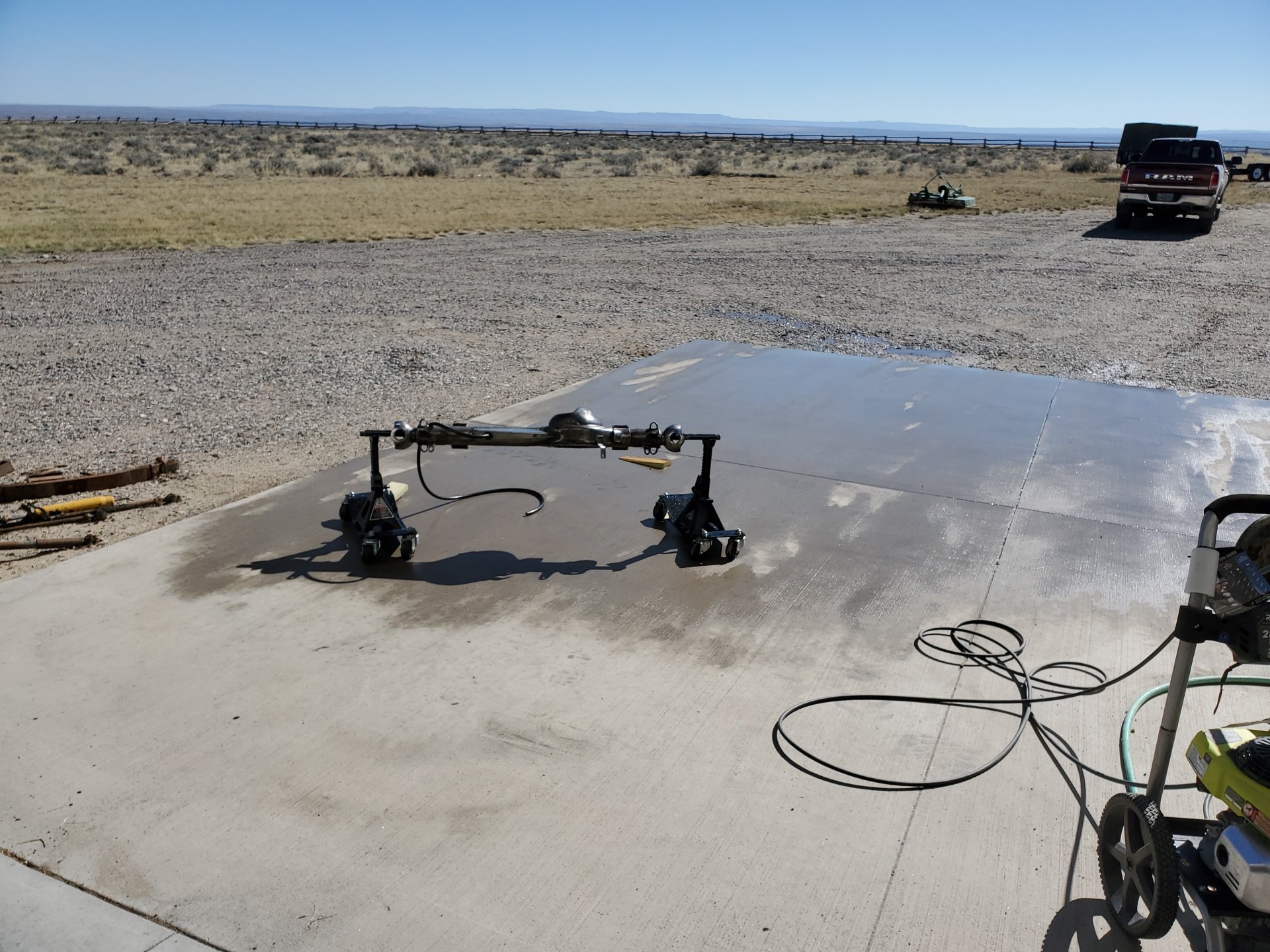

Did some cleaning today. Power washed the front and rear axles. Then did a metal prep on the front axle to get it ready to paint.
Put a metal prep on the front axle before paining

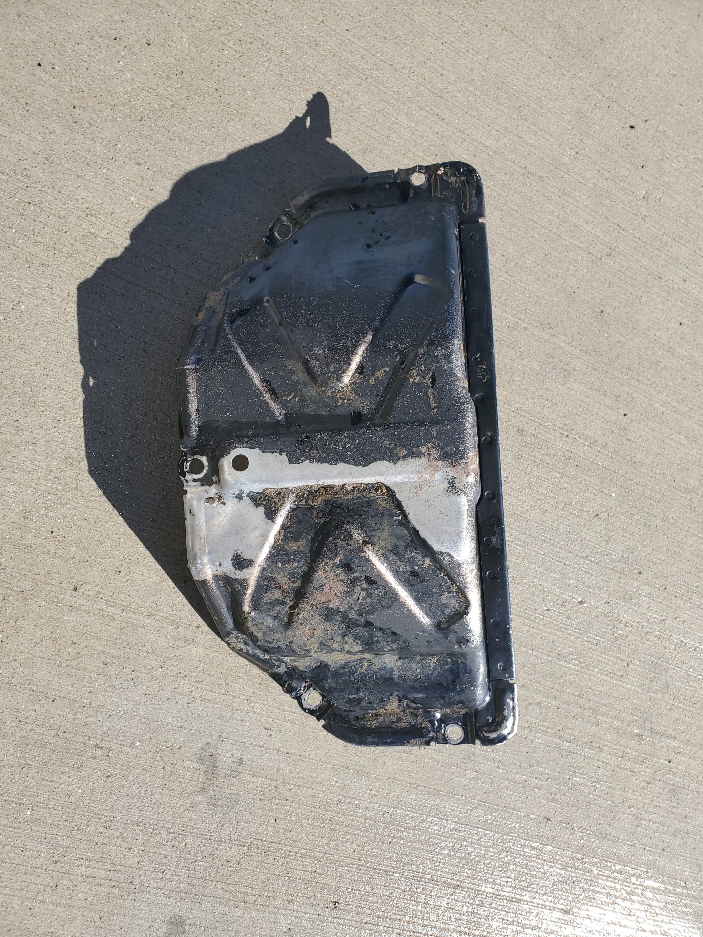

Cleaned the clutch inspection cover before shipping to another member.

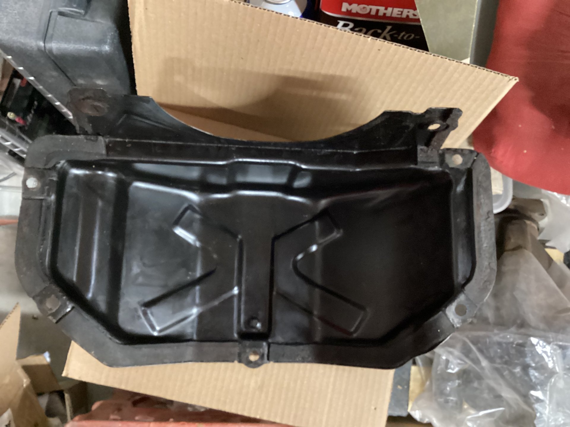

With that 3F bell housing you need a clutch cover with the staggered bolt pattern like this one. PM me if you need it.
With that 3F bell housing you need a clutch cover with the staggered bolt pattern like this one. PM me if you need it.View attachment 3174740
