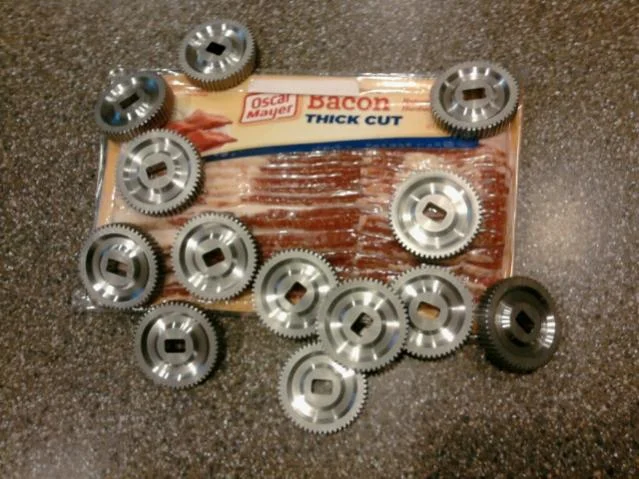

Rear window gears done
yeah... wow! I guess it beats the hell out of not using the back window.:rolleyes: Hope my brass one never gets stripped...
Just Ordered One From Don
He says he has about 20 of each new and old gears left. $65.

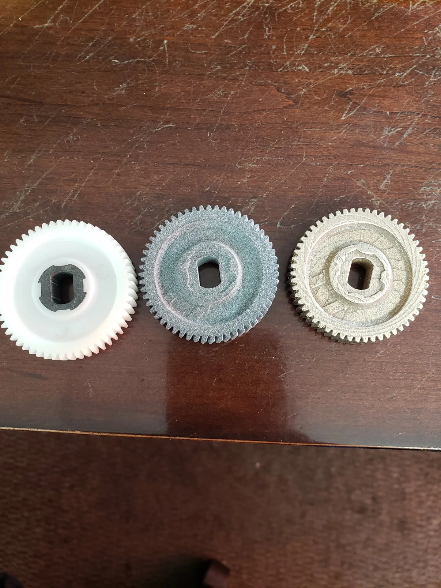

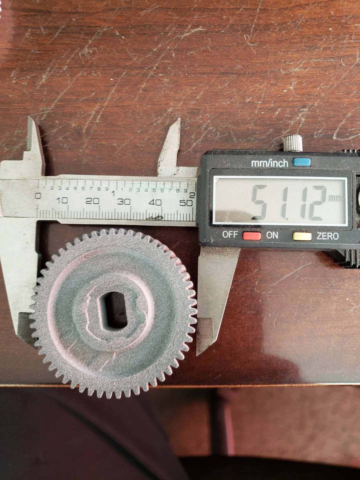

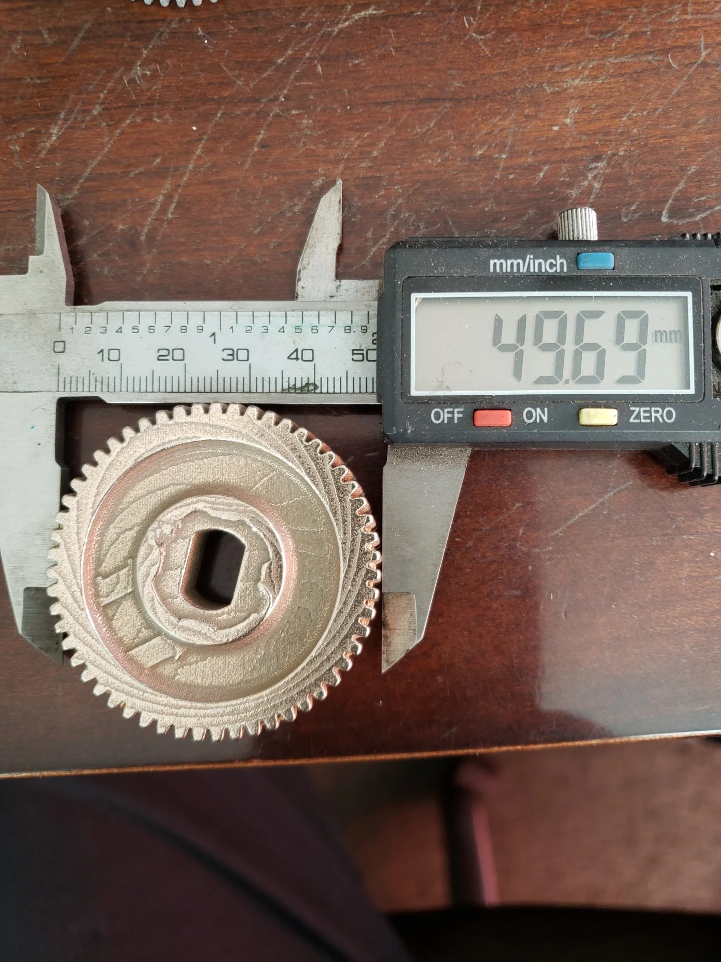

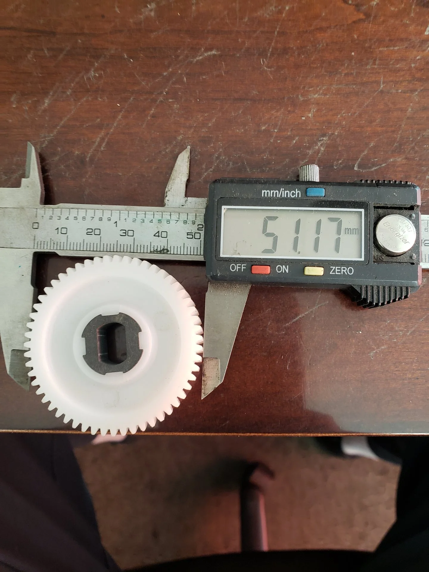

Have one in mine , pa12 , the same kind one i sent bob . looks to be an exact reproduction .. but the one i cast out of metal came out undersize ... when i sort out this i will stsart the second style gear .

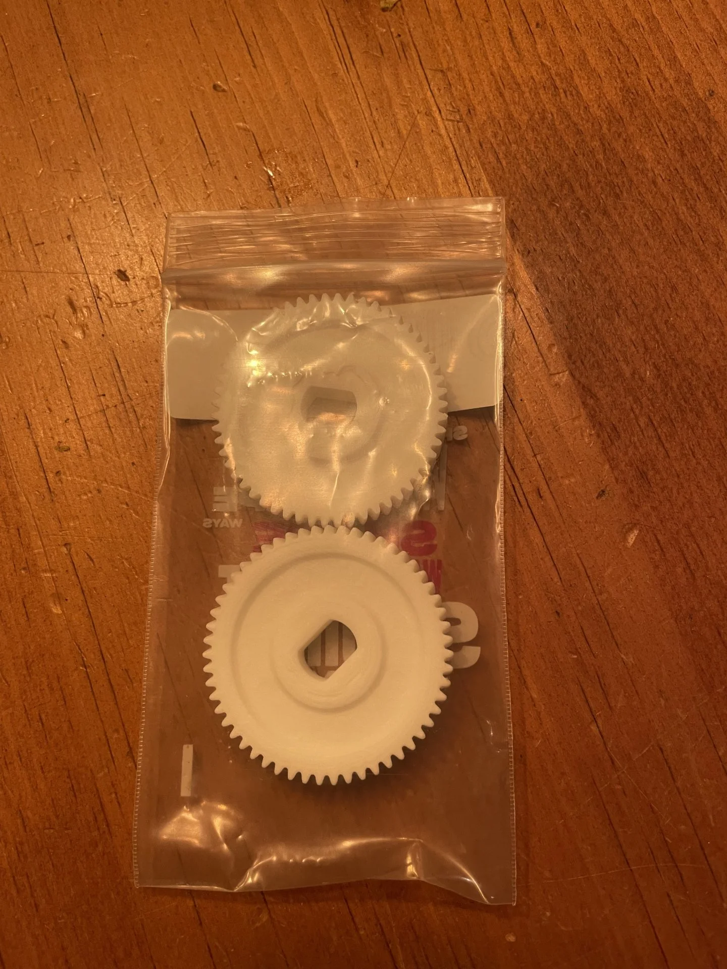

What option are you guys using? Natural, processed or premium? Can I buy one direct here or is it best to buy off the shapeways site?
