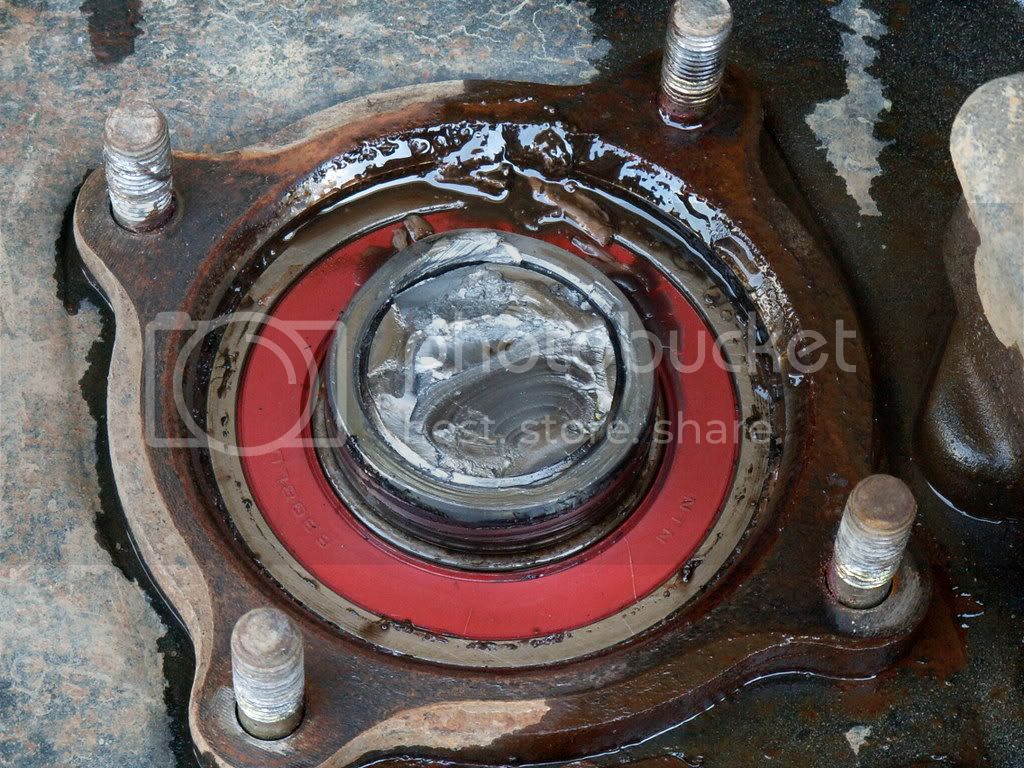

Whilst my Car is sitting in the driveway doing nothing because the Engine is out off being rebuilt for the second time, I decided to changeout the gearoil. Having put the rear of the Car on stands I shook the tyres to check that the Car was steady. - I thought maybe the Wheelnuts were loose, so I got out the Torquewrench and set it to 90 ft/lbs. and got only an itty bit of movement out of 'em. After all this and looking at the four axle nuts, it appears that the rear wheelbearings are flogged out at 200,000 miles to the metre. :clap:

I just did mine in August. I recommend you change the oil seal when you do the bearings. I used Marlin Crawler's new heavy duty rear oil seal and would recommend it but I'm sure an OEM one will be fine. You will also need an O-ring seal and a snap ring for each side. I don't recall needing any additional parts although you should do any necessary brake maintenance while you are in there (turn drums, new pads, etc.).

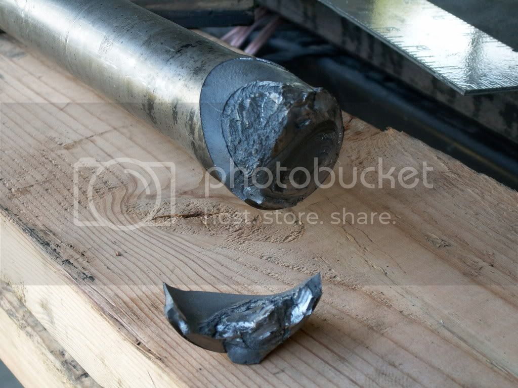

I tried that "pound on the ground" technique once. Once. Never again. I pounded like my life depended on it and that sucker would not come apart. I seriously thought I was gonna shatter the end of the shaft, or bend it.
I would never put heat on those axle shafts. Good way to ruin the heat treatment and hardness, then SNAP the next time you hammer the gas.
