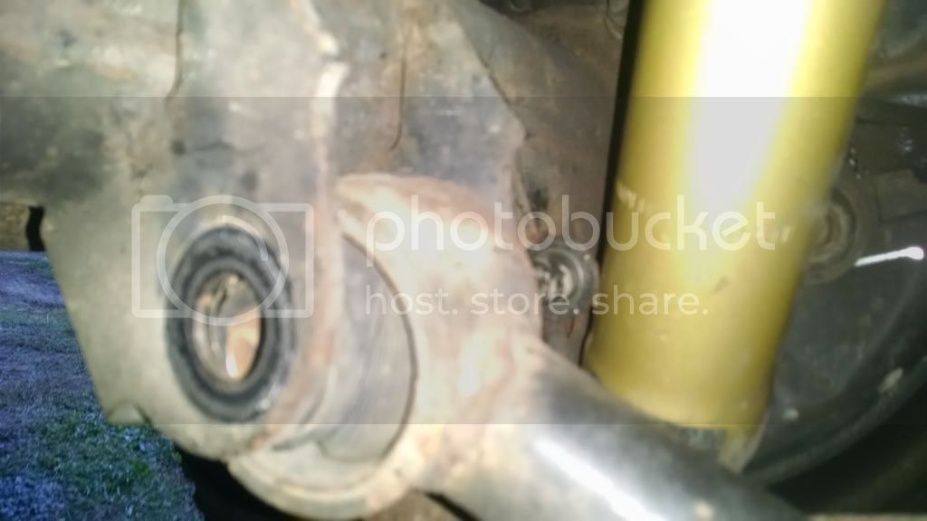

My metal tech lower control arms arrived today, and i hit a snag trying to get the old arms off. my rear shock is blocking me from being able to get the rear bolt out. did anyone else run into this problem? at this point, the only thing i know to do is to try to move the shock. i was working on drivers side tonight, but it looks like passenger side will have the same issue. i've got the tjm adjustable shocks. perhaps they're a little larger than some? anyone have any other suggestions?
not the greatest pic:
