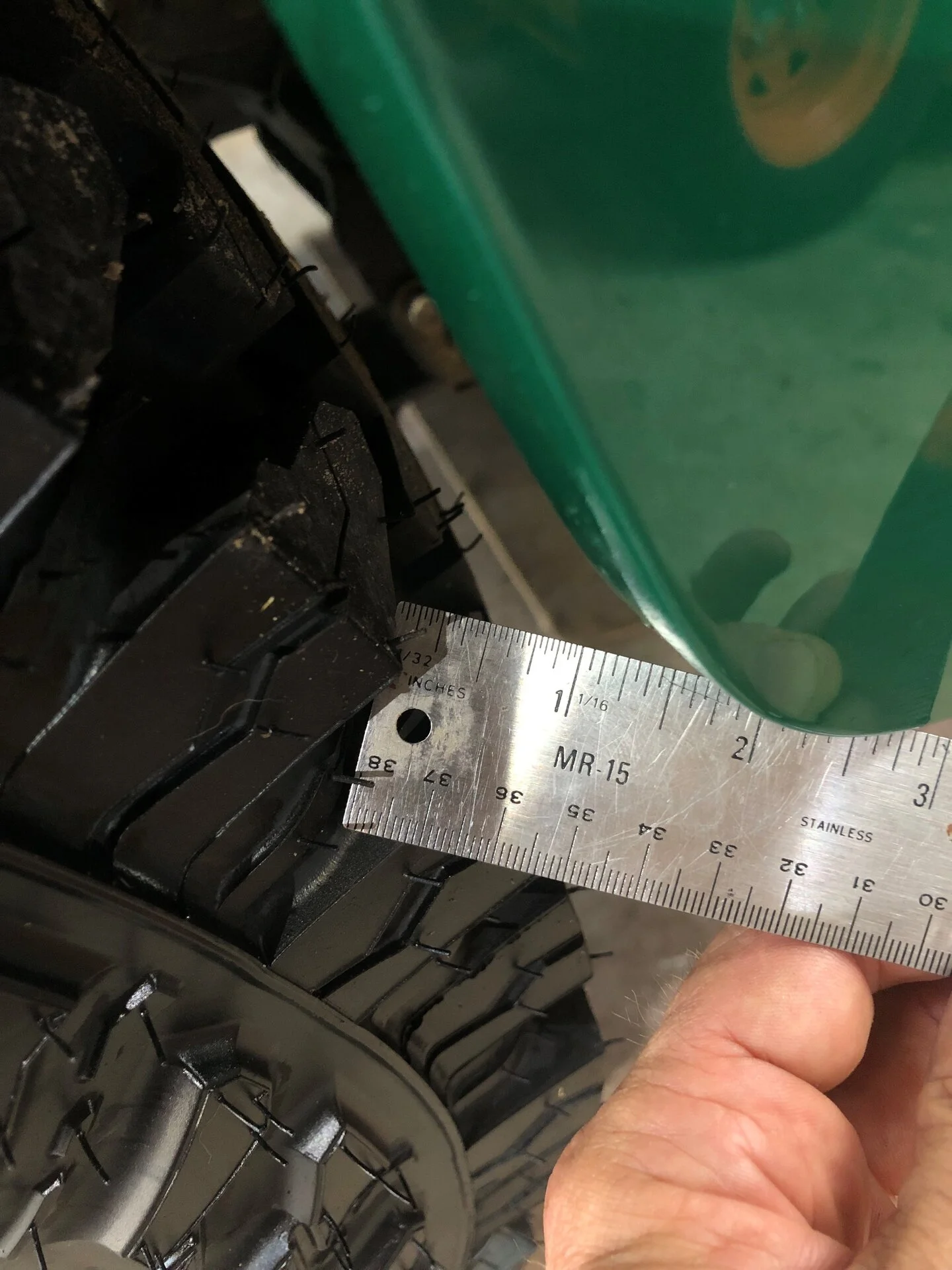

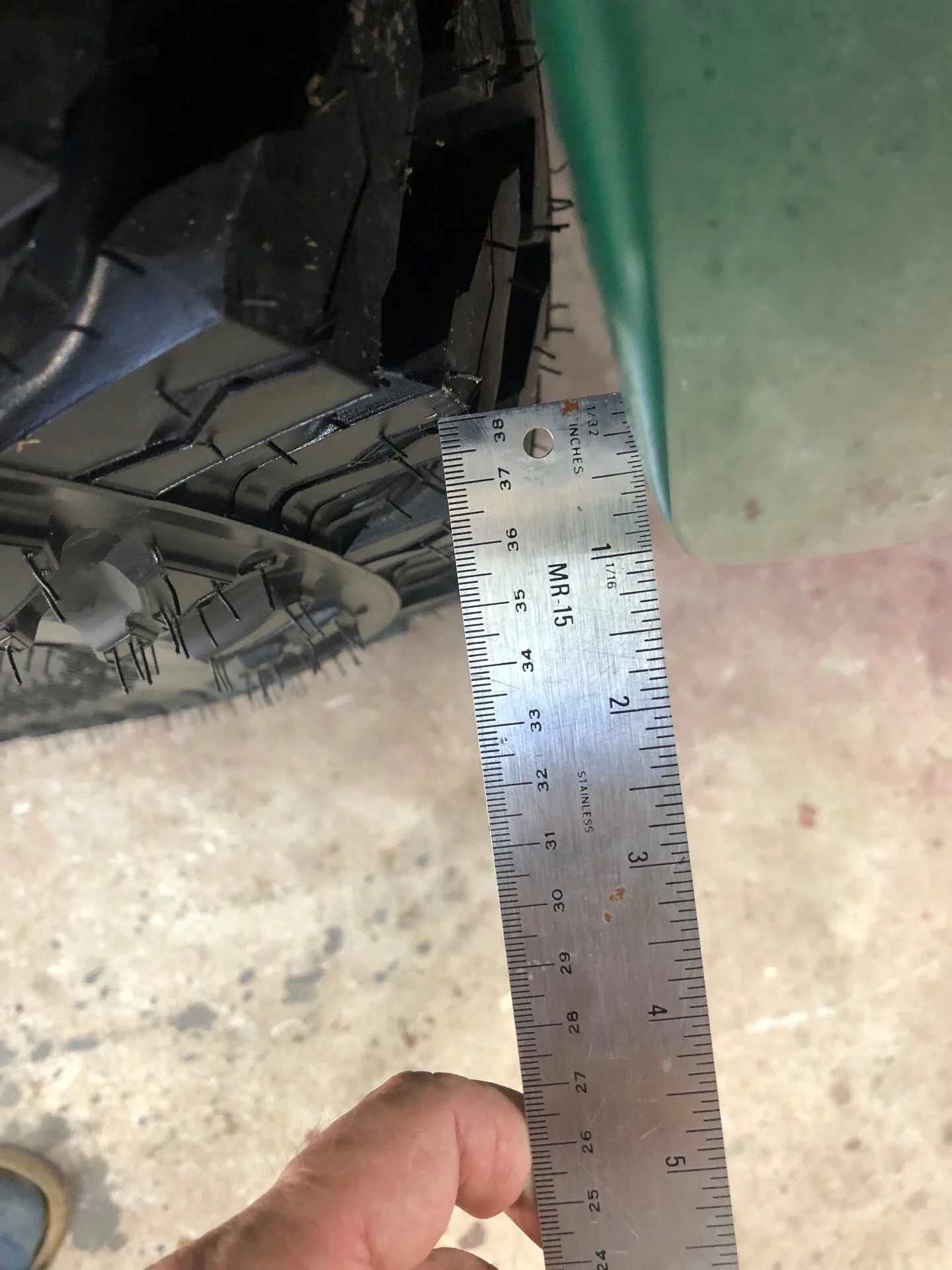

Recently had the rear fenders patched using the panels made by Real Steel. We are running a 2-1/2" OME lift; 16" wheels and Yokohama Geolandar M/T (LT255/85R16). The clearance at the leading edge of the rear fenders looks close. What does the brain trust think?
Thanks.

Common issue with the OME springs. I got some spring pin plates and moved my axle backwards about 1.5", worked great. Also, as the springs settle, you'll eventually get better shackle angle too.
Here's mine with 255/85r16's and OME lift after moving axle back.
Thanks. @MDH33 Where did you get your replacement spring pin plates?
I can't recall where I got the spring pin relocation plates. They are generic, probably 4 Wheel Parts or Amazon. I just used my spring width and pin diameter to reference size. You'll need ubolt plates too. I got those from ruffstuff
