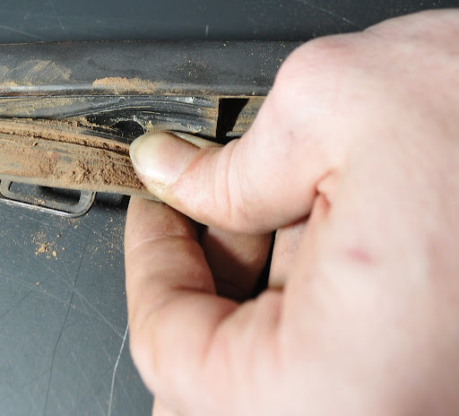

I'm going to do the ends like mine had. Let me see if the pic shows it clearly:
hopefully w/ this cropped you can kind of see the adhesive. Was like rubber cement, just at the ends where they touched (on side near window lock). And i clipped my fingernails after this...embarassing...lol.
so i'm going to use the gorilla glue i think. i know it dries white, so hopefully will just put a couple dabs under the WS to hold it.
