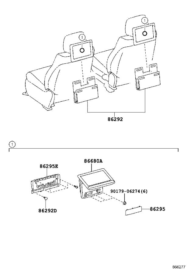

Does anyone have any of the screen protectors they want to sell? 86292 in the diagram below.

The site I use for parts reference shows the same part number for the monitor for both Lexus and Toyota. I assume the mounting base is the same, especially since it looks identical in photos of the Lexus and Toyota seat back.
I was able to order the vinyl covers from the Toyota dealer and they arrived with the Lexus logo embossed in them. Pretty funny. They cost about $75 for both. I think 86292-60030 ended up being the part number.
