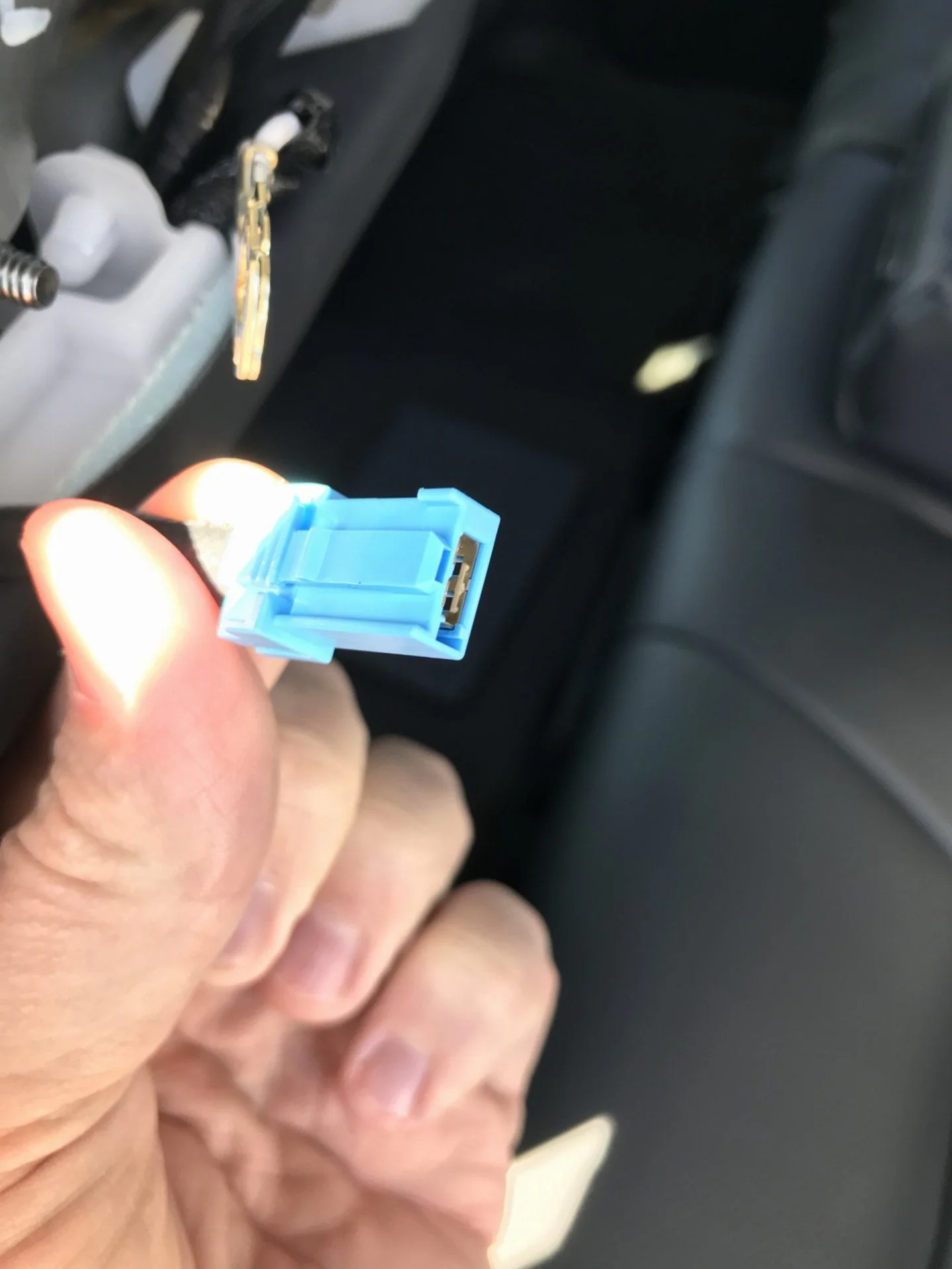

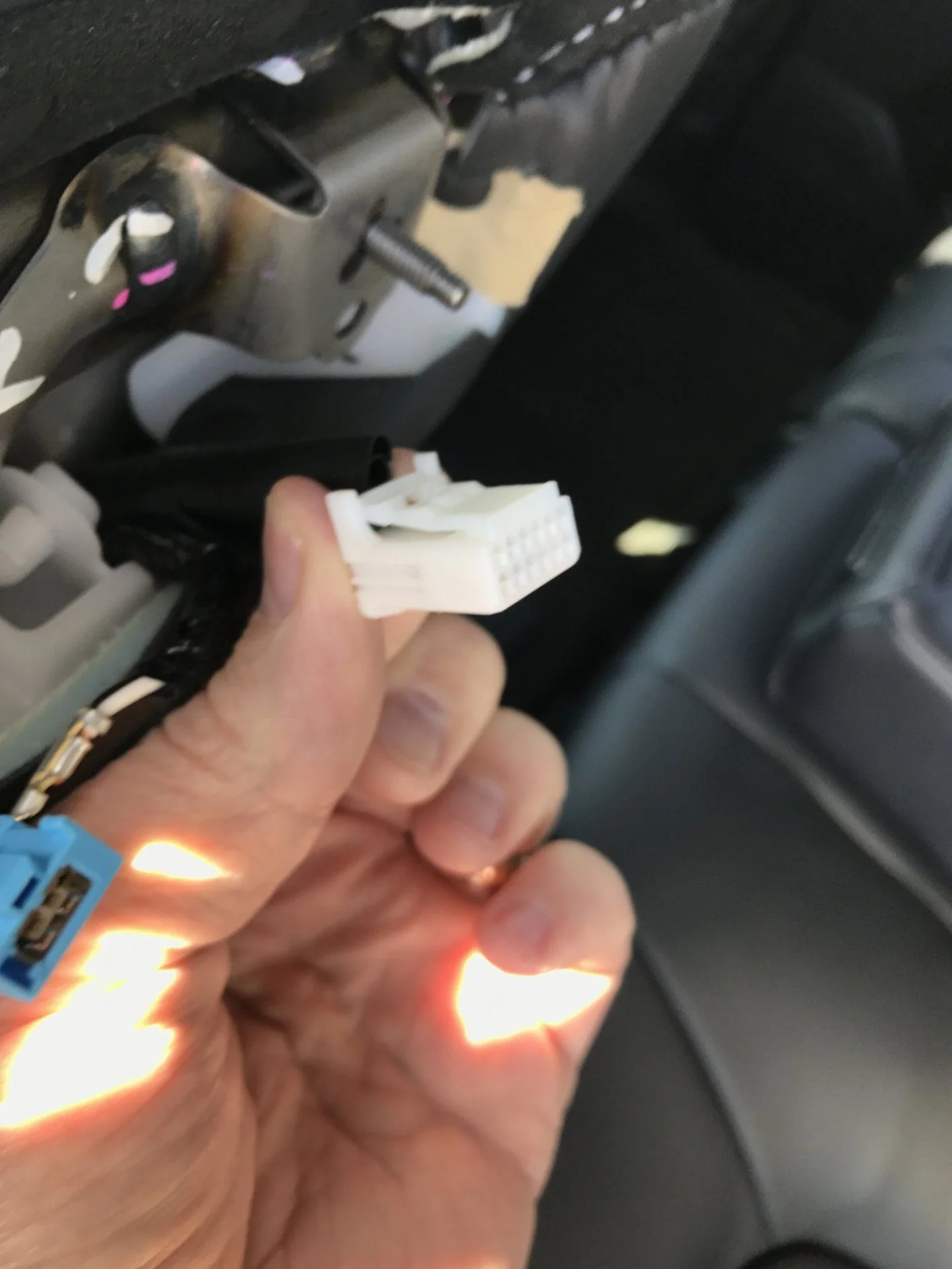

So, I'm in the process of removing the rear seat video screens in my new LC. The cover came off easy. A 10mm socket made quick work of the three nuts holding the screen onto the back of the seat. Two of the connections came off easily, but I'm having trouble with the green connector. Any advice for me on how to take it apart without damaging it?
My plan is to do a 3D scan of the base, make a few modifications (eliminate the top part and round out the base), and print black textured covers for the seatback in ABS. I also want to preserve both screens so that the vehicle can be put back into stock condition should I choose to sell someday. I'll let you know how this goes.
Nevermind. I used a long pair of needlenose pliers to squeeze both sides of the connector, and it came right off (I have fat fingers and could not reach in there on the back side). Next step - 3D scan, modify and print. Hopefully, I'll have a working prototype cover sometime this weekend!

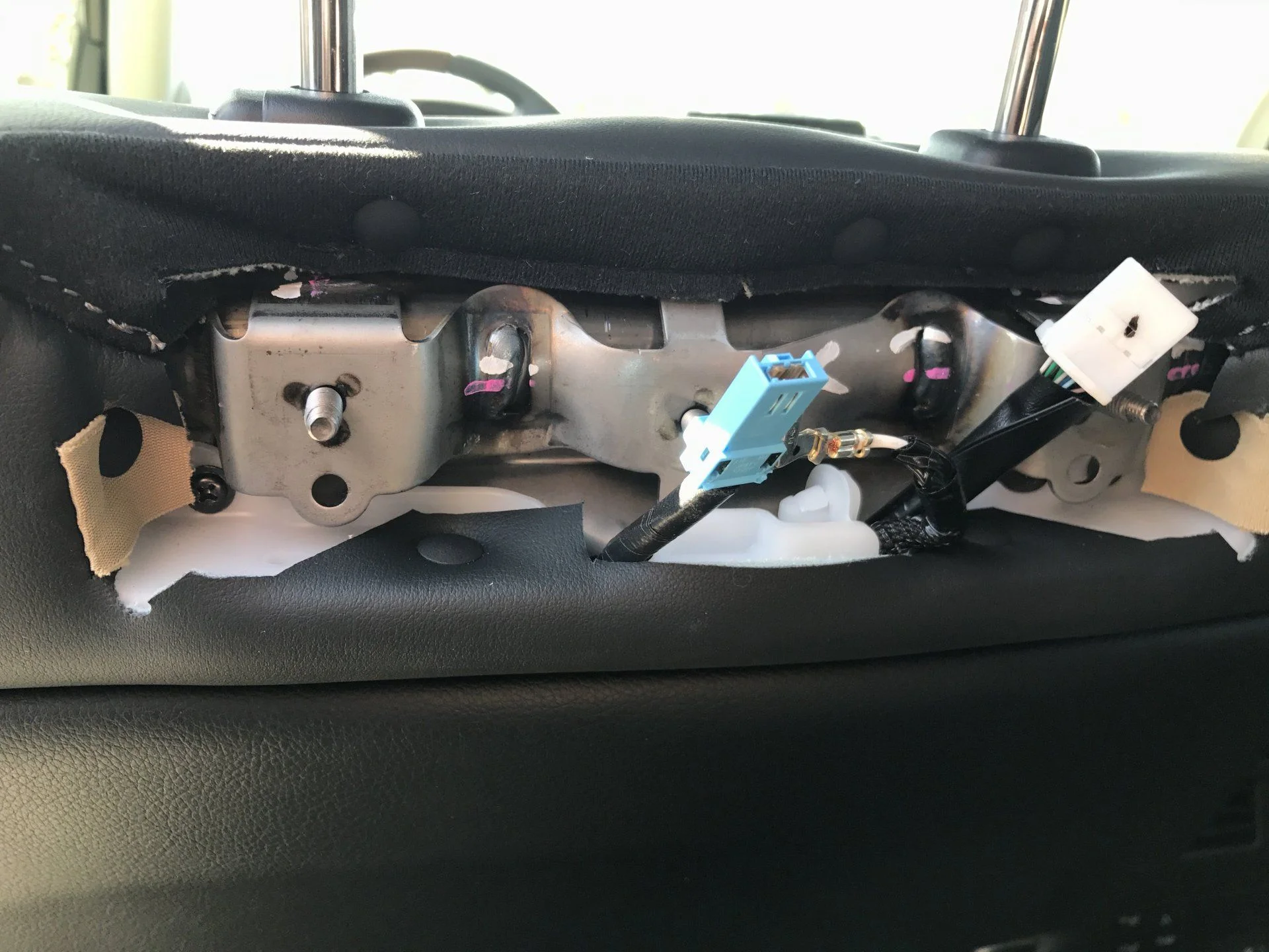

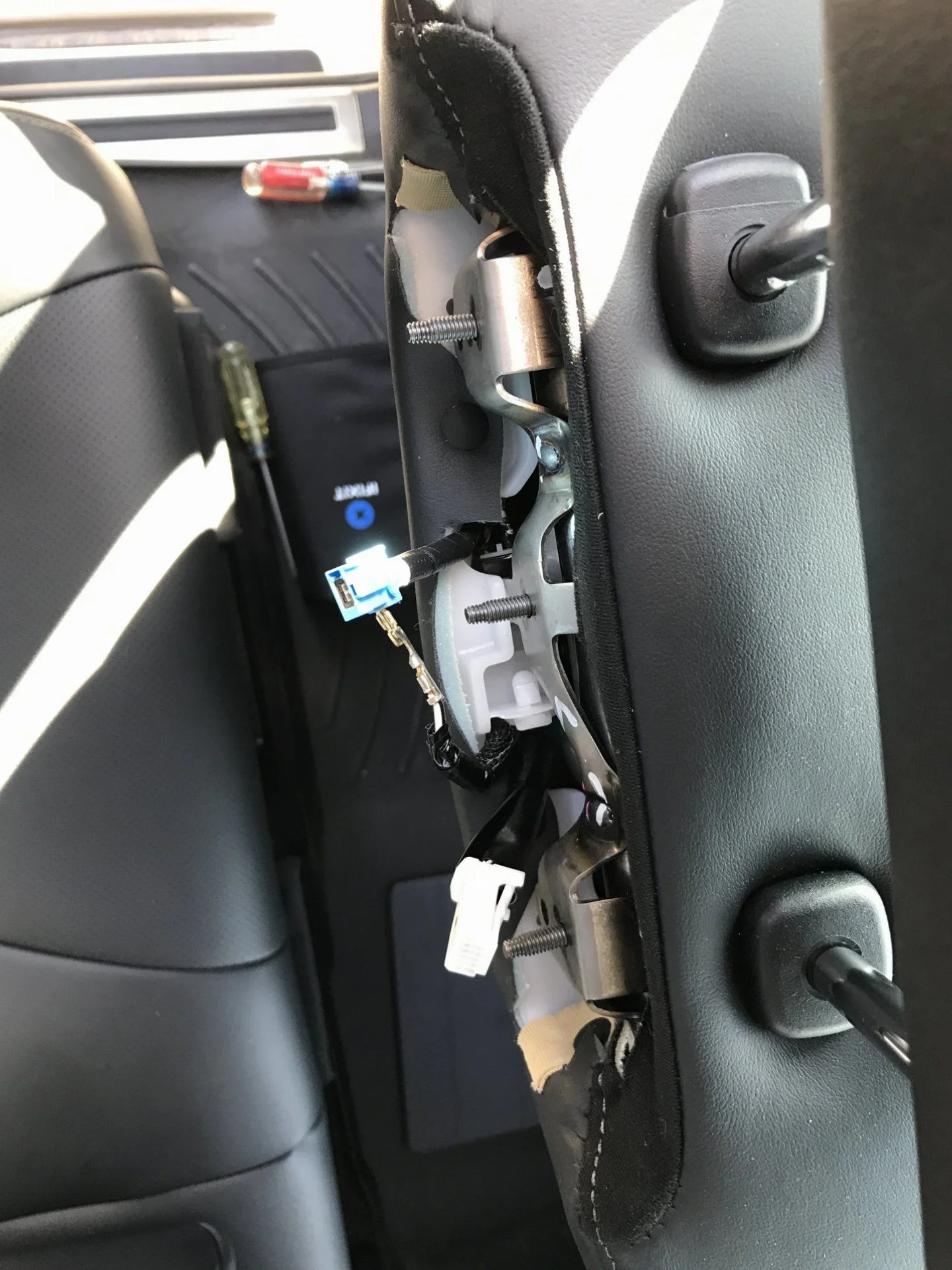

Would like to see a picture of the defect left after removal of the unit, if you get a chance.

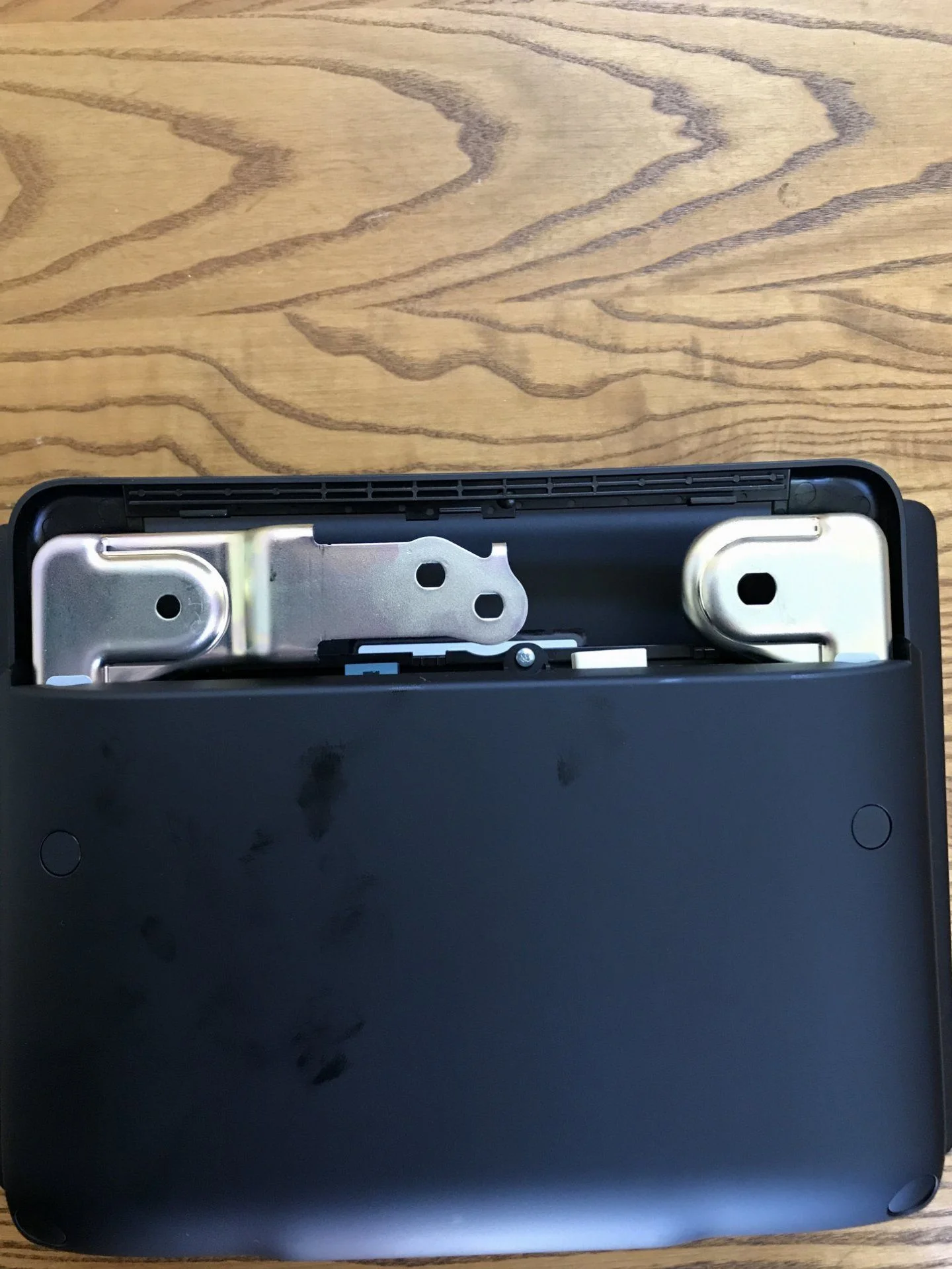

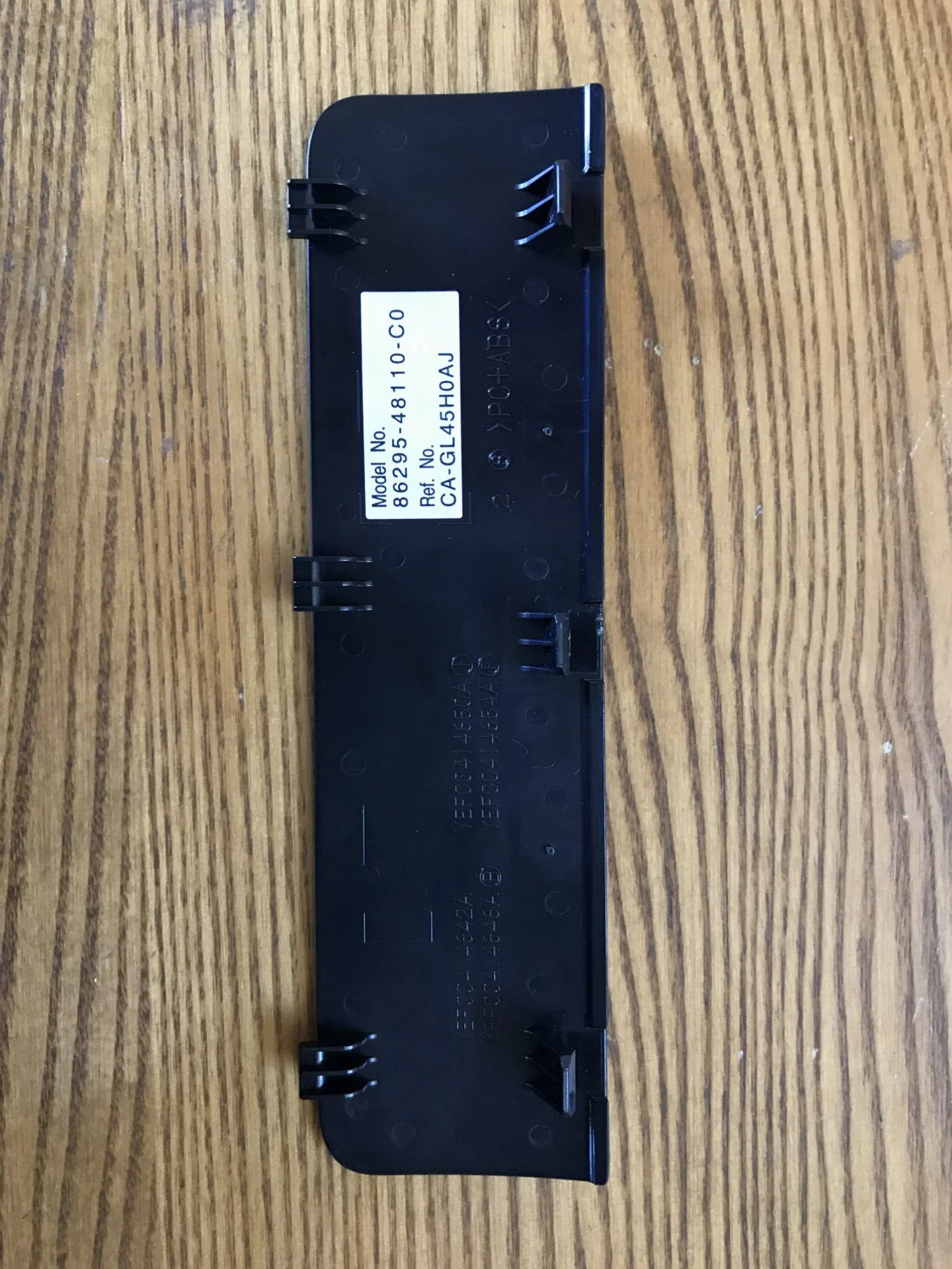

Well, everything is removed, scanned, measured and is now off for processing in Solidworks by a friend that has a full license (and the knowledge to translate my vision into reality). Since he has a "real" job, my model should be ready for a couple prototype prints in about a week. In the meantime, here's the requested pics of the parts and "the hole":
