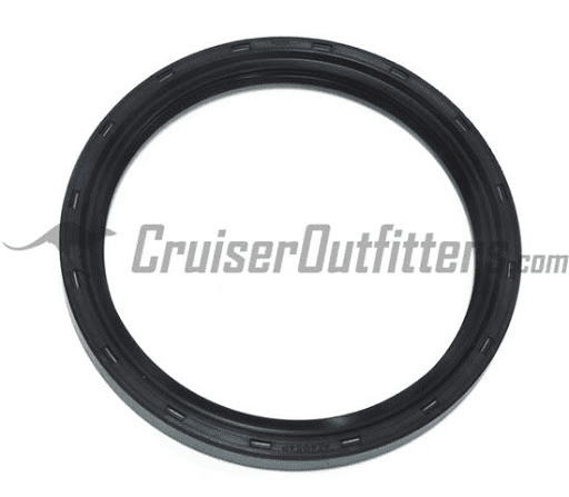

So my rear output seal is leaking on my transfer case . Ordered new seal from Toyota however doesn’t seem like the right part #. Can anybody verify this is the correct seal ? 1982 FJ60
Just to clarify, you want the seal that is for the shaft (flange) going to the rear wheels?
If yes, the 48003 has been superseded to
(I believe the 48022 you rec'd is the super'd part # for the seal going to the FRONT driveshaft).
For a 2f that doesn't look right at all. This is what I used on mine though I don't know the Toyota part number.
EDIT: reading comprehension bad, I thought this was about the rear main seal. Ignore me.
this image looks like a rear MAIN seal.
