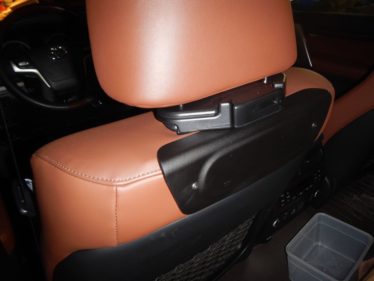

I used the Victory 4x4 in my 2020 LX 570.
I have the Victory 4x4 filler panels. They look nice and I am happy with them. I put some speaker grill cloth behind them so that you can't see into the back of the seat. Rear seat passengers will def want to make sure they wear seat belts cause they are very solid steel and wouldn't be nice to a head/face if an accident occurred. I sold my 2016 screens for about 1K each on eBay. Took a month or 2 for them to both sell. Not sure if the market for them is still the same but the 2016+ are very prone to getting crushed from tilting the 2nd row seats forward to aggressively.

The Victory 4x4 panels are well made and work great for the LC seats.
Edges are not sharp on the Victory 4x4 and they are not any less safe than having the screens in place.

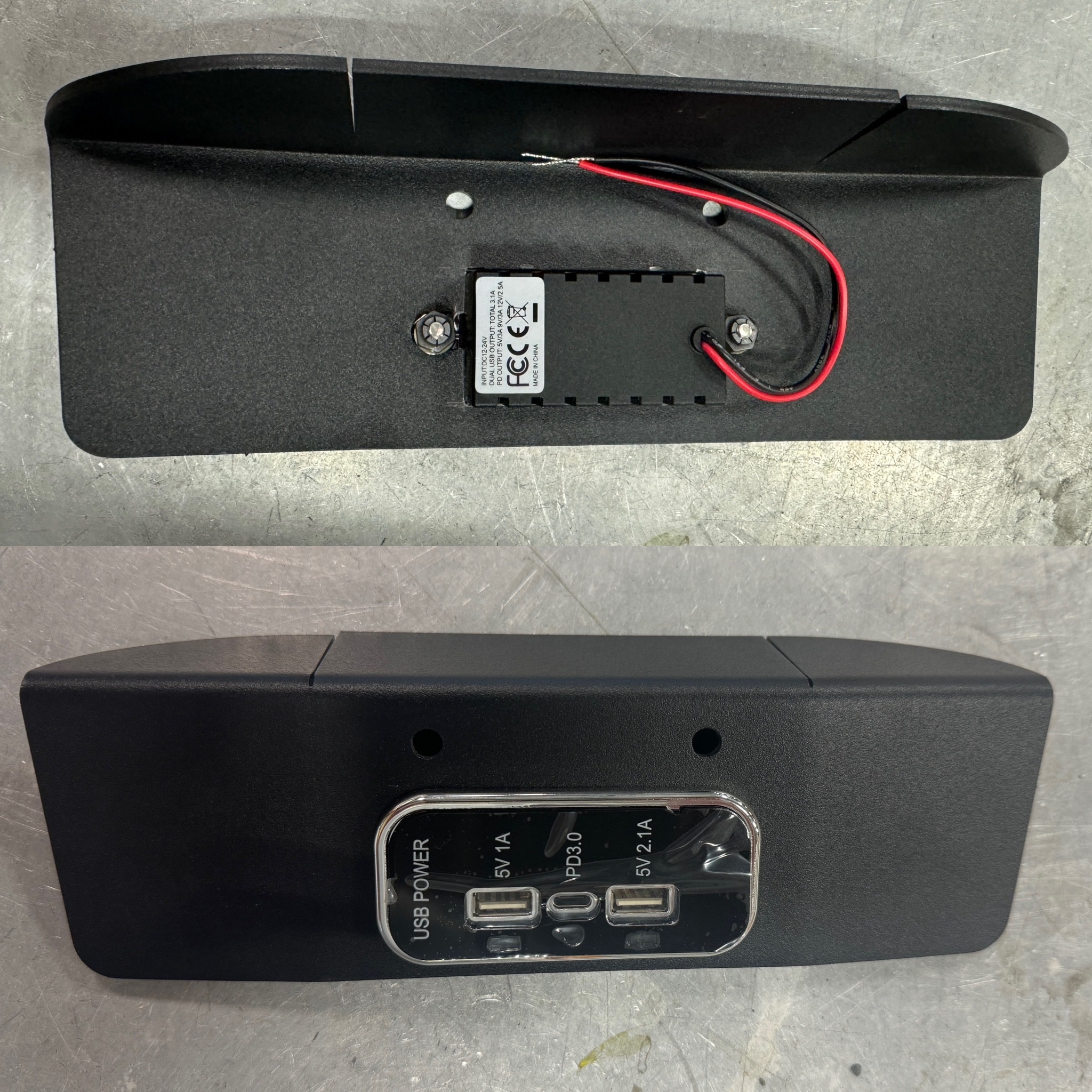

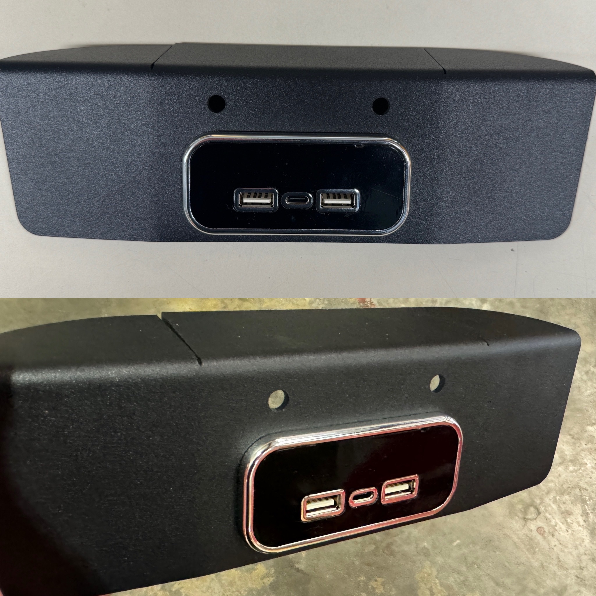

I purchased the Victory panels a few months ago and installed some USB plugs into them. I intended to purchase a 2015 LX but the deal fell through after I had the panels and plugs ordered. So while I haven't installed them into an LX, here's what I came up with. I'll do a proper write up once I get them installed. I've been told that there's wires at the base of the seat that are sufficient for the USB plugs, both constant power and accessory power. Judging by the size of the wires on the plugs, it won't take much of a wire to do the job. I used a dremel tool with a cut off wheel to cut the panels to fit the plugs.
I used some black vinyl to cover the writing on the plugs as I wasn't a fan of the labels, it's pretty obvious what they are. Also, these plugs are not supposed to have any backlighting. No need for a red or blue light glaring at the passengers for the whole ride.

Very well done.

Dude. This is awesome. I’ve been researching the right USB port to put on my victory panels I think this one does it!
