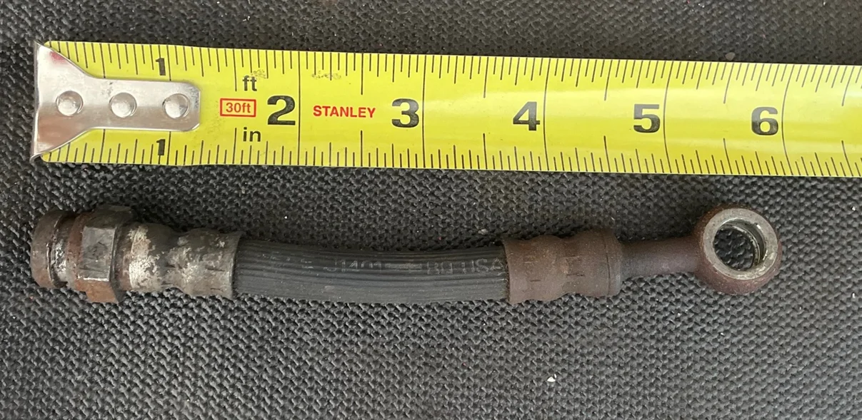

I am wondering if anyone can help with a part number or vehicle to search for the brake hose pictured below. I am the new owner of a '78 40 and the PO did a rear disc conversion. I am restoring and have not been able to find the right hoses for the rear end. I looked in the FAQ of the forum and the recommended hose listed there (Nissan 200 SX) is too long for my set-up. Calipers are metric GM style. I appreciate any help.

You will not find it, that is a proprietary hose to JT Outfitters, $14.95 & in stock, just spoke with them and they make those in house. There is no AC Delco, Napa, Orielly part number as they are not a commercially manuf. part.
Thanks man, you saved me on that. I have been going crazy trying to find those. I looked at JT outfitters but missed them somehow. I really appreciate the help.
