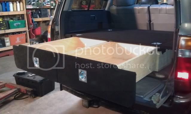

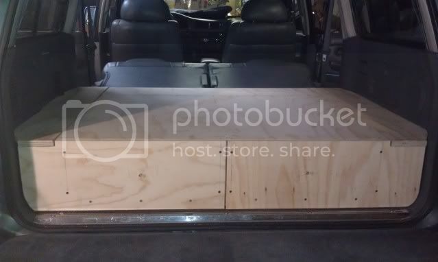

I started to build my rear cargo box today. I am trying to set it up for camping as well as keeping organized. I contructed the whole thing out of 3/4" AC cabinet grade ply. $30 per sheet at lumber yard. I fastened all the panels and drawers together with 2 1/2" screws and glue. I used european hinges for cubby tops. Box was prebuilt prior to install. 8 bolts hold the thing down in the factory holes for the rear seat brackets. The drawer use NO slides. I built boexes perfectly square and built drawers a shy 1/16" smaller all the way around. They slide nice and snug. Best of all no $$ spend on big $ slides. I will be picking up some slide locks and tie down point tomorrow. Also will be wrapping with thin black auto carpet.

To remove full assembly I would take out 8 bolts and it would slide out in one piece. The hinges are quick release euro hinges for no hardware removal
Looks nice, i wanna do one but want to make it modular for easy removal. How many sheets did you end up using?
Thanks. 2x4's would be a waste of space in this situation 3/4" AC screwed togther is very very strong. Pre-drill and countersink all screws, use glue, build everything square. My drawers are 30" deep. I am a contractor by trade so working with wood is second nature. Take your time and have fun with the design....I didnt...I was going more for speed and cost effective. Oh and I used two full sheets.

I did aclimate the wood but we will see this summer on the humid days. Using the 3/4" ac ply which is cabinet grade doesnt move to much with weather.

Thanks! If you didnt use your third row all the time. This setup can be taken out in 15min tops with one person.

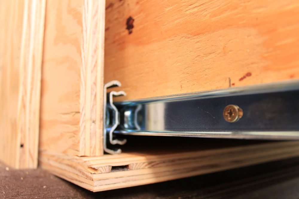

I have 100+ pounds of tools/CO2 tank/recovery gear in one of my drawers. If I didn't have slides, I'd never get the drawer open or closed easily.
BTW, nice build. :cheers:

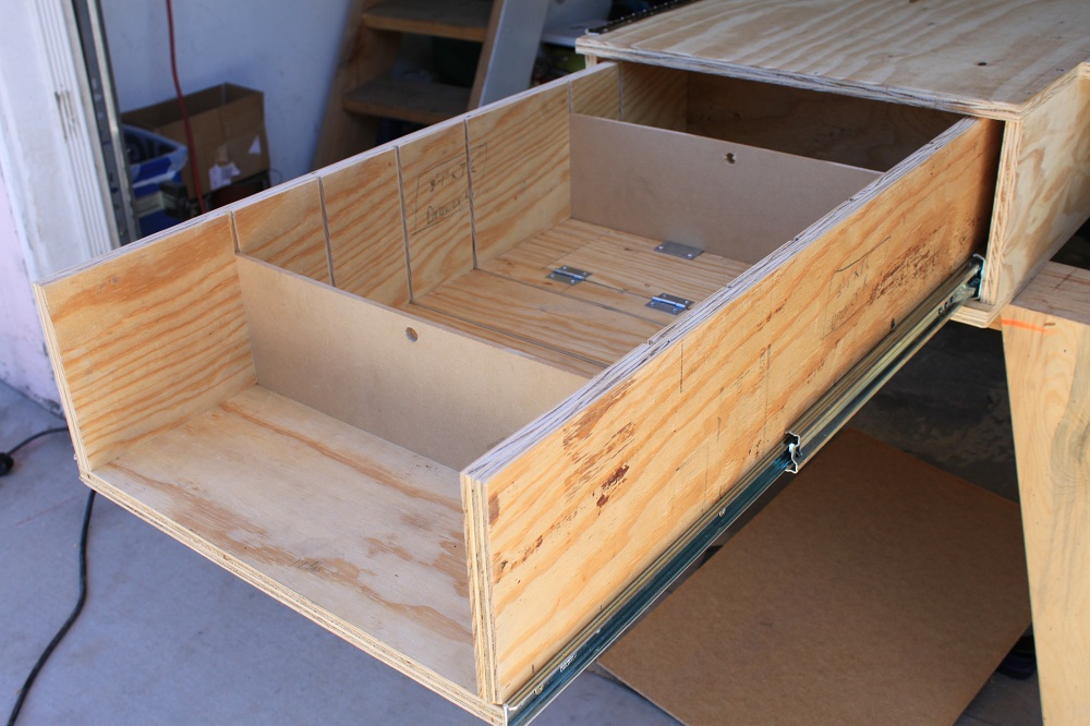

I cant say the slides arent nicer....I was going for budget friendly and no moving parts to break.

Slides can be cheap. But A set of slides would cost what I built my whole setup for, maybe more. They do slide quite well how I have them.
Are drawer slides needed...? I can say they arent needed but would be a nice additon. I chose not to and save a few $ towards the spiral of projects I want to do on my 80.
If you have lots of weight in the drawers or plan to open them on the trail -- yes, that does happen -- then you'll like the slides.
But I can see economy and simplicity, too. This build has that, looks great, and I agree is plenty strong with 3/4" birch ply. That's what I build lots of stuff out of and it's plenty strong.
:beer:
If they become a problem and I hate the function its nothing but building a two new boxes, reuse face , and add slides. I'm sure it won't come to that but an option.
