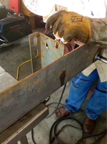

Most spindles that "do" break---snap at the upper weld / heat fatigue area over time. Given that you have boxed the spindle....you would be much better off with a very limited penetration weld in that upper high fatigue/load area. Not only is there no need for a big weld/multiple welds....but its actually working against the life of that spindle. The weld simply needs to hold it vertically and let the strength of the boxing act as the main horizontal load bearing element.
Cold worked steel is not good for welding applications since the heat will just make the metal lose it's strength (near the weld-basically releasing the tensile stresses of cold working) that was gained through cold-working. Hot worked metal is slightly weaker but more ductile and better suited for welding applications. Hot rolled will be cheaper and keep your bumper costs down while actually ending up being just as strong at the weld as cold rolled.
I'd be willing to bet that when spindles break, it's more due to the fact that the opposite end of the swing arm isn't captured properly. I don't foresee any issues here.

nope- most spindle breaks are "stress/ fatigue" related........and all occur at the uppermost weld which is weakened by the aforementioned reasons. The horizontal loads on a bumper with a swingout of 24"length with a sizable tire/accessories is fairly significant when compared to the effective yield strength of mild steel. whether you use cold rolled or hot rolled- once you hit it with heat from the weld- you are effectively reducing the cold rolled strength back to hot rolled- at the weld.
Its a pretty easy fix given your boxed design at the spindle area which looks good. You really want the boxing to be doing the work relative to the horizontal load...........so just lay down a bead to "hold" the spindle to the boxing and let your design do the work.
Is this 3/16th?
^I see what your saying and probably agree with you, but would have to see some computer load video to understand it. If it was mine I would weld it fully around. This seals out rain and debris from getting down into the boxed area and corroding years down the road.
Is this 3/16th?
Of course a spindle break would be caused by stress and fatigue. Where would you say that the excess "stress/fatigue" comes from? It comes from the opposite end of the swing-arm not being supported properly. Exactly what I posted earlier.
The end of our swing-arms, opposite of the spindle, will be completely supported once latched.

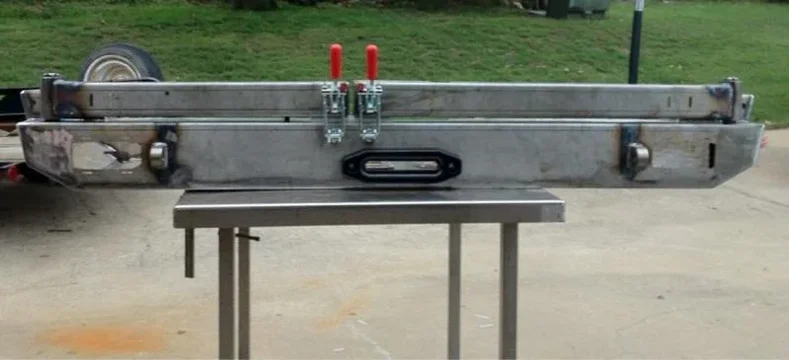

Had a busy day today. LOTS of welding, but everything went together very smoothly. I think we've finally got all of the little kinks and assembly challenges out of the way. Started with a big pile of parts, and worked them into rear winch bumper shell.
Sent from my iPad using IH8MUD
Ended the day by loosely setting the bumper in place on the cruiser. Didn't bolt it on or anything, so it's not sitting level.

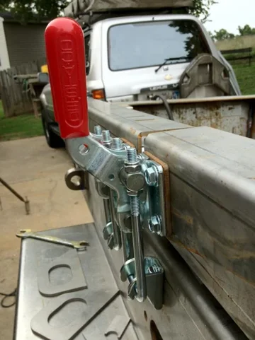

Here's an idea for the FJC swing out.
Smooth motion, no latches. Swings with the operation of the door.
