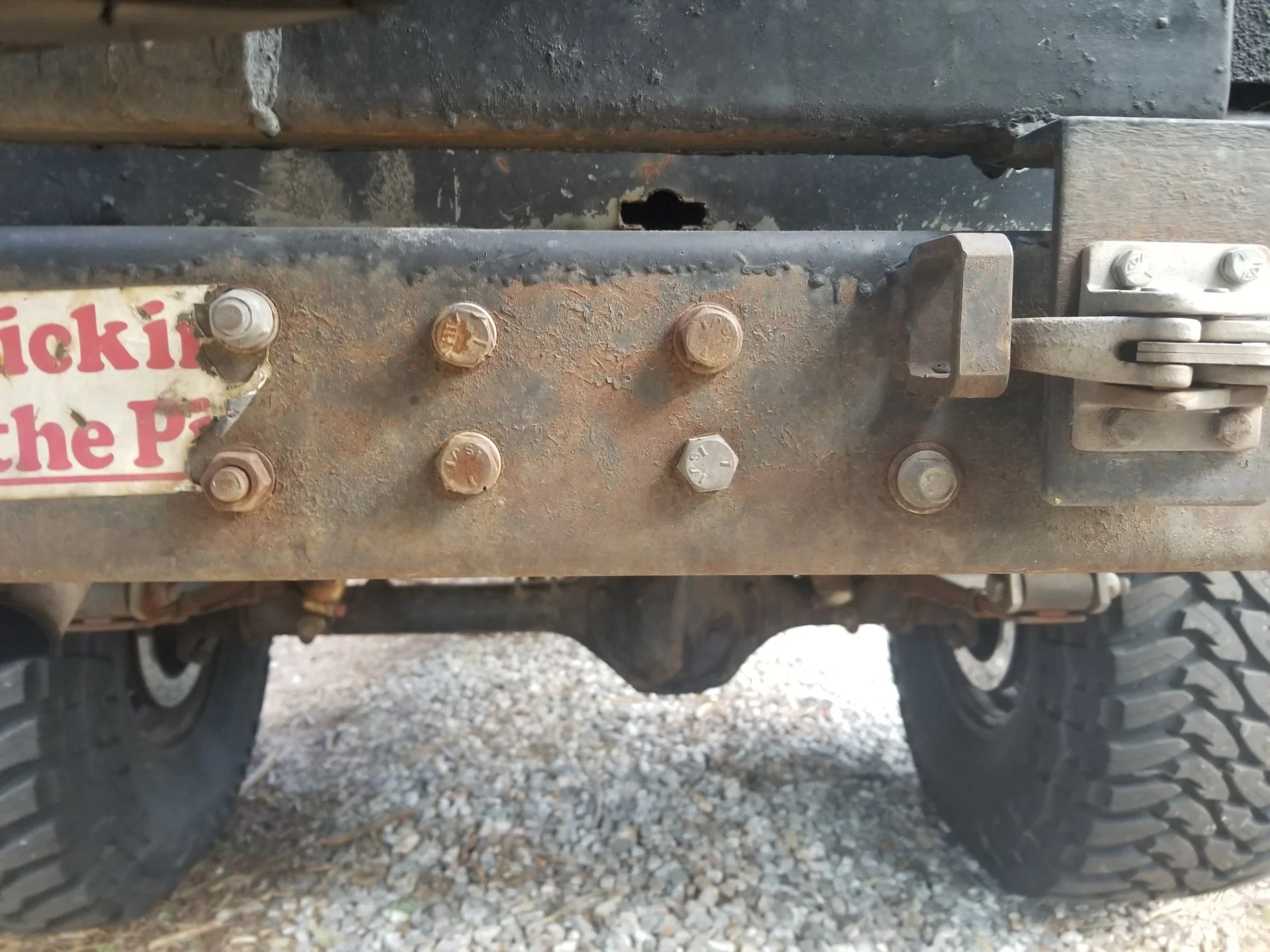

I had a shop cut off all rusted bolts to remove rear bumper.
They told me I needed 1/2 x 13 x 1 carriage bolts & 1/2 x 13 x 1 1/4 other bolts.
Are these correct or should they be metric?
I tried a search but couldn’t find the definitive answer

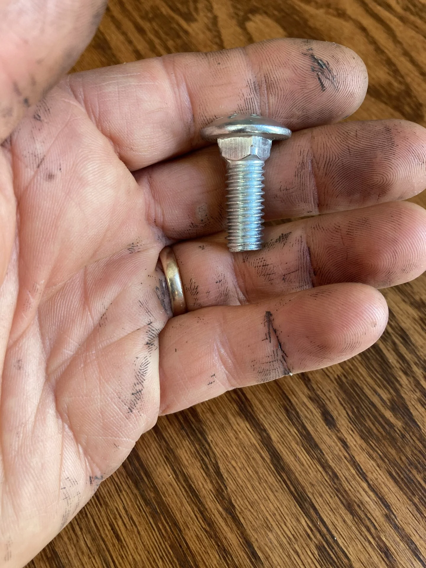

Toyota Part Number 90112-10016

I love McMaster Carr. I placed two orders last week. Having said that, they don’t have M12-1.25 carriage bolts.
But they do have M12-1.75 IIRC.
FWIW- I just ordered the factory bolts from toyotapartsdeal. They were like $5/per.

Not sure if you were asking me. The price includes metric, carriage, and plated. Using them on painted bumper as they come.
