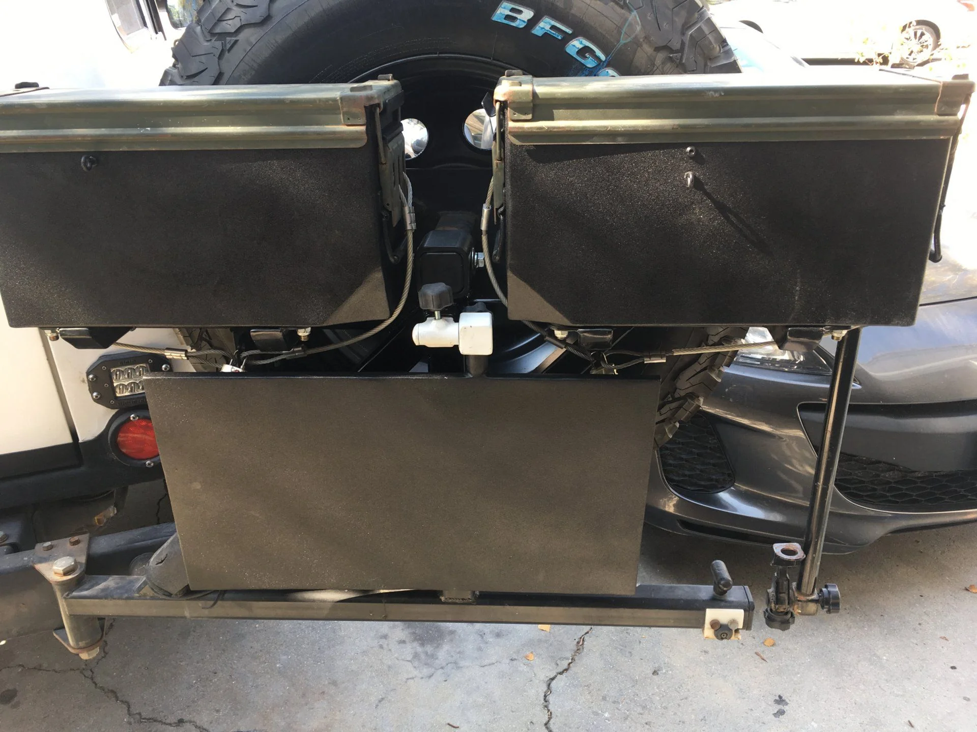

rear body mounts

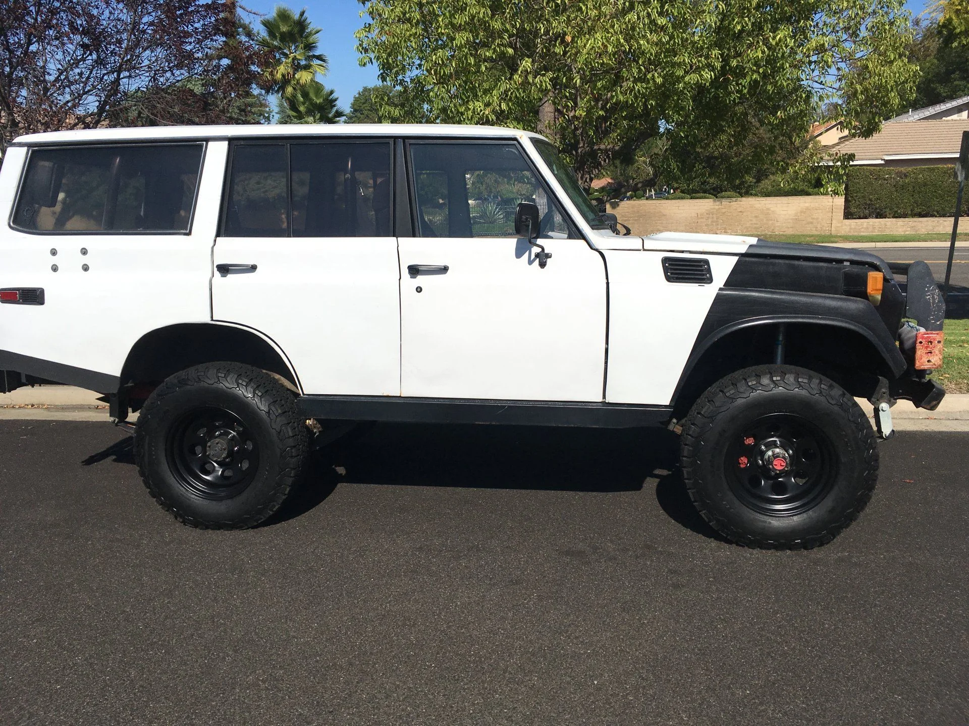

thats not even close to bad yet for a pig , most of ours were way worse
Well that makes me feel better I guess. That hole that has the black paint actually extends all the way around the roof, but jsut covered with fiberglass.
I figure that I get that confidence from fixing that hole by the back seat and then get after the roofline.
Sorry to hear about that crown, but sounds like you've got the right ideas cooking. Just weight the options on the roof as long as you can; and get after that hole in the Cpillar...

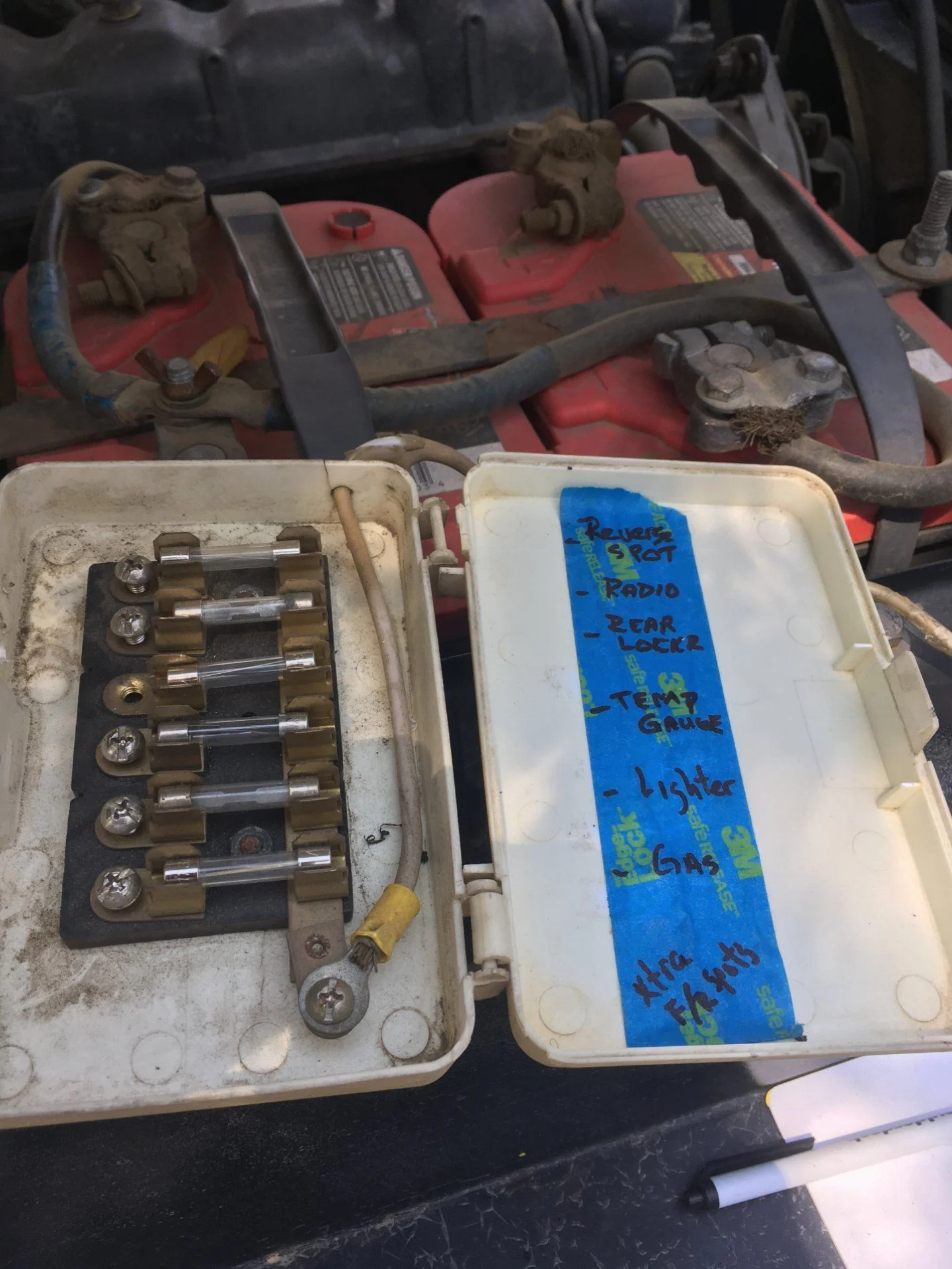

Got this done in the mean time.
I actually had some pride in my bandage box homemade circuit panel. That being said I like this new one better!

Interesting paint job, is the rear cut up at an angle?
Also, what side mirrors are those?

My back mounts were nonexistent. So I did some fabbing- whole rear sill and ran the side angle with some heavier gauge steel. The mirrors (marginally stoked on those) got from SOR. Way better than what the PO had tho.

that truck has come a long ways, C! lookin good!
they look to be FJ40 hard door mirors?
wow cool setup with the rear bar.. I have an ammo box i want to use for recovery gear but wasnt sure about securing it outside of the vehicle.. this is a great option for securing and mounting! keep up the good work!
