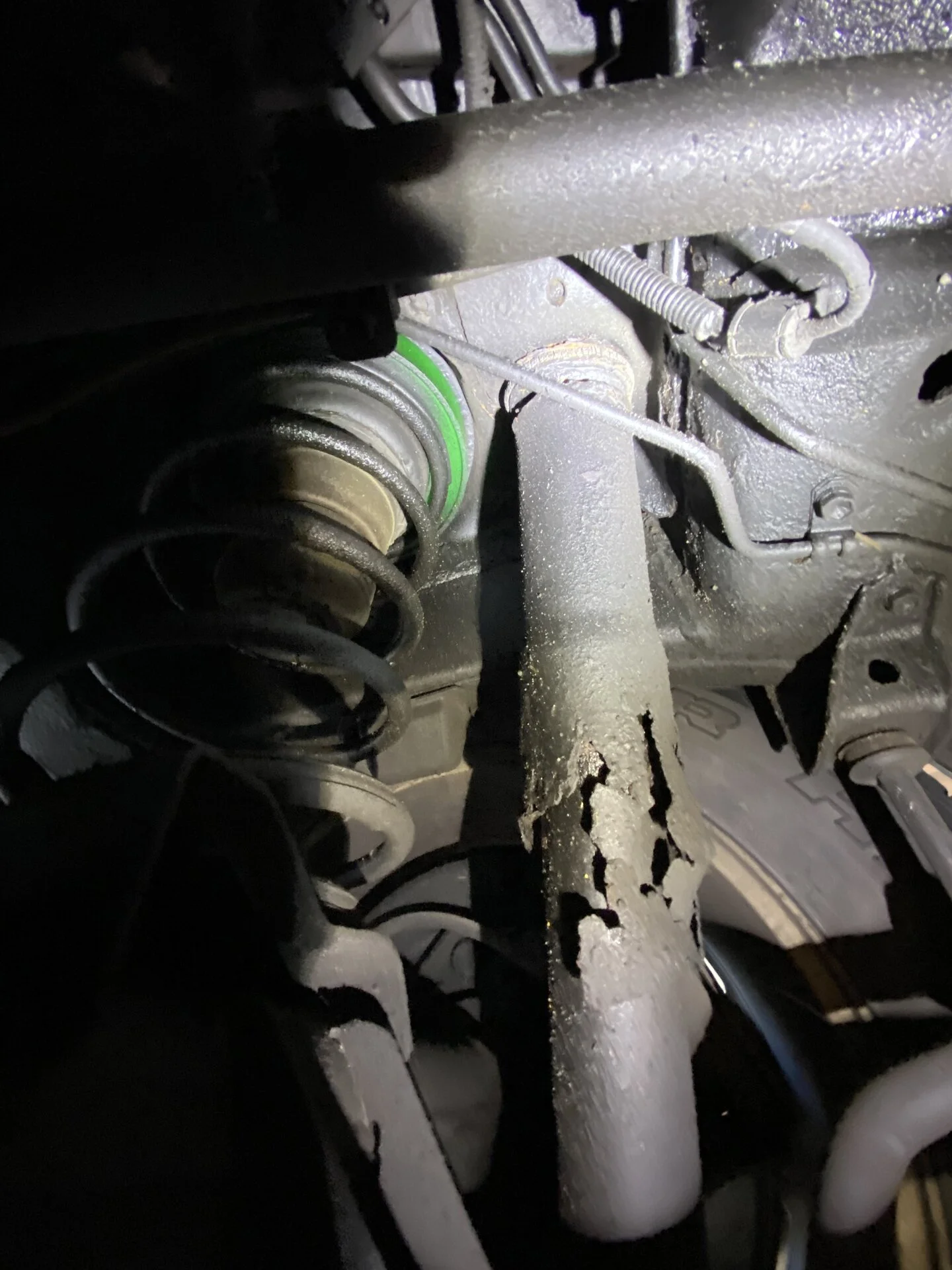

Haven’t driven in a week. Came home to a small oil puddle nearby the DS rear tire. Looks like oil is dripping off of the rear control arm. I can’t really tell what’s leaking because of the oily undercoating.
Before I start cleaning up a ton of oil, any ideas? AHC or Axle leak?

Yep, it’s a small leak from the AHC hardline that runs next to the gas tank. Looks like it leaks down onto the rear control arm and blows back onto the spring when driving.
The AHC fluid is about a centimeter below the MIN line in High.

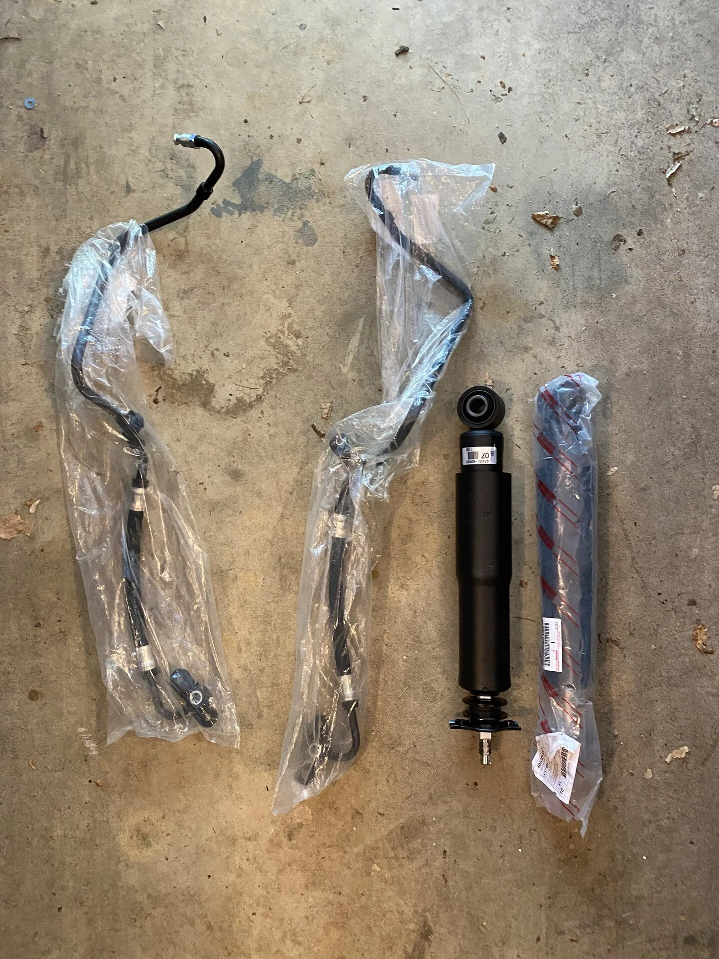

I’m happy I already have the parts, but not happy to do this job. It doesn’t look fun.
Included some photos of the leak to give you all an idea of how rusty things look and how much of a pancake my rear shock bushing is.
