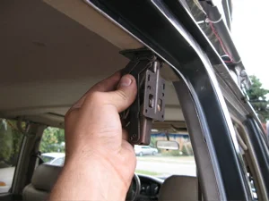

This is a mod I have been wanting to do for quite some time now so i though since the GF is out of town I'd start to work on it. The idea here is to hard mount the cooler (fridge when i get one) so that i can easily get to it at all times (even when the trailers hooked up) That being said this will function much like the work trucks flip up sides. I plan to replace the glass with a solid piece of aluminum which will also allow me to easy mount other items to it on the indside so when it flips out they will be right there (fire extinguisher anyone?) But enough talking and on to the pics.
First few pics are with the rear window removed to show you just how big it really is.
and finaly a quick stop to the greatest hardware store in the world (hardware sales)
and i got a set of these trick european 270 degree hinges what will flip up and out of the way of the body when opening.

cool thing about this mod is if some one wants to run a fridge and no storage box they could weld a frame the uses the stock holes for the rear seats to hold the fridge in place (and right height) they then would still ahve plenty of storage everywhere else and could be easily removeable.
The only issues im seeing so far are the hinge mounting. Originaly i was hoping for a mod that anyone could do with the right parts however it looks as though for this to be a over built setup a fabricated hinge mount plate will have to be made. im thinking utuilizing the upper handle mounting holes as well as the third row and second rox seat belt holes for the plate to mount. I thought about using just the upper handle holes but im afraid if i have to much weight attached to the swing out door then it might be too flimsy. Also by incorperating the seat belt holes into the mount there will be another surface to mount the gas shocks that will hold the window open. This will give me the choice of where and how to mount the gas shocks.

They will hinge from the top and open upward (like a gulwing) the idea of having them drop down was a also played with (could be used as a table) I may to the other window that way however whel it comes down it blocks your access into the truck so unless it had to positions it wouldnt make access any easier.
Looks like it will meet what you want it to do!! I am looking forward to seeing pics of when it is all finished.. Looks like you got a good start to it.. Good Luck,
Keep the pics coming!!
its still going to use the factory rubber seal, fitment will have to be right but basically the two latches i have will be putting the pressure on the door to keep it water tight. if you look at your window now the only thing holding it in place is the ruber gasket (no bolts or screws or clips) Im using the factory window frame and gasket and replacing the glass with aluminum
