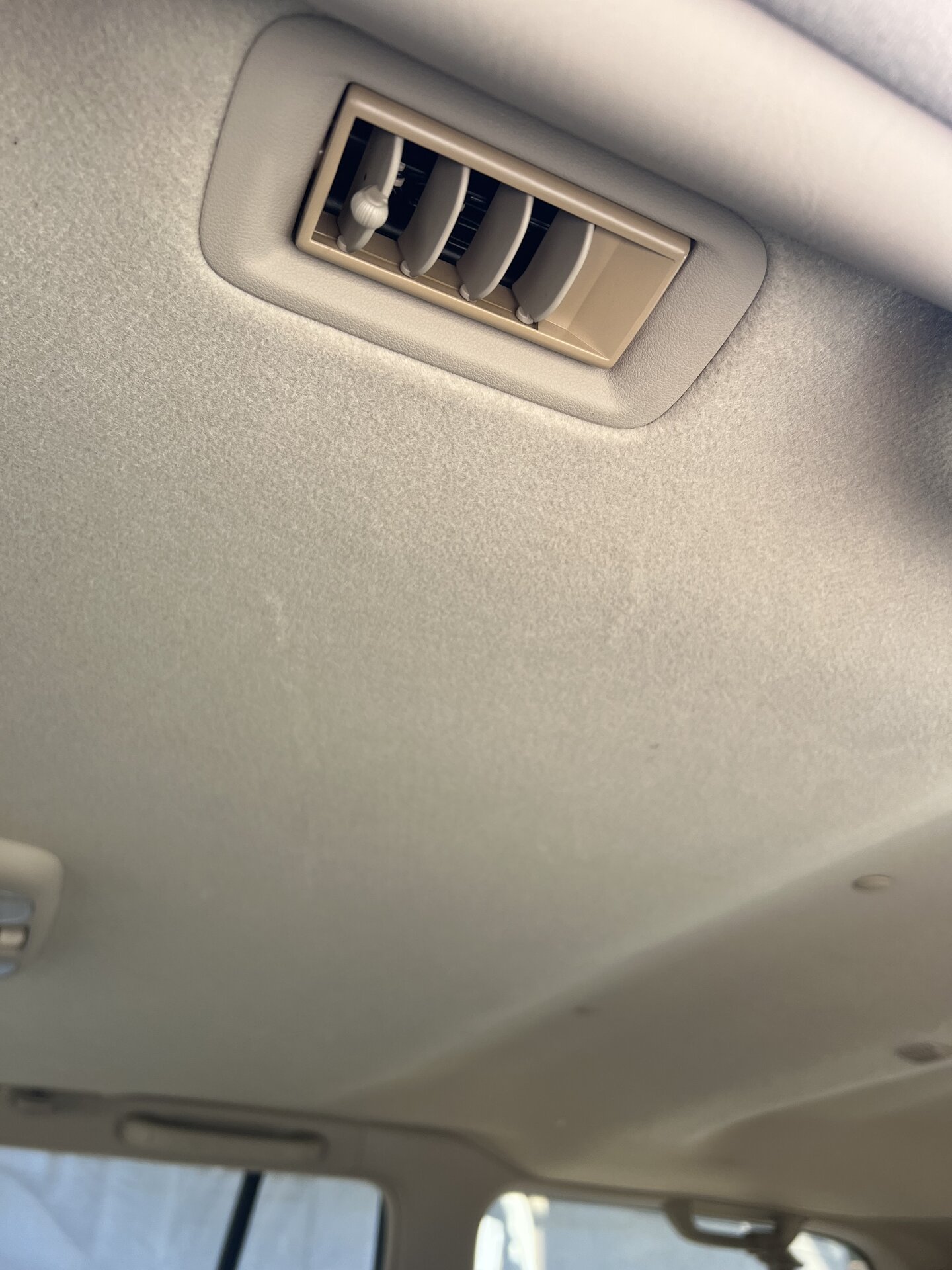

My rear AC is not blowing cold but my front works incredibly. Wanting to tackle this before it really heats up in Texas. Any suggestions before I go down a rabbit hole?
I bought my ‘99 LC 3 months ago and then previous owner did confirm that he recently charged the AC with R-134A at 1.5lbs.
Thanks y’all!
Not sure 99 had rear AC. Do you have vents on the roof right above the 3rd row? the heating for 2 and 3rd row are located below the front seats and center console.
I have the rear vents and AC control on the roof yes!
