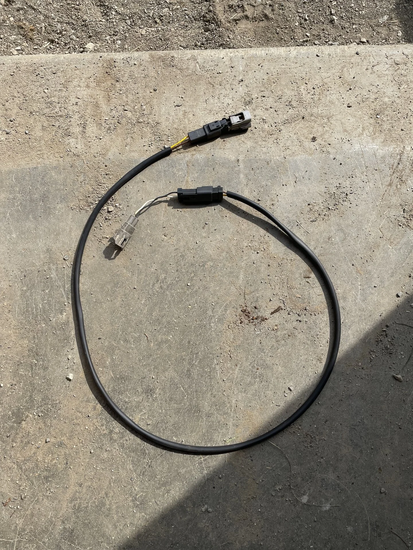

Can you show us how you built the harness?
Got photos and details, wiring type/size, sources for parts, etc,etc??

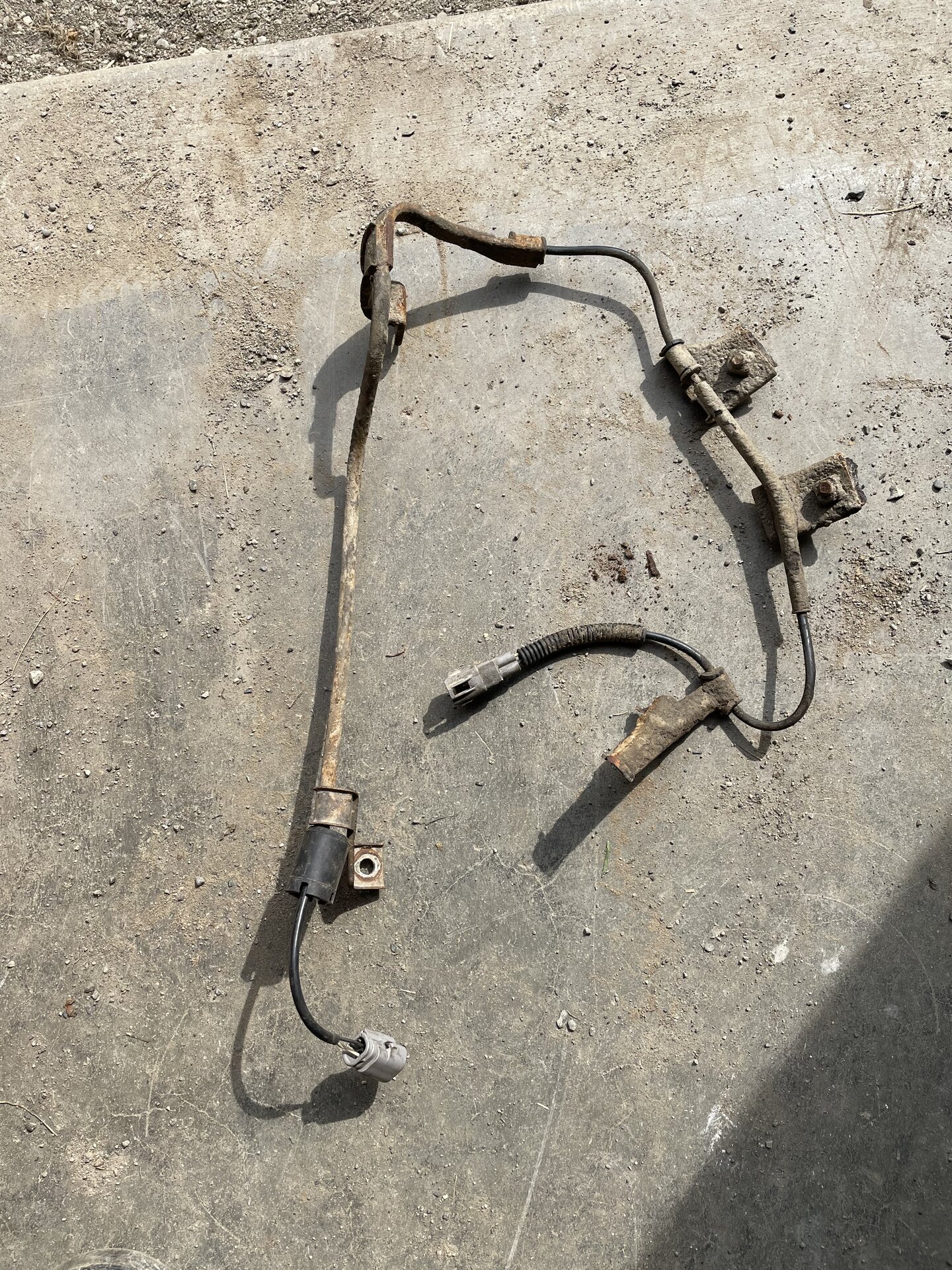

So basically, I tested continuity on the wire harness up to the small section on the passenger side rear. I found a very high resistance on one wire, so I cut the center section of the harness out stripped the wiring back. I had a section of Raychem and 20g wire crimped on DT pins and connectors.
It helps that I own all the correct diagnostic tooling and repair equipment (heavy equipment mechanic for 20 years)
