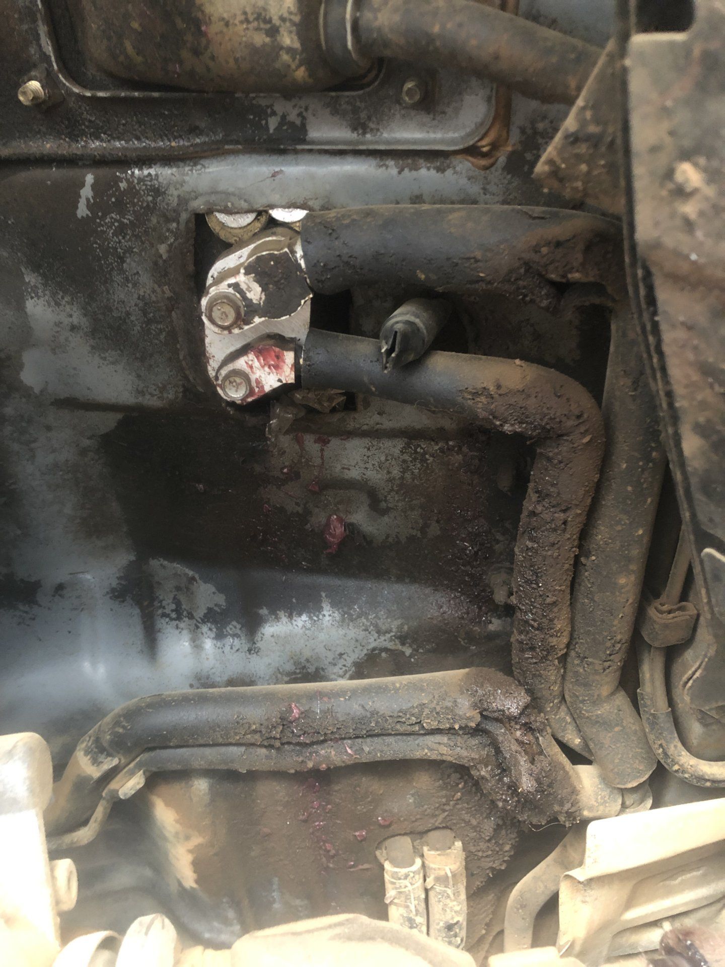

Just came across this thread looking for some answers to an issue with my ice box center console. Maybe somebody here knows.
I also had the rear AC apart today too fixing something small. Anyone know if that rear unit is supposed to turn on the compressor on it’s own? Or does in rely on the dash AC to do that, which is the case with mine. Same question about the ice box center console, does it turn on the compressor on its own? Mine switches on and I hear the fan running but does not get cold, even with the compressor running and while the front and rear ac do get cold. Other then switching on the fan how do the COOL and ICE switches work? What are mine not doing, since I’m sure there is freon in the lines but I’m still not getting cold? Some electrical circuit is not being made I believe.
Attac
Hi. Rear AC should work on his own. Under hood here is magnetic valve that get 12v while front AC or cold box is ON and let freon go to front units (AC, fridge) if the magnetic valve does not receive 12v then it will not cool front units but the rear AC will work (kind of ancestors dual-zone AC control) Did u retrofit your AC system? Or it's originally, I beg your fridge thermostatic expansion valve is gone in two way it prevents freon from entering the evaporator or it get over freezing cuz spring and diaphragm does not adjust the correct amount of freon feed, cuz... 🤓 capillar tube is empty or week
