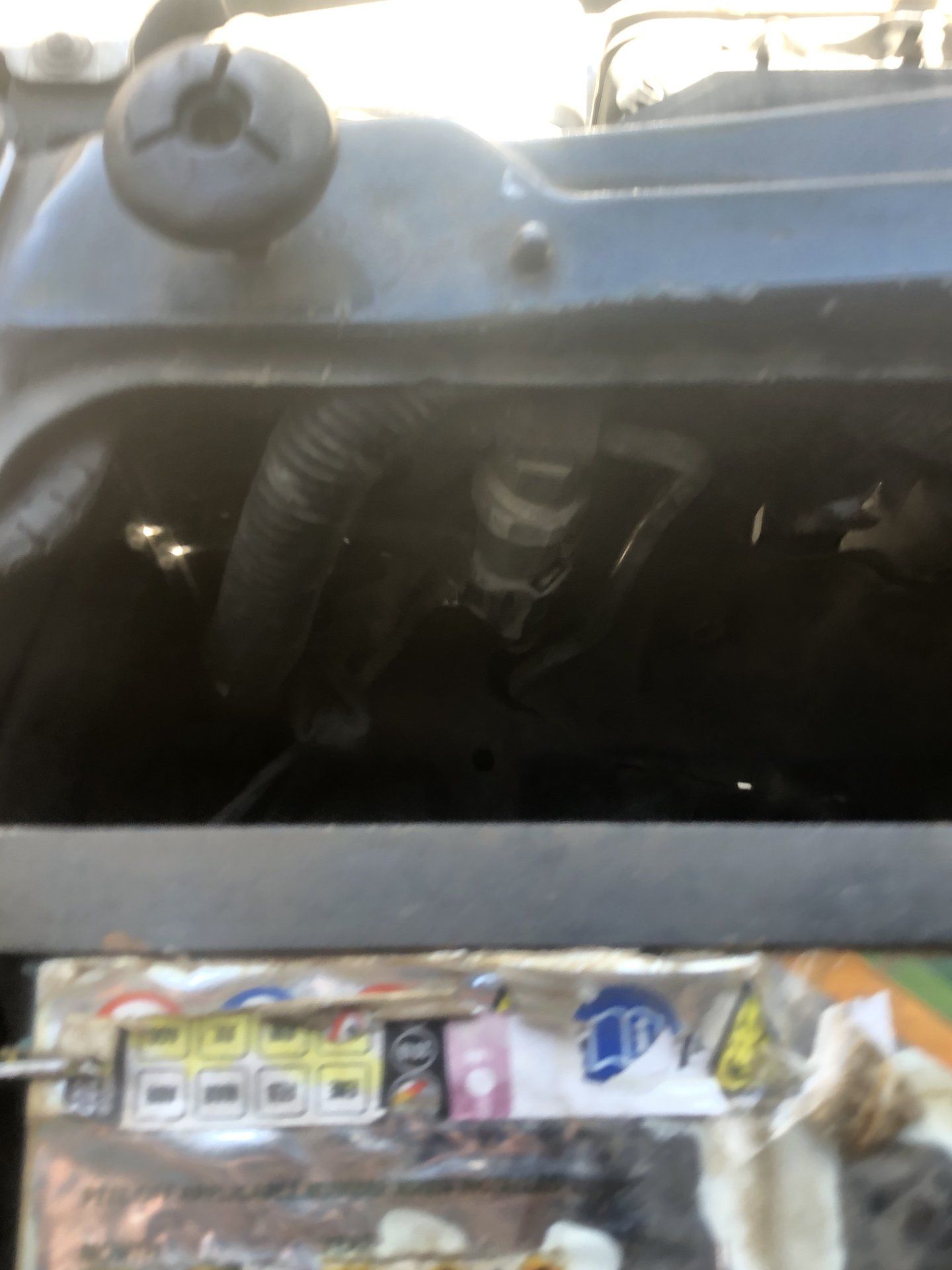

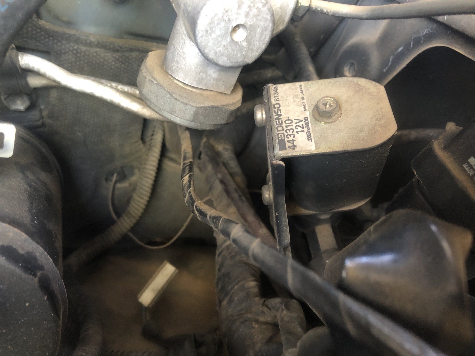

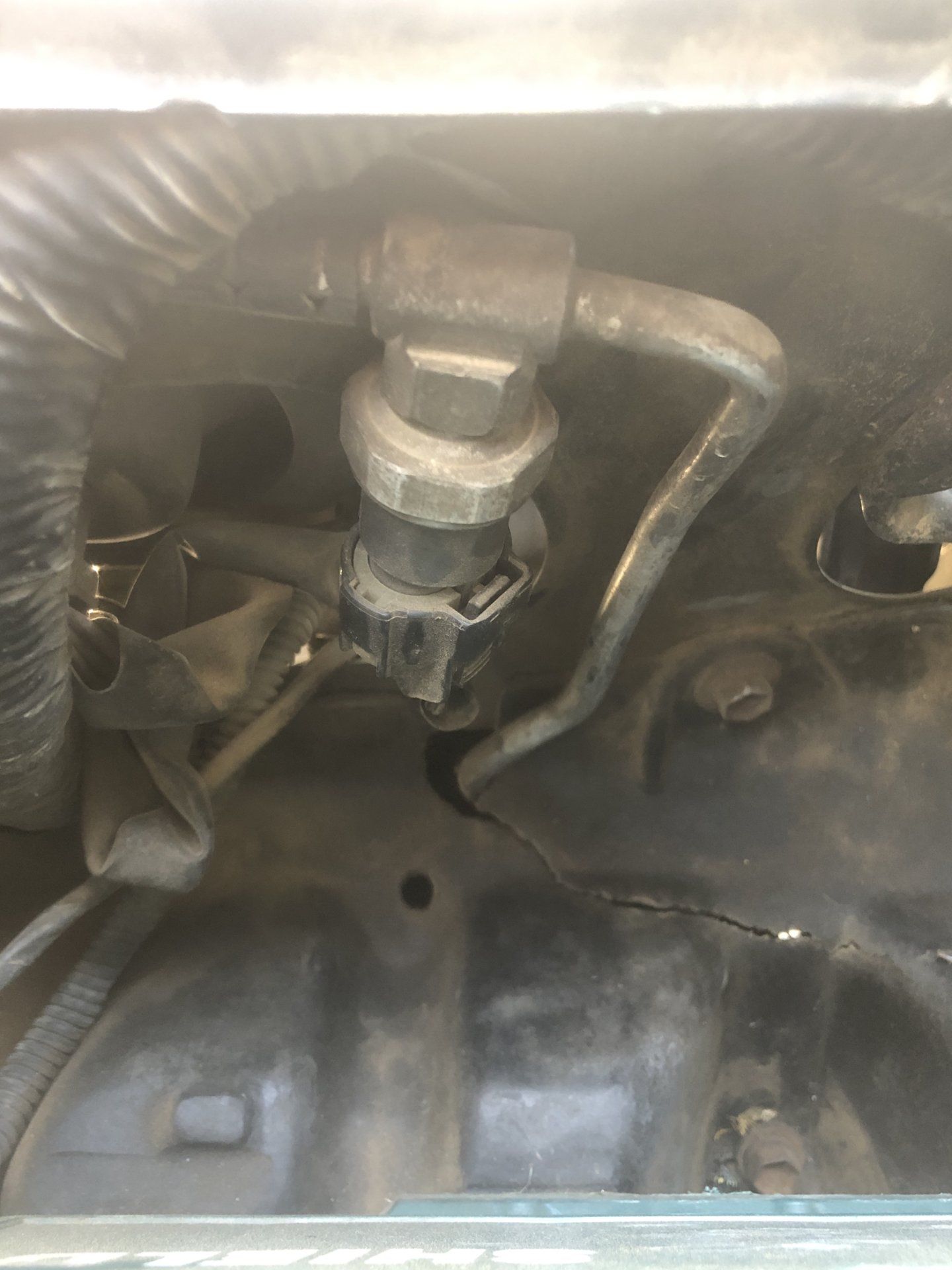

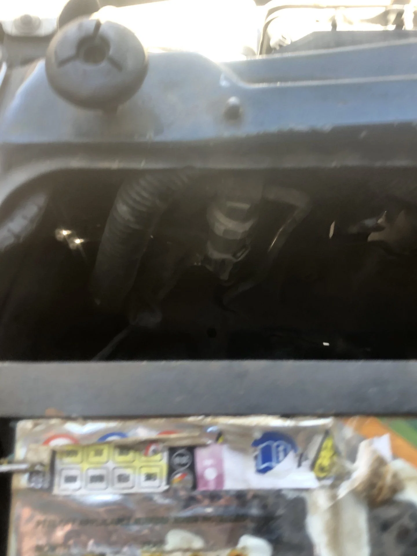

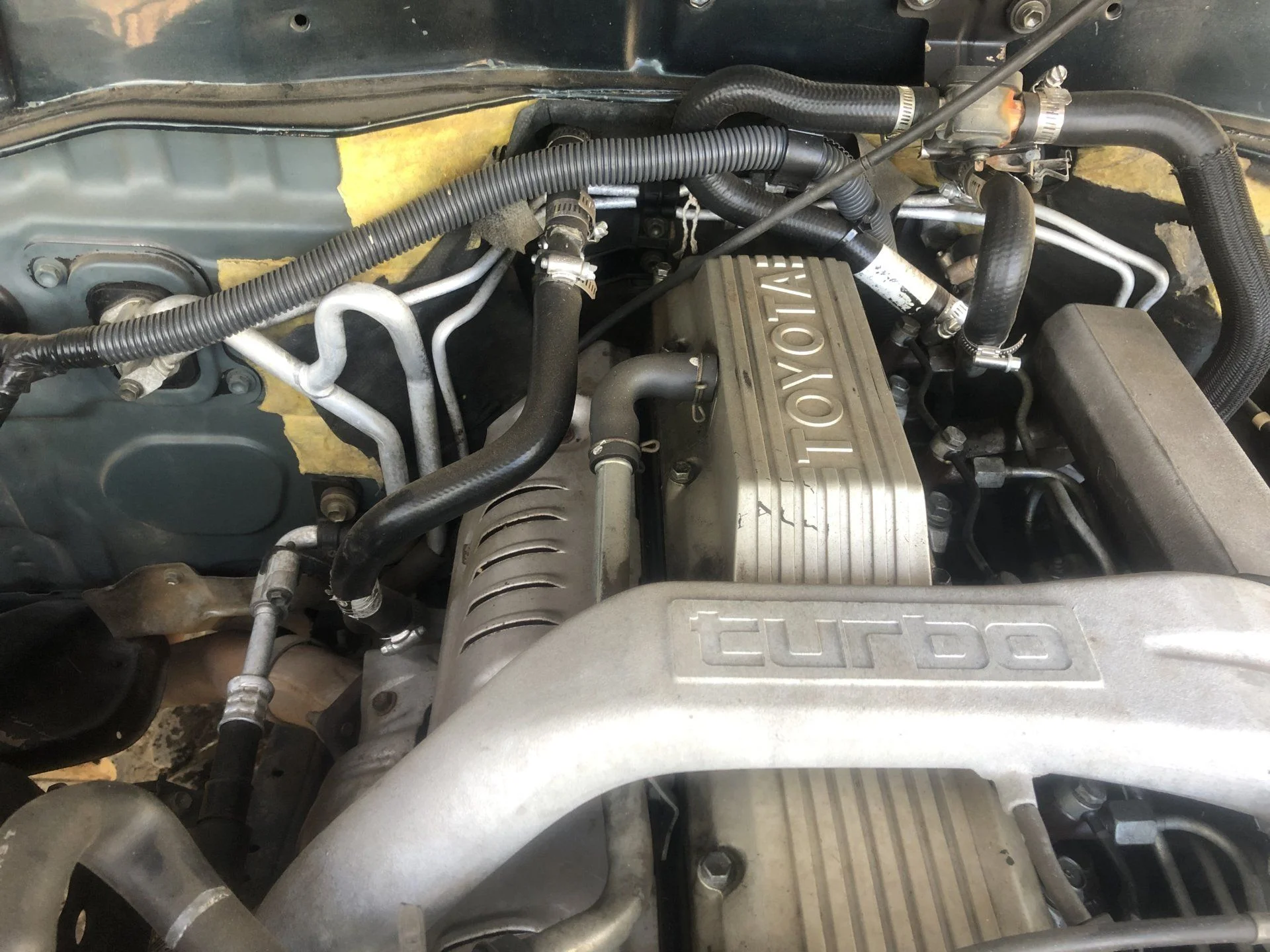

Wow such good info, I found the sight window and I think I found the magnetic valve on the left fender about 12” in front of the firewall. Also found another electronic something just a few inches in front of the sight window (in front of the battery) on the same line. I only have the button above the back seats, nothing for the rear AC on the dash.

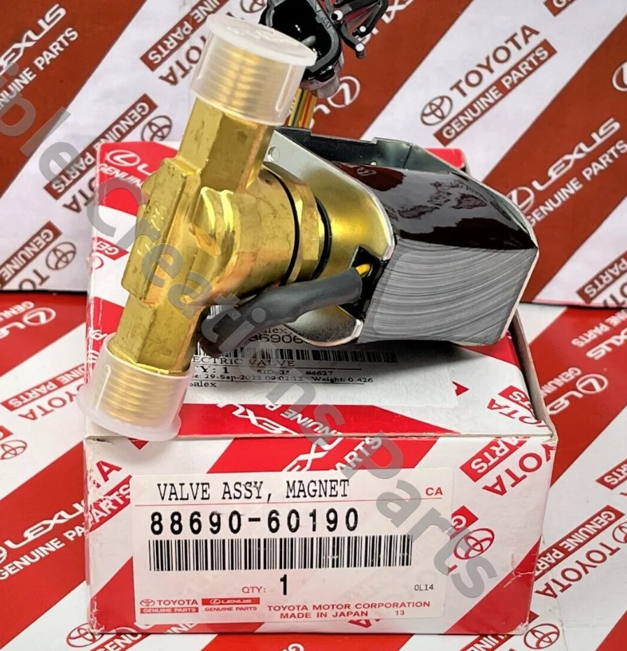

The 2nd photo is the pressure switch that reads the hi and low side pressures and will shut the compressor off if the pressure is out of spec. The 3rd photo, the Denso solenoid is to shut off the lines to the rear a/c when it's not being used.

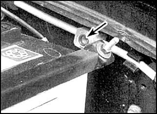

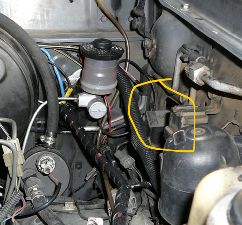

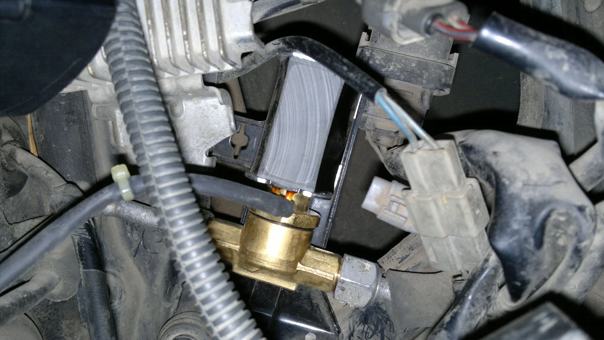

here is where is split .. there is a valve here .. which control the " gas " going to the rear evap when you activate the rear AC switch

When I push the normal AC button in the HVAC controls The green light illuminates on the button but it's like it doesn't do anything anymore. Does that magnetic switch only get triggered by the rear AC or is it triggered by the front or rear AC?

I had to remove that valve when it went down few years ago .. and the consequence, it's you will fill it up the hole system all times.
It wasn't a problem to me but it might be for any other person that does not like to use the rear AC all the time ..
