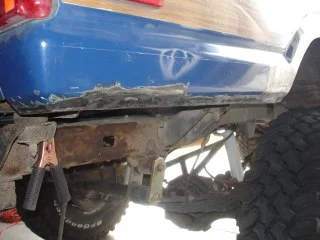

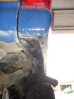

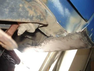

So I got the PS rear quarter welding finshed!
It was a real PITA trying to make and weld the under plate to fill the hole of the chop, but...it came out OKAY!
Thankfully Im rhino lining it!
K

Now Im gonna have to clean and paint the frame rail back there...
Its a whole "can of worms" that I didnt really think about till I got into it!:o
K
