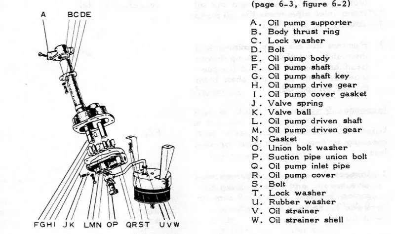

I pulled the external relief valve, smoothed out the grooves on the metal piston, re-installed and piston moved smoothly(I don't believe it was binding before but touched it up anyway).
I still have the high oil pressure issue.
Over a span of 5-10 minutes, the oil pressure gradually climbs to the 4th quarter of the gauge and then I shut it down. Reving the engine did not seem to accelerate the pressure climb much.
With regard to the oil pump relief valve, would adding motor flush or Marvel Mistery oil be worth trying to loosen any bound valves, as opposed to jumping to dropping the oil pan and dismantling the pump?
