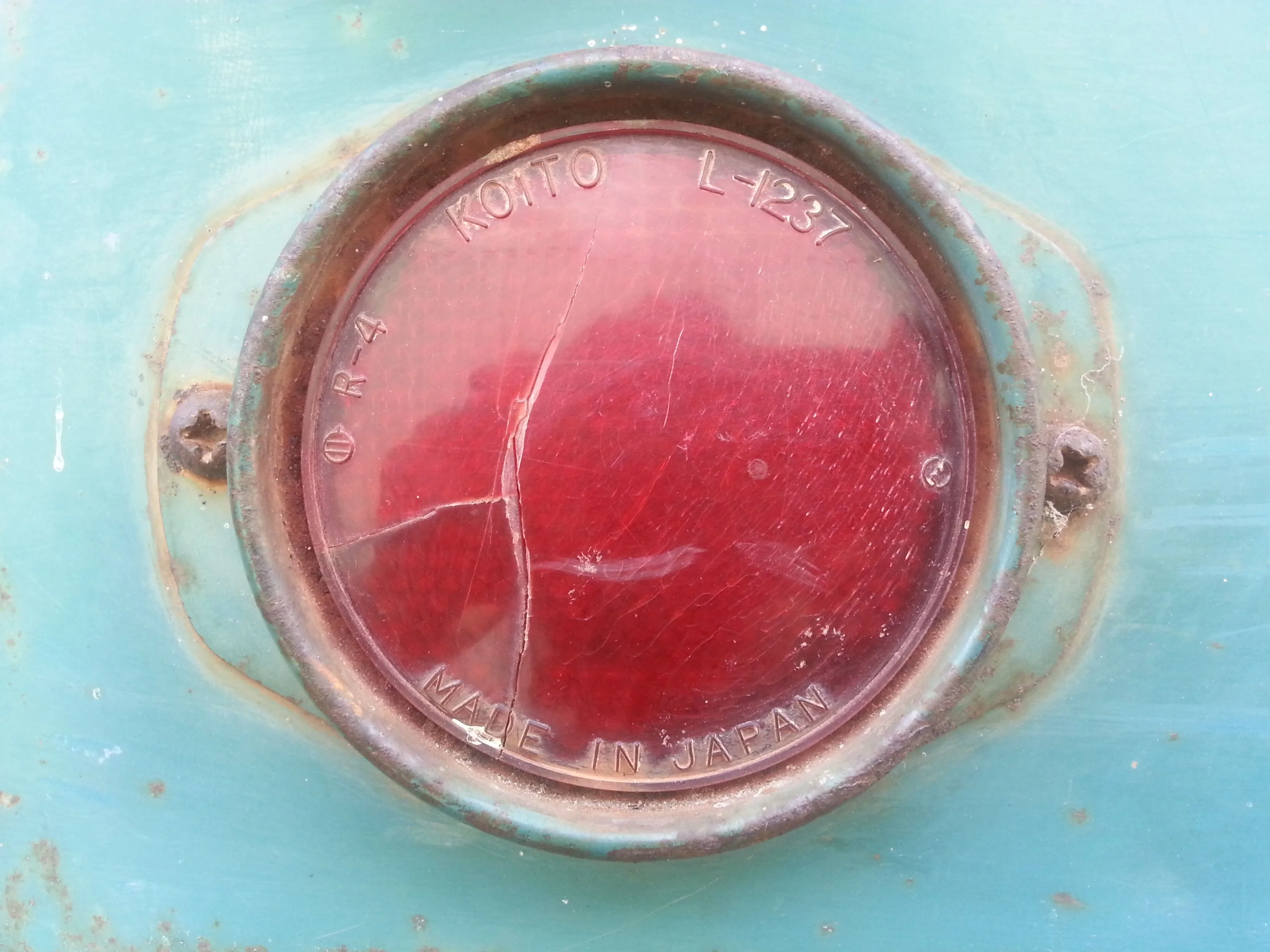

The later Koito sealed beam headlights were put on other Japanese vehicles. I find them on Subarus, Corollas and such. Maybe yours were put on other early Japanese vehicles and a search there will turn some up.

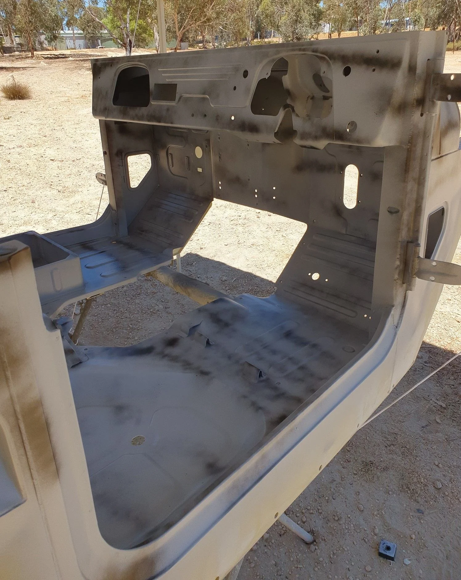

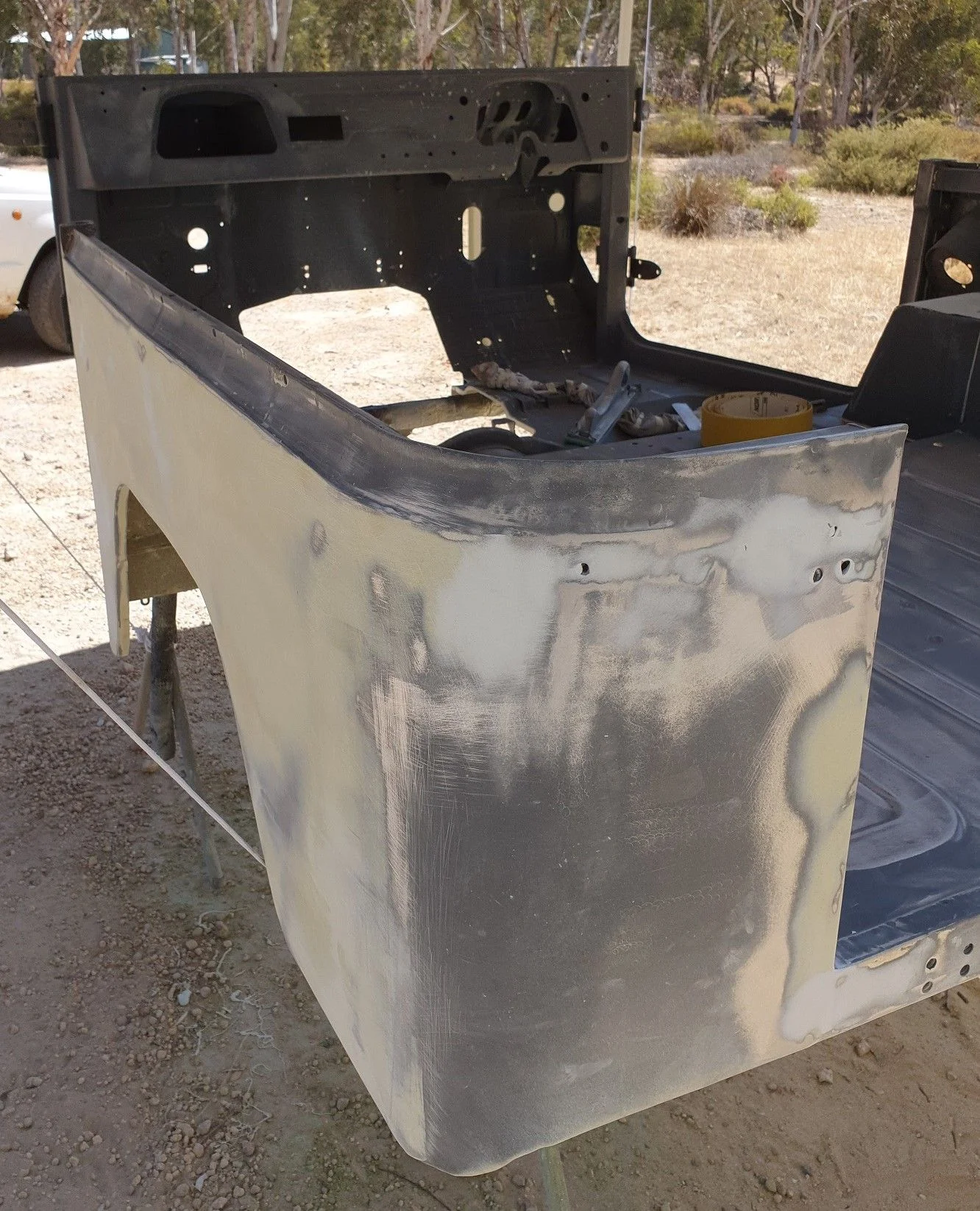

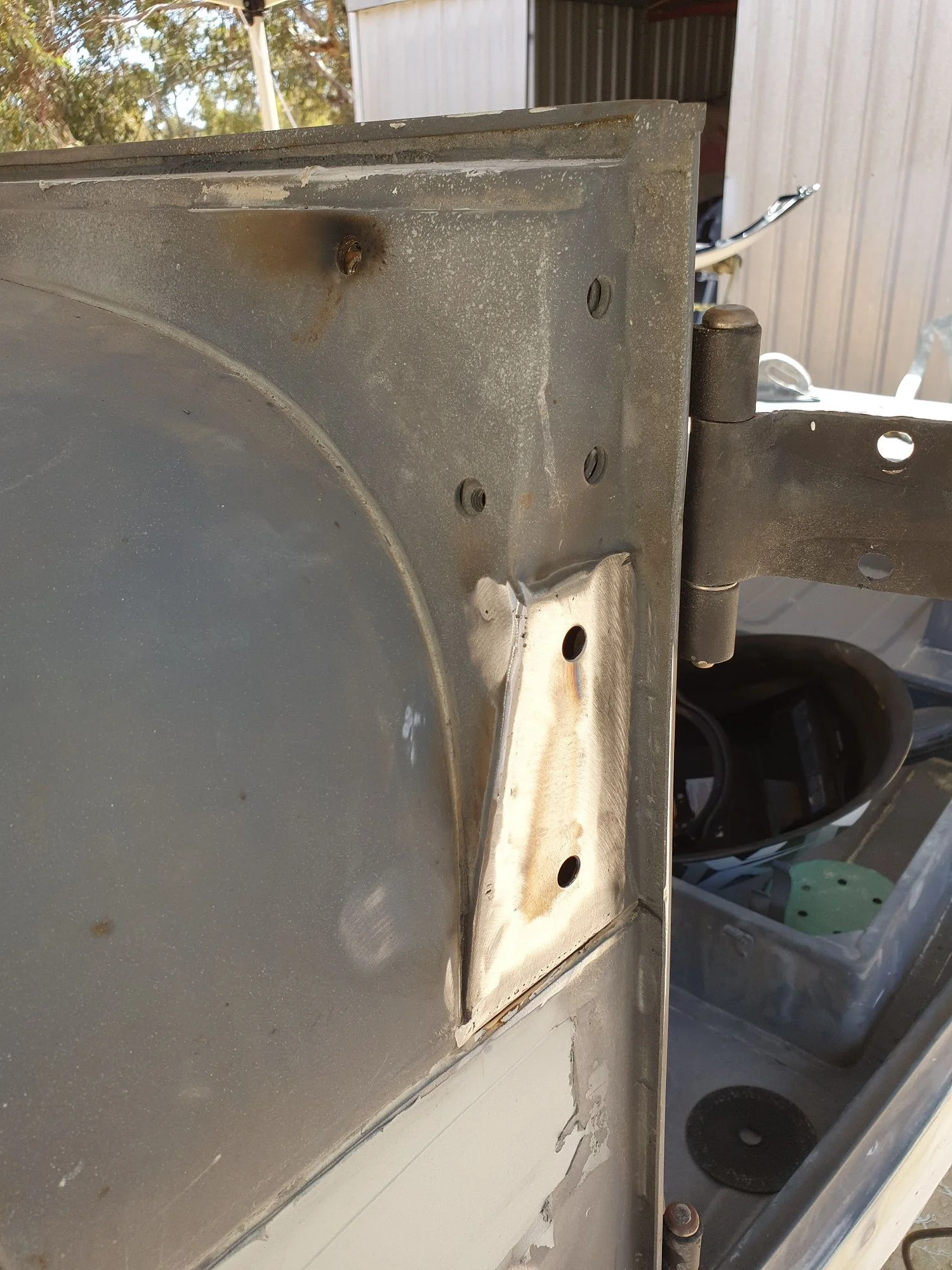

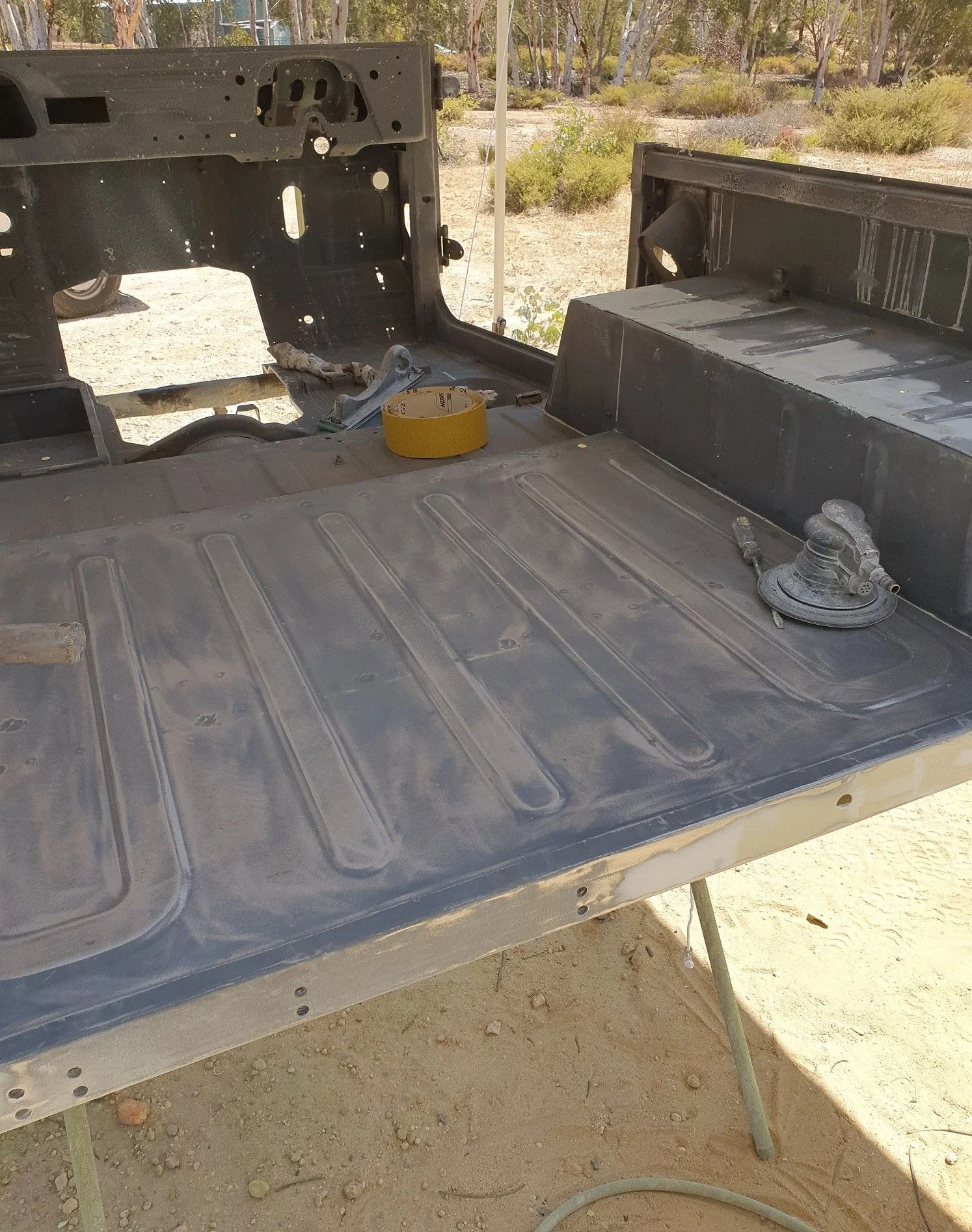

4 w/s hinge bolts. two side bolt holes below that look like mirror mounting. that's where my 45 has the mirror
my wag
1 is dimmer switch
2 are where the wiring harness passed through with a big grommet
3 is throtlle pedal mt
4 master cylinder
5 steering column (i'm guessing this was a floor shift?)
6 is about where the fuse block would mount, but seems close together
7 ignition
8 turn indicators
9 lights wiper choke

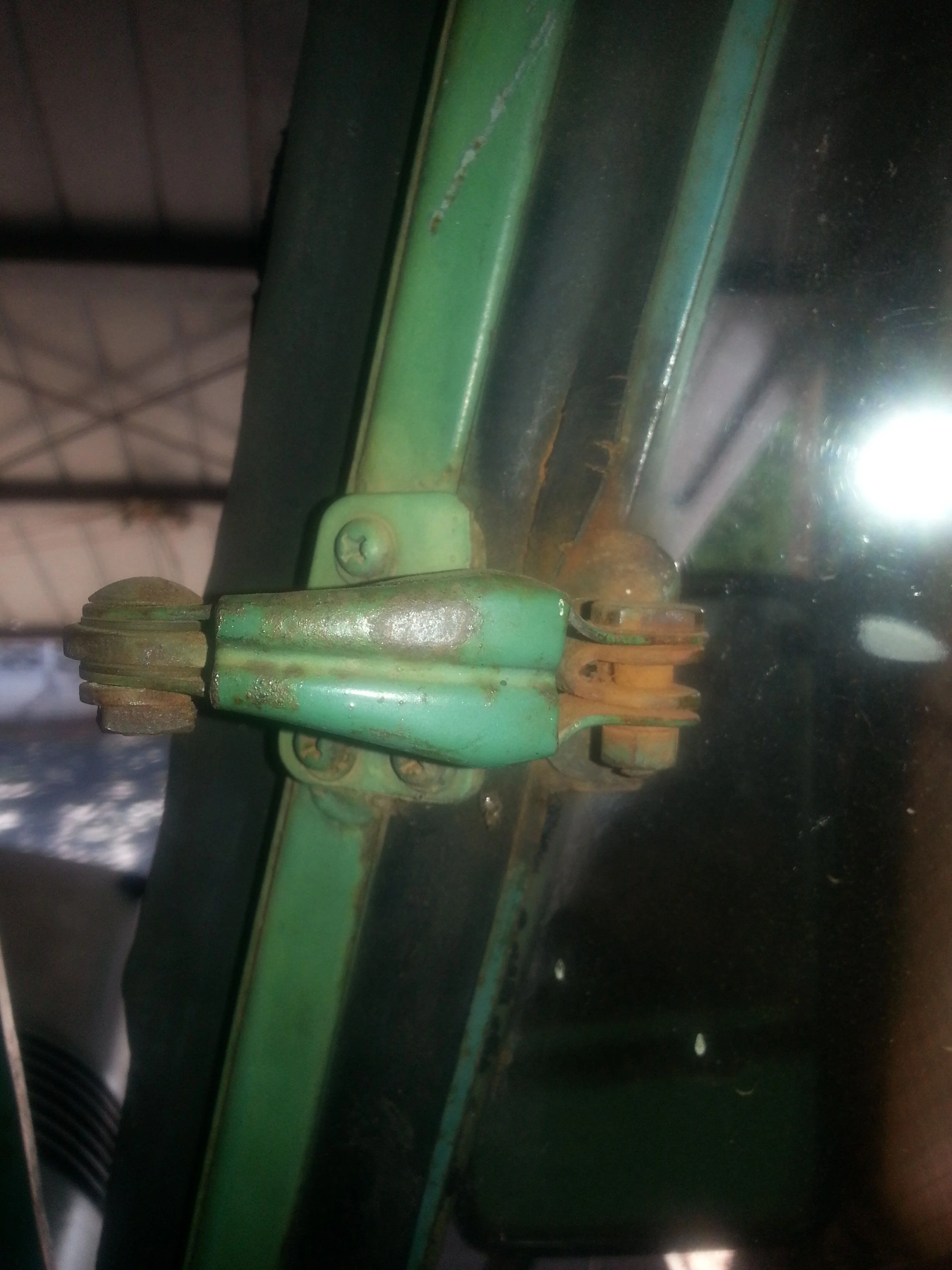

10 windshield hook
11 int light
radio is not original not sure on the rest, no 40 series here to look at, so i'm going off memory
