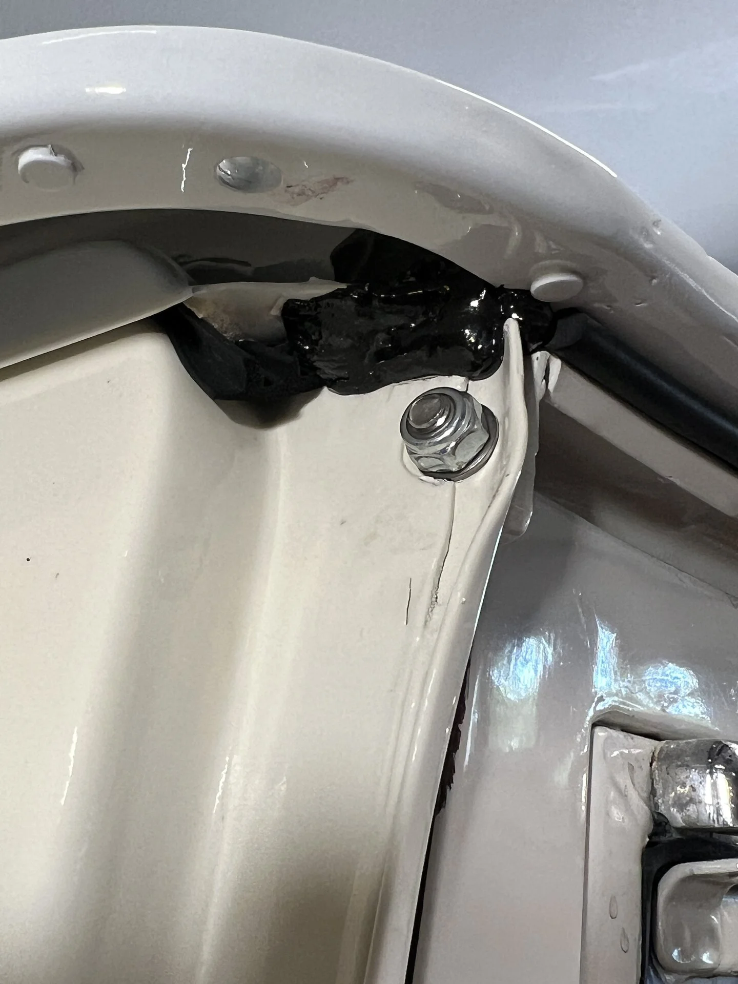

Did you use butyl tape, or did you find another solution for the gap? Pictures would be appreciated. I am in the same process right now.
Thanks.

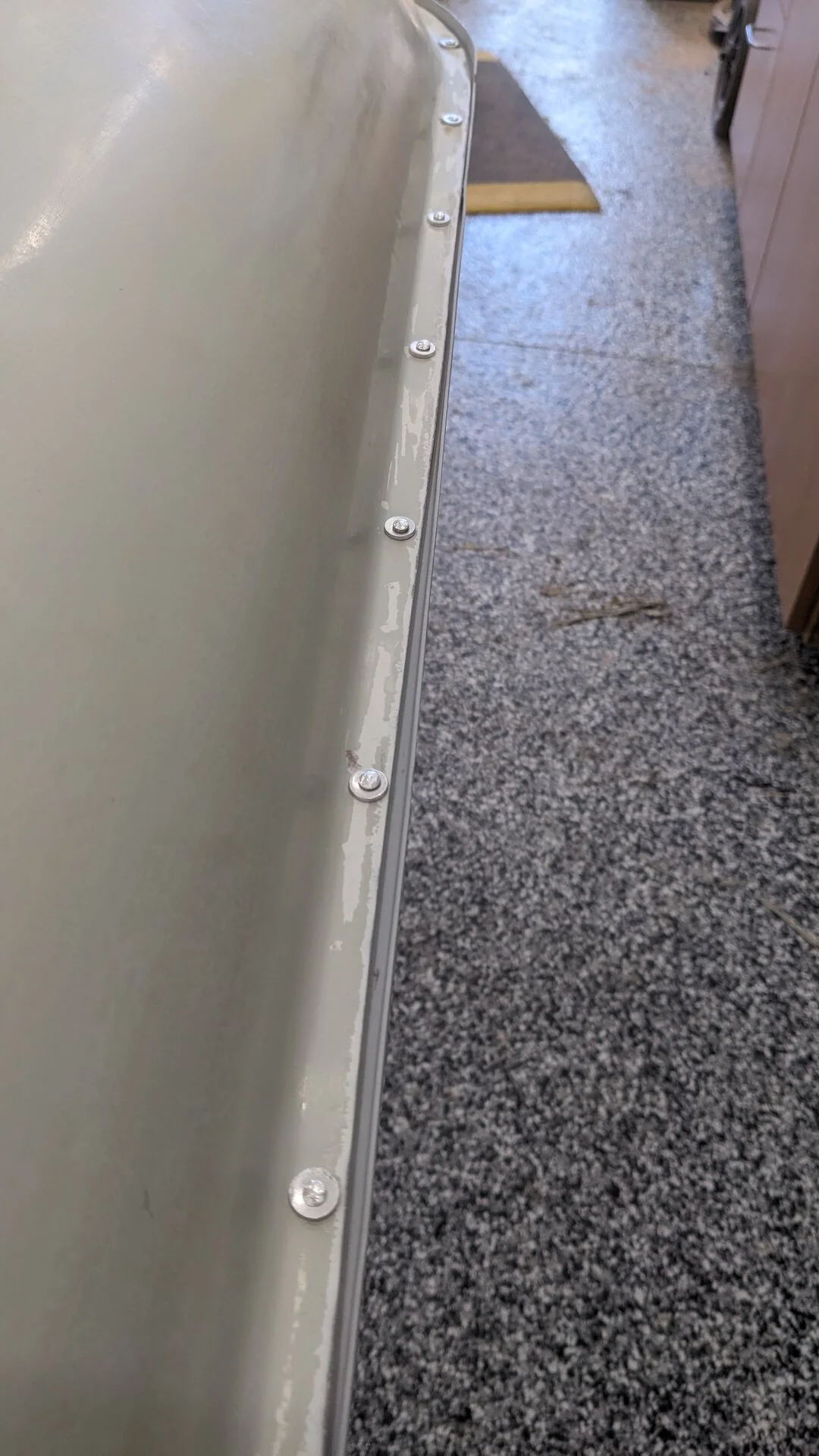

I ended up using butyl tape I picked up on Amazon. Worked out great!

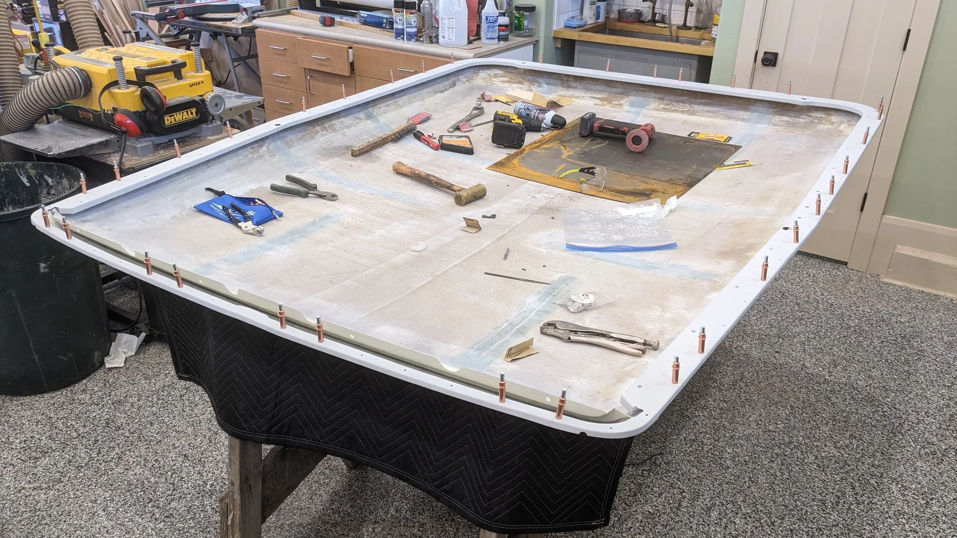

If the brotherhood of the traveling vice-grips is still in effect, I could use them. After trying to remove all the old caulk/seam sealer from my top in an effort to reseal it, I'm throwing in the towel and just going to remove the gutter completely to ensure I get all the gunk out of there before resealing.
The brotherhood still exists. Send me a message with your address and they will be on their way :)
And whomever uses the pliers MUST document their repair in this thread.
Thanks again for the customized vice-grips. I can't say this job was too exciting, but it was riveting :rimshot: They are now available to be passed along to the next person that needs them, just give me a shout. One thing I noticed is that if after clamping them if you give them a little 1/2" wag back and forth the formed dome of the rivet seemed a little more uniform.

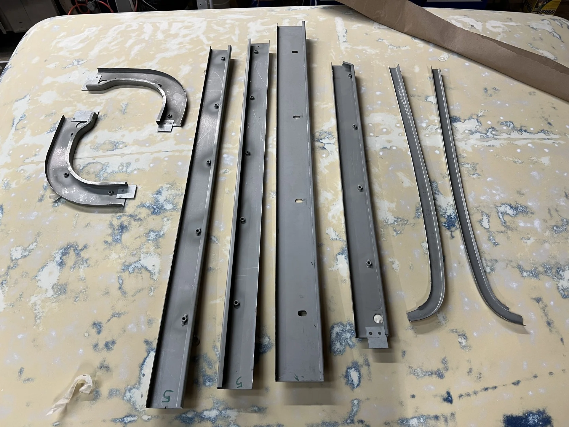

I received my ccot drip rail today - it is nicely made and it seems to line up well. I was pleasantly surprised that it had the captured bolts already welded in place. As @DangerNoodle's post above describes, it will require some work to get the sections to fit exactly. I say get a welder (I splurged last year on a lincoln powermig) and have at it.
In contrast to @DangerNoodle's method I think I'm going to tack weld it while installed on the truck. The existing drip rail isn't an accurate flat surface in my situation.

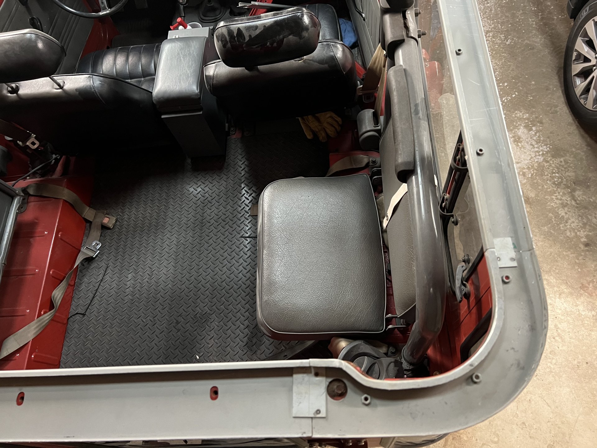

Personally I would have it fixed. Or better yet, take the opportunity to get a little MIG welder and learn- it's not hard at all to learn how to do the welding necessary for sheet metal work! Don't be intimidated. This isn't a structural repair- nobody's life depends on it. And if your welds look crappy, you're going to grind them down anyway.
I think you should repair it because If you hit it with a wire wheel/angle grinder, I think you're going to find that the rust turns to dust and you're going to have holes. That rust is pretty bad.
I would recommend patching the bad spots rather than getting a new gutter. The Cool Cruisers full gutter comes in pieces without any of the rivet holes drilled. So it'll require some careful fit-up work (bolting the pieces down to the hard top sides and door headers, placing the fiberglass top on it to make sure it's all aligned, adjusting, tack welding, and then carefully drilling the many holes for the rivets. Fiddly work. If you take it to a pro, they're going to need the entire cruiser to do this properly, and frankly I wouldn't trust a shop to have the necessary patience. If you can bend the damaged sections back to flat (I'm sure you can), then I'd just patch the rusty sections. It looks like it's just the horse shoe sections that need replacing.
An in-between solution would be to just replace the "horse shoe" section with the cool cruiser panels if those are your only bad spots:
I would first bend the bent sections flat, brace it by tack welding some angle iron across the corners to keep things from moving on you, carefully cut out the corners, and fit/weld in the new horse shoe pieces. Then you just have to drill a few holes for rivets.
One of the things I learned with my resto is that sometimes it's easier to just patch the rusty spots than replacing the panel with aftermarket parts. Aftermarket parts always require a lot of fitment and adjustment because they're never perfect... and you have to spend a lot of time aligning the parts and measuring before welding in the replacement panels. Replacing entire panels for one section of rust can easily become a "throwing the baby out with the bath water" situation. Your rusty original panels fit your rig, so there's an advantage to keeping as much of the original panels as you can.
