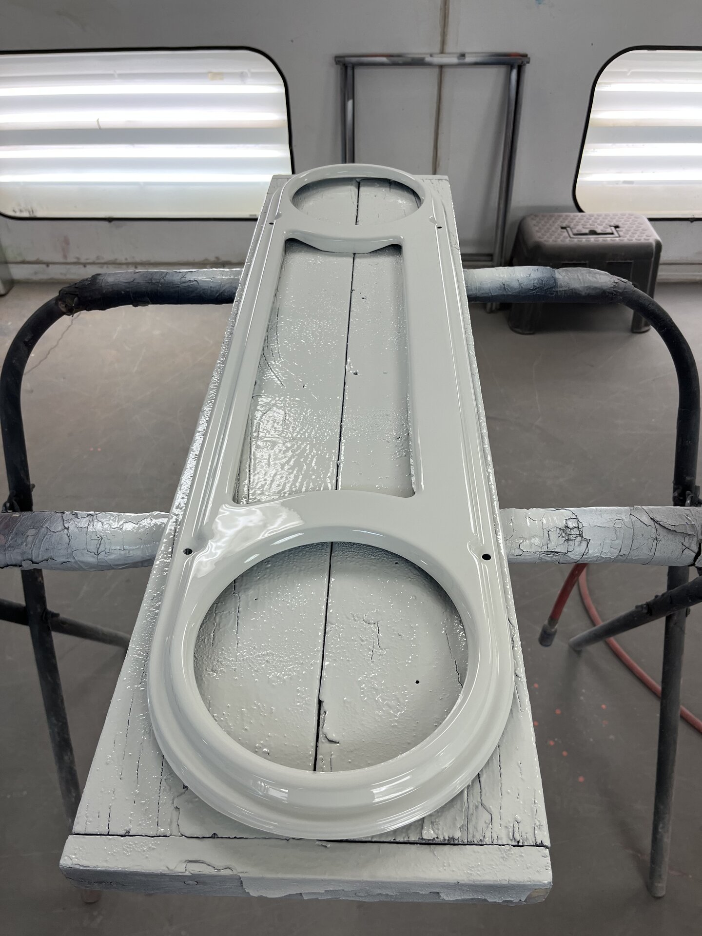

Slowly with the roof – first up is the visor – was not riveted to the roof. And metal mite activity present. I’ve never welded, so this Dark Arts stuff.
Decided to use my only defense against the Dark Arts…. My checkbook.
They chem dipped to strip paint, welded some metal, primed it, handed me a bill, and abracadabra … the parts back.
Now on to a) sand and paint b) look at how I want to fasten this back (I’m interested in the binding barrels and Screws vs 7 rivets - any thoughts or experience out there?) to the roof at the proper angle c) look at a welding class at the community college so I can then be a Pro d) take on the roof rail and dig into that rust as a Pro.

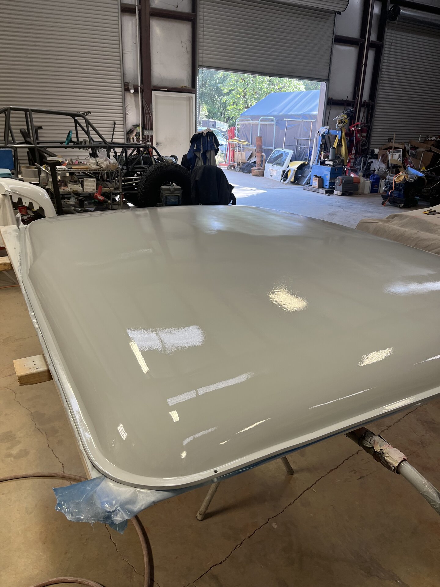

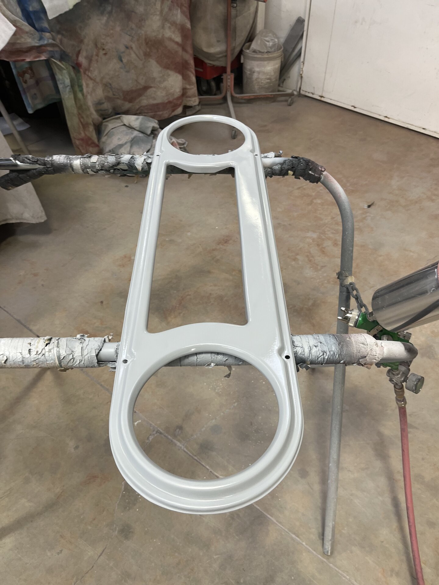

Getting really close. I picked out a color, and it's with the painter. This morning he blocked it with 180 grit and laid down 2 coats of polyester primer. 2k primer and then paint this Thursday. He is a solid dude and has a pro paint booth in his shop. Really glad I went with this guy.

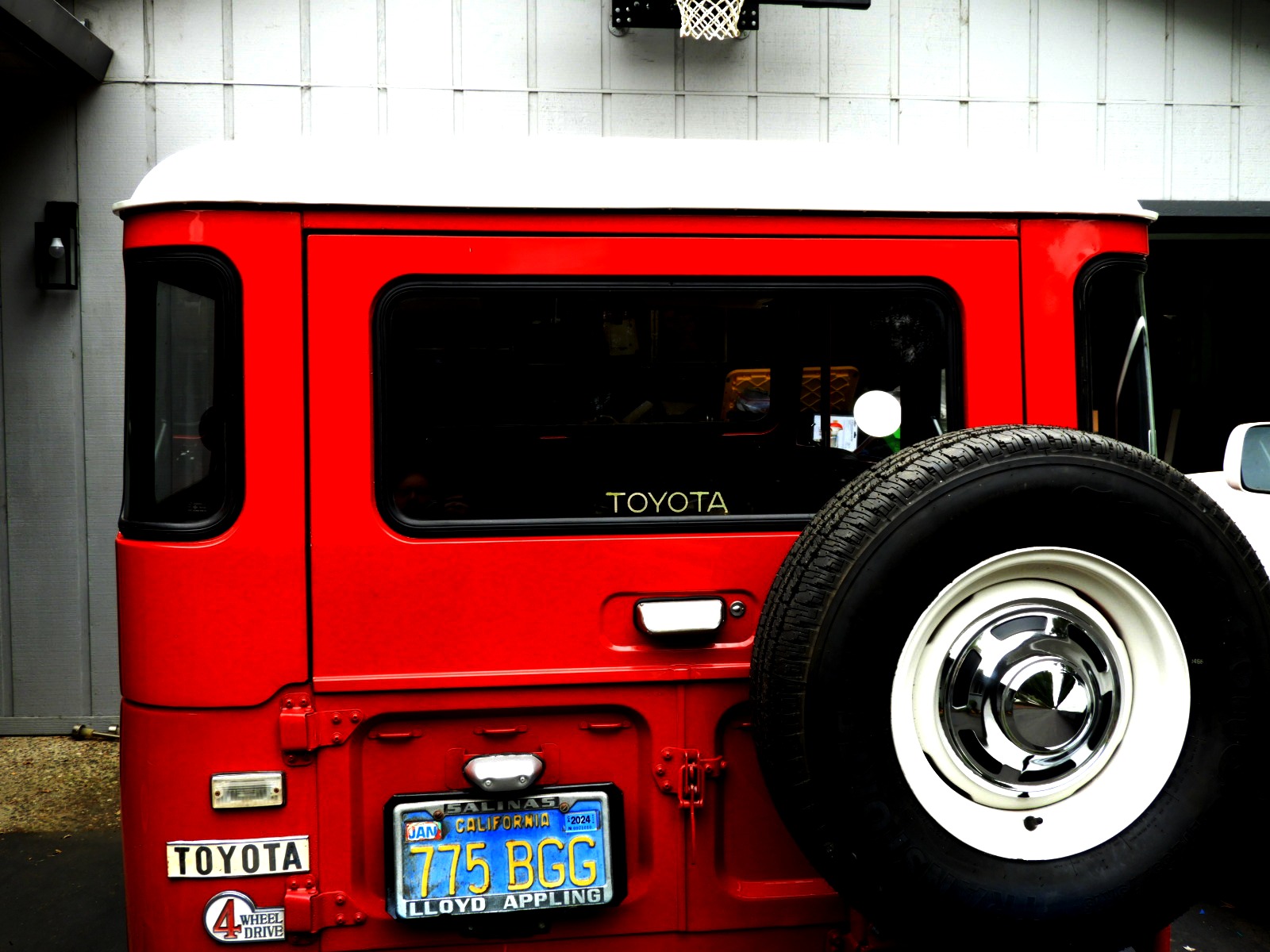

Picked up the top and bezel today. I am happy with the white I picked out. I considered the other white colors I have seen on other threads, but they were either too tan or too bright white. I went with Toyota 068 Polar White. It went well with the body color, in my opinion.
