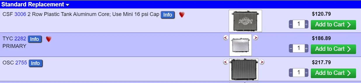

Has anyone had good experience with any of these radiators from Rock Auto?
I have used several TYCs in my hundys over the years, with good luck....but I got them from Amazon at about the same price. One or two of them actually were in a KOYO labeled box.
I got a CSF installed 5 years ago, no issues with fitment and crossing fingers while I type, no leaks.
BUT, the ONLY reason I got it is because there was a radiator distributor in my area (not selling to public anymore, sadly) and they had it in stock, so I didn't have to deal with shipping damage. I wouldn't have bought it if it needed to be shipped. And 5 years ago I didn't know that Toyota of N. Miami was in the loop with the South East online discounts, so I would have paid 3 or 4 times more for a radiator that needed replacement asap.
BTW, used OEM cap, not aftermarket there..
Do you plan to own this vehicle for a while? If so, go OEM.
My Koyo lasted about a year before the seam at the top by the hose inlet split.
OE lasted from 2007 - 2021
Koyo lasted from 2021 - 2022
Similar stories with all aftermarket brands. Some have great luck, others not so great. It's not worth the risk to me to roll the dice with parts on a truck I drive every day with my family.
I have a 10 year old, probably 150k mile CSF in mine. No issues.
Personally, I went to the Lexus dealer. 450$ picked up.. after “Lexus days” promo discount on the online price.
The extra 200 is well worth the piece of mind. It replaced a leaking denso unit that looked fairly newer. The OEM unit appears to be much higher quality. Hoping to get at least 10 years out of it.
Cooling system is not a system to skimp on IMO
I got the KOYORAD A2282 and it has worked great for me

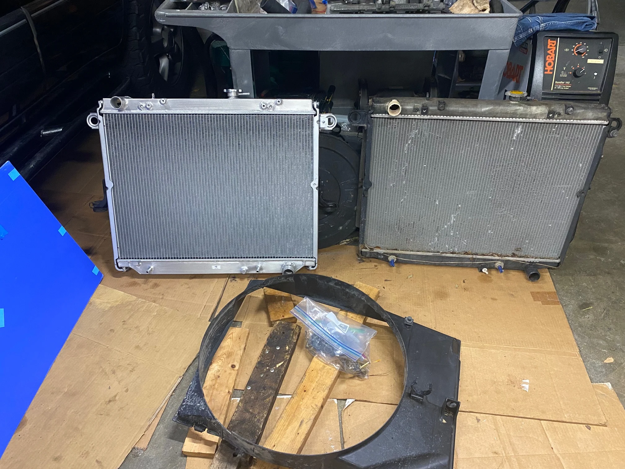

Refreshed my memory from the big radiator thred. Seems there were rumors of toyota using a different source for their radiators in the 2020-2021 time frame. Also dealers may have substituted aftermarket radiators at the time when doing repairs but charging for OEM. Further reports of OEM radiators leaking within a year. That's what led me at the time to replace with the Mishimoto. But if Mr T is making the radiators, that would be my first choice. But I've been happy with my Mishimoto(all aluminum) They can have issues, but if its good, its good.
To the OP's questions: I would avoid the aftermarket radiators that have plastic tops and bottoms. Way too many reports of failed radiators within a short time frame
