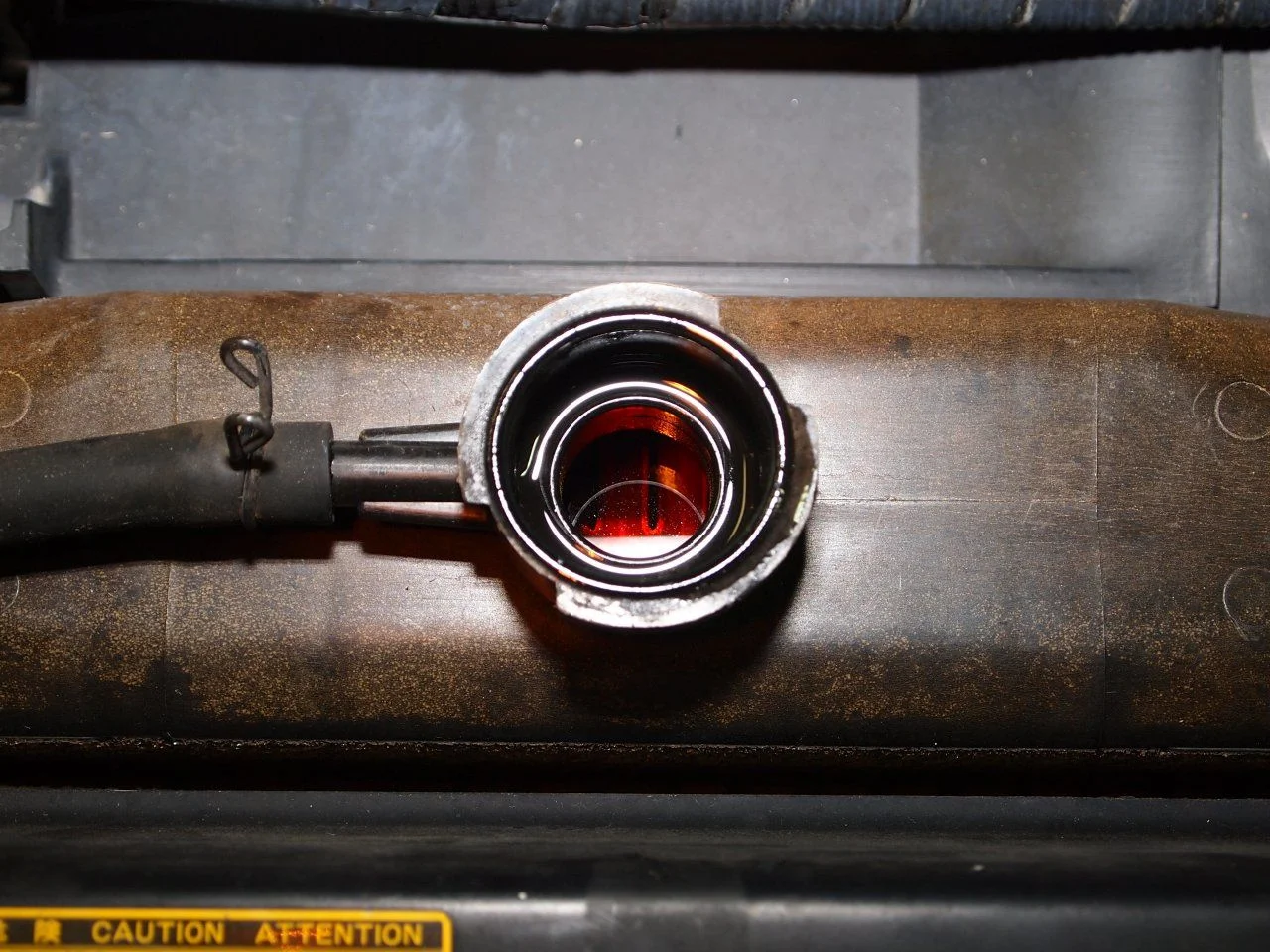

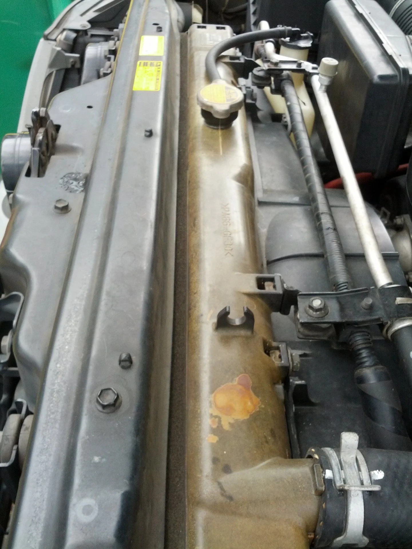

I was at 164k on my OEM radiator before it completely failed (it split at the top). Keep a lookout for the plastic parts of the radiator turning a brownish color, that's a good sign it's nearing its failure point.
Here are a couple pics I stole from other threads showing the brown radiator:

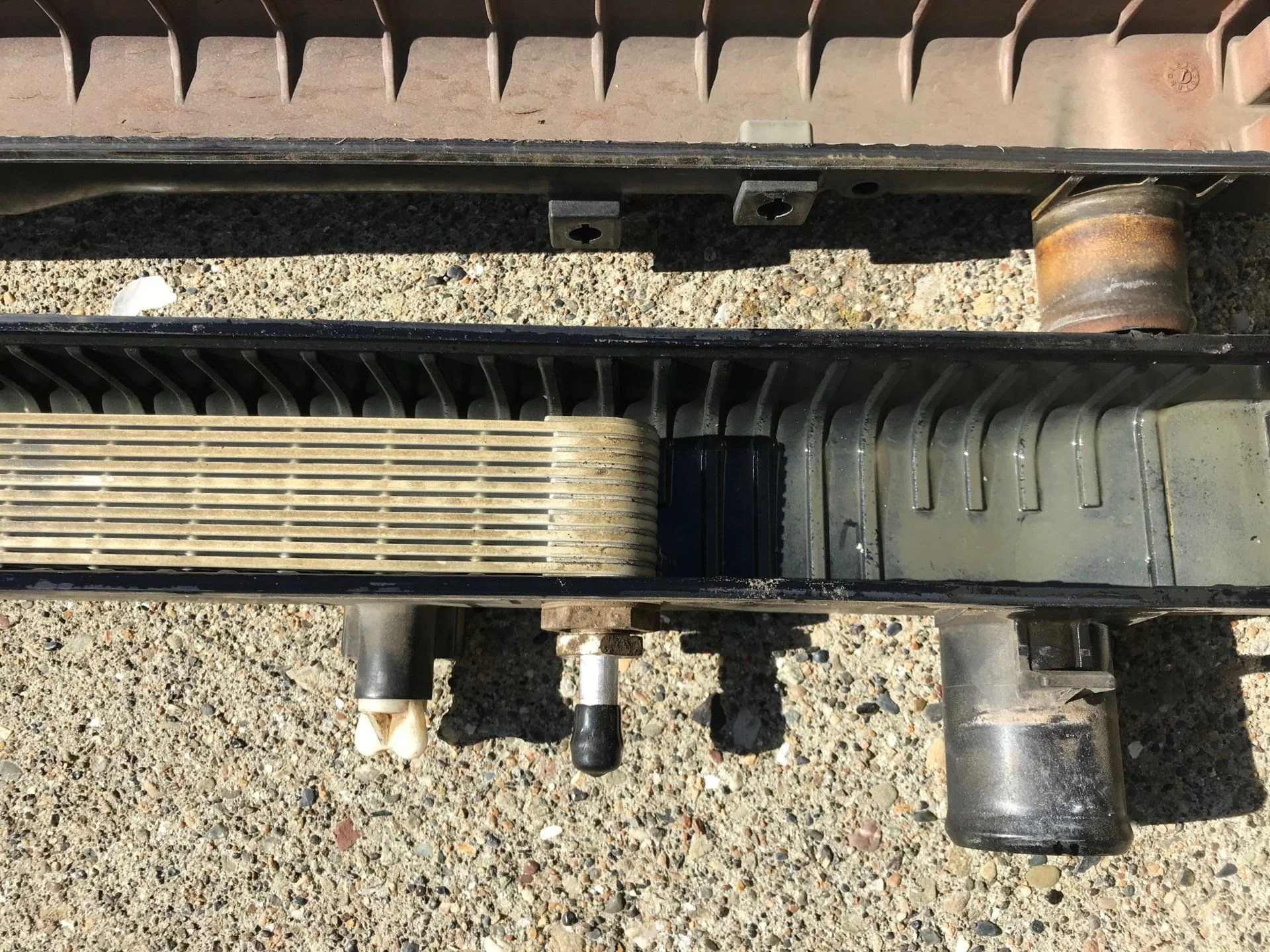

Top tank gets hotter than bottom. When I pulled my rad hoses to change timing belt at 222k, the inlet (top) was brown and brittle; the inside of the top tank had similar texture. When the polypropylene is exposed to that many thermal cycles its properties degrade. Same thing happens to the heater T fittings. The bottom tank was still solid and normal black color.
