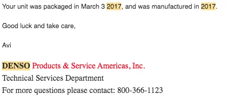

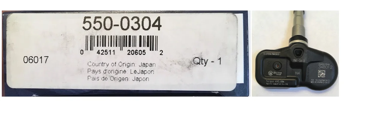

I was able to purchase a 5 set on eBay back in 2018 for around $150. I was suspicious if they were legitimate.
Denso confirmed manufacture date.

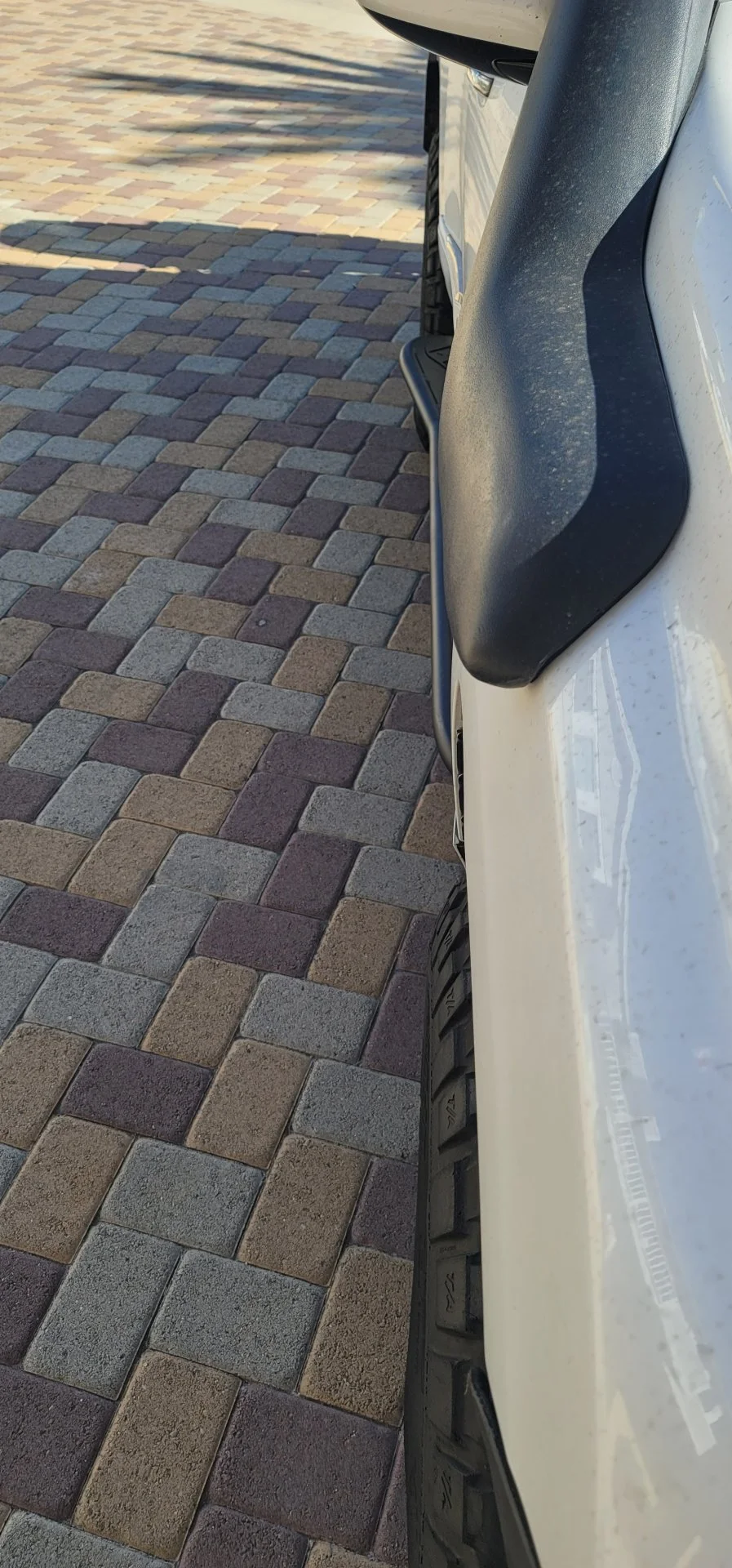

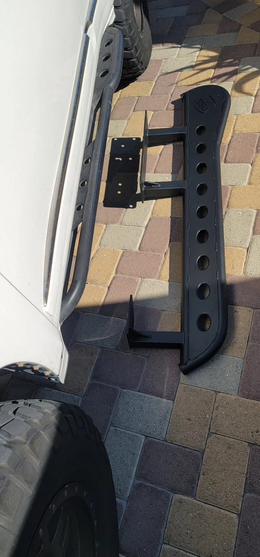

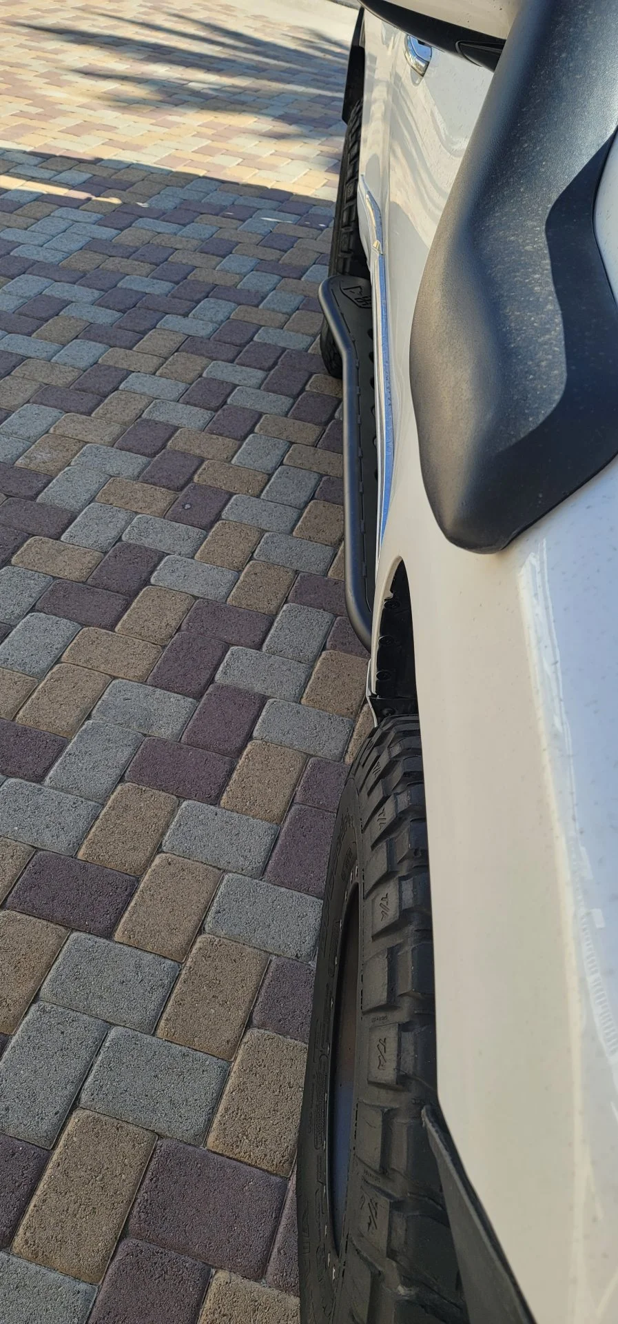

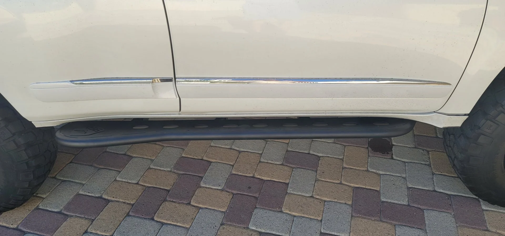

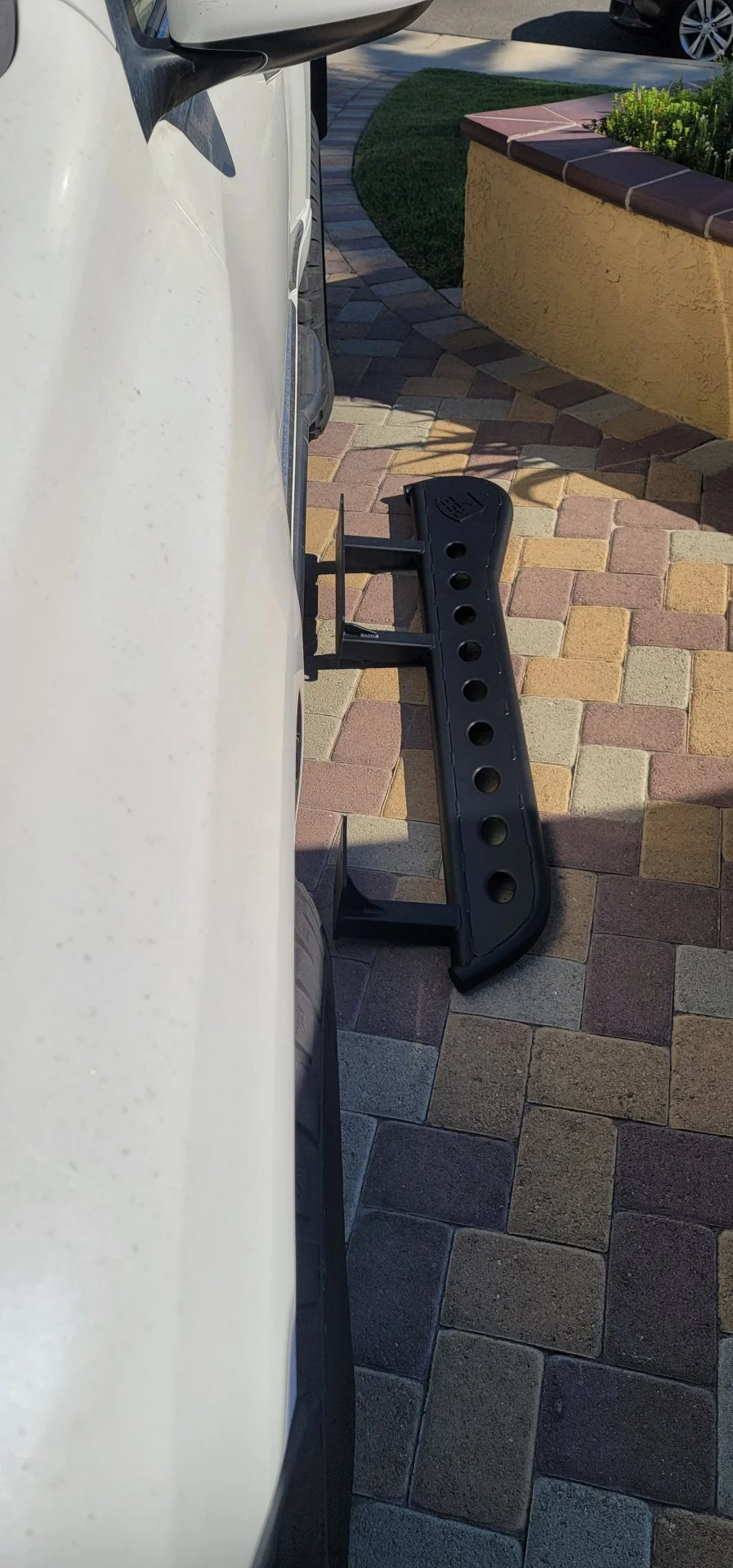

I finally installed them yesterday and took some photos for comparison. I tried to take the photos at as close to the same angle on both sides to get an honest comparison:
This is the drivers side Metaltech with the new RSG slider on the ground.
This is the RSG mounted on the passenger side. You can see that the RSG slider is wider, and considerably more at the kick-out.
