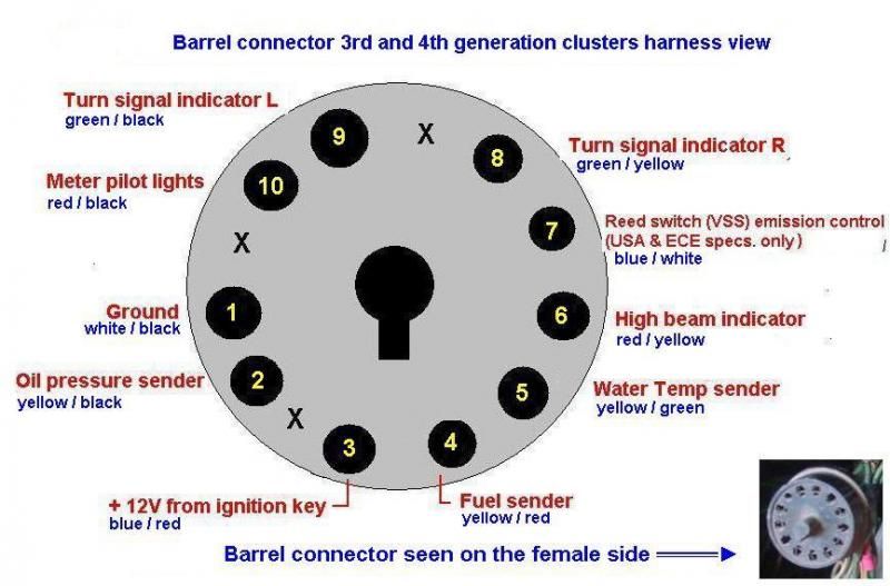

Finally get to the point where I need to ask some questions about wiring...This is my first wiring job in my existence...I got 2F 77 40...... I just can't figure out where to get ACC power,key on power,constant power for the unit....I believe from fuse block???which wire(color) I need to splice?How and where to connect into tail light circuit from DIM terminal on DD computer and from Brake terminal on DD I need to connect to the brake light switch-where exactly??where is the best way to ground the DD computer?After disconnecting of ammeter from original cluster-do I need to connect + and - together or what to do with the AMMeter wires?From Tach terminal on DD should I just connect to the negative side of coil or I need to go fused through the fuseblock??Thanks to everybody who is willing to help...Mike
You can get all at the fuse block or near the switch harness. Blue Red (LR) is ACC on pwr and I think only runs wipers and radio. The brake light switch is right behind the combo meter.
