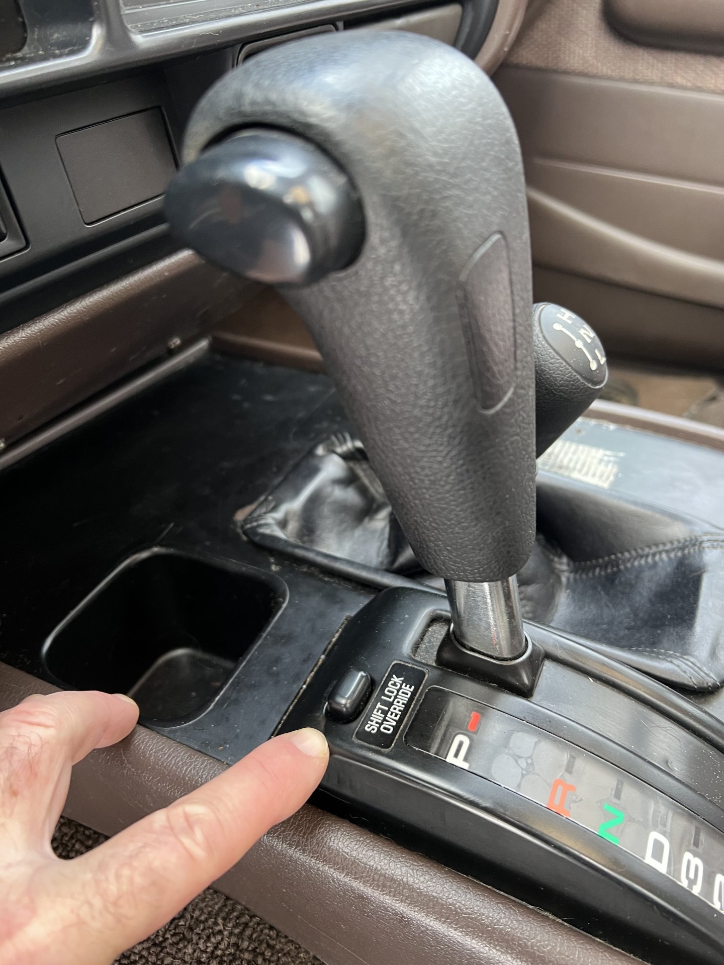

I just purchased a ‘92 fj80 and in order for me to take it out of park I have to push the shift lock override button down. Even when I’m in the vehicle and my foot is on the brake, I still have to push the button down in order to move the shifter out of the park position. It’s my understanding that this would be required if I had issues with brake lights or something along those lines? All my lights work as they should and there doesn’t appear to be any issues as far as that goes, does anybody have any suggestions on why this is?

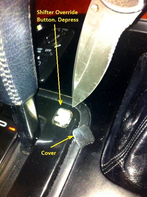

That's interesting. On my US spec 96 1FZ-FE FZJ80, that "button" is covered by a plastic cap which, when removed, allows you to insert the vehicle key (*or a long, then screwdriver) into the hole and push down on the mechanical lock which then allows you to move the shifter out of Park. This is normally needed only when the vehicle isn't running (*transmission interlock safety), or the battery is dead, and you need to move the vehicle. In other words, it's an emergency use only thing.
I see that you're in Alaska, and would think this might be a specific safety addition to prevent anyone from moving the gear selector unintentionally, but there's also the thumb-button, so...
Hopefully, someone here has seen that before and can comment. I've never seen a US spec vehicle with anything like that before, though most have the emergency workaround, as specified above.
necro thread resurrection; mine started acting up the other day again. Previously it was blown brake light bulbs, but all my lights are working. Another interesting difference between the domestic and JDM models, my HDJ81 over ride switch is a big red button right on the shifter console; not hidden by a cover or needing a pencil to actuate.
Standard on the A440F. Toyota hid the button on later models.
Right.
On later 80 series it under a small cap on the shifter tower (just above the Park marker).
On 100 series it is under a cap on the shifter panel area.
sounds like you have an issue with the shift lock solenoid, download the correct EWD for your truck and get to probing pins. that over ride is indeed an emergency release in the event you can't get the shifter out of park. take a look at this thread 92 fj80 shift lock solenoid - https://forum.ih8mud.com/threads/92-fj80-shift-lock-solenoid.1231801/
