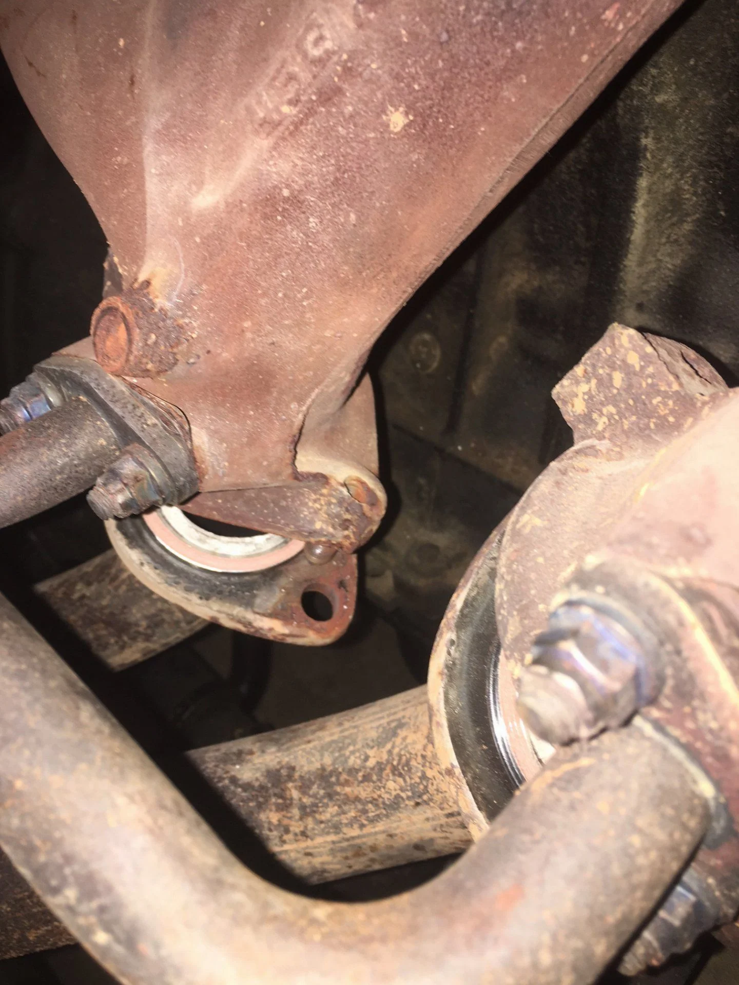

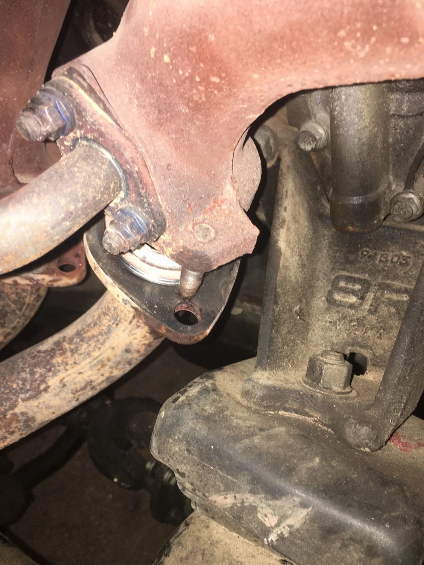

I think I put some pics up in the "what did you do with your 80 today" thread.
These probably arent hugely helpful, I thought I had some better ones, but at least you can see the real estate.
