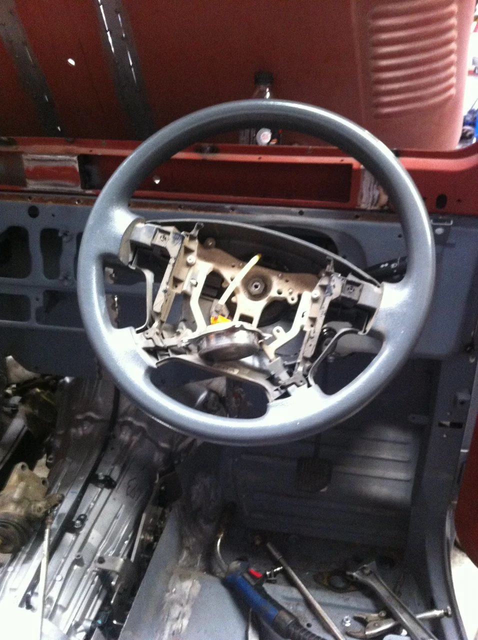

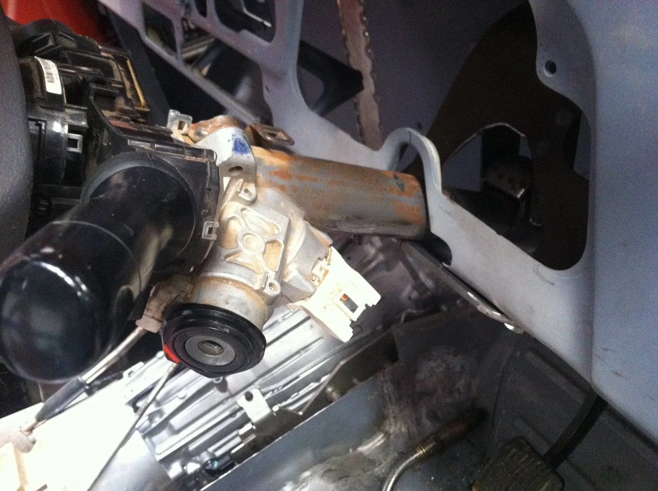

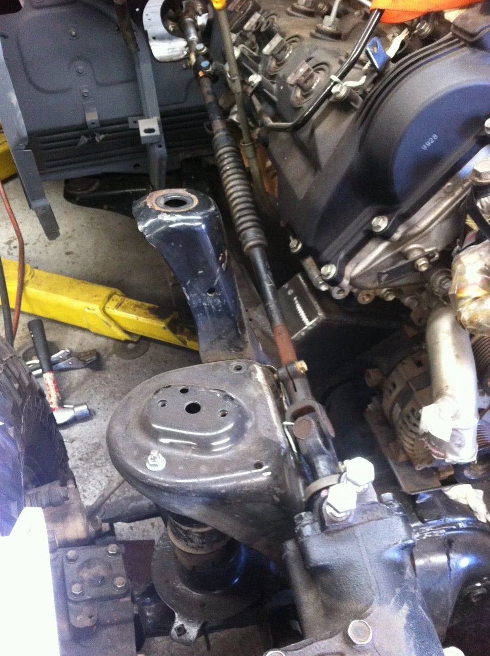

Steering column has now been done. Using GU Patrol box, 80 series intermediate shaft, 79 series extended, steering column and splash seal at the fire wall. This is the 79 series steering wheel. Would like a black wheel, so will need to find a replacement.
Column just misses the engine.
Another 1/2" over and I would have been a bit stuffed.
The 79 column. I will be using this as it has wipers and lights/indicators on there and I can use the center dash console area for other things. Also, as I will be using the 79 wiring loom, I won't have to change this area too much, apart from the airbag bit.
A new bit has been made for the fire wall and I will be using the 79 series steering column seal there.

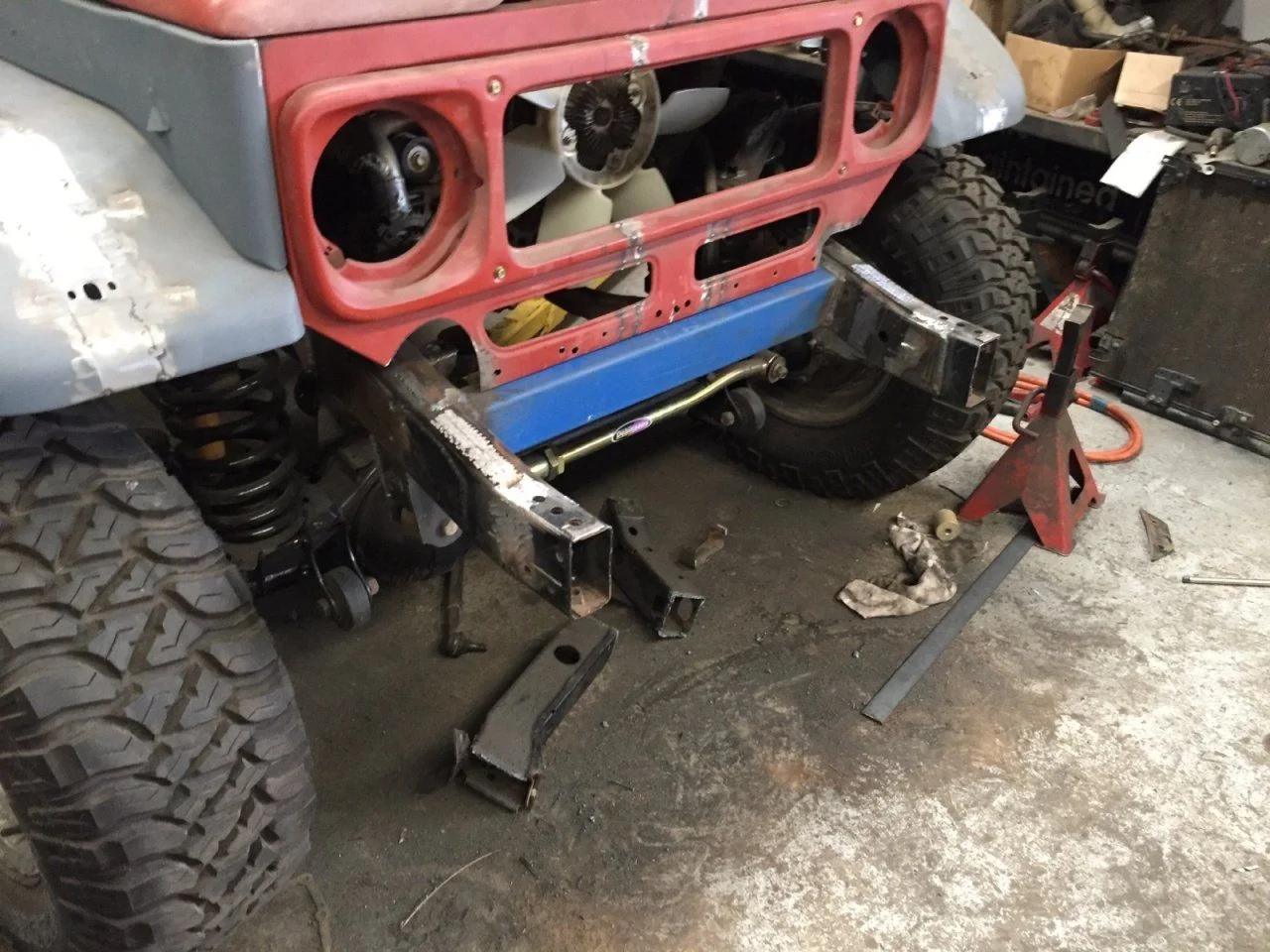

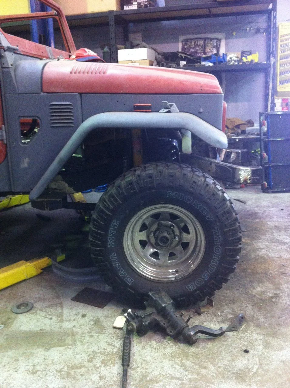

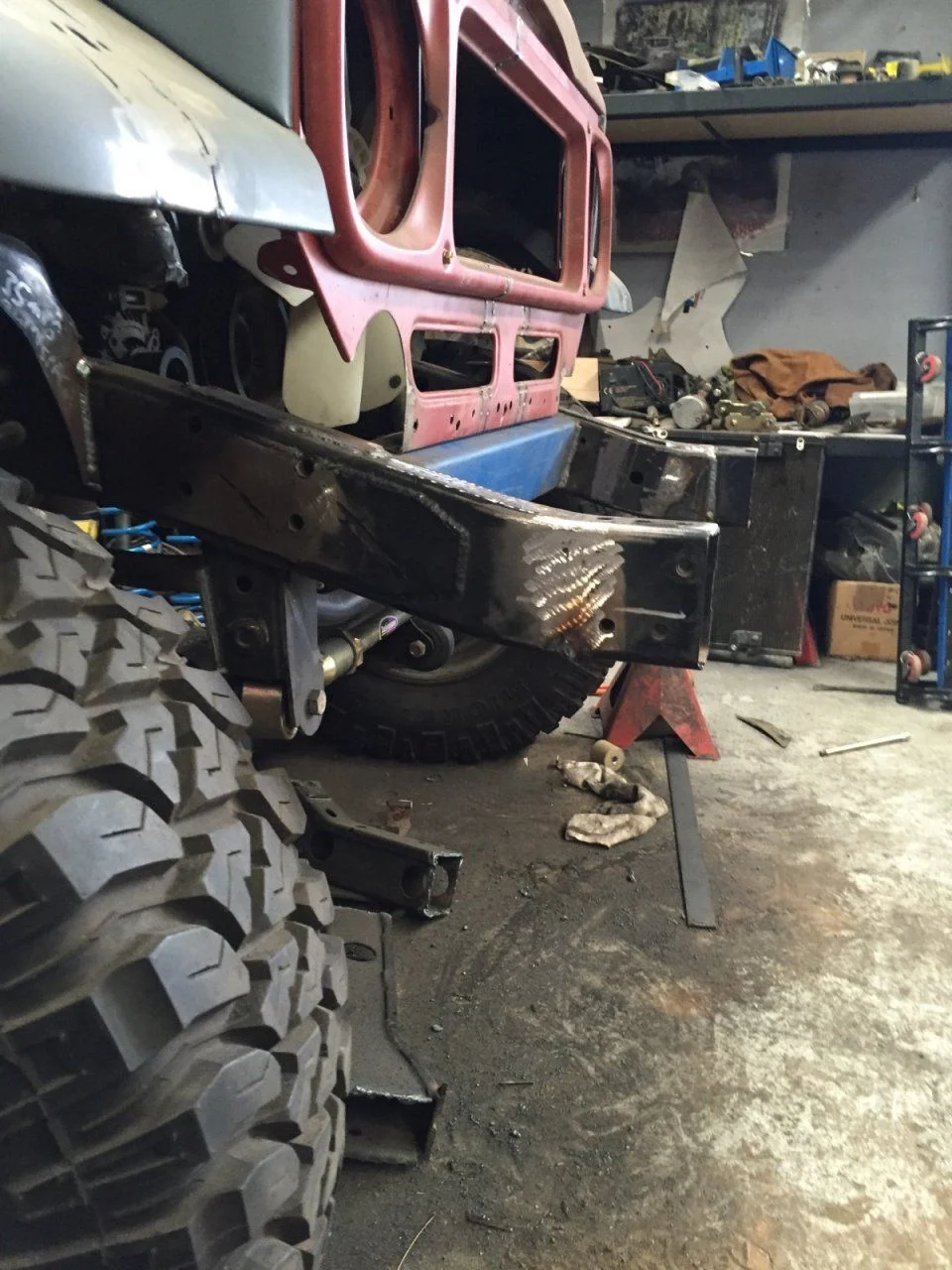

The chassis had a nose job today. The front of an 80 chassis is 100mm longer from the center line of the axle to the end of the chassis. So this excess was cut this end off and the captive nut section at the end that hold a bull bar on has been welded back on to make fitting a bull bar easier.
The center bracket that hold the front bib in place will be put back into position.

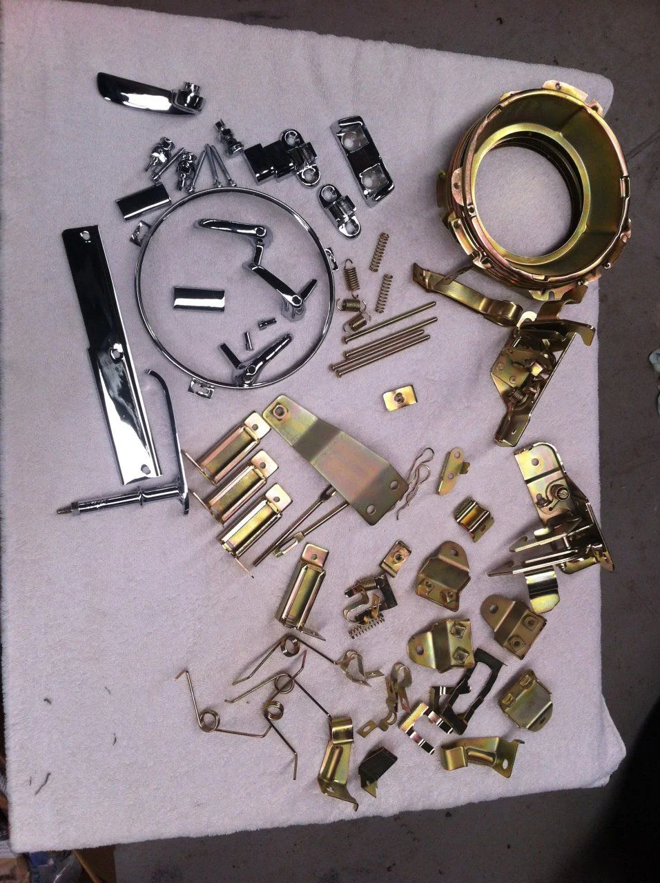

I have had some bits and pieces away getting zinc and chrome plated. Now I have to figure out how they go back together again!.
Nice job :) Have you thought of using vinylcote for the steering wheel? It is a dye type paint that will recolour vinyl. It soaks into the plastic so it can't wear off.
thanks for the product name diogenese. I will look into it. I am aware that you can sand and paint plastic but not aware of vinyl. How does it hand being used given it's a steering wheel and will get a bit of rubbing over the years.
I have to admit to not using it on a steering wheel before but I have done door handles with no rubbing off. The stuff soaks right into the vinyl and doesn't leave a layer on the surface so I don't think it would come off.
Edit. Just did a quick Google and the stuff you want is vinylkote with a K . Apparently vinylcote is a plastic spray paint not a dye.
VHT makes a very good color dye in spray cans - it will dye that wheel black , I use it to restore old garden tractor wheels that are sun damaged and cracked . You must follow the directions on the can to a T with any VHT product - but they work better than anything I've ever found , especially their header paints .
Once the color is on - give it a day or two and coat the hard section of the wheel with Eastwood's Diamond Clear , should look new .

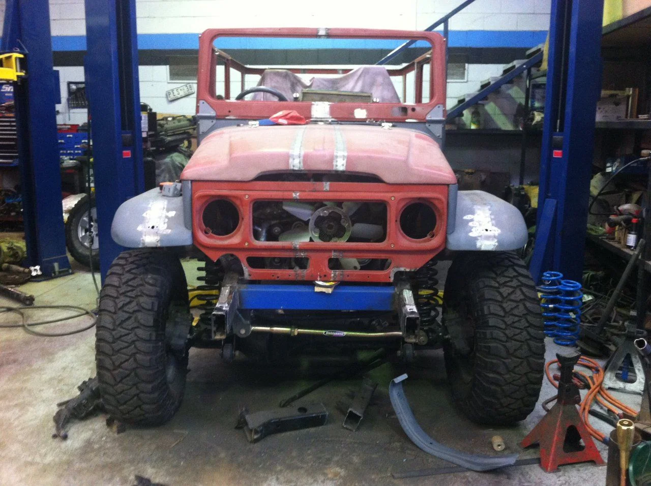

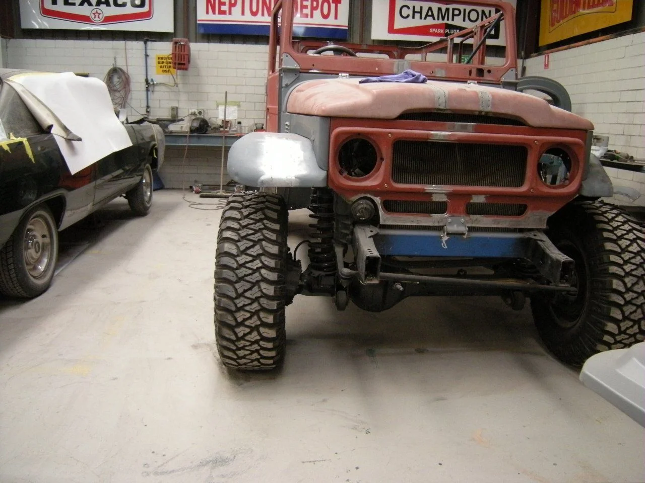

project is now on 4 wheels again and this is the approximate ride height that I am aiming for when completed. Still need bar and winch on the front as well as other engine bits and pieces. Will be back to body shop in 2 weeks for the welding of the body and final panel fitment and tidy up then on with wiring and other things.
The engine is slightly offset to the LHS (our passenger side) by 25mm or so. This gives some room on the alternator side to change it if required as it sits very low and is prone to mud ingestion!!!!.

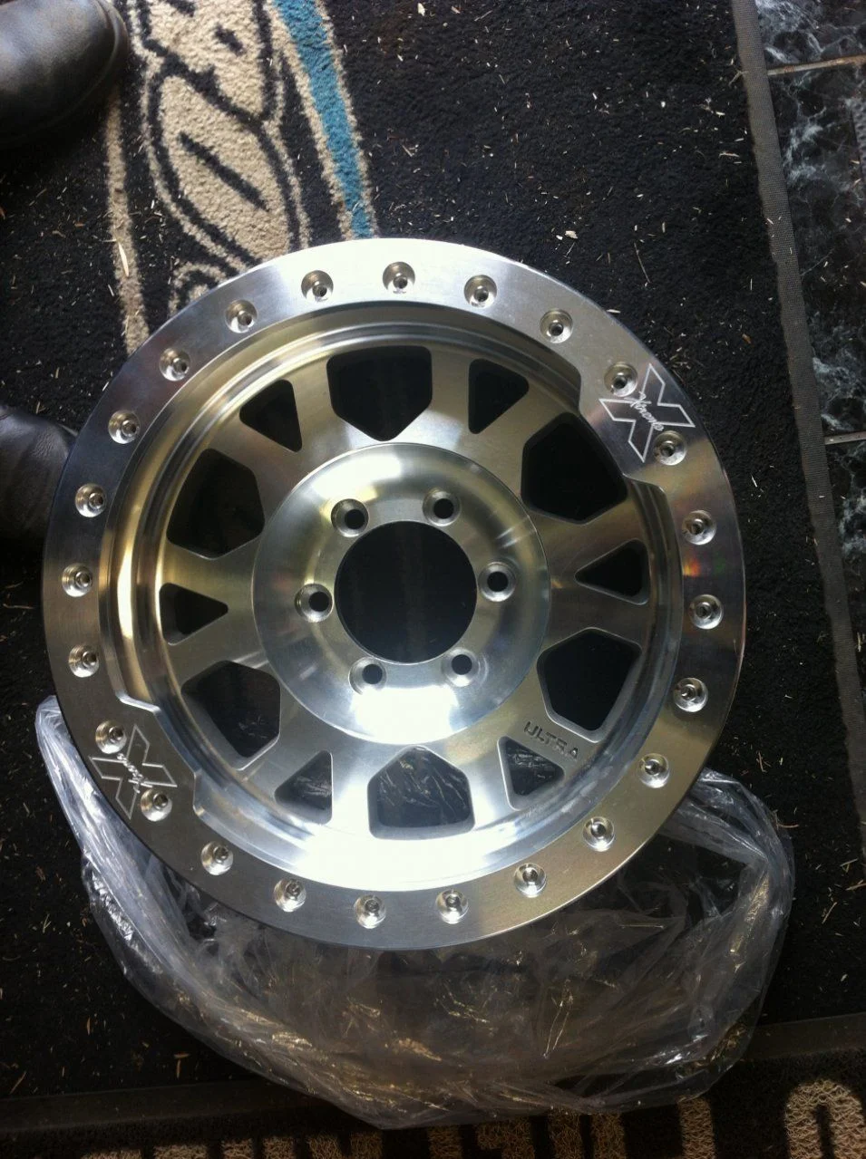

These are the wheels that I might run with. They are a Ultra wheel with beadlock on them. I would prefer black but I guess that I can paint them. Running 17" tyres on there that I haven't decided on yet.
It appears that the front wheel is a few inches (cm) forward from the normal position (centered in the front fender arch) for a 40 series. Was this your choice, or was the fire wall and engine the limiting factor for the position? If you had it to over again, would you alter something, or any thoughts?
Well spotted. Front axle is 2" (50mm) further forward than normal as a mix of keeping the wheelbase as small as possible, was aiming for 120" but had to settle for 122" and then trying to fit everything including the rear doors that are 4" shorter than the front ones in there as well. Was a tight fit but it is all in there is the dimensions that I was happy with while still having a 1/2 decent ramp over measurement. So all round compromise was achieved as I also had to put the 3rd row seats in the back and at the moment they just fit on the area there after the middle row seats are folded flat and that leaves enough room for me to have my seat there and not have the person squeezed in behind me, I'm 6ft 4in, so I drive from the rear seat almost!!!.

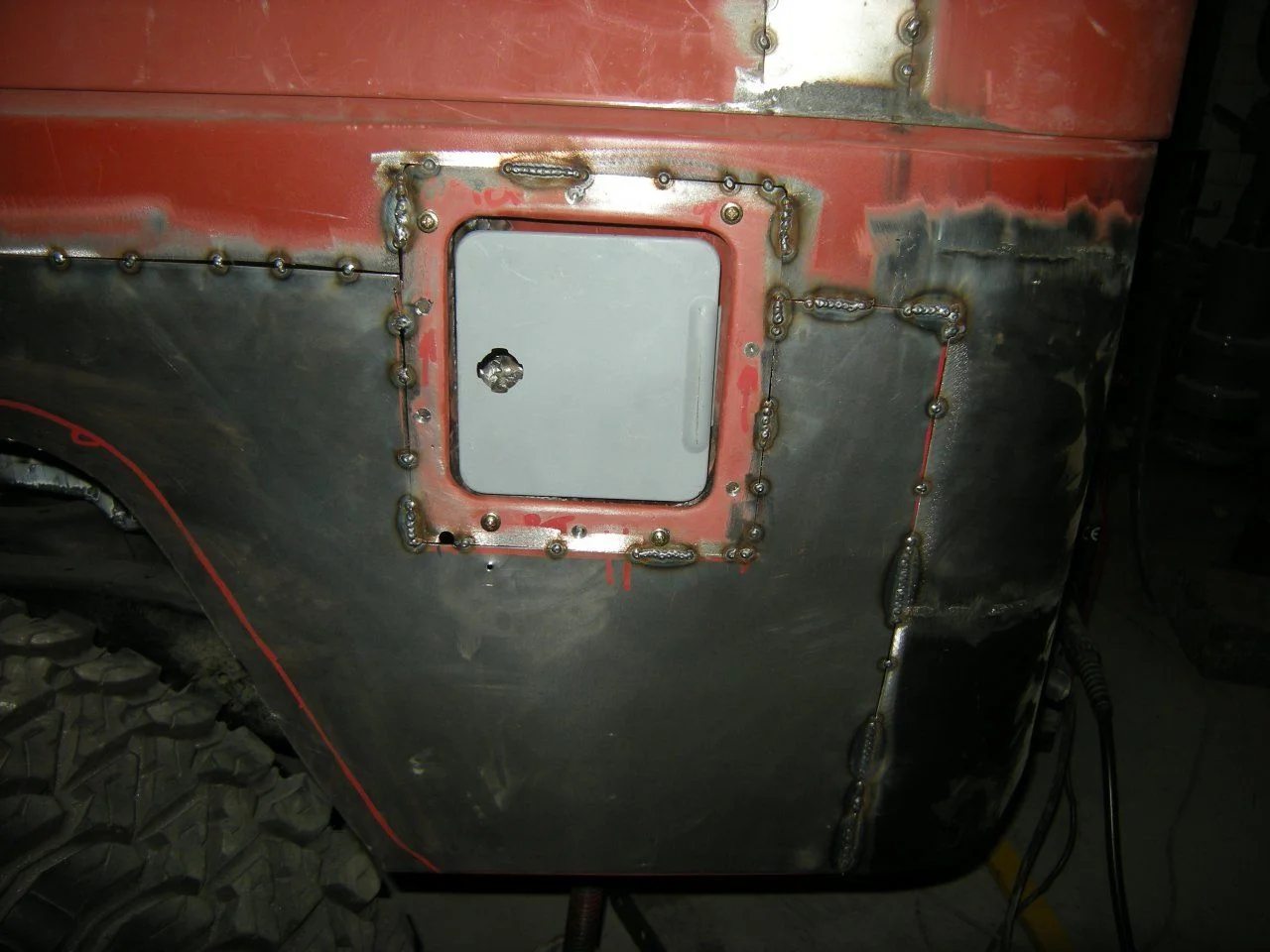

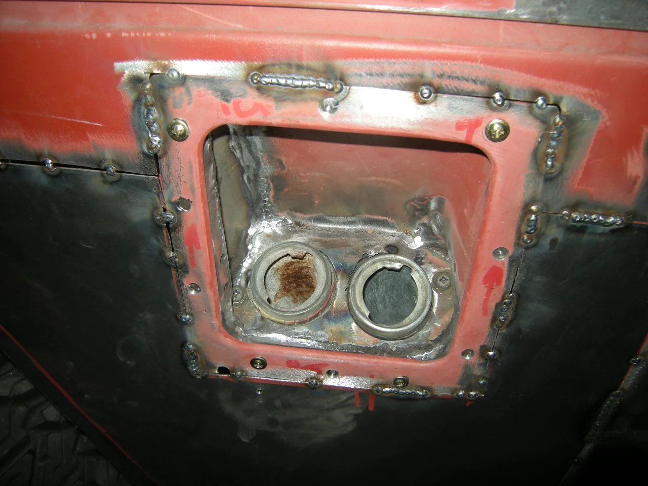

Fuel tanks are in, close to 300L of diesel in there approximately. Used the 40 series fuel filler cover and inside was able to use 2 x late model swb 40 fuel filler necks to take the fuel towards the tanks. I did have a single 80 one with the lever to direct fuel towards the front tank or rear but due to the height of this actual unit it meant that the outlet was directly in line with the chassis and that wasn't going to work.
Rear corners are completed.
Dual fuel filler necks in there. Front (main tank) and rear (sub tank)

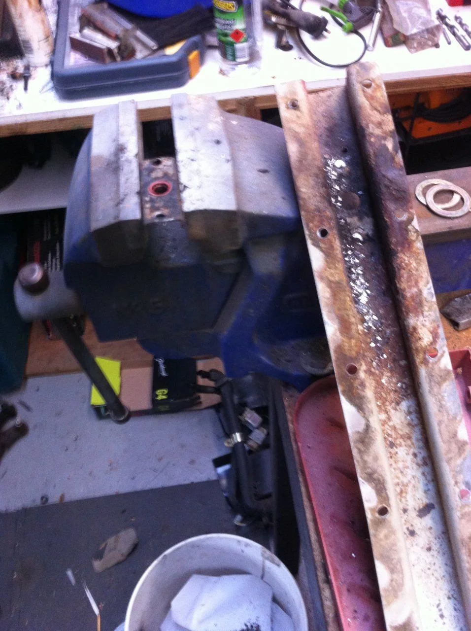

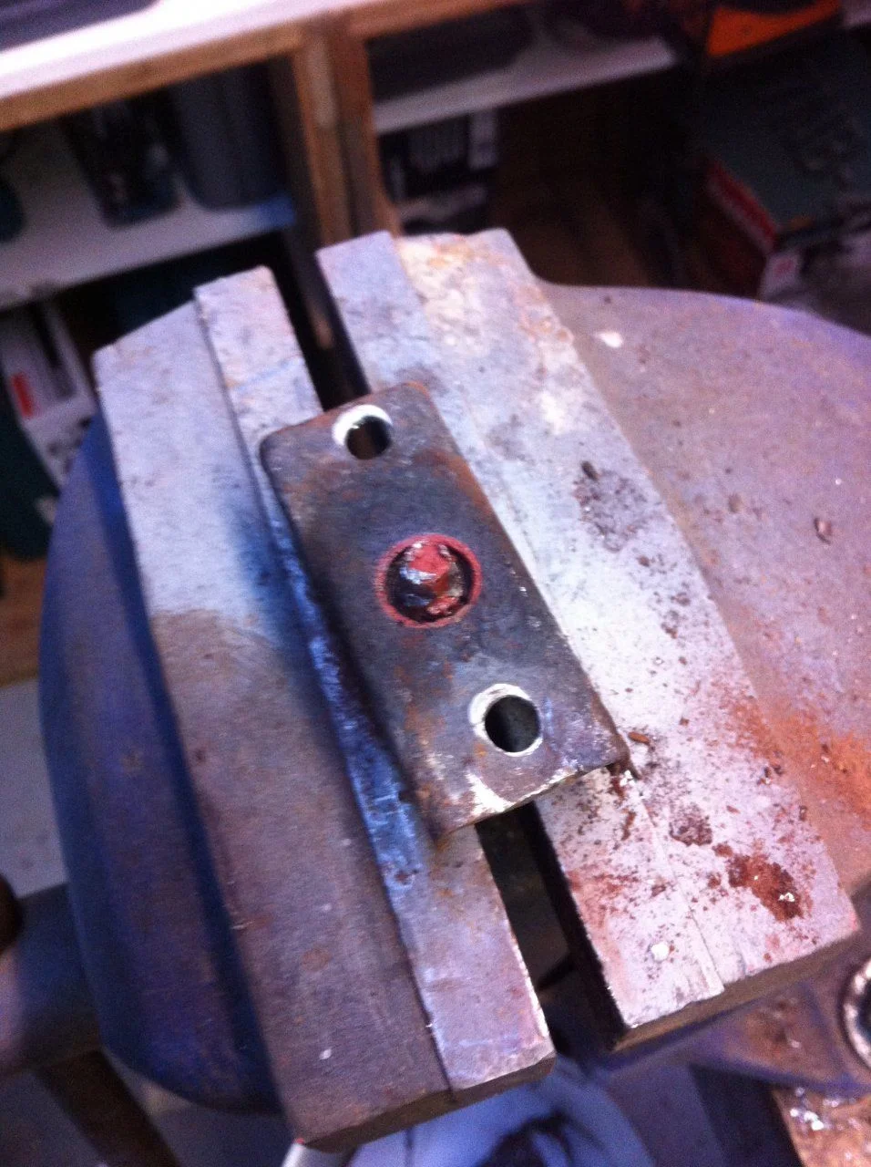

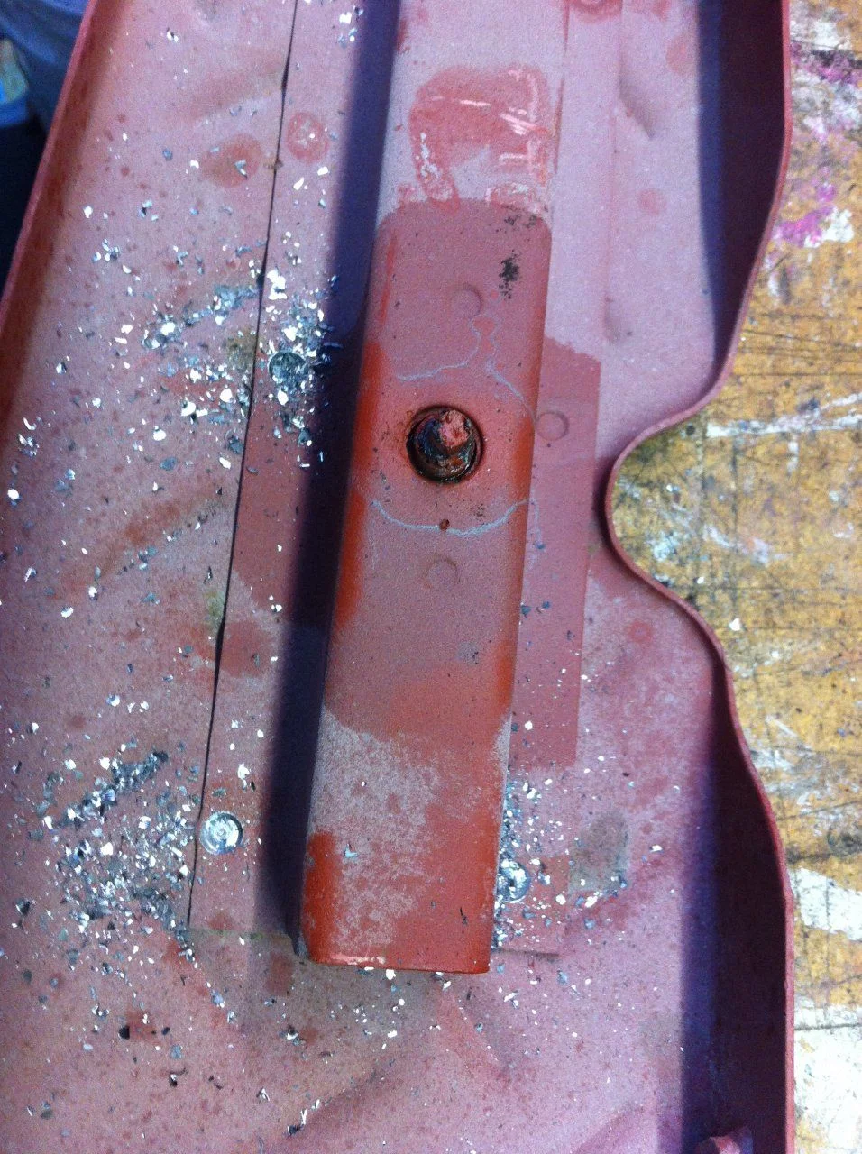

The side steps I had had the bolt broken off in the nut that is underneath. I real pain as I tried but failed in getting them out. So i drilled out the spot welds and took the whole thing to bits. Was able to put the small plate and bolt in the vice where I was able to get a better purchase on the thing and it came out pretty easily. Reassembled the brackets and welded it back together again. Looks like new.
The small bracket that hold the nut with offending stuck broken bolt.
After I got the borken bolt out I ran a tap down the thread to clean out the rubbish.

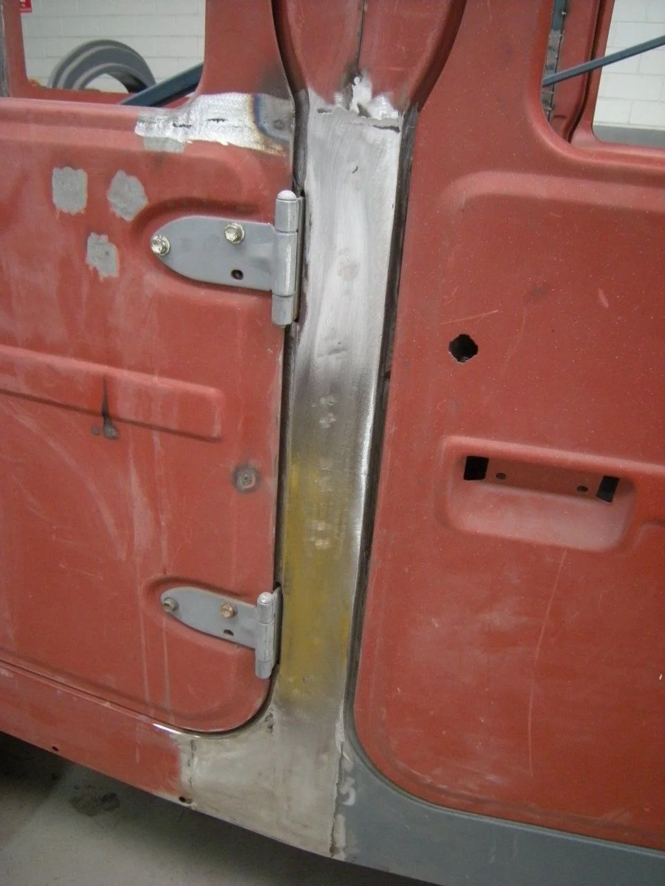

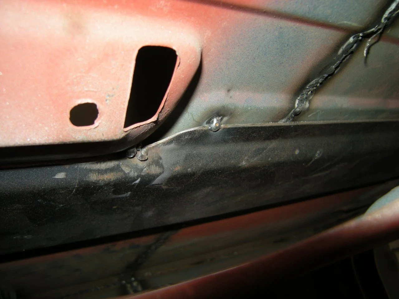

One thing that I have always been concerned with is the strength of the B pillar as it now has to take the weight of a door and window. Had it before with some 40mm sq RHS tube there but there still was too much movement as far as I was concerned. ended up adding some more angle into the area and then some 5mm plate steel on the outside. This has made it a lot stiffer. Still have to sort out the door stops as I was going to use 79/80 door stops as they slide into the door rather than the 40 one where it goes into the body area.
Once it's painted you wont know the difference.
As this is also going to be hauling the family, I put some side intrusion bars in there in the event of some nutter not seeing this thing. I dont have to as our local rules say from 1/97 it is required and this chassis is 5/95.

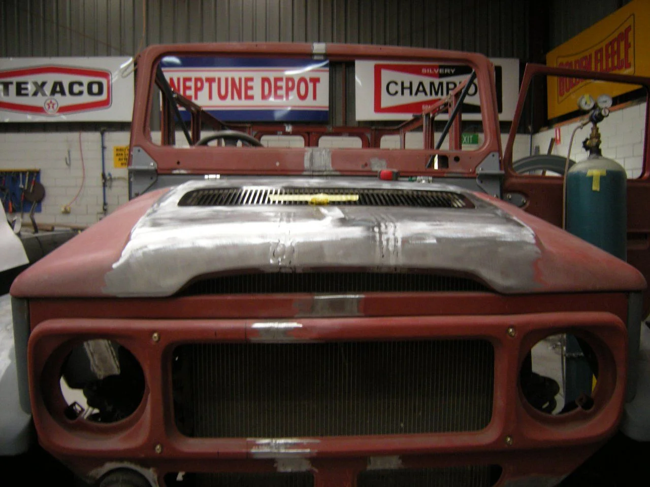

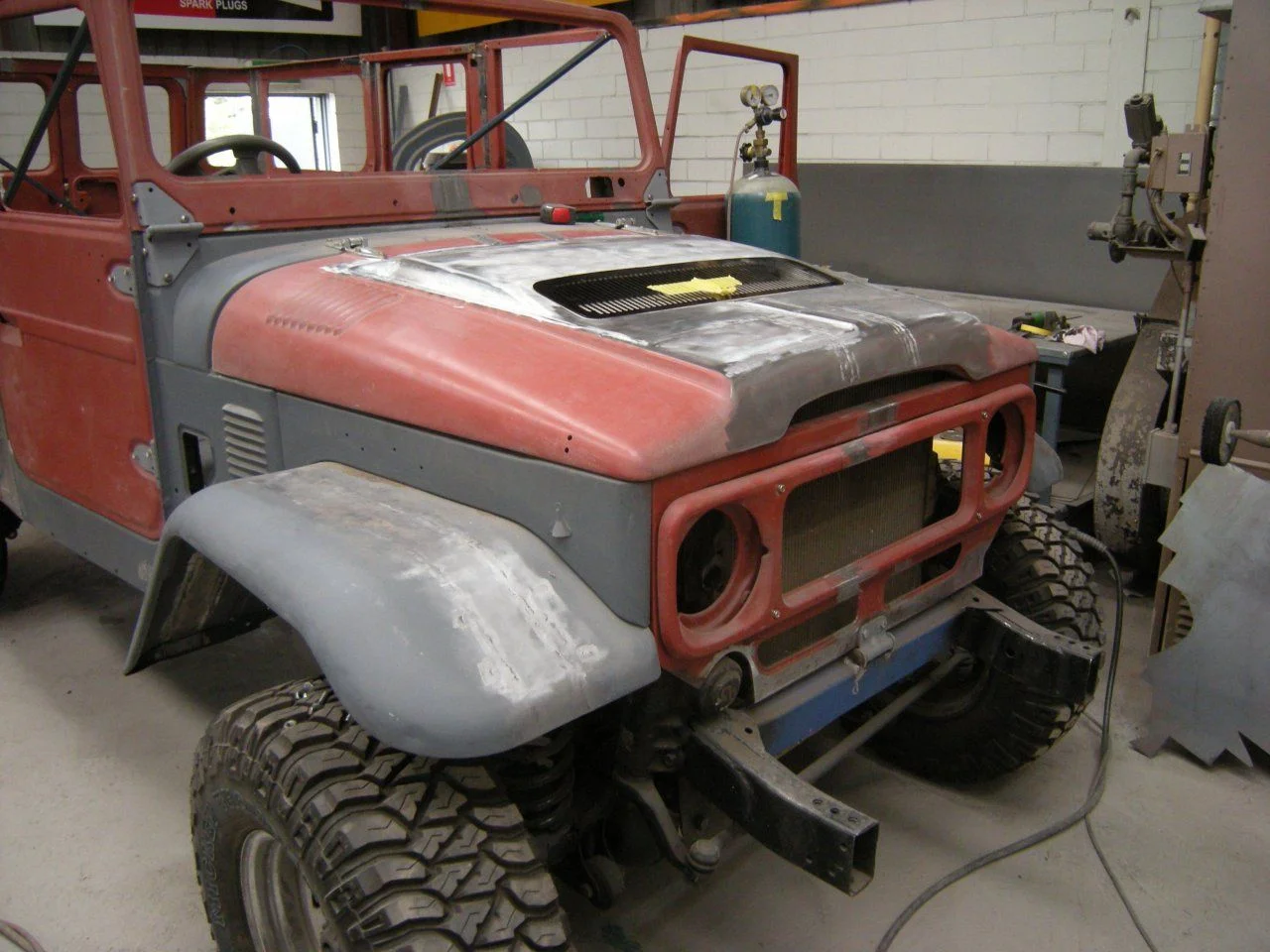

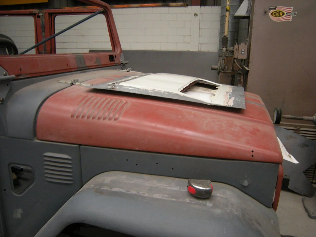

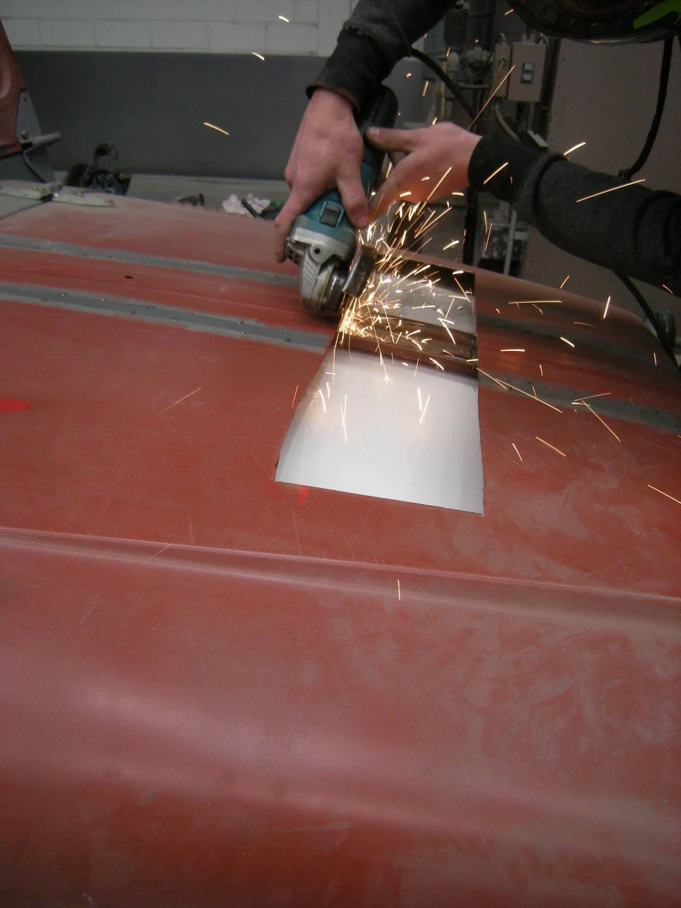

Next came the part that I wasn't too sure about. How was the 79 series bonnet going to fit onto the 40 series one. A few have done it and have had to reduce the width of the scoop in order to fit. Given I have 50mm up the guts of the thing I thought I might be okay.
Cutting a hole in a rust free 40 series bonnet. eeeck. Started with a small hole to see the rough location and then cut backwards and forwards from there.
Rough location of the hump for the intercooler intake.

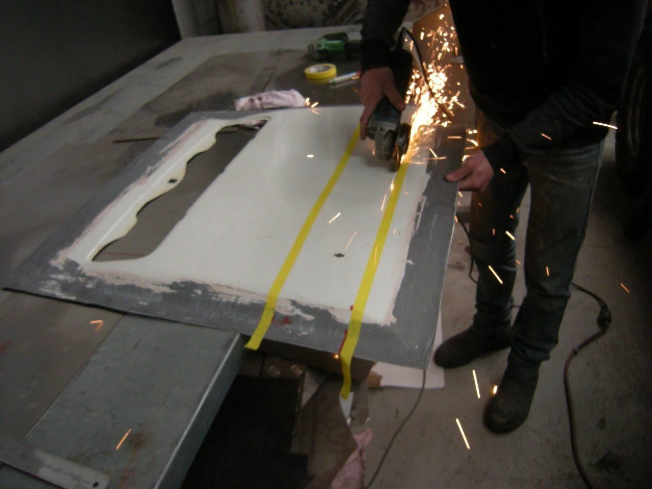

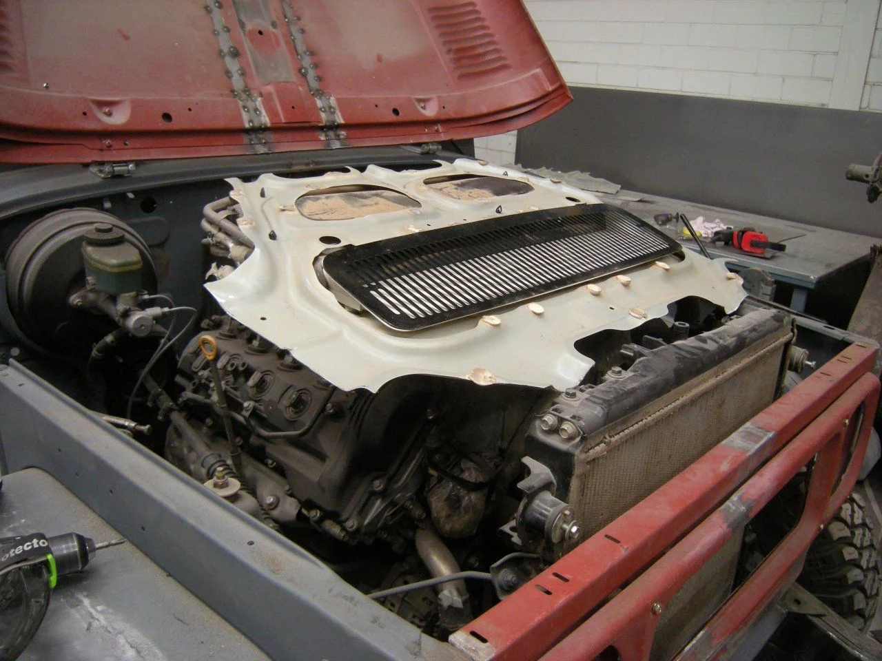

Underside section of the 79 bonnet with the plastic bit for the air flow direction for the intercooler.
The intercooler is offset to the left hand side of the car. The plastic bit under the bonnet directs the air that way.

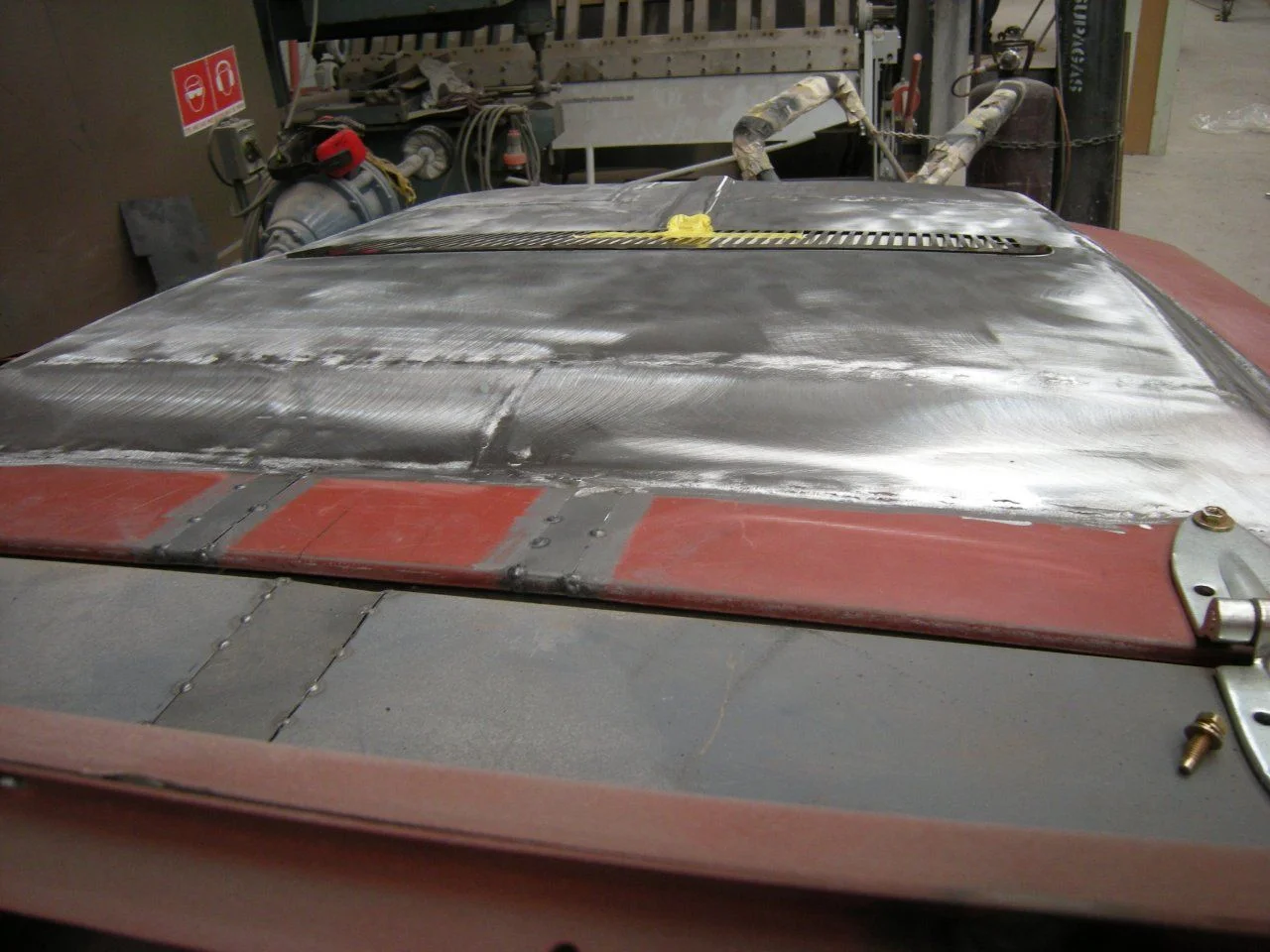

The width turned out pretty good and fits in there nicely just before the 40 series bonnet side pressings, just the length was about 125mm (5") too long so we cut the redundant back end of the scoop down to fit it in there before the bonnet hinges.
