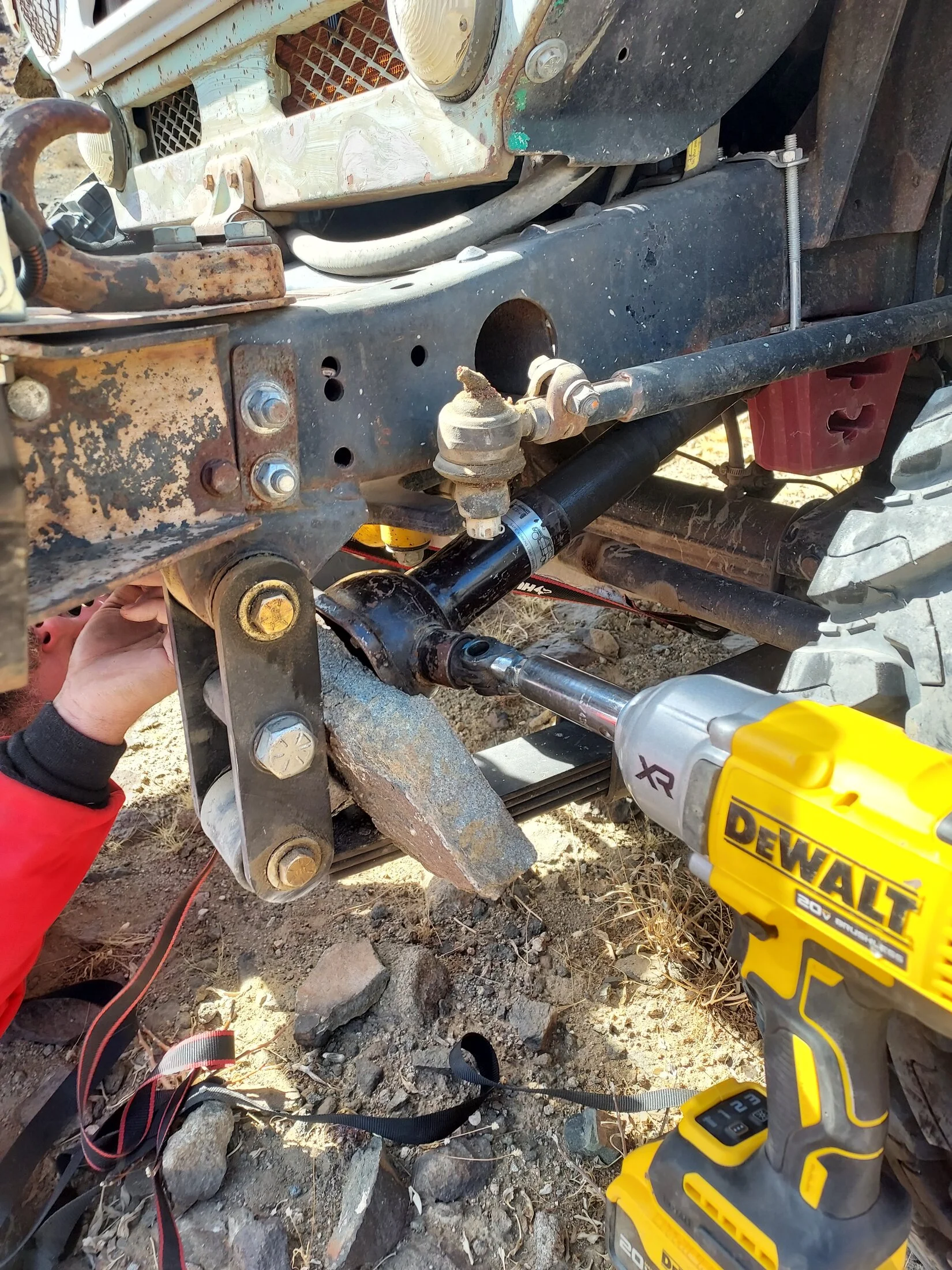

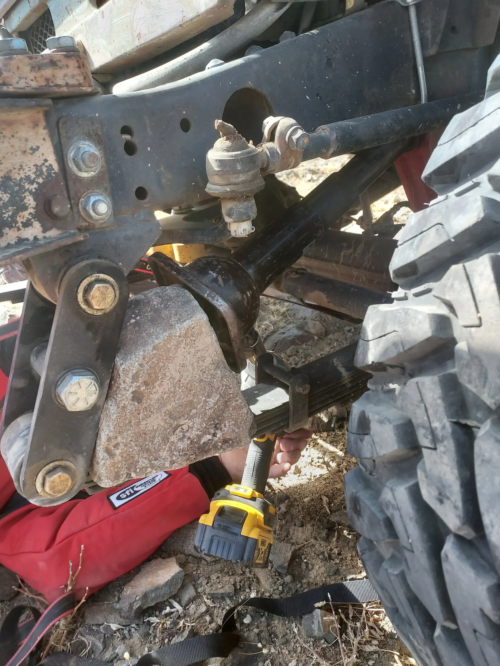

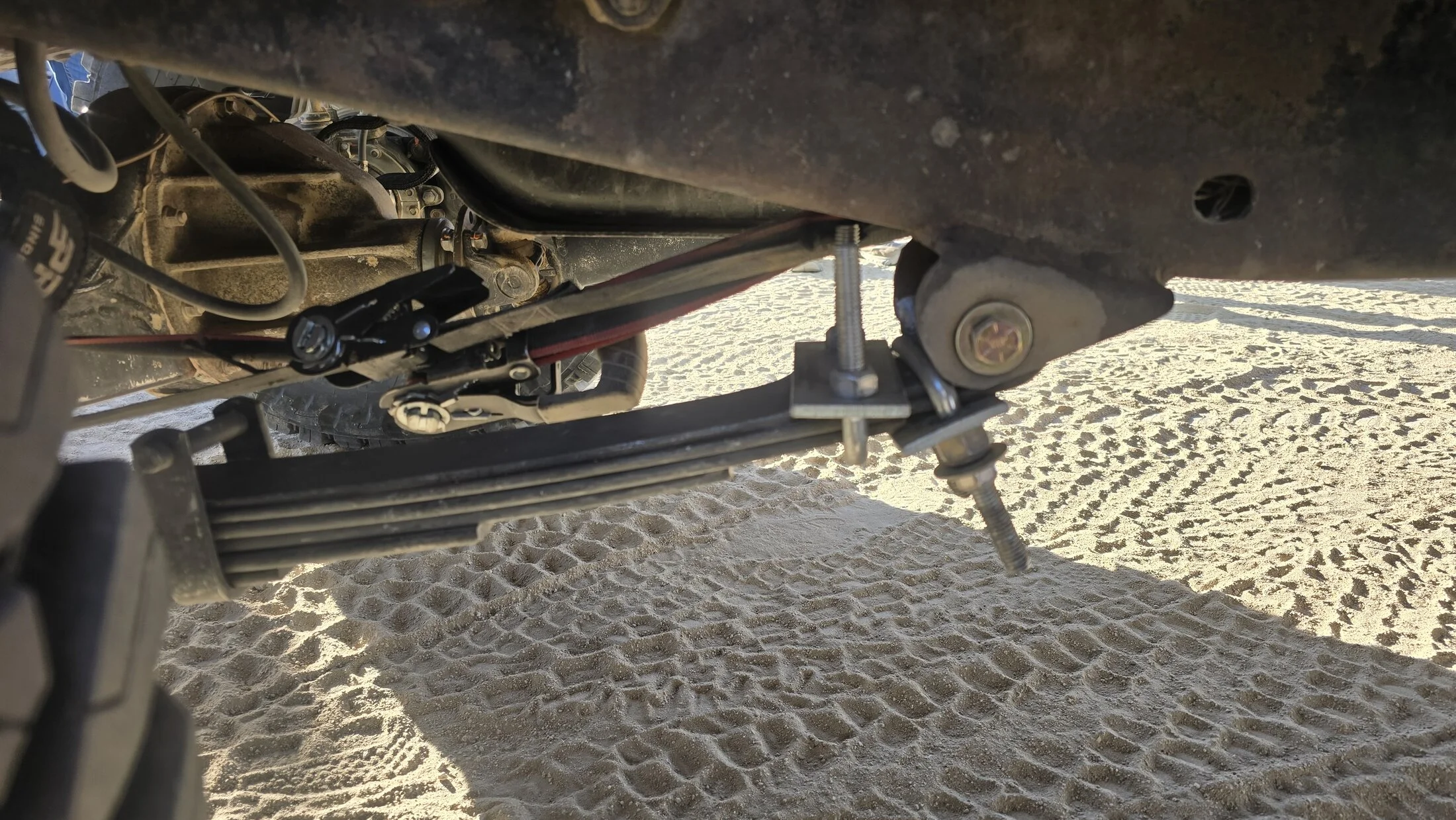

After the 1400 Class trucks went past Kurt @cruiseroutfit and I started off. We pushed through the wash and around backdoor. We had clean air and up until we got to mile 11 things were going well. The 45 felt Great and opted not to stop in Remote Pit, Thats when it started really getting rough. Rock crawling and basically pushing rocks out of the way with the axle, the lower truss I installed was like a bulldozer blade. I tried to take my time and more than once the steering wheel was ripped out of my hand. Mile 15 we were going down a rocky downhill trail just beating the crap out of the 45 when BAM ! We pulled off course and found a broken front drivers mail leaf. No radio, cell or Satellite phone service. We were on our own. The driver's side of the axle was pushed back 6 inches, No center pins were broken, shocks still looked good. After a few attempts to get the axle and springs into place I told Kurt I have an idea. We would use the 4runner jack I had welded a 19mm nut to and using rocks as spacers jam the jack and rocks against to front shackle and use the jack to push off the bump stop. We kept finding larger rocks and with a limiting strap from the spring around the hood onto the roll cage we finally got it into position. Using the 2 flat C-clamps and a couple of ratchet straps we had the main leaf back into position. By then Chad Hall had stopped to check on us. We gave him the thumbs up and started putting tools away. We were going to finish at least one lap. With Kurt and I back into the 45 we found out chance to get back on course. Slowly and feeling a bit nervous we worked our way down the hill. At one point stopping because we heard something Kurt got out and one of the straps came loose. Once back in the 45 we started off 7mph, 15, 25mph Rolling across the woops. Pushing a bit more with every mile. I was starting to calm down and over the intercom Kurt was calling our turns and so relaxed " Were on Course "

Great idea with putting the 19mm nut on that jack!👍
Time for a shackle reversal?
