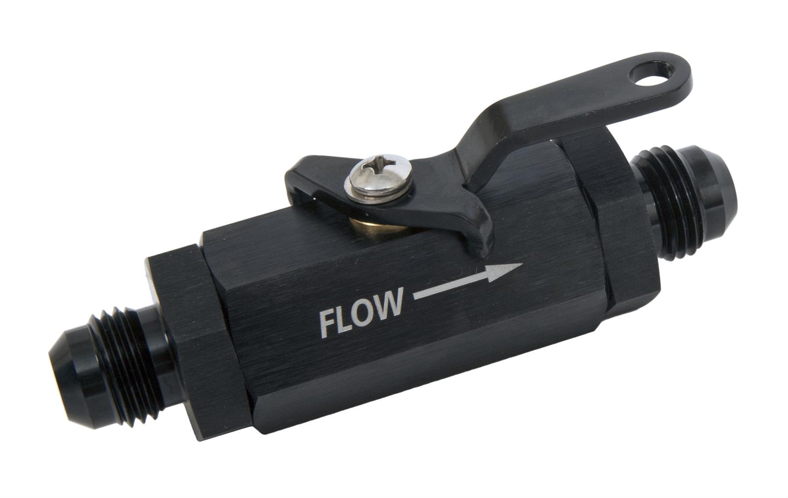

Feel for you ! Clear filter is the only way to go , put a fuel small on ,off , switch just before the filter , You"ll thank me !
100% agree. I plumbed a shut off right out of the tank. Definitely learned that lesson at GSMTR a couple years ago when the first pump started whining.
