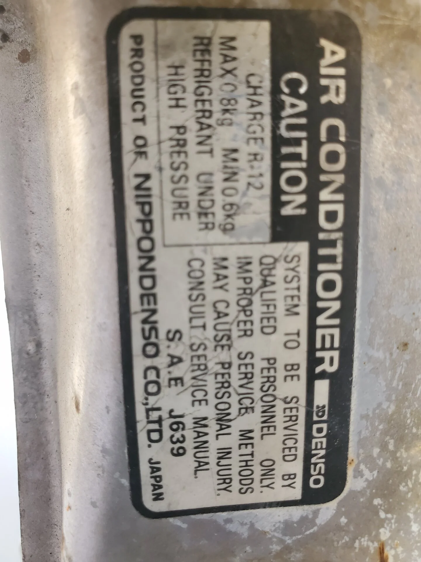

I don't know about the volume (weight?) of refrigerant, but I read the pressures are supposed to be 240 psi high side, and 29 psi low side.

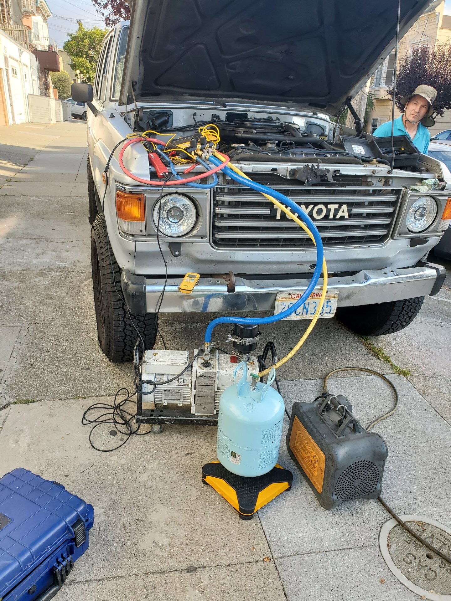

I just had my a/c done by a pro here in San Francisco last week. He knows the land cruisers and older toyotas really well.
I had the same idea as you. I was going to our have everything new since I really hadn't had a/c in over 15 years. To make a long story short he had me buy just a dryer because of the service life. Everything else is bone stock and I mean even the hoses, evaporator, condensor etc..
He evacuated was was inside which was almost nothing and reinstalled some new oil and r134 to test. He didn't bring nitrogen I believe due to leaving it on his commercial building project.
Well, the system held up fine and he removed it once more and that's when the new dryer went on. I installed it while he did his mixing of oil. He said that out system is actually not to big. He has how to videos on YouTube and hopefully he uploads them in the upcoming days on the work performed on my 60
