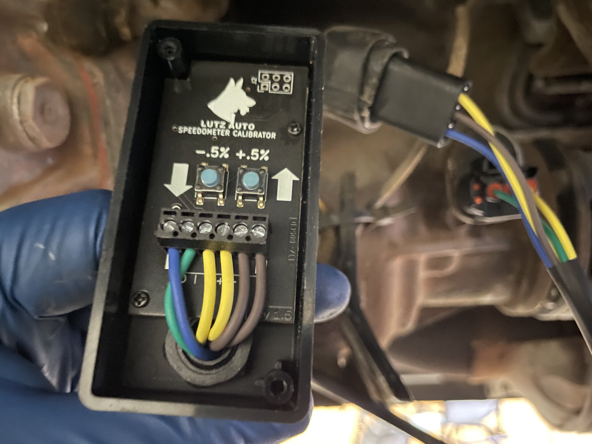

Finally got 500 miles on it. Confirmed wheel bearings are still seated, re-torqued steering arms and bent the tabs on the nut huggers. Speedometer was 11% off so installed a Lutz Auto speedometer calibrator. Now it’s dialed in!
The Lutz Calibrator is awesome. So easy to use. I think I have one of his Beta units.

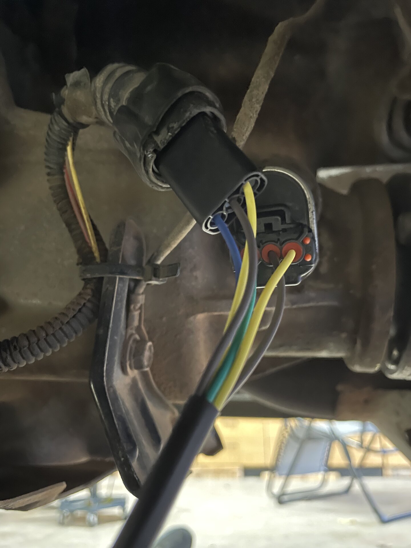

I've had the motor apart and it is well greased. If I lift a rear wheel with a floor jack, the locker will engage almost instantly with with a bit of wheel spin to line up the splines. If I'm approaching an obstacle and attempt to lock the rear, it won't lock. At this point I'm already committed and in the rocks. I can rock backwards and forwards if I have room to maneuver, but the rear dash lamp will sit there and blink at me. At some point it will eventually lock (after swearing at it for a while), but it's nothing like the ARBs that I had in my 91.

No locker can lock instantly. The splines on the locking collar have to line up to slide over. ARBs have a fairly fine spline and lock/unlock very quickly. I've never had an issue with the ARBs not locking quickly when I engage them. I would imagine it's the same with Eaton.

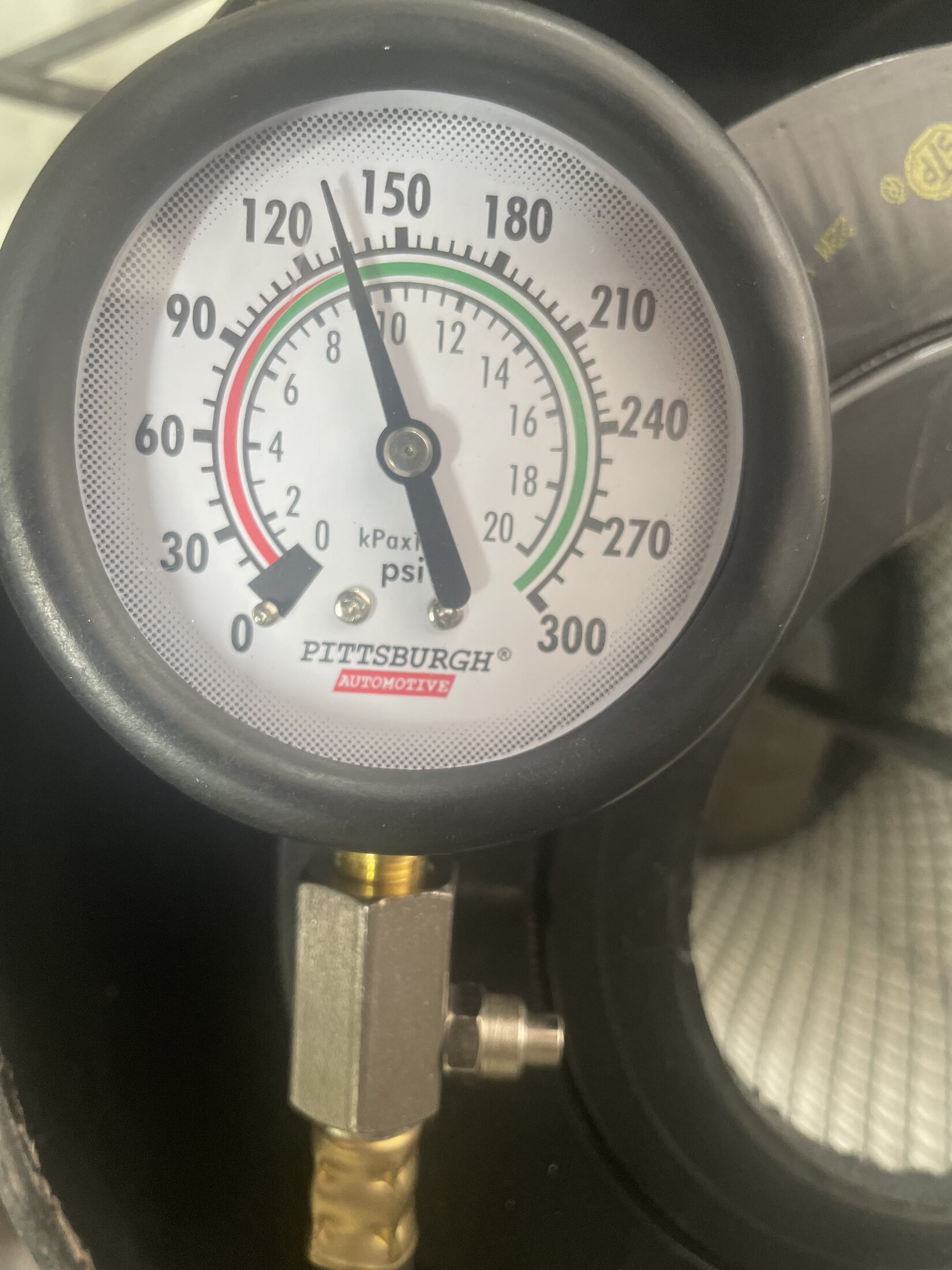

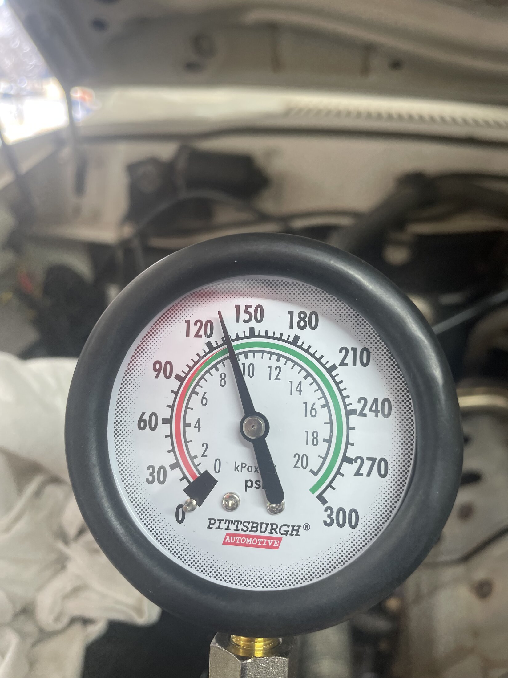

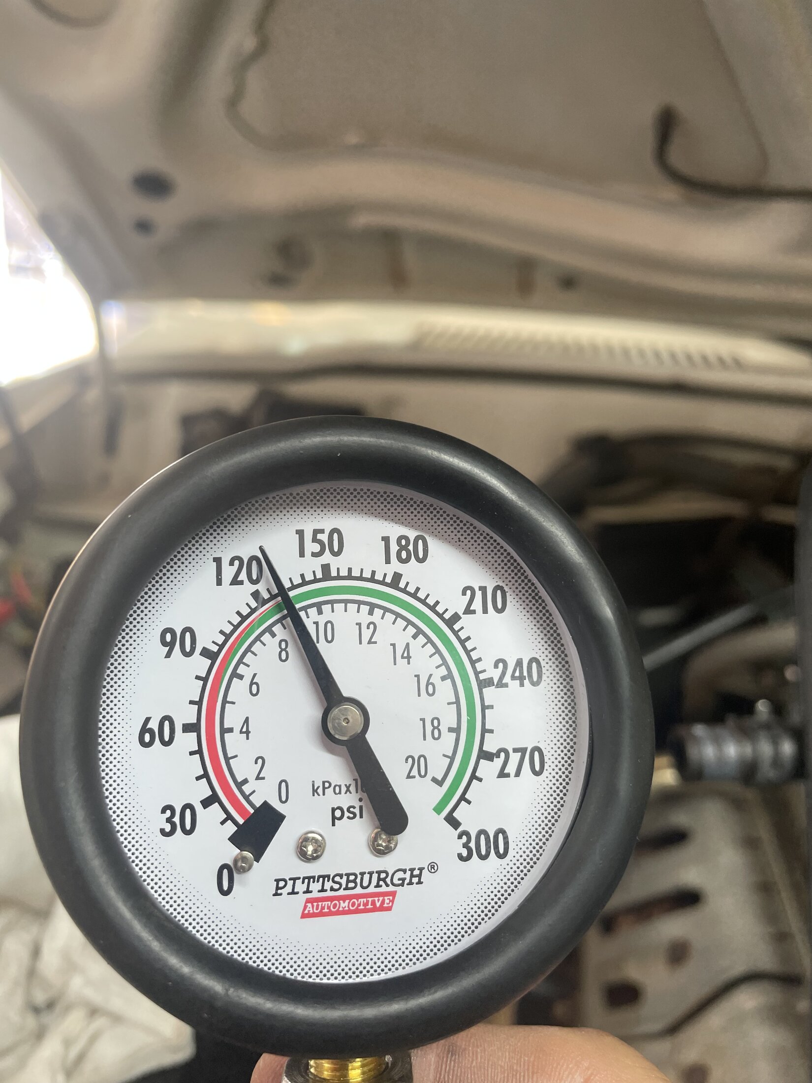

Took compression readings with a cold engine. They are pretty close but lower readings than what I expected maybe because the engine was not warm?

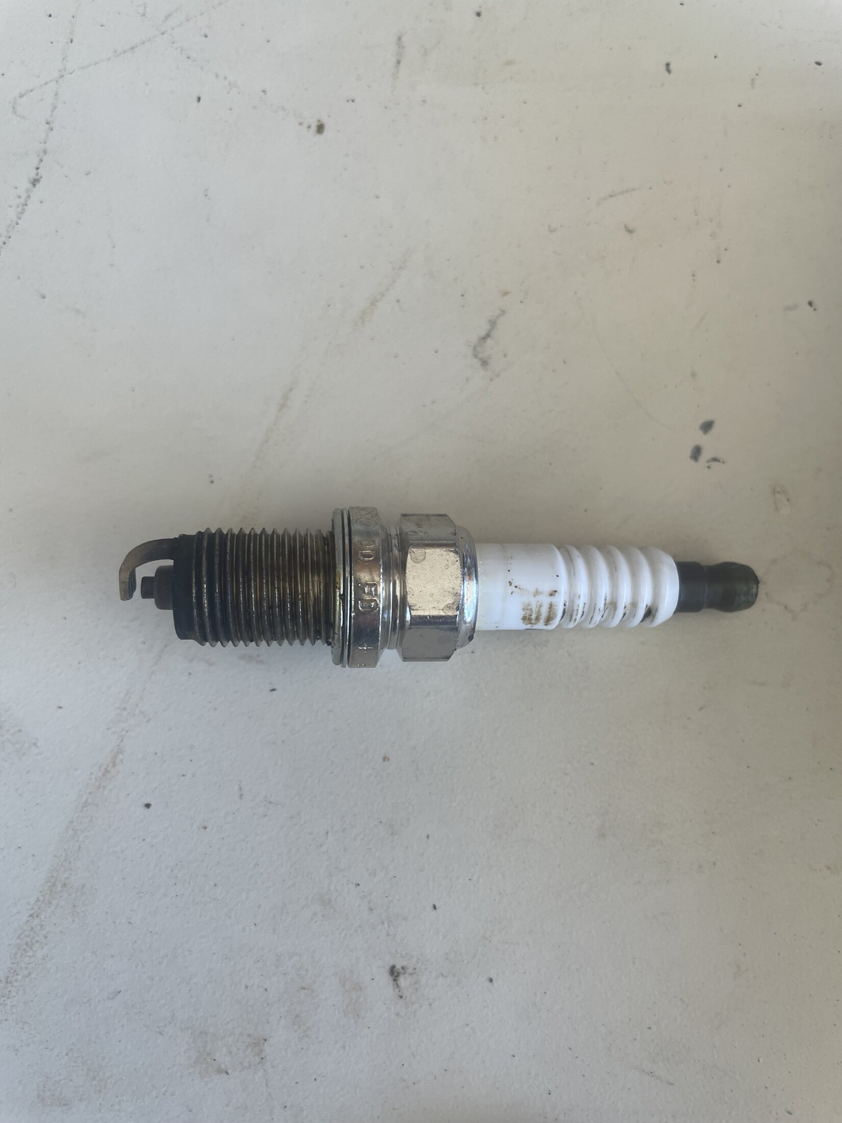

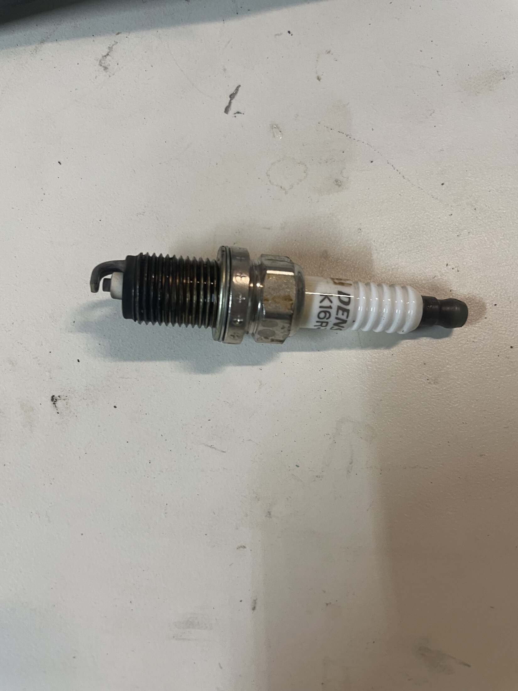

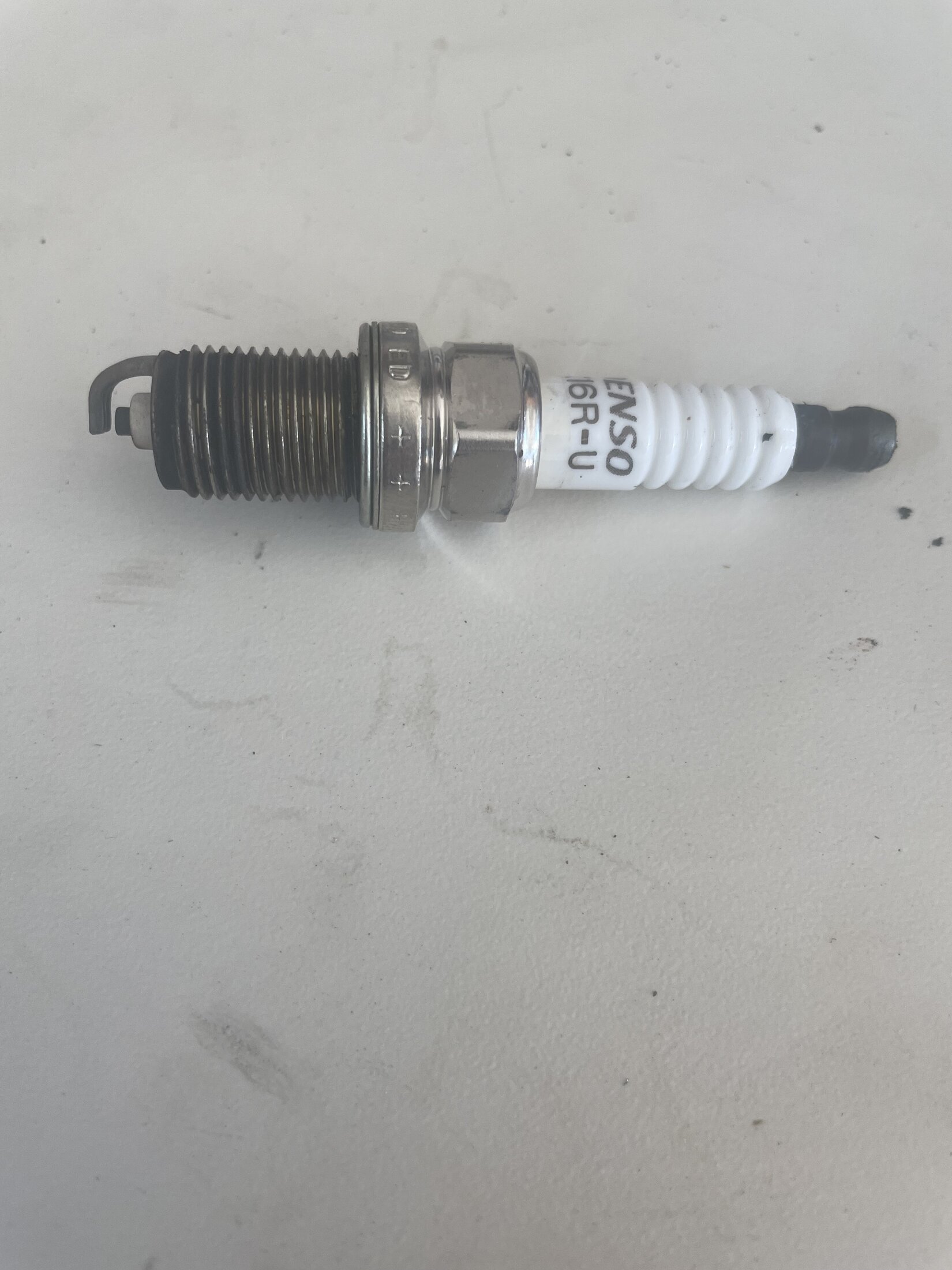

Changed spark plugs too….not bad.

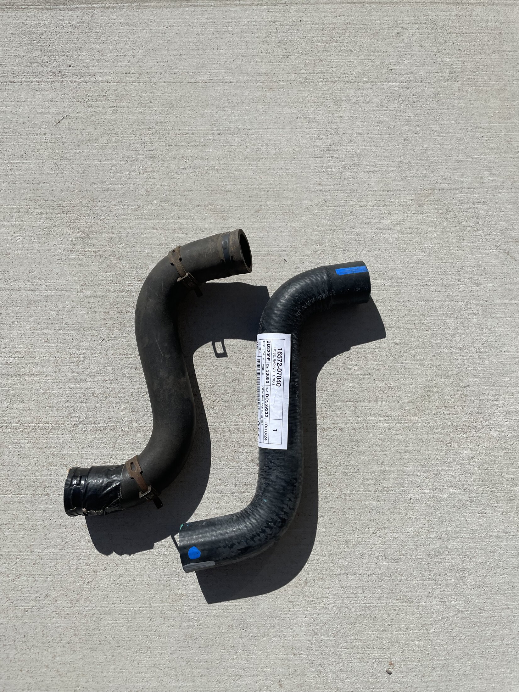

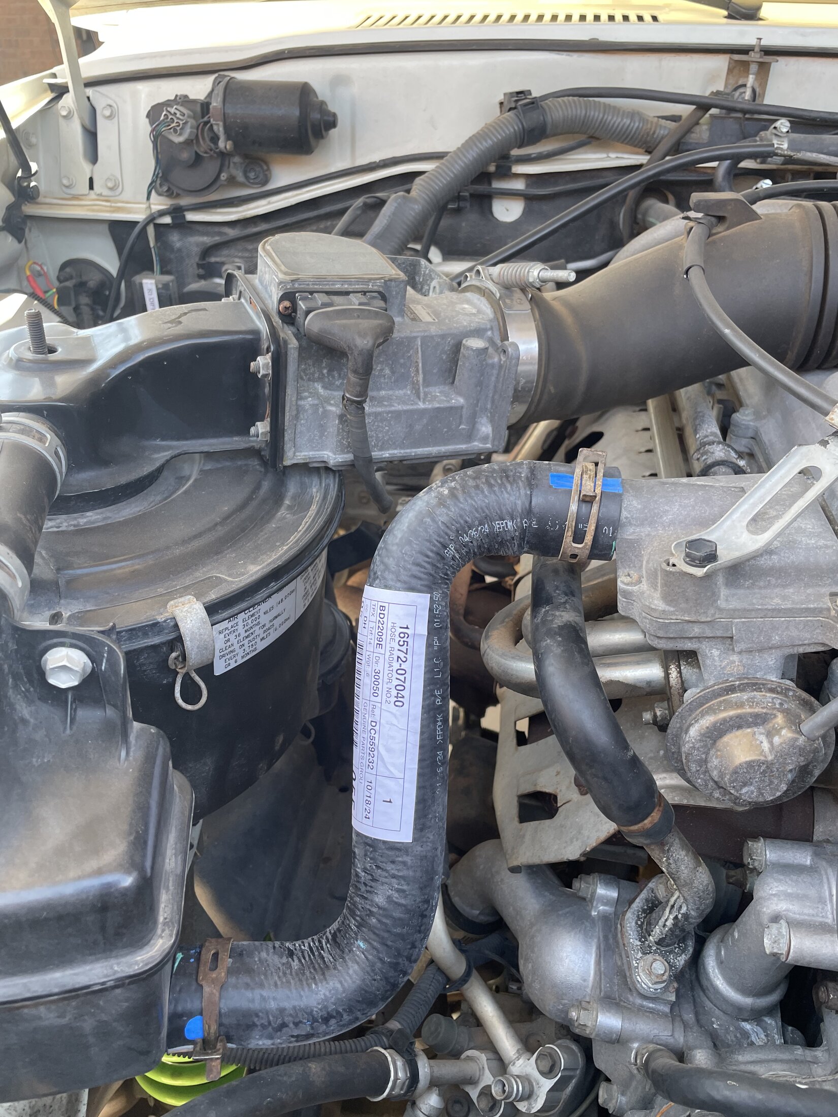

Now to cut this Gates hose to fit last coolant hose that is NLA
