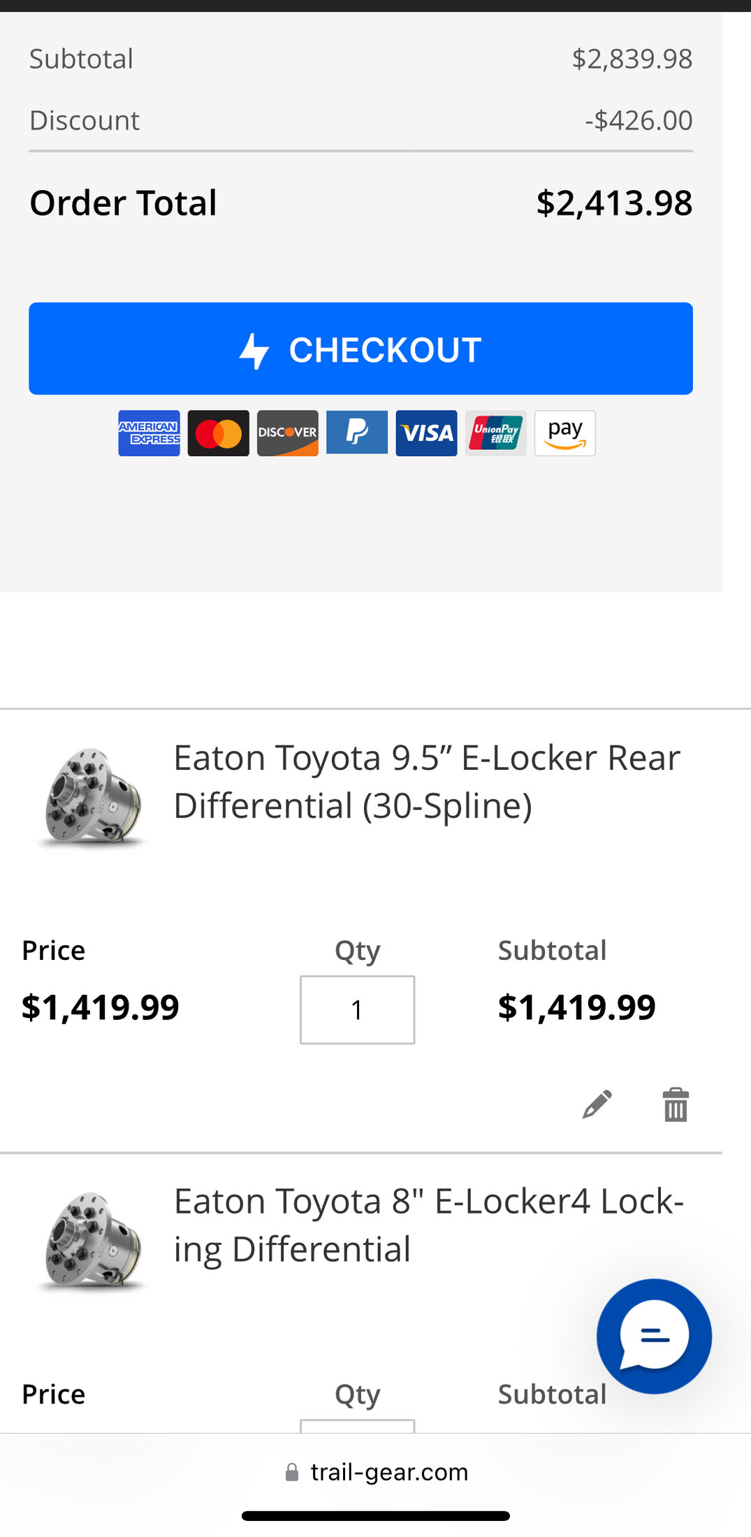

Pulled the trigger on Eaton lockers and more to do’s (1 Viewer)
I got my Eaton lockers at Trail Gear during Black Friday 2 years ago which was under $2300 for both and front rear, which looks like they are running a deal right now.

Looks like the front and rear e lockers from summit are $2900 parts only. So yea you got a great deal
