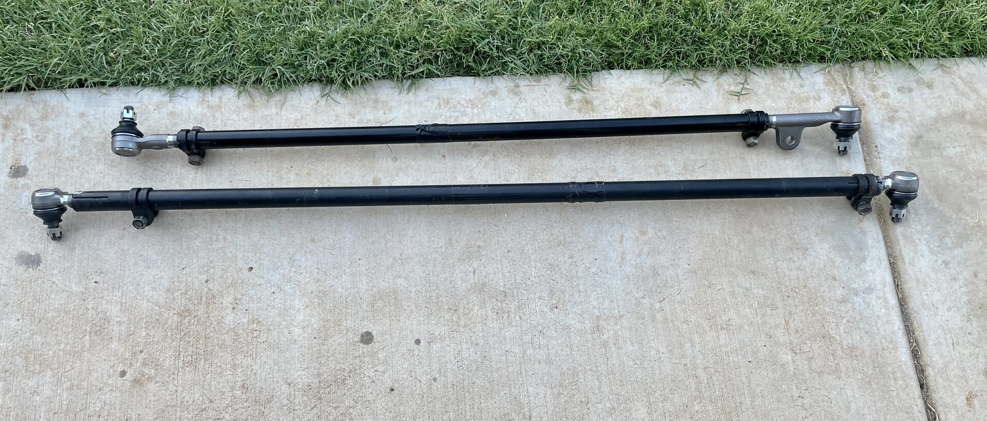

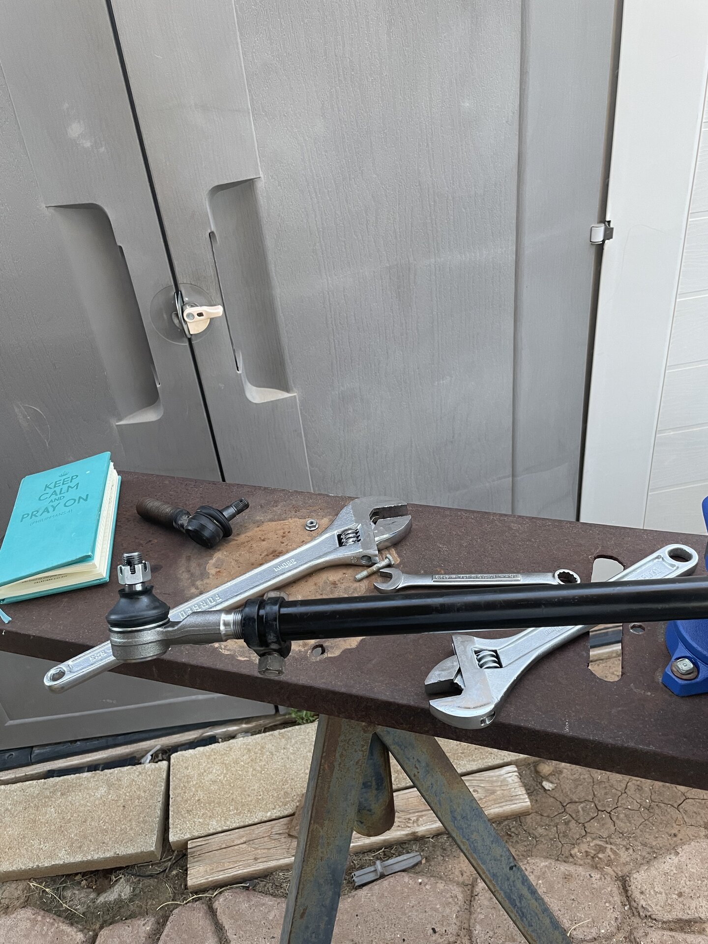

Taking out the !@#*!! tie rods is never as easy as people beauty shoot it to be…::but out with the old and in with the new

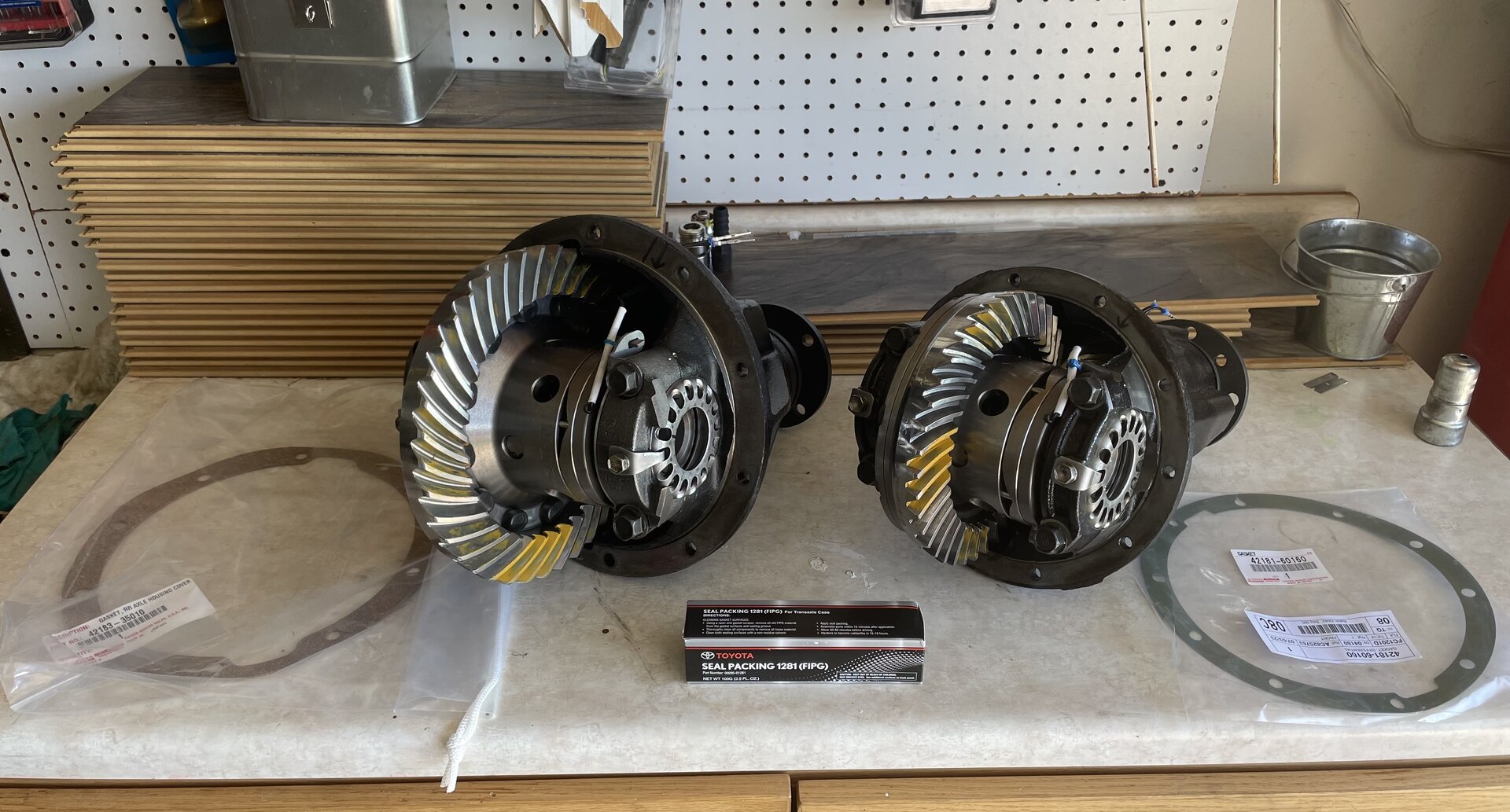

So received these a couple of weeks ago and had not had a chance to install due to waiting on some parts. While I get everything put back together, here is a beauty shot and also including the install exchange with Zuk in case anyone (besides me) is interested.

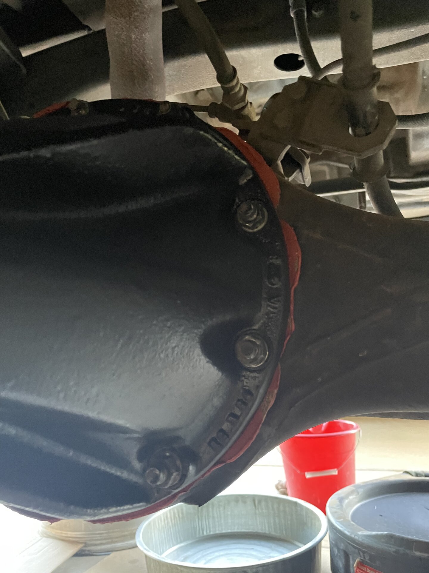

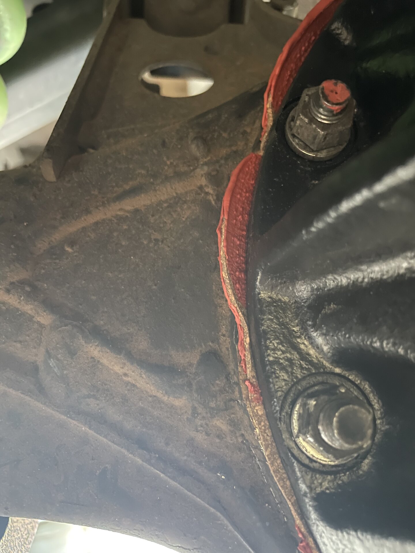

This doesn’t look right. Rear diff. I started to tighten in cross cross fashion. FSM calls for 54 ftlbs torque. I expected the FIPG to squirm out but not the gasket!…..thoughts? The front diff didn’t do that, but then again it calls for 18ftlbs
View attachment 3401454View attachment 3401455
That's because you used BOTH FIPG and a cork gasket.
Use one or the other.
I believe they are designed for a paper gasket and that's it.
It will most likely leak because of that.
If it was mine I'd pull it apart and get rid of the gasket and just do FIPG.
Yes a lot of work but less than tearing it all apart after it's together.
Good point. Did not think of that. The front one was paper. Just put it on but will come off. Thanks, thought I’d ask before buttoning up the axles and adding gear oil.

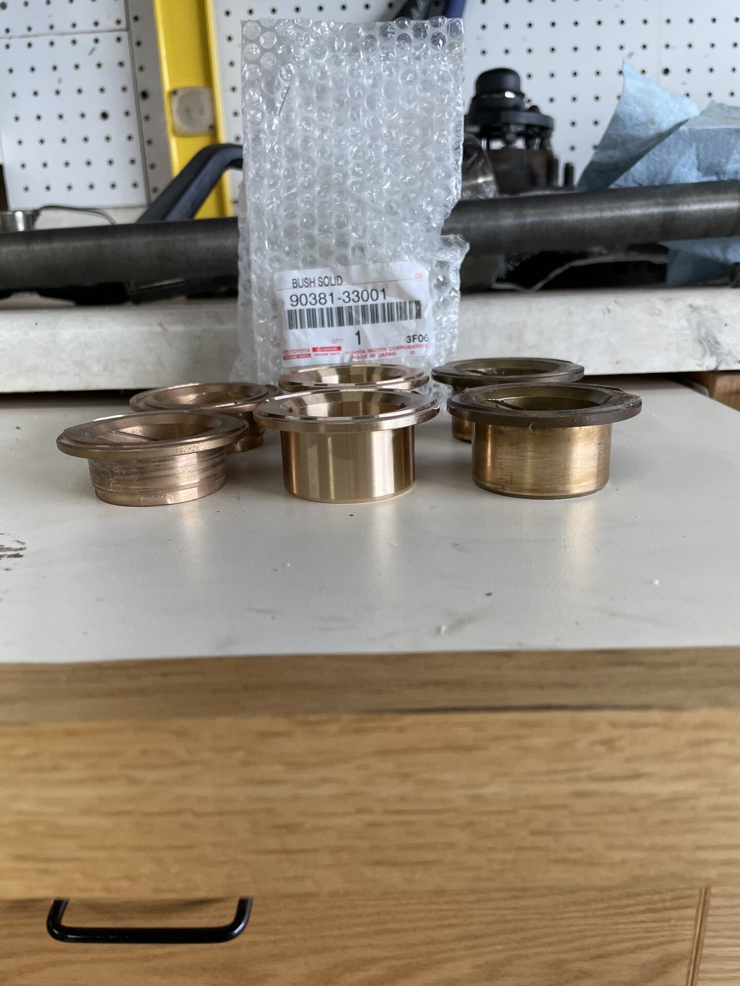

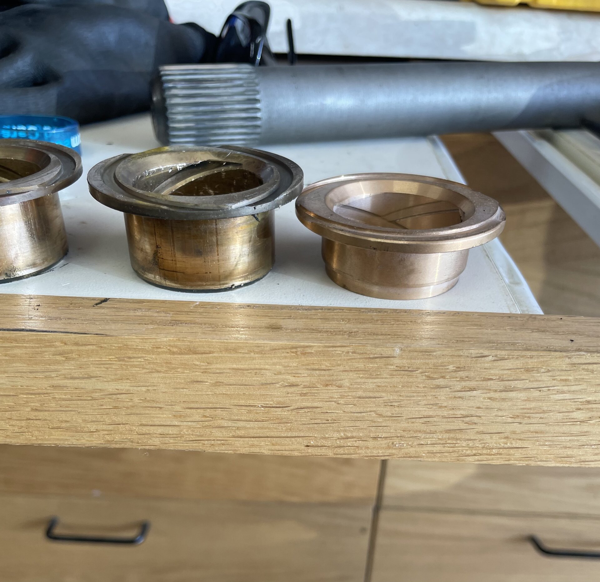

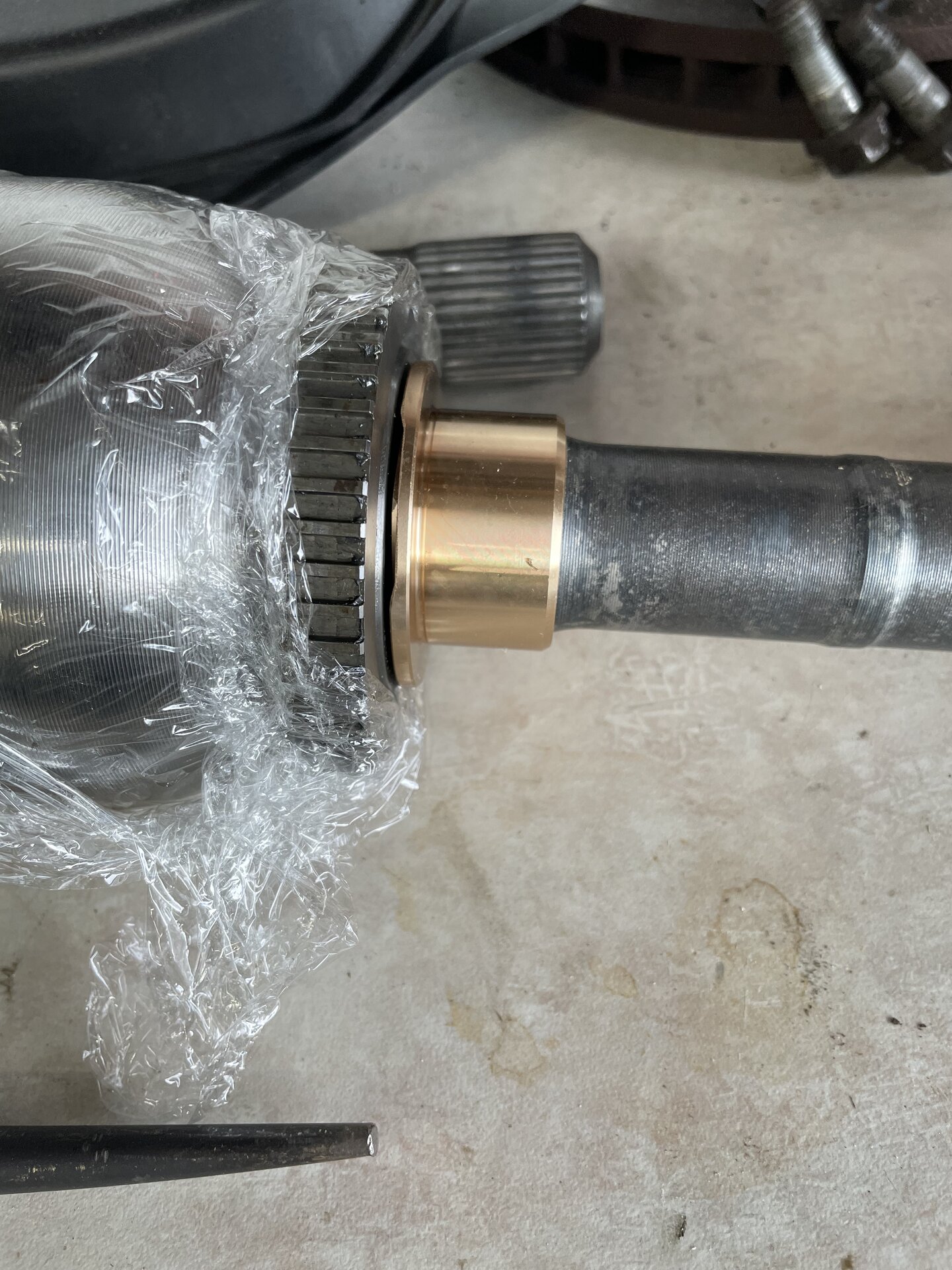

This shorter brass spindle bushing came in my knuckle rebuild kit…will that work or do I need the same depth as previous? Looks aftermarket.
Been a while, but after some good advice ended up ordering the correct bushing (middle).
Hindsight, should have never messed with it but oh well. As you can see the short one just doesn’t cut it….don’t know if these are specific for 91-92.

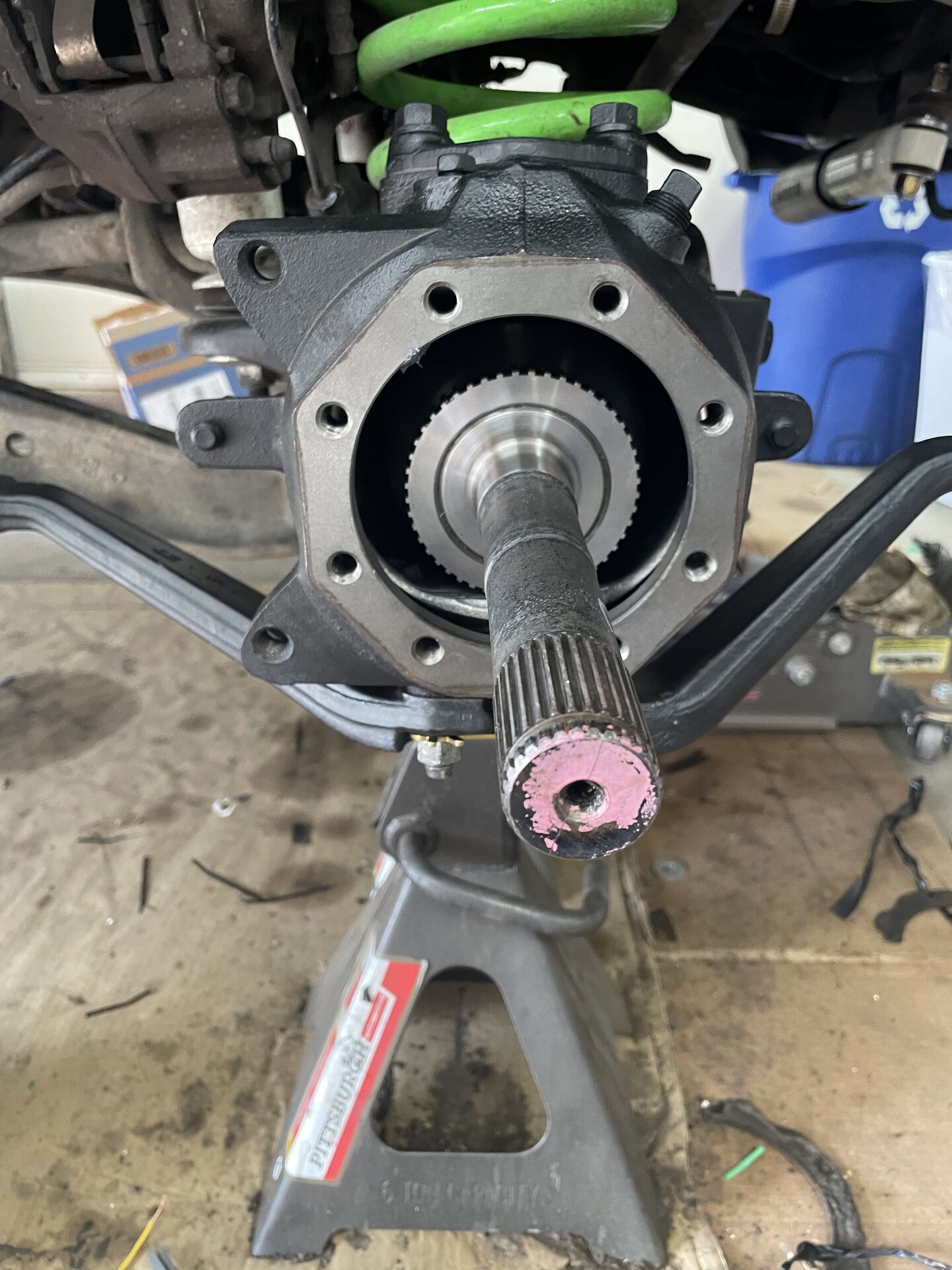

Also finished up the knuckles…fish-scaled, hugged nuts. and greased.

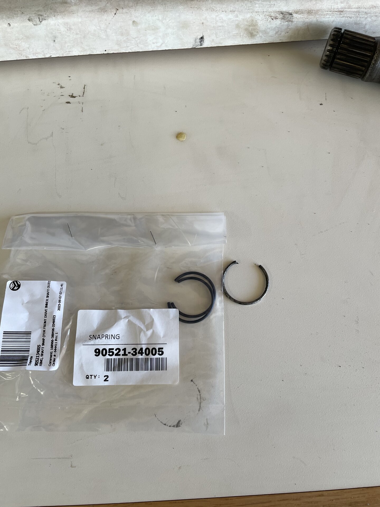

I swapped the birfs left to right, right to left so used new c clips.
