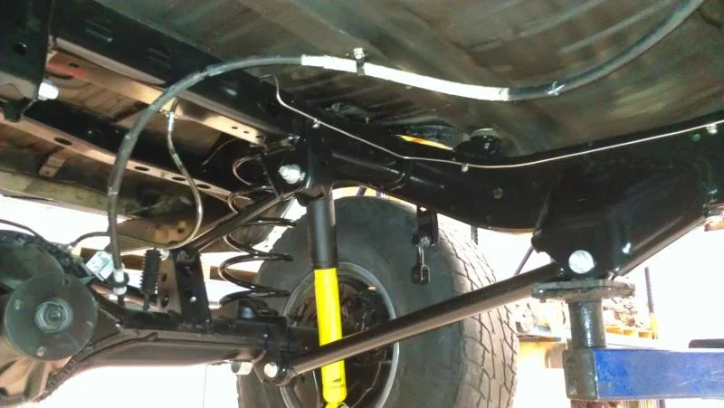

You guys are hilarious. I dont want to post up, its great bathroom reading material. Im back and working on it and will post up some pics tomorrow. Bending stainless brake lines suck. Cant wait to bend the 3/8 fuel lines. Finished the shifters, installed the fan controller, etc.

Tough crowd. Got the brake lines done....what a bitch. Working on the fuel lines now and finishing up the fan wiring. Got a cool fan insert made and powder coated that allows use of the big Spal fan recessed into the 62 shroud. I will get pics posted up when I get a chance. Did buy a RZR, but cant stop working on the 62.
