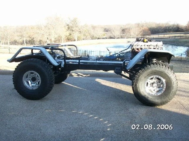

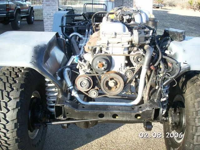

OK, back to work. Today I got the radiator mounted, and mostly plumbed. I will need to get a piece of tubing bent tomorrow for the rear hose(what used to be the upper) and it will be finished. I am hoping to get the wiring harness the rest of the way on the engine, plug everything in and start it by the weekend. I know it runs, just want to check for leaks. I ordered a overflow tank to go up front in the engine compartment mostly for air bleeding/burping, but also to catch any overflow since I have no idea how this is all going to work. The 80 shroud is back off to get the 19" Crown Vic electric fan installed into it. For now I will activate it on ign power, but after I see how things work, I hope to run it thermostatically. Heres todays progress.
G
Tire fettish...
Rim fettish..
I wonder what Grogan's other fettish's are :flipoff2:
Midgets? Just tossin out a guess here......
