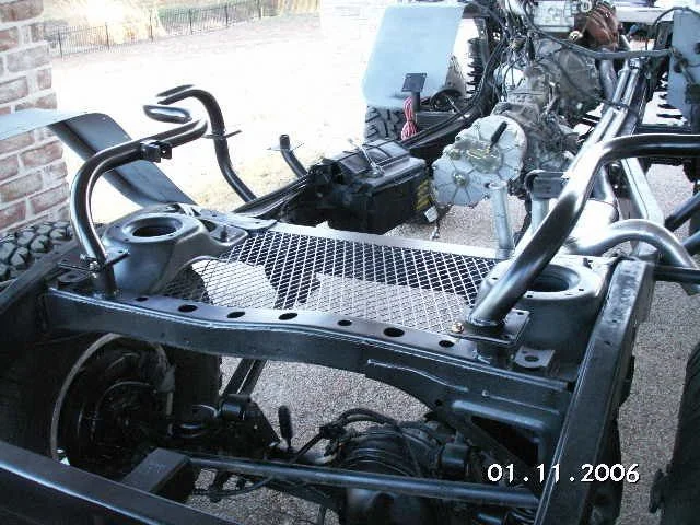

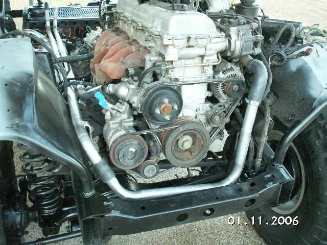

Today I got quite a bit accomplished. Got the coolant system plumbed all the way back to the radiator as well as made the radiator mounts. Also made a screen to keep flying crap out of the radiator. Decided to make all new tranny coolor lines to run back to the rear mounted radiator which allowed me to loose another 10 lbs in steel lines and a dozen overkill brackets. The lines will be teflon lined stainless braided hydraulicly crimped with #8 fittings at each end. I will solderon #8 male fittings at the radiator end and the tranny end so they will screw on easy with no leaks. Here is a couple of progress shots. I am getting impatient waiting on the body.
