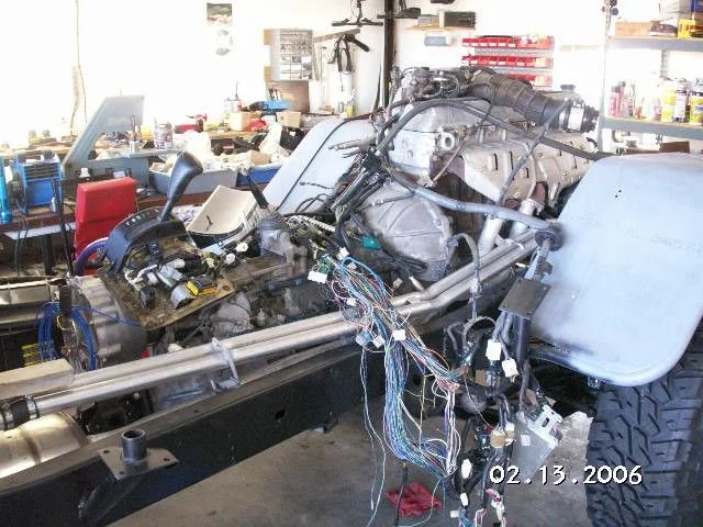

The switches are from 4x4 mods and seem to be decent quality, but time will tell. The 3 in one gauges are from a streetrod company called haneline. They are new and not advertised yet butthe rest of their stuff is first rate. Working on getting the harness on the chassis today and will have it done this weekend. I had already taken a lot of the crap out of it but now I am fitting it to the chassis. Got the tail lights and modified the harness for them plug and play. More pics tomorrow.

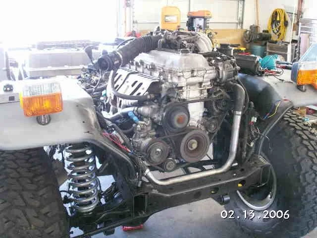

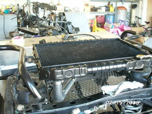

No pics really. I did take some but not because I got anything accomplished. I did start the truck today and tried to figure out if the factory water pump will be able to push/pull water all the way to the rear where the radiator is. I am waiting on a small aluminum tank to mount high on the engine for filling and bleeding of air, so I will have to wait until I get that system up and running before moving to pump issues. I dicked with that all day so I couldn't get the wiring done for the electric fan, but I did find out that a GM O2 sensor will work fine with a dummy load sensor for the 2nd O2 sensor. I have not gotten any codes, but I haven't driven it yet either.

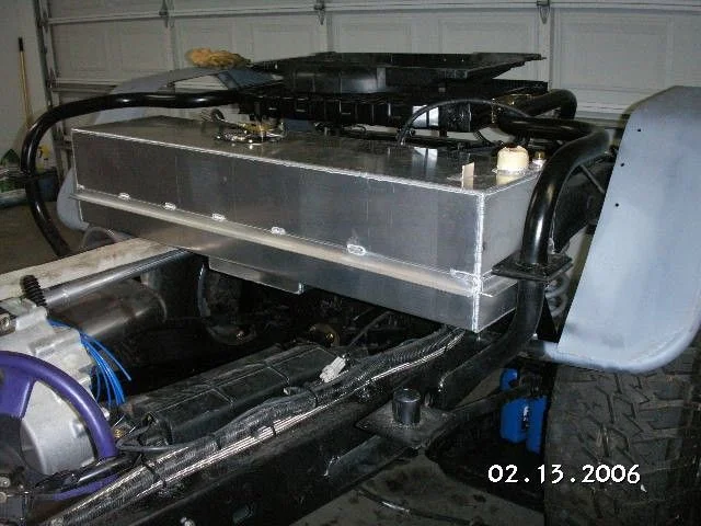

Bled the cooling system and let it run for 1 hour today at idle with no fan. It wouldn't run over 190 degrees. Got all the rear wiring done for the fuel system, electric fans, etc. Todays pics.
Two quick questions, Gary:
1) Is that a purple steering wheel?
2) Can I have the truck, as a gift, between buddies, for free?
