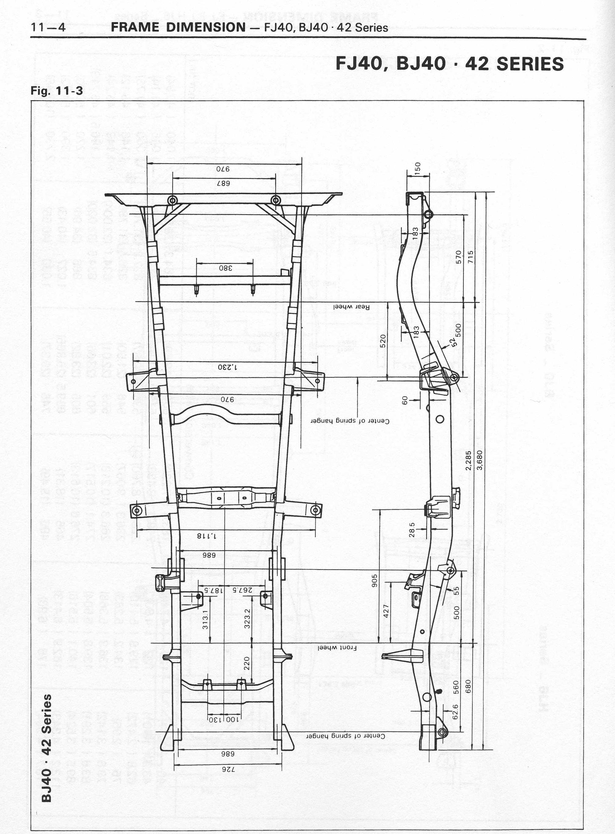

What about the frame and the shackle mounts are they within specs, you may have bent frame rails.
I don't know exactly what spec is. I found a couple of frame spec diagrams but it wasn't very clear what information was accurate. They didn't all agree with each other.

My FSMs on "Chassis/Body" have exact dimensions for frame, and sections for Inspection and Repair & Replacement ( my stuff is for a '64 40 tho ). Toyota Factory Service Manuals are great.

Its definitely a correct era 40 axle, the more I read the more I think its just the frame that's out of whack. Supposedly the correct spring width is 970mm or 38.2 in, I measured the axle at right around that.
So project update. The frame was definitely put out of whack when the rear crossmember was replaced. I decided the easier way to fix the suspension was to just remove the rear spring perches and move them out. So far I've gotten them ground off and started to learn to weld, so I can reattach them. It'll probably be ugly but I'm just going for functional.

Not sure if this helps or not (don't know what years the frame changes), but a good reference...

They aren't wrong lengthwise, they're no longer the correct width apart. They should be 38.2" and they're nearer 37.2". The frame has been gacked, I'm solving it the lazy man way by only moving the parts of it I care about.

Well its been awhile, I guess I owe this thread an update. Since I've been home for break I've made some good progress. I decided to grind off the rear spring perches and re-weld them a little further apart. I have a sum total of about an hours worth of welding experience at this point but I'm proud to say that the perches are reattached with probably the ugliest booger welds I've ever seen, but at least they seem pretty solid. I'm going to add a bolt through just to be on the safe side but all in all it went about as well as I could have hoped.
