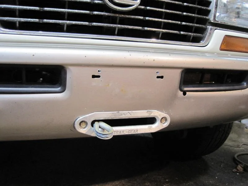

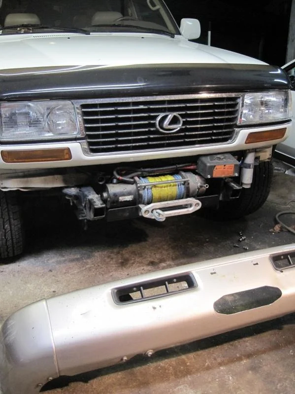

I have done this before to my white 8o with the same winch you have using a TJ winch mounting plate. I will be doing this soon to my LX overland project using a Mile Marker 8000 lb. winch. The previous setup included a hawse fairlead with as small of a hole cut into the factory bumper as possible. This time, I will cut a larger hole the size of the licence plate and use a roller fairlead. I can post pics of the former setup but do not want to spoil your thread.

Your thread was a good read. I especially like the fact that we both had the same idea; it came naturally to want to mount the winch upside-down, but then I had the same thought you did - no protection.
Really clean install and excellent way to add functionality, Rick!
I just may go with a roller fairlead later, but I want this to be tested as-is: this project only cost one 7" metal-cutting Skill Saw blade, so I will let this project remain as a no-cost build. :cheers:
But, I just might build a front bumper soon.
What did you use to trim the fairlead? And do you have any more measurements??
I didn't trim the fairlead, that is how I received it. If you are referring to the area where the fairlead is exposed, I used a Skillsaw and 1/8" cutoff wheels.
I can take any measurements you are looking for; which are you interested in?

oh, I meant the winch mount (which the fairlead is mounted to). The steel plate looks fairly thick did you do that the same way?
And the dimensions for the cuts in the bumper, as well as the dimensions for the plate, would be great!

Harbor Freight, $39.99. The plate I have is 1/4", not sure if the plate they are selling is the same, but it is heavy duty.

Picked me up a mount from harbor freight for 40 dollars and stole your idea. Used a 9000lb winch from pathfinder recovery gear and with a little grinding of the grill bracket was able to push it far enough back to only trim just around the fairlead. Turned out great, thanks for the idea.
