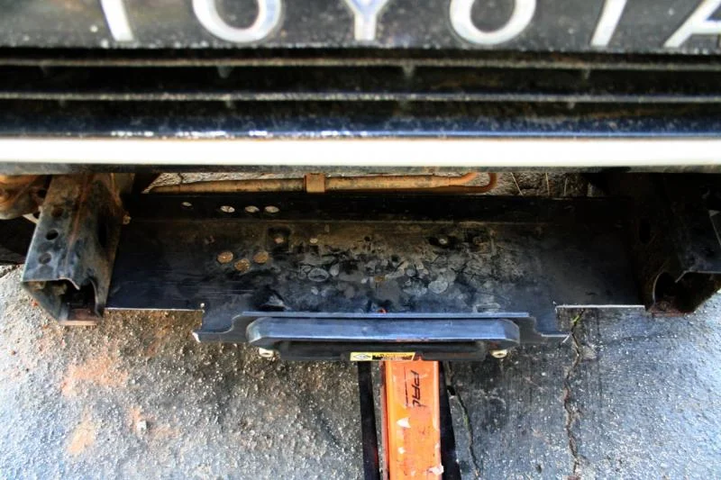

Here are a few mock-ups.
I wouldn't mind some opinions on how I should do the cutout on the bumper; I already allowed more than enough room for the fairlead, and am now wondering if I should cut more to allow for side-to-side movement of the winch line.
Anyway, here you go:

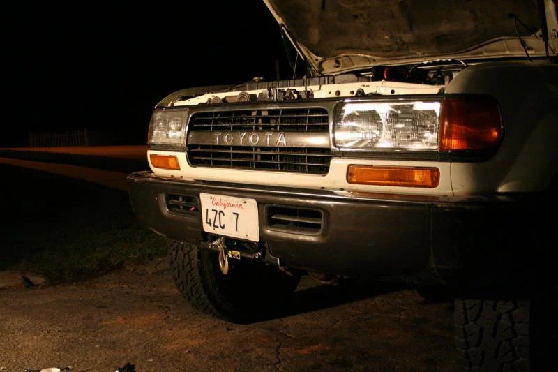

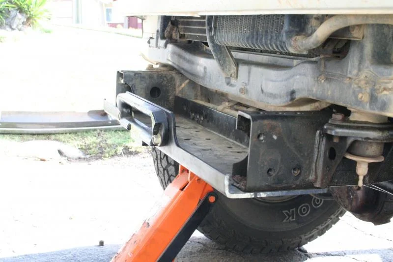

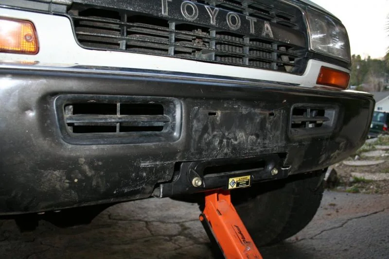

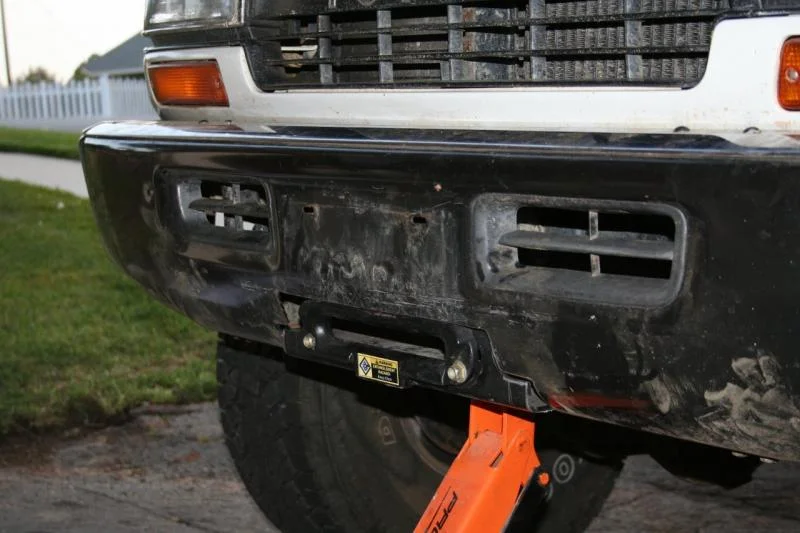

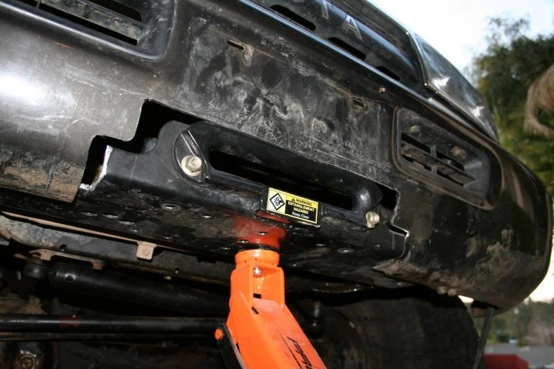

In the first image, I lined everything up and put on the bumper to see where the mounting plate would hit. It did, so I carved out the front of the plate and the lower portion of the bumper as you can see in image two and three.

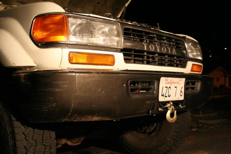

Two more images, showing how the fairlead sits relatively flush with the bumper. The front license plate will block the fairlead, but I think I can live with that for now.

Back on track, I now have to relocate the control solenoid. It will not fit under the valance, but the winch itself fits really snug behind the bumper.
Ultimately, I had to remove the recovery hooks; these will be later relocated, but not tonight. Everything now lines up.

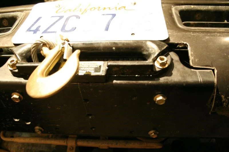

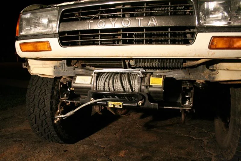

Finally finished.
Top image is what the winch looks like fully mounted.
Last few are the final product.
I am too tired to take measurements of everything now, but here are a few:
For the winch mount plate, the holes are separated by 28" exactly; the distance between the bolts on each side are 2.375" (2-3/8").
The bottom of the bumper will need to be carved out in order to allow the bottom mounting bolts to clear. The license plate was moved upward to about .50" above the two side vents.
I may want to cut more of the bumper away so that I can easily access the clutch; as it is, I can get one finger through to reach the clutch, so I can live with that.
Enjoy!
Nice job. What did you use to cut the bumper? You got some nice rounded corners I'd like to repeat on mine.
Why wouldn't the tow hooks mount under the winch plate in the same location they were originally?
I used a skillsaw with a metal-cutting blade to cut everything. It went from 7" down to three inches, so I would suggest getting two blades to do it right.
The hooks, due to the fact that the mounting plate lowers them from their original position, get in the way of the brackets that mount the bumper to the frame. This is pretty much a non-issue since I have a lot of room on the mounting plate to mount the hooks.
